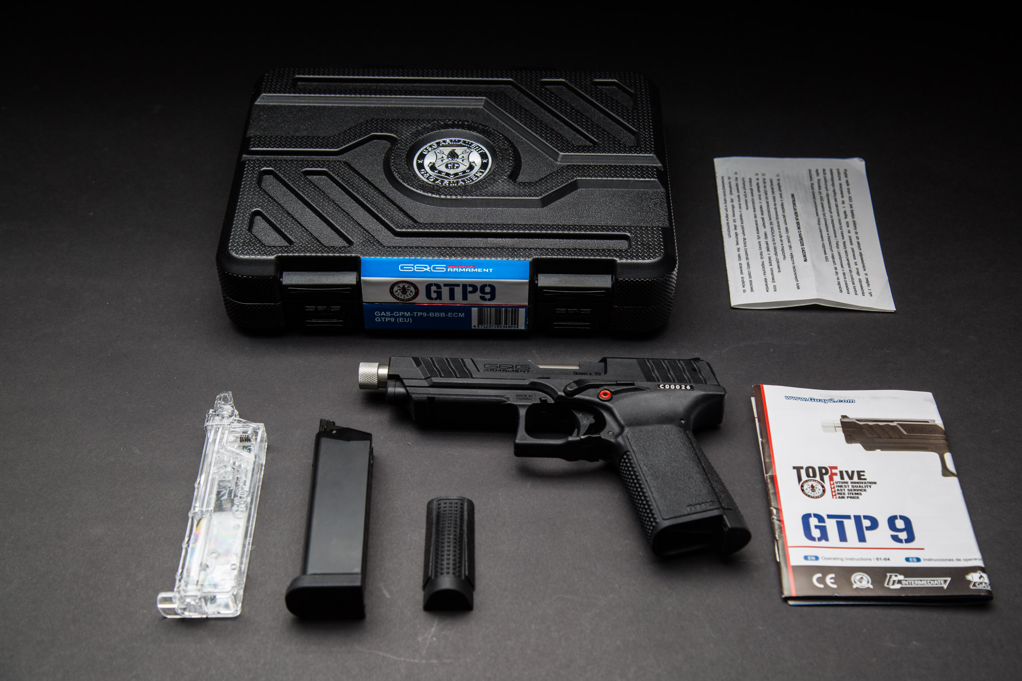

The replica sits very well in ones hands and shoots very nicely. Nevertheless, as the magazine being emptied, I had the impression that every consecutive shot was getting weaker. Interestingly, the measurement of the muzzle velocity denied this impression completely. So that's just that, an impression. From one gas filling, nearly 2 magazines, or exactly 38 BBs, can be fired. We managed to repeated this result, +/- 3 BBs, several times.
Pros:
- an attractive, almost perfect set (case plus accessories);
- modern, aggressive look;
- very comfortable grip;
- well placed and designed manipulators;
- solid, robust design;
- convenient Hop-Up adjustment.
Cons:
- just an average muzzle velocity;
- not a very strong blowback system.
