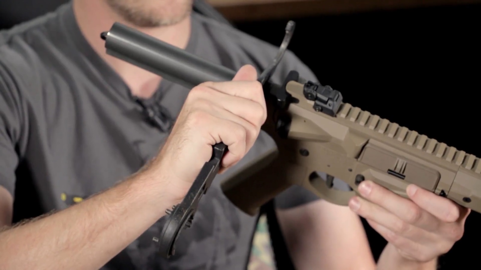

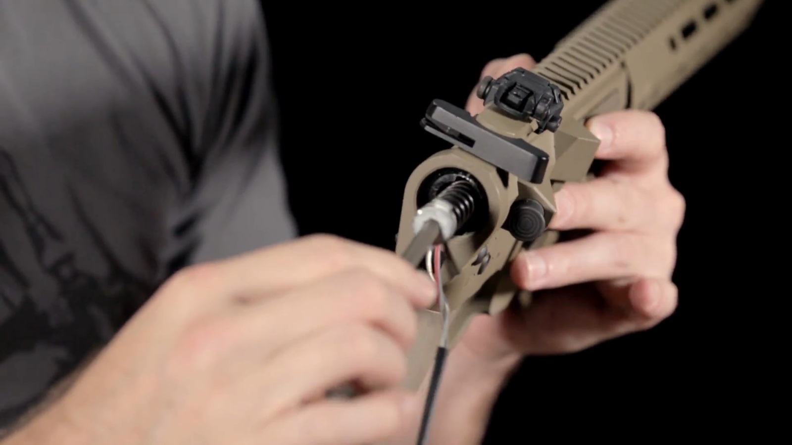

To change the spring, it is not necessary to pull the gearbox out of the body, which saves significant amount of time and simplifies the operation. First, one uses a dedicated key to unscrew the stock guide, then unscrew the centering screw using a flat screwdriver and remove the spring guide using an Allen wrench. The next step is to change the spring to the right one and assemble the replica, doing everything in the reverse order.
