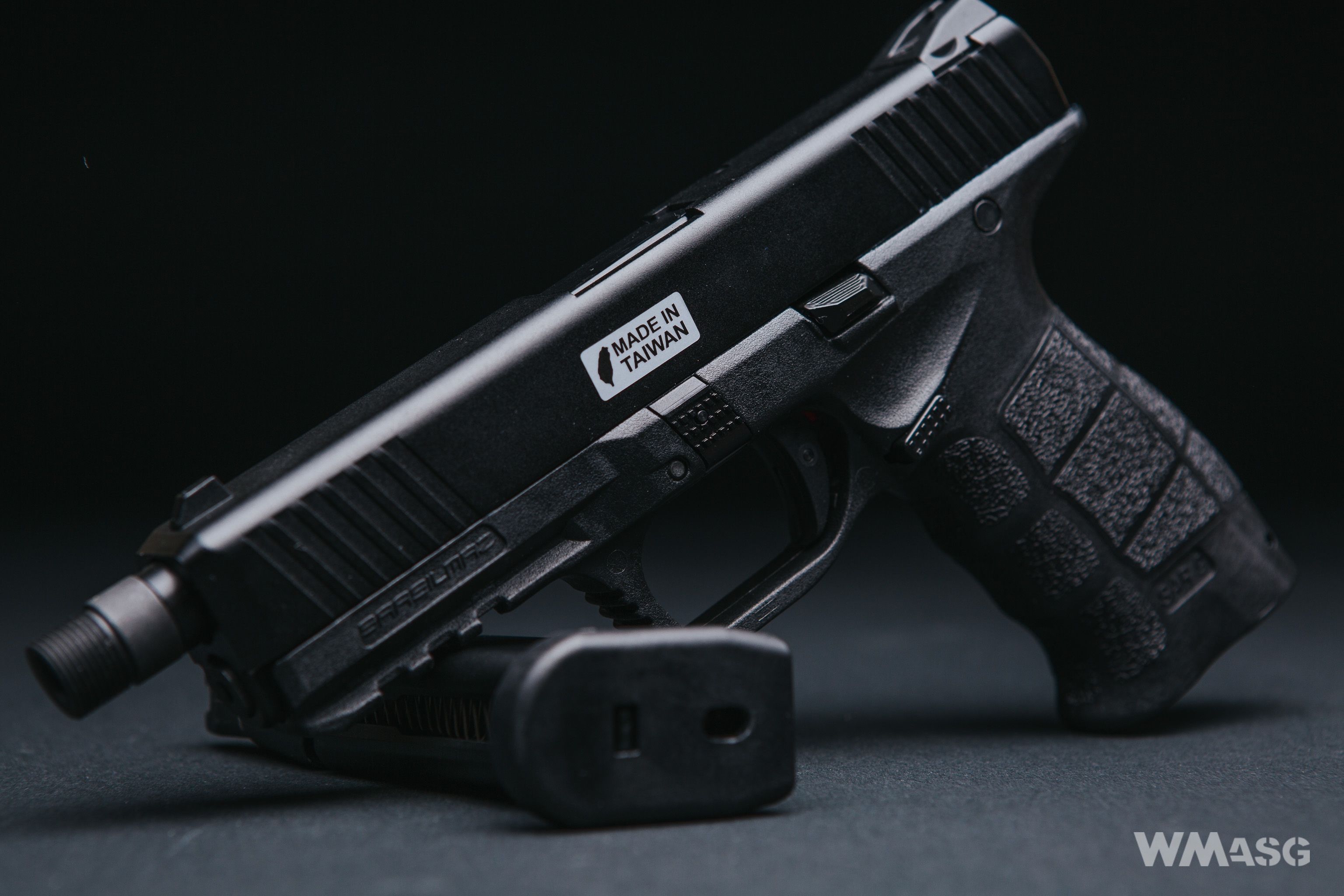

Important features of the pistol from the point of view of a potential user are a fixed inner barrel, as in the Korth pistol replicas, and new Revo valves.
The frame is made of hard polymer. The manufacturer declares that the slide is made of aluminum and not an aluminum alloy. So it probably is not ZnAl. Visually, the gun looks great. We did not have the opportunity to compare it with a real firearm, but based on some experience in dealing with real guns, we can say that it looks very convinci.

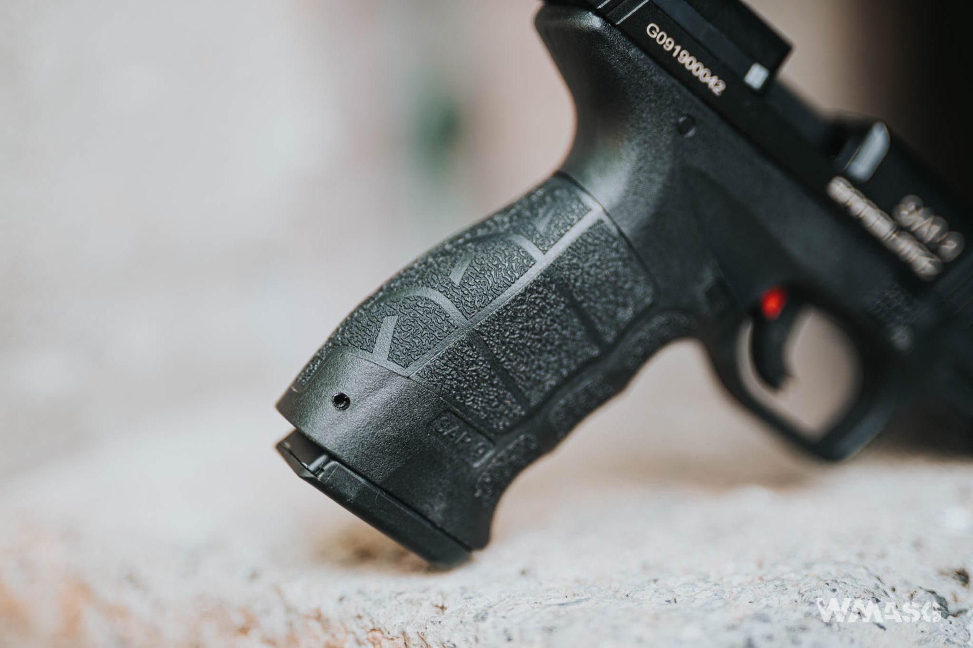

Let's start with the frame... The rear part, just above the grip, is deeply undercut, which protects the hand against possible contact with the slide moving backwards. The grip is ergonomically shaped and covered with a non-slip texture, thanks to which the replica sits very firmly in the hand. The lower part is slightly extended, which is supposed to facilitate (speed up) magazine changing. The front ridge of the grip is shaped to support the individual fingers. In turn, the place where the trigger guard connects to the grip is additionally deeply undercut, so that the gun sits deeper in the hand, which noticeably handling of the gun.
The grip of the real SAR has a modular structure, so it can be easily adapted to the preferences and size of the shooter's hand. ICS has faithfully reproduced this solution. By taking out a single spring secured pin, one can replace the back panel with an enlarged one, which is included with the replica. Removing the back panel also allows the removal of both side panels. This solution was also applied by ICS, but neither in the replica's box nor in the manufacturer's catalog can any accessory side panels with a different profile be found.

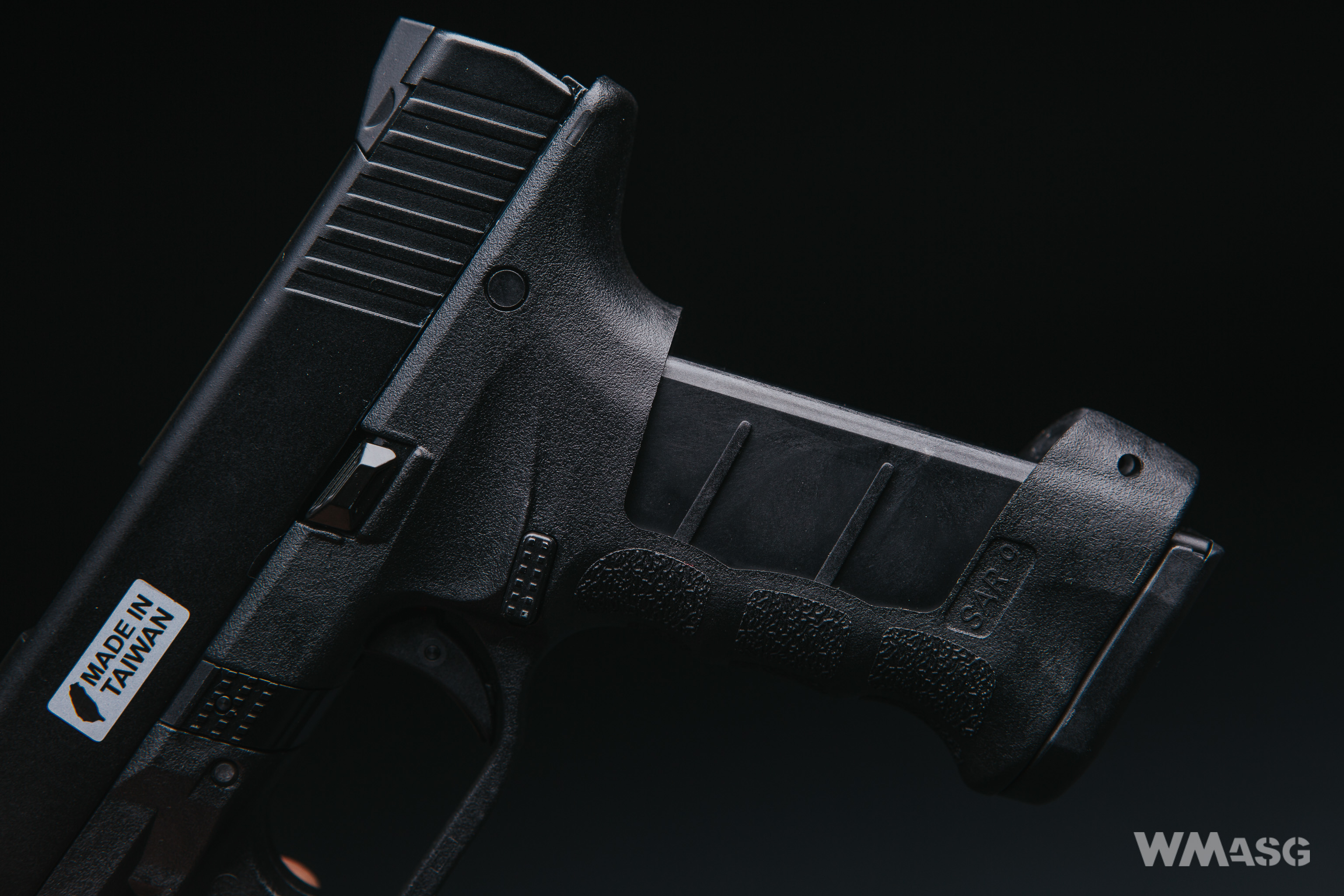

On the right side of the pistol, at the contact of the trigger guard with the grip, there is a magazine release button. It is one-sided, but ICS has made it possible to move it to the other side to make life easier for left-handed shooters. The operation is not the easiest one as it requires a few trials and practice. In a nutshell: remove the needle spring that supports the magazine release from the inside of the grip, transfer the release to the other side and reinstall the spring. Good luck!
Another button is located directly above the magazine release button and it is used to release the slide when it stops in the rear position after the last BB has been fired. This slide stop is only on the left side of the replica and cannot be moved to the right. In Glocks it catches on a special notch in the side of the slide. The SAR has a notch inside the slide, there is no undercut visible. Slightly to the back one of the axles of the trigger mechanism was replicated (but its only a dummy). In some versions, a safety switch is placed here.

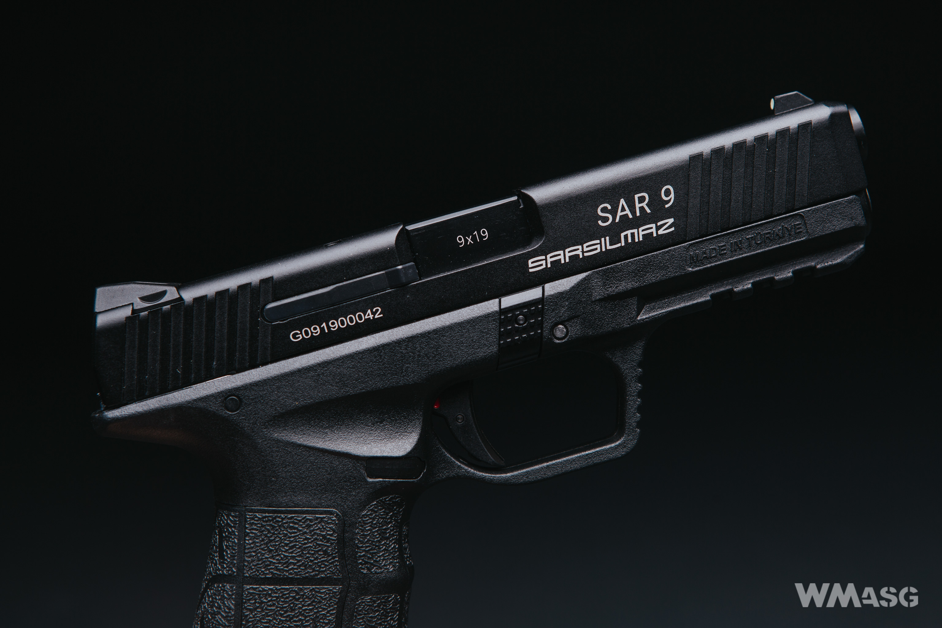

The slide itself, colored in semi-matte black, just like the frame, is also very well made. On both sides, in the front and rear sections, there are obliquely milled ribbing that facilitate charging the pistol. The left side of the slide is free from any markings, but on the right we have the name of the manufacturer and the model name. The caliber 9x19 is marked in the ejection port and even further is an individual serial number. There are no "airsoft", "ICS" or "made in Taiwan" markings on the pistol. Only inside the underbarrel rail is the “Cal. 6mm BB" marking. All of them are laser applied.

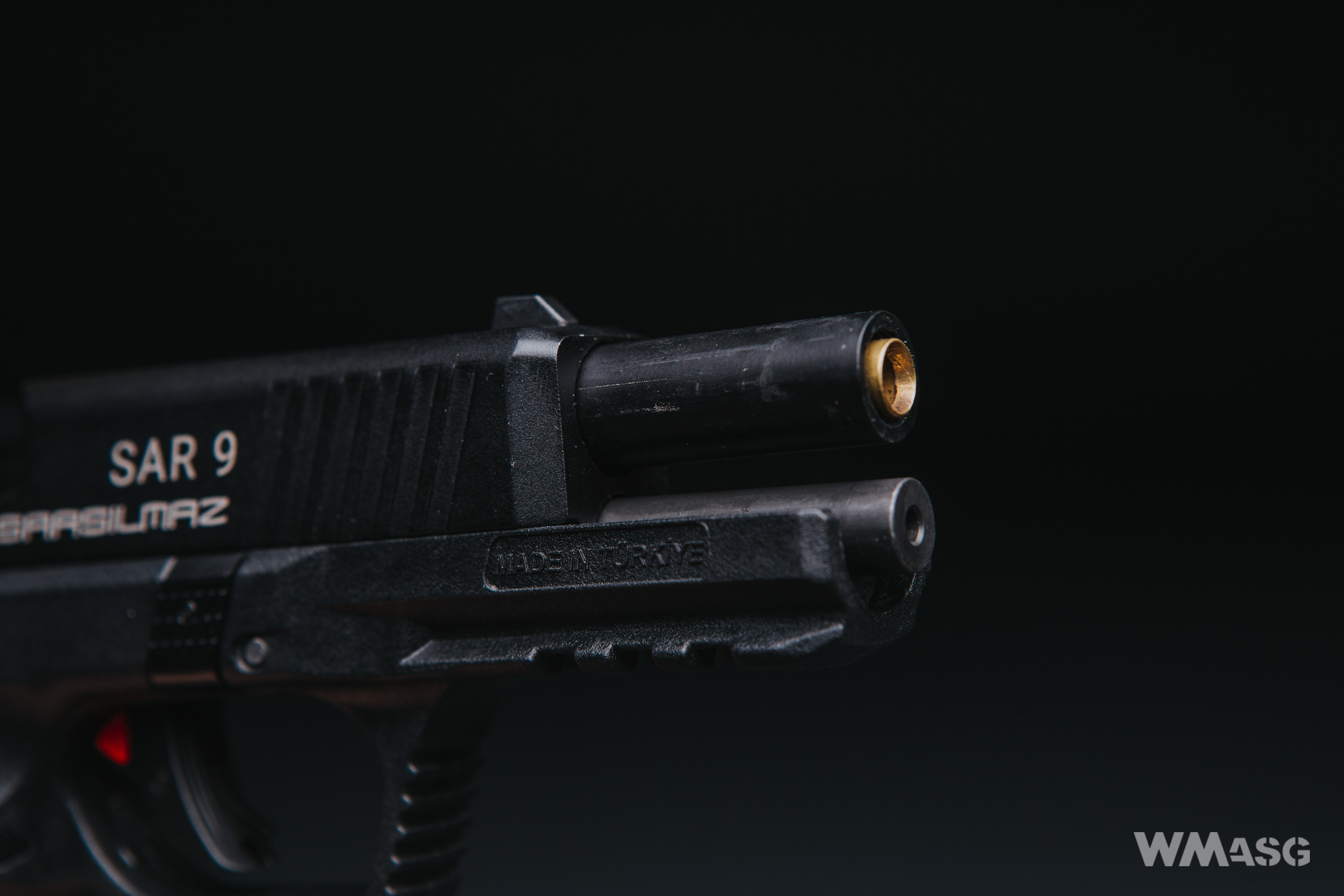

The outer barrel of the gun ends with an internal, CCW 11 mm thread for mounting a silencer.
The test copy was equipped with a steel adapter for an external 14 mm CCW thread, typical for most silencers.
The adapter is not mentioned in the user manual, nor is it in the SAR description at the ICS website. Therefore, we probably received a pre-production copy that will probably soon be offered by the manufacturer.
