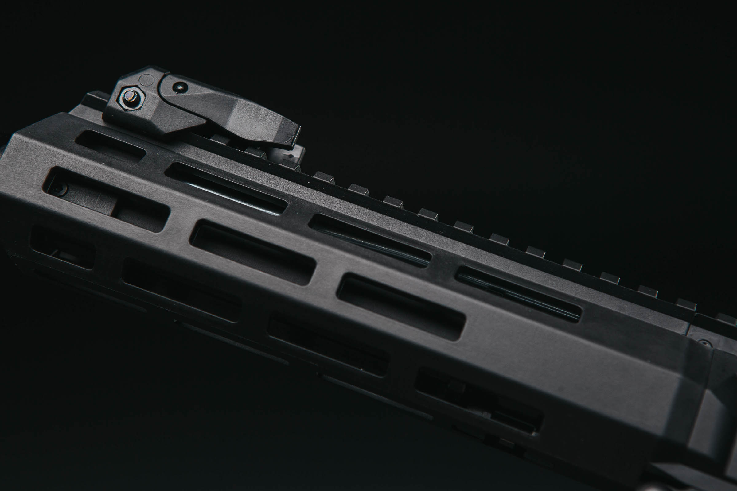

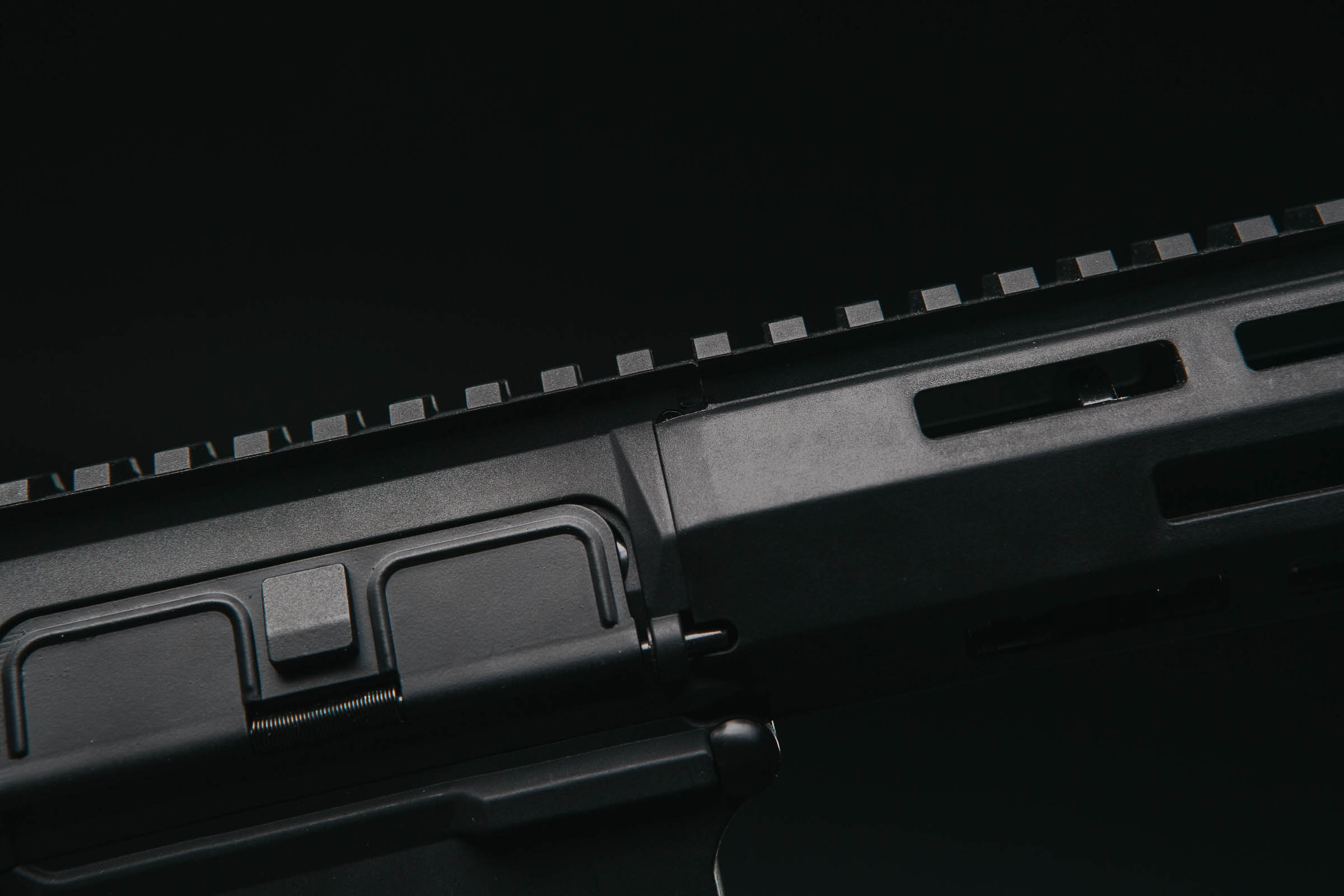

The first thing is the stabilizing pin. A hole is made in the upper receiver, just below the upper Picatinny rail, into which a stabilizing pin placed in the rear part of the handguard is inserted. Thanks to it, both sections of the top rail (on the upper receiver and on the handguard) match perfectly. In addition, the pin is one of the parts that prevents the handguard from rotating around the barrel.
The second thing is the protruding side arts of the handguard, which cover the upper receiver. Their size is such that they slide over the receiver very well, without slack. This is the second element that does not allow rotation and clatter of the handguard.
The third thing is a clever coupling with a Roman screw, which, leaning against the collar of the barrel mounting ring, presses the handguard to the upper receiver. The effect? The replicas is really stiff. And by the way, multitool pliers are enough to disassemble the handguard. It is enough to loosen the Roman screw so that you can pull the coupling out of the socket and using a little force, the handguard can be slid off the replica by pulling it towards the muzzle of the barrel. And underneath is a bonus not often found in replicas of this price rage - Double Eagle made a metal replica of a gas system with a gas block and a gas tube.

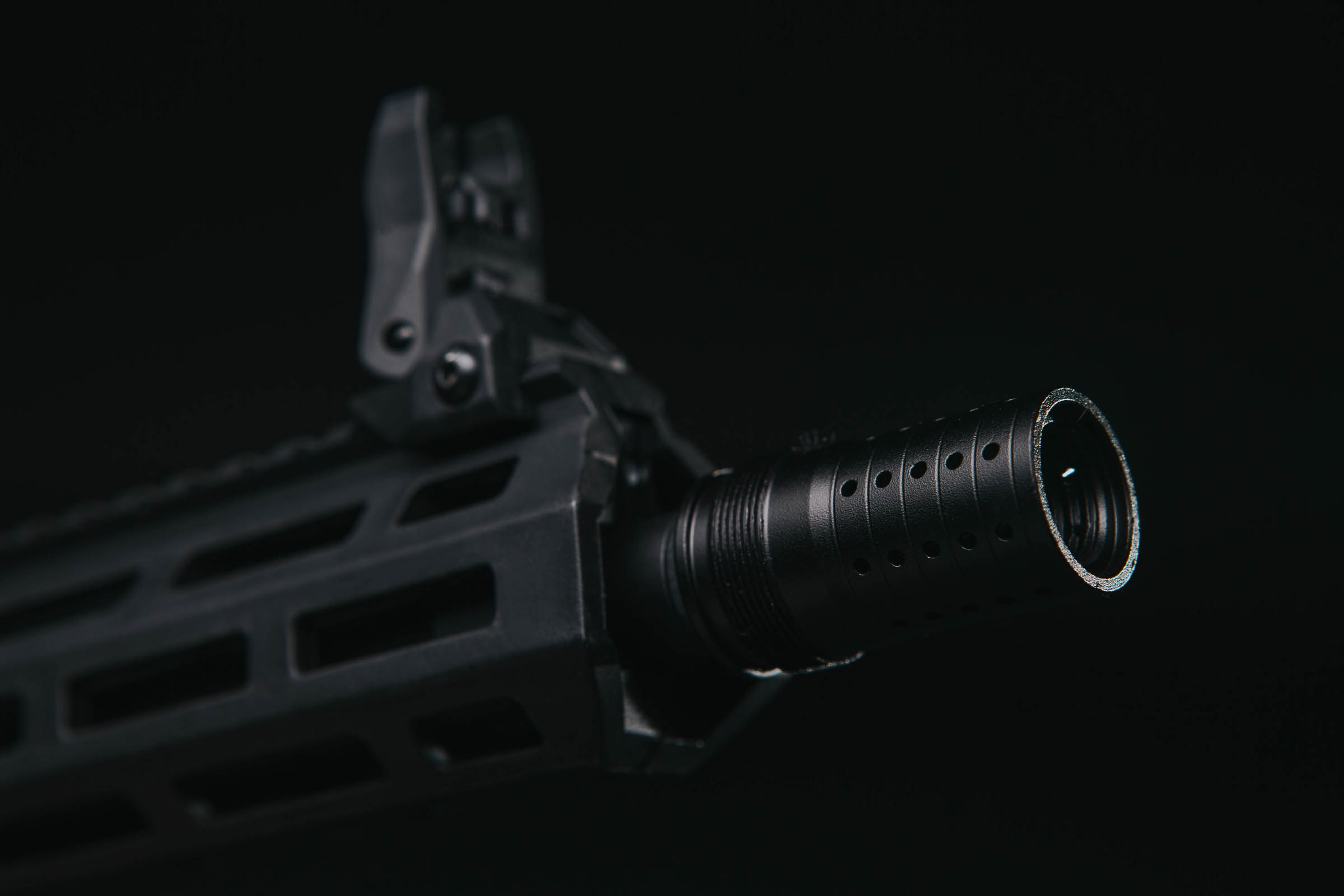

The barrel ends with a flash hider mounted with a typical 14 mm left-hand thread. A setting screw, that secured the flash hider, is located underneath. A 26 mm outer thread, places in the flash hider, is puzzling. There is probably a DE silencer on offer that can be installed in this way, but we haven't found it yet.

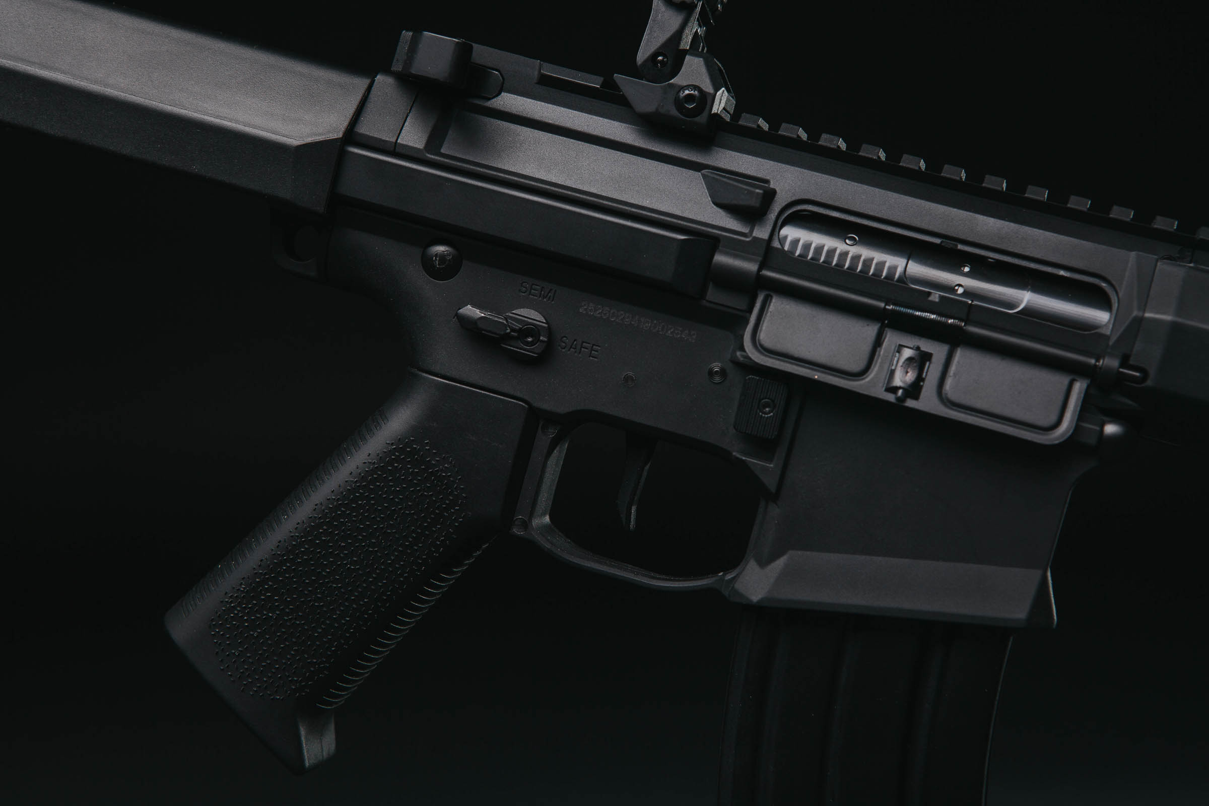

The replica's receiver is a variation on the subject of modern ARs milled receivers. There are 2 things to note here. First,  side undercuts in the upper receiver, where the stock guides move. The second is the seemingly enlarged magwell. In practice, however, it turns out that this magwel is only a dummy. Of course, its outer walls are formed into a widening funnel, which is to facilitate changing the magazine, but the inner walls are standard vertical ones. The integrated trigger guard is enlarged and it cannot be detached.
The safety/selector switches are located on both sides. They "click" clearly when set to individual settings and do not show a tendency to switch by themselves. They work with a bit of noise. If I were to have my own copy of the Honey Badger, I would lubricate the gears connecting the right and left switch.
The charging handle is enlarged and looks a bit like high-performance handles with double-sided release levers, but this is just a stylistic choice. In fact, the enlarged latches, except for their appearance, do not serve any purpose, and the release lever is standard and placed in a typical way, on the left side.
Pulling the handle opens the ejection port and retracts the dummy bolt carrier revealing access to the HopUp adjustment. Unfortunately, the replica does not have the ability to lock the dummy bolt carrier in the rear position therefore, when adjusting the HU, the charging handle must be pulled back constantly. The HopUp chamber has a knob perpendicular to the barrel axis (rotary type) and allows for precise adjustment.
A dummy bolt catch looks standard and luckily sits still and doesn't make any sounds.
The traditionally built magazine latch has a clearly enlarged button that is slightly protruding from the lower receiver. The index finger finds it every time, but in our opinion the spring of the latch should be a little harder.

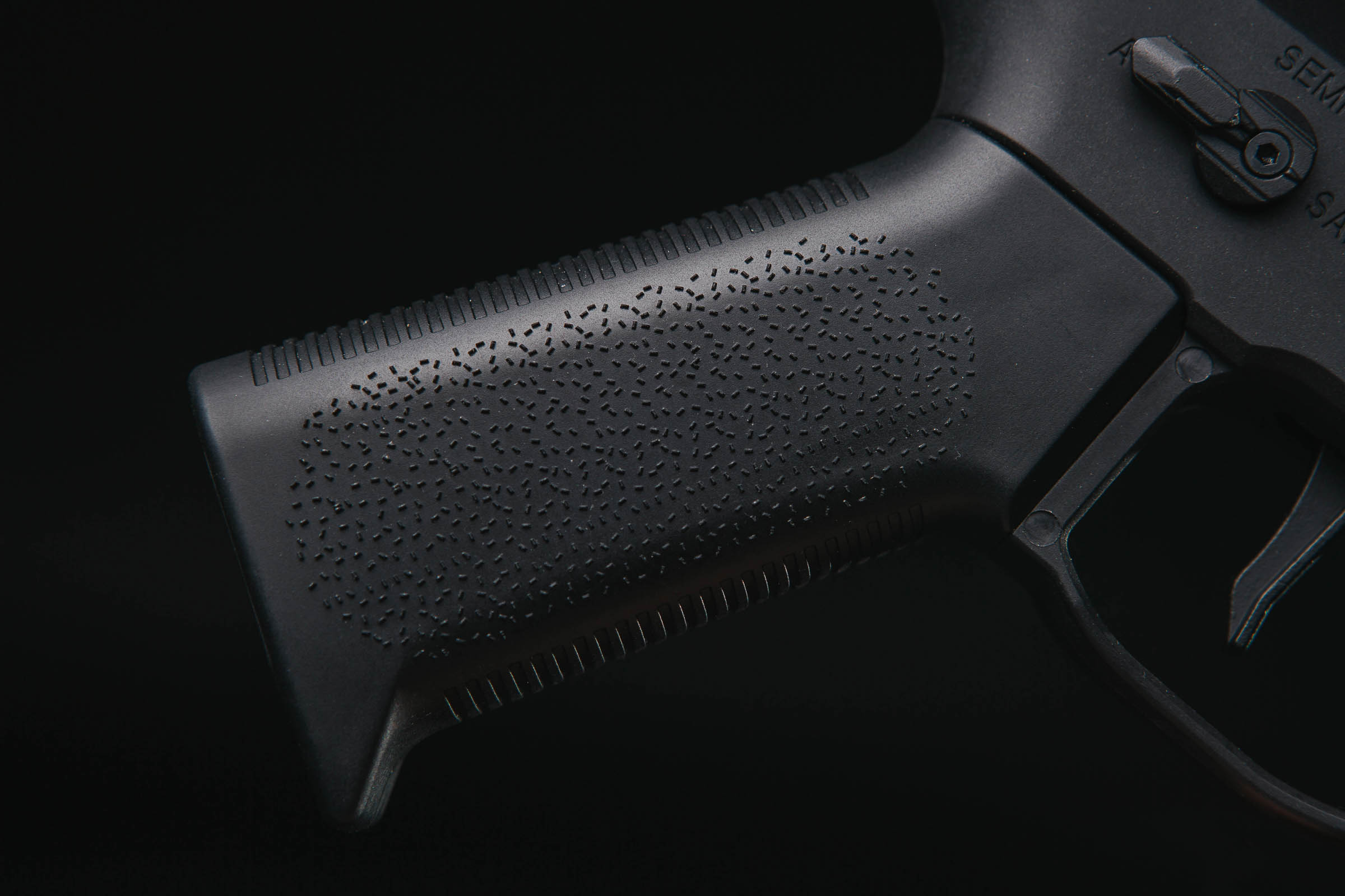

The pistol grip has no additional finger support. Both its front and read surfaces are grooved, and the side surfaces are covered with something similar to stippling but texture is given in during the injection process, and not during subsequent stages of production. The bottom plate is made of metal (ZnAl) and has a large screw to adjust the position of the motor with a head for a flat screwdriver.

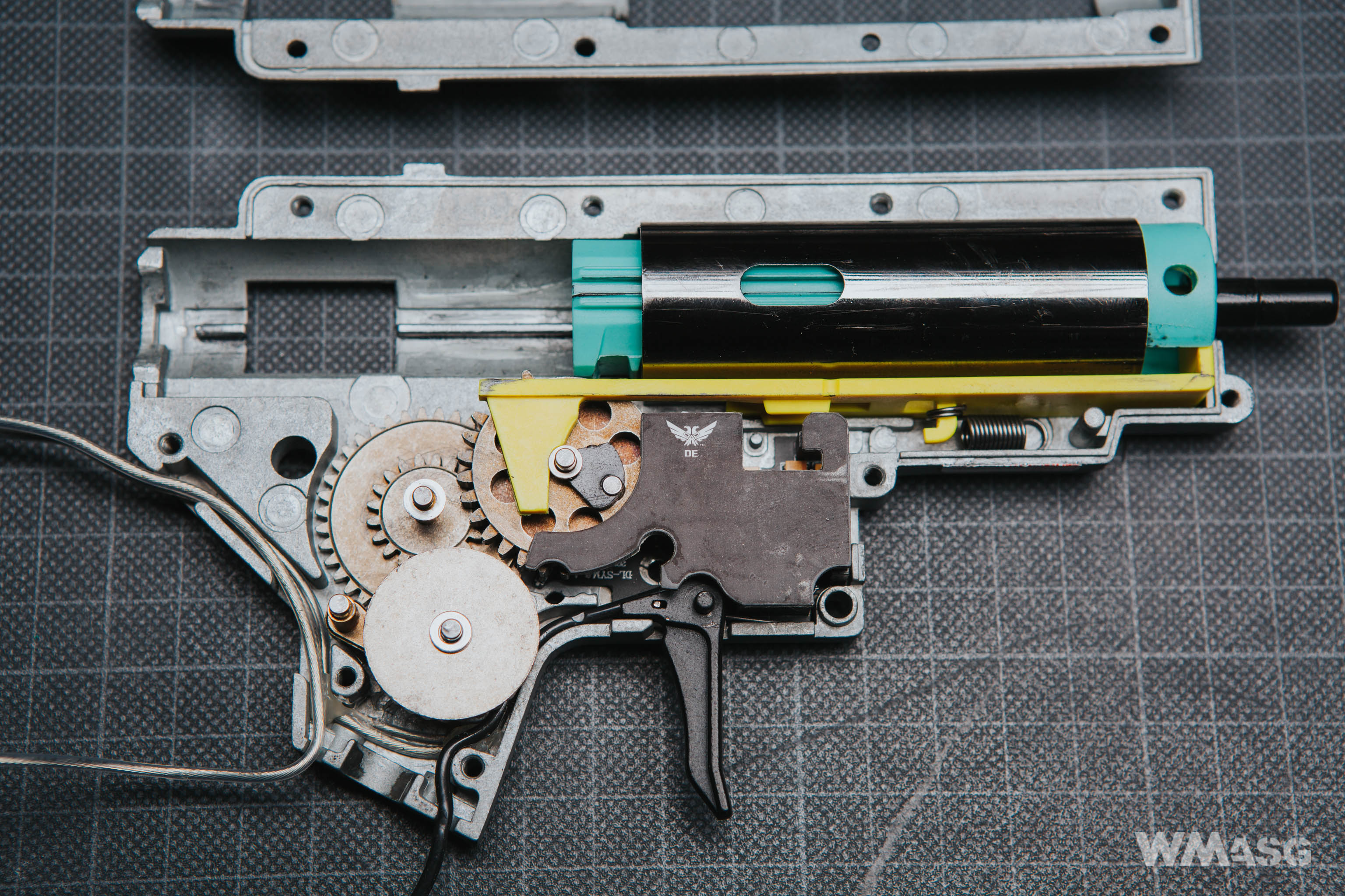

All M90X replicas are driven by the same mechanism based on a standard V2 gearbox with a quick spring change system that can be done from the outside, without opening the replica. However, it is necessary to disassemble the stock and the buffer tube.
Inside
The operation of the mechanism is controlled by the aforementioned Falcon programmable system, with which you can choose between SEMI/AUTO and SEMI/BURST firing modes while setting the length of the BURST mode from 1 to 5 shots. When we set BURST to 1, the replica will fire with single BB in both selector settings (SEMI/BURST), unless we also turn on the double-shot mode, then in the SEMI position with shoot 2 BBs in each cycle: the first one when pressing the trigger, the second one when releasing the trigger, and in the BURST position it will shoot only one BB.
The third adjustable parameter in the Falcon is the trigger pull with 3 settings: standard, short and very short. In combination with a vertical "quick" trigger it works really well.
The system is programmed with successive trigger pulls and each setting is confirmed with the safety/selector switch. Detailed instructions are attached to the replica and at the Taiwangun website there is also a short instructional video showing exactly how to do it.
In addition to the features described above, Falcon has several other functions. First, it tracks the operation of the sector gear (cycle control) and always stops the mechanism with the piston in the front position. And besides that, it is also a mosfet and an advanced voltage cut-off fuse when something bad happens with the replica or the battery.
The design of the system itself is obviously nothing revolutionary and replicates the already known solutions, but it is worth noting that the Falcon system has no mechanical parts as the position of the sector gear and the movement of the trigger and the selector plate are monitored by optical sensors. And while testing it with a flashlight from different angles, we were unable to activate the system without pressing the trigger, which, unfortunately, happens to the products of some other manufacturers.
On the mechanical side, the gearbox is typical for mid-price range replicas. Of the reinforced parts, we only have a ball bearing piston head and a ball bearing spring guide. The piston has three steel teeth and is made of the same material as the cylinder head and is also equipped with a solid bumper. The gears are set in 9 mm bearings are made of sintered steel. The bevel gear is set in ball bearings, other wheels are set in plain bearings. The nozzle has no o-ring. Low resistance wires and a factory-fitted DEANS plug deserve praise (hence the presence of a battery adapter with a small Tamiya plug included). Assembly and fitting of parts is at an average level. The gears' shimming could be slightly improved and the lubrication of the gears and the cylinder system could be slightly better, but this is common in replicas from this price range.
The whole mechanism look identical the one used in the Poseidon branded replica of the Punisher series:
