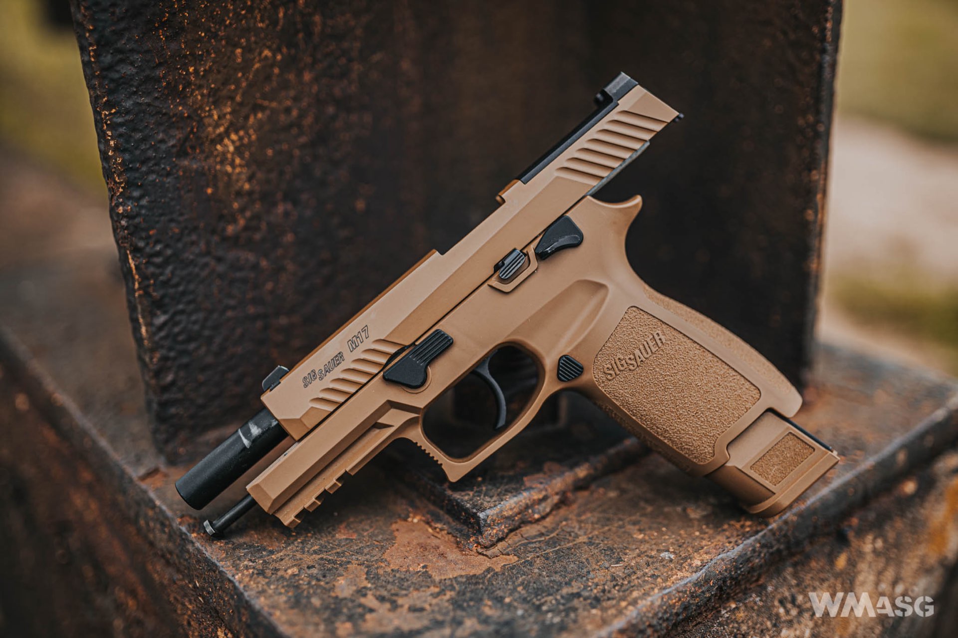

The M17 is a pistol with a polymer frame. Interestingly, in the original, the frame is not an "essential part of the weapon" this is why to adjust the size of the grip to the size of the hand, in the SIG one does not replace the back of the grip but the entire frame. There are 3 sizes of frames in 3 colors and they can be purchased as an interchangeable accessory. The replica is available only in one size.
The numbered, so-called "essential part of the weapon" in the M17, is the complete, closed trigger module. Of course, the number must be visible from the outside, and that is why on the right side of the M17, a port was made in the frame through which the number is visible. In the airsoft version of the gun, this detail is exactly the same, although the trigger mechanism is, of course , of a completely different design.
The 4.5mm airgun version, which we had also reviewed, looks much worse in this respect.
Next to the port with the number, there is the slide stop lever. Even further there is a thumb-operated safety switch. Of course, in line with modern trends, both manipulators are double-sided i.e. located on both sides of the gun.
It is worth paying some attention to the ejection port. The fact that the dummy extractor is a separate element and not a part of the slide does not come as a shock. But SIG has also reproduced the indicator showing if there is a round present in the firing chamber. This little "thing" is movable and moves with the movement of the slide.
The front and back of the slide are typically serrations to facilitate reloading. The rear plate and the screw holding the parts of the extractor were also properly reproduced and were also missing in the mentioned 4.5mm version.
The sights are fixed (non-adjustable) front sight and rear sight, typical for military weapons. Contrasting white dots were painted on them to facilitate aiming in poor visibility conditions. However, this is just plain white paint and the dots do not glow in the dark.
In the original, the black plate on the upper part of the side can be replaced with the base for a micro-collimator. In the replica, the plate can also be removed (along with the rear sight), but there is no proper and stable positioning of the base. And so far we have not found information about the availability of a collimator base for the airsoft version of the pistol.
On the left side of the slide, apart from the doubled safety switch and slide stop, there is also a rotary locking lever. This lever is, of course, used to disassemble the slide but luckily, and here we would like to thank the replica's designers, the slide needs to be removed only for maintenance.
