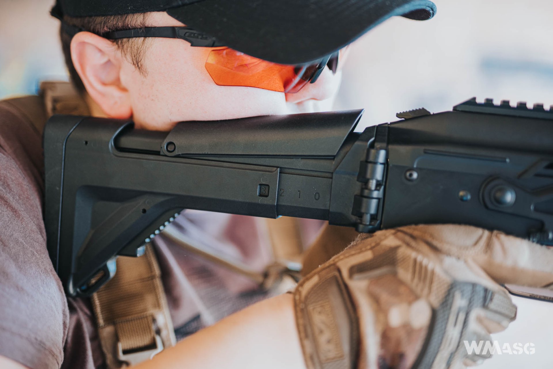

The aforementioned stock looks a bit like the ACR (Masada) and the Zhukov stock from the current Magpul's offer. Its a passing resemblance. On the other hand, it is an ICS stock transferred directly from the ACR-like replica of the CXP-APE, which has been produced for several years now. Magpul, advertising the Zhukov stock, said that it was designed to fold over to the right side due to the Dovetail mount and the optical sights attached to it (original Russian stocks folds to the left - if anything is mounted on the mount, it cannot be folded). There is no Dovetail in the ARK.
The stock, like the original Zhukov, is mounted on the extension of the barrel axis (as in the ARs). This makes it easier to keep the weapon on target. It does not matter much in airsoft, but it is worth mentioning. The stock has 2 adjustment options. The first is the cheek pad with 5 height settings. The second is a telescopic length adjustment (6 settings).
ICS CXP-ARK
We have a few reservations about the stock. The first is the material. The black plastic it is made of seemed too soft. Nothing has been broken during our test but the material is noticeably bending with enough force applied.
The second reservation concerns the risk of damaging the power wire that exit the carbine's receiver and enter the stock. ICS uses stiff wires therefore one has to be careful when putting the stock back into shooting position.
ICS CXP-ARK
The third thing is the cheek pad adjustment. There is no limiter. If one does not count/feel the settings, the pad can be pulled off the adjustment notches will move freely on the hinge. In practice, this has happened to us every time.
ICS CXP-ARK
The fourth thing is the length adjustment. As in the case of the cheek pad, there is no limiter therefore it's very easy to pull the stock beyond the usable range and stay with it in your hands. The matter is further complicated by stiff and long wires.
The last thing is the rubber butt plate. It is simply a piece of rubber placed over the stock. We have our doubts weather it will be ease to loose it in the field.

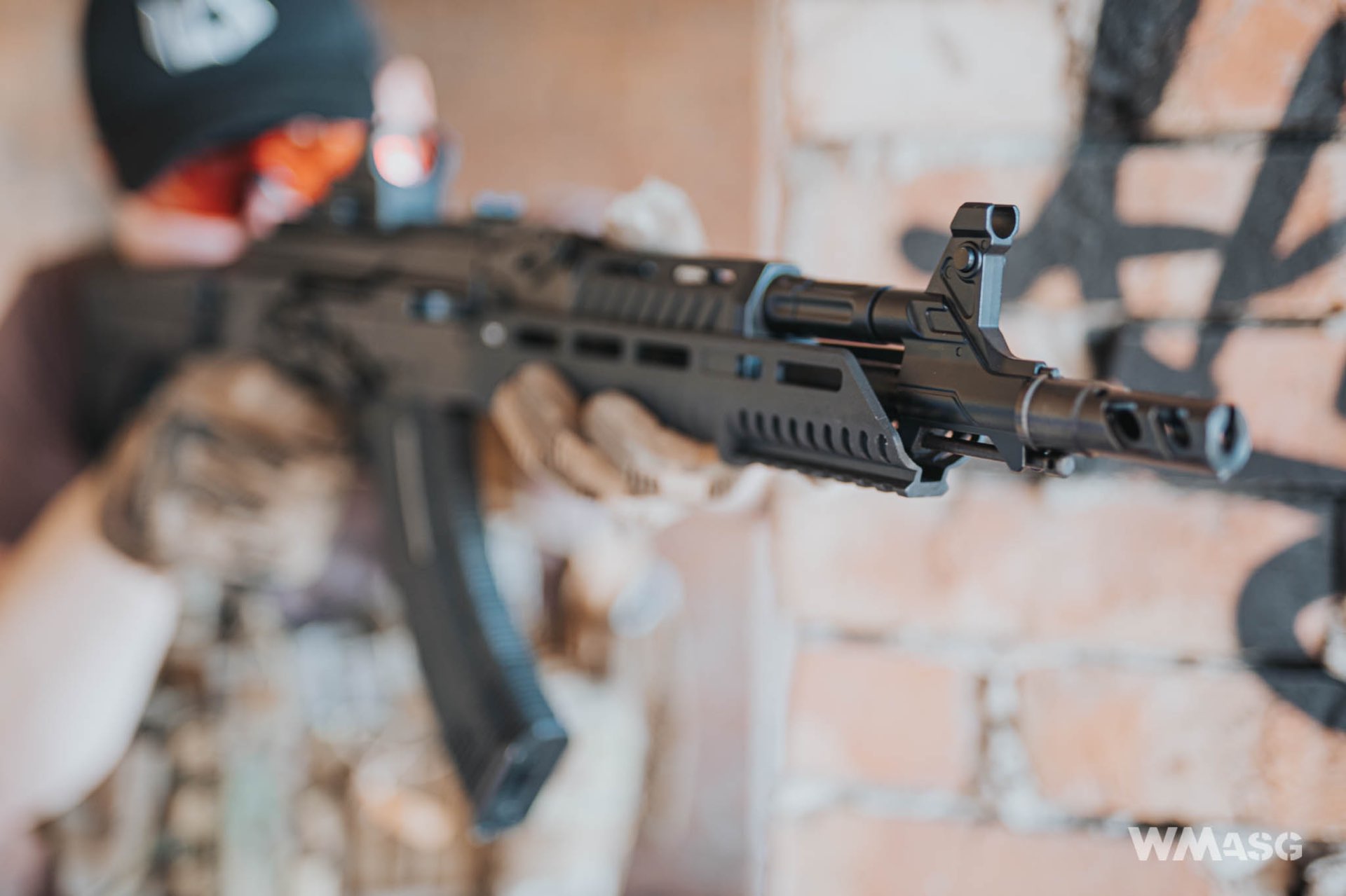

The polymer handguard is made in the M-lok standard - it even has appropriate markings. It is made of the same material as the stock and it also felt a bit too soft for us. The shape is similar to the stock and the grip brings to mind a the shortened version of Magpul's Zhukov-U model. Nevertheless, both the handguard and the gas tube cover are original ICS designs and are only similar to Magpul products.
ICS CXP-ARK
M-lok sockets are located on the sides of the handguard and on the top of the cover. Additionally, at the bottom of the handguard there is a short, 8-slot Picatinny rail. The cover with the gas tube has a standard length of 17 cm. The handguard, due to the way it is connected to the receiver, is not compatible with replicas from other manufacturers.

The gas block, as in comparable carbines, is also the basis of the front sight. ICS is consistent in its approach to the design of this replica as this part is also completely non-standard. The closes thing to it is the Colombian Galil ACE gas block but in fact it's just an impression. Both parts are not really similar at all.
ICS CXP-ARK
ICS CXP-ARK
The front sight is adjustable vertically in an almost traditional way. Almost, because the right side of the dummy "barrel" has to be press to do it. The key included with the replica is used for adjustment. The whole part is mounted freely on the barrel and secured from the bottom with a screw hidden under the 100% dummy cleaning rod, 215 mm long.
