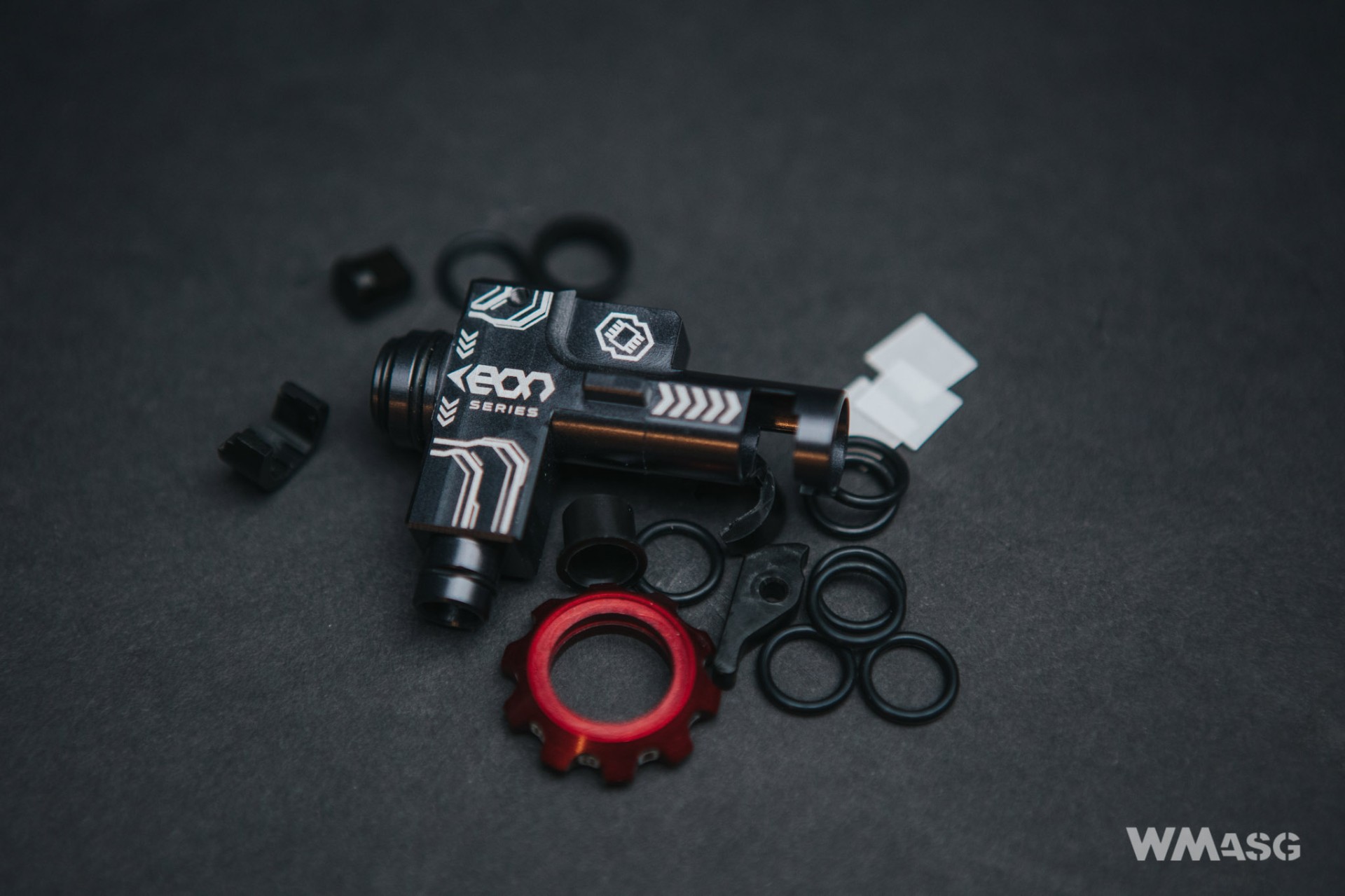

In the box we will find:
- Hop-up GATE EON chamber made of aluminum using CNC machining
- pressure arm made of POM using CNC machining
- 4.5 mm universal, double-sided spacer made of POM using CNC machining (for barrels with a standard and enlarged port)
- 6 mm R-Hop spacer made of POM using CNC machining
- an arm mounting screw
- stabilizing barrel latch (c-clip) made of POM using CNC machining
- stabilizing barrel latch (c-clip) made of POM using CNC machining - offset version for buckings with a longer collar
- barrel stabilizing sleeve made of POM using CNC machining
- nozzle sleeve for HPA engines made of POM using CNC machining
- 10 x o-rings replacing the classic spring (additional chamber stabilization)

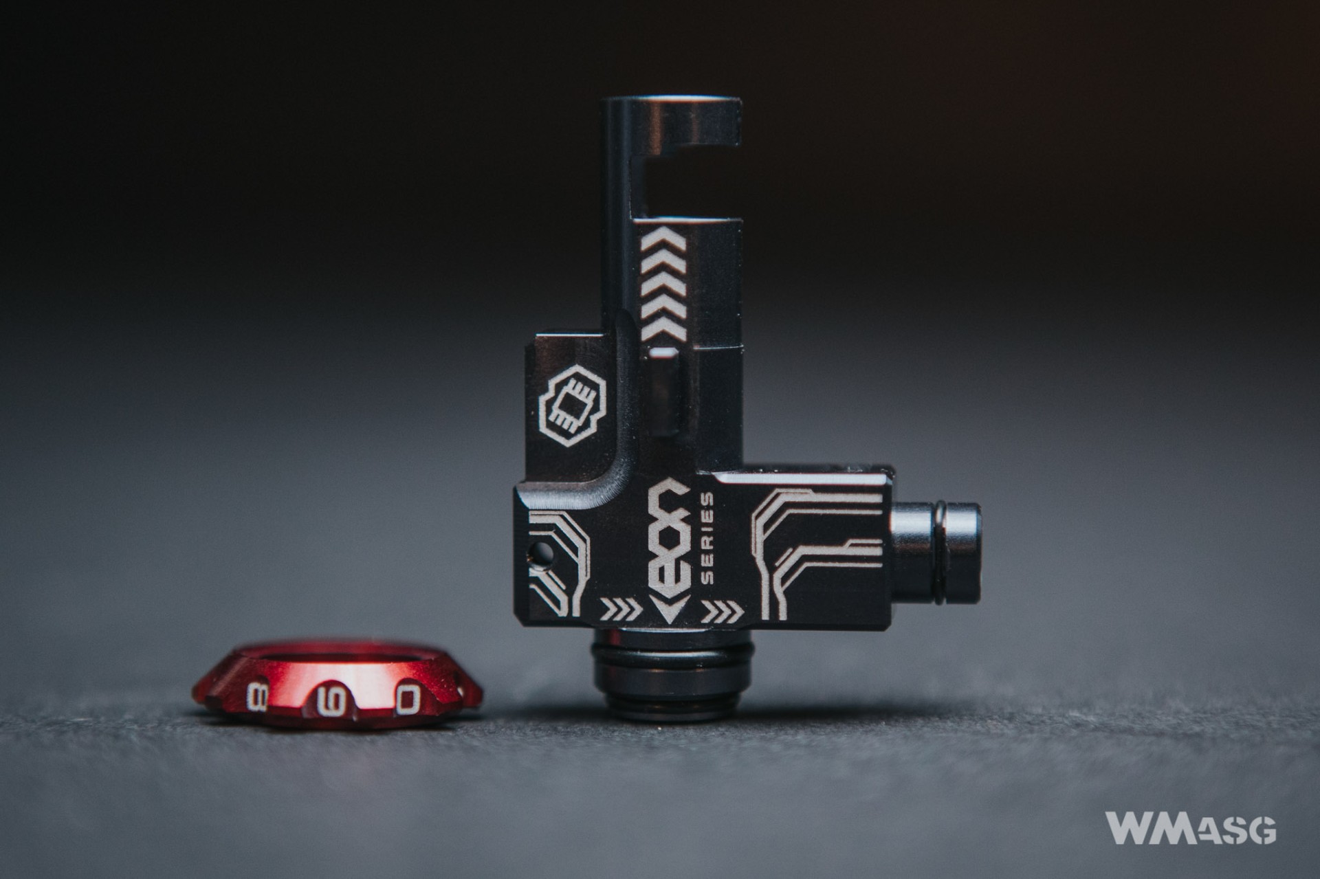

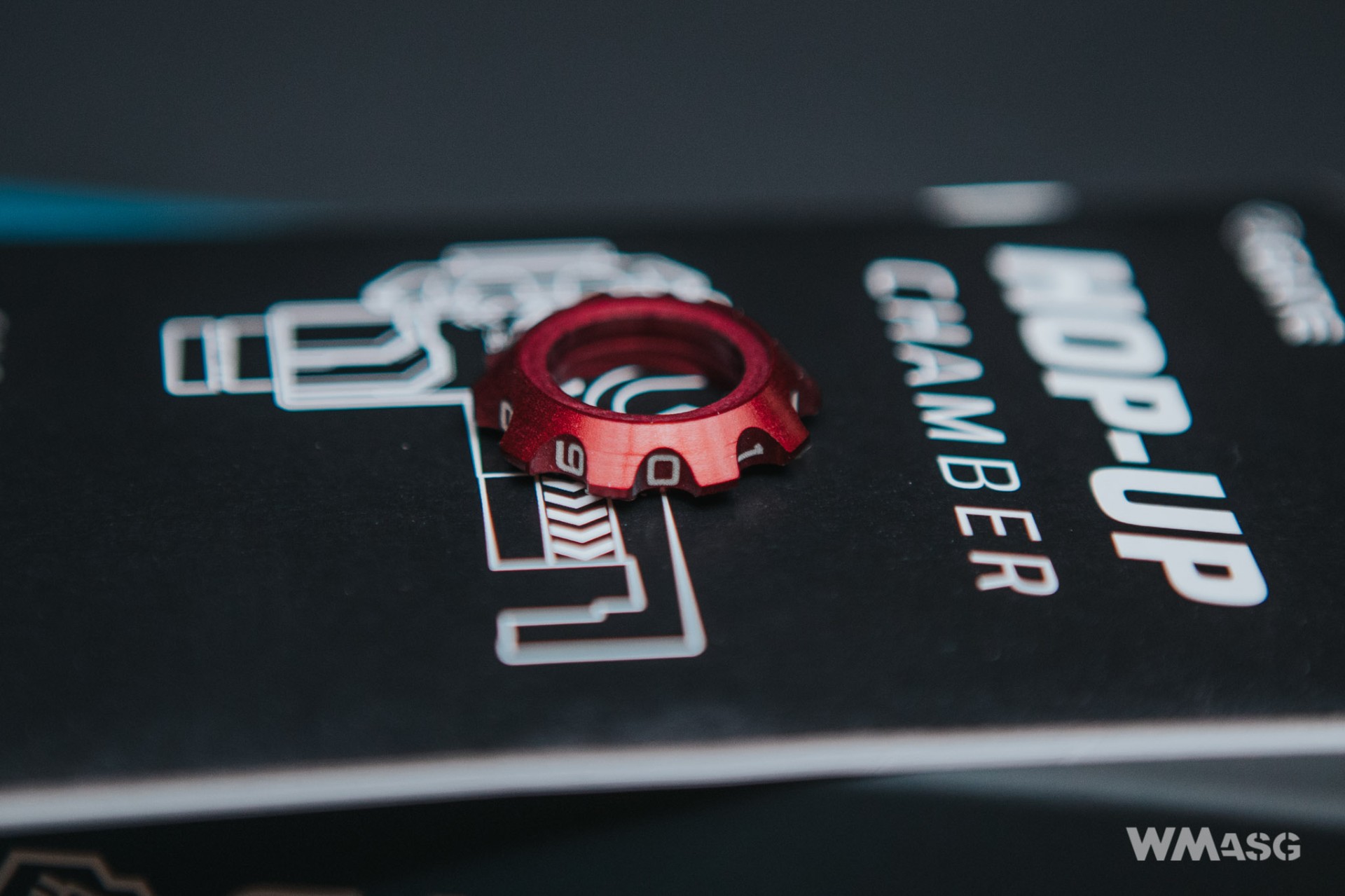

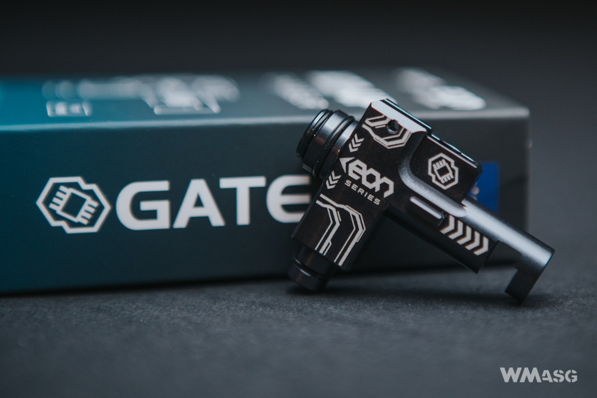

The chamber is made of aluminum using CNC machining. Among other things, it features the GATE Enterprise logo and the EON brand name. The markings are applied in a precise and visually pleasing manner. The adjustment wheel is also made of aluminum and has marked scale clearly visible to the user. It is attached to the chamber using an O-ring, which ensures the stiffness of the design and greater precision of settings. The use of this solution prevents the chamber from loosing its setting during shots. The adjustment wheel is available in a wide range of colors.
The set includes two types of barrel c-clips, which makes it much easier to adjust the barrel-chamber-bucking set. The c-clips added to the set provides greater product versatility, the additional c-clips is GATE's answer to users having problems with adjusting hop-up buckings due to the different lengths of the collars that they can have. Instead of a spring pressing the chamber to the gearbox, o-rings are used, which makes it rigidly pressed. The set also includes stickers for the chamber wings for better stabilization of the component in the barrel.
The set also includes two types of spacers:
- flat R-Hop 6 mm spacer only for barrels with an enlarged window,
- universal 4.5 mm clamp for flat omega spacers and round spacers popular in traditional chambers.
Nozzle sleeves for HPA engines are also included. They are made of POM (polycrystalline thermoplastic). This solution is intended to eliminate the effect of the mid-cap syndrome. The element is well-suited to the HPA Pulsar S engine from Gate Enterprise. Tests have shown that the use of this component does not completely eliminate the mid-cap syndrome, but it makes it easier to solve it.
The box also includes a POM sleeve that stabilizes the barrel. An external rim has been placed on it, thanks to which the o-rings evenly press the chamber to the gearbox and do not change their position. In the place where the chamber enters the gearbox there is a centering o-ring. In addition, an o-ring has been used to hold the BBs in place, which eliminates the effect of them falling out after removing the magazine.
