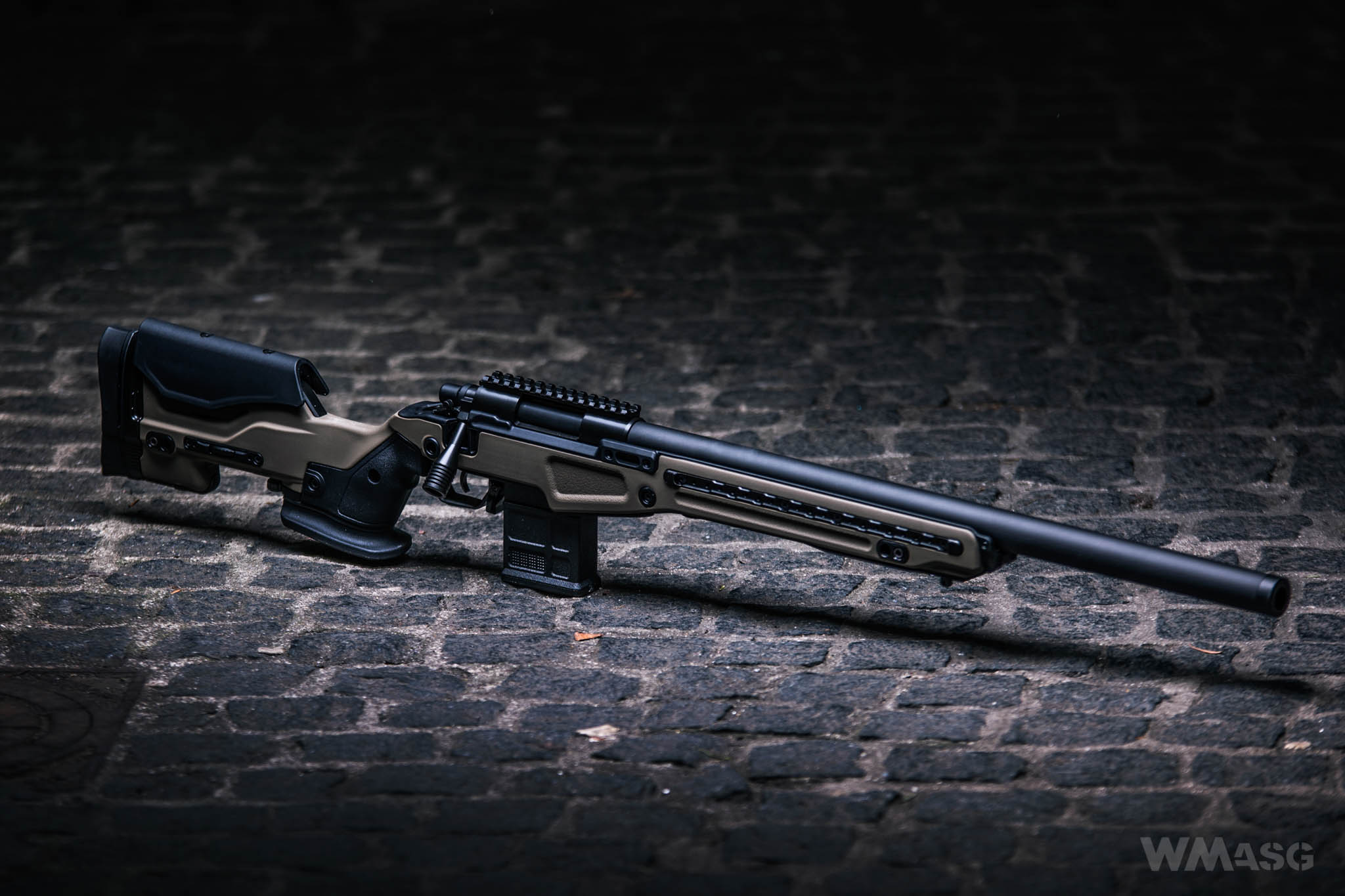

The T10 comes in a brown-grey cardboard box with black labels containing the description of the replica. On the top of the box is a small photo presenting the replica and a big logo of Action Army Company. The set contains a replica, a magazine, a fake magazine and a user's manual.
Action Army Company T10Action Army Company T10
First impression
The first impression after taking the replica out of the box is very good. A robust, compact design, a polymer which is pleasant to the touch and matte paint look excellent. All parts are very well fitted and we did not notice any slack. High ergonomics can be felt at the initial contact: the replica sits comfortably and firmly in one's hands. Its aggressive design and materials used in it production it does not resemble a toy gun at all.
