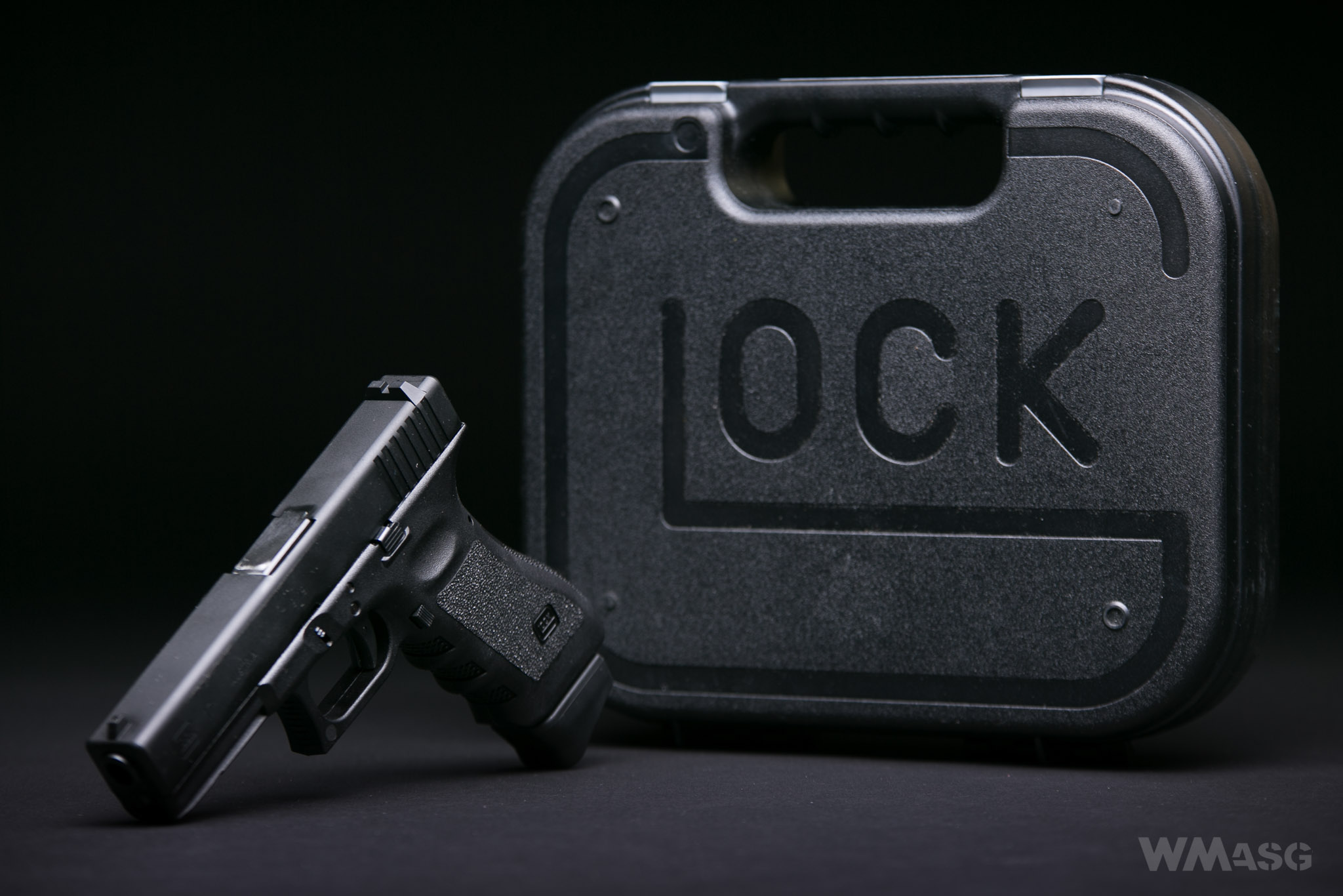

First impression

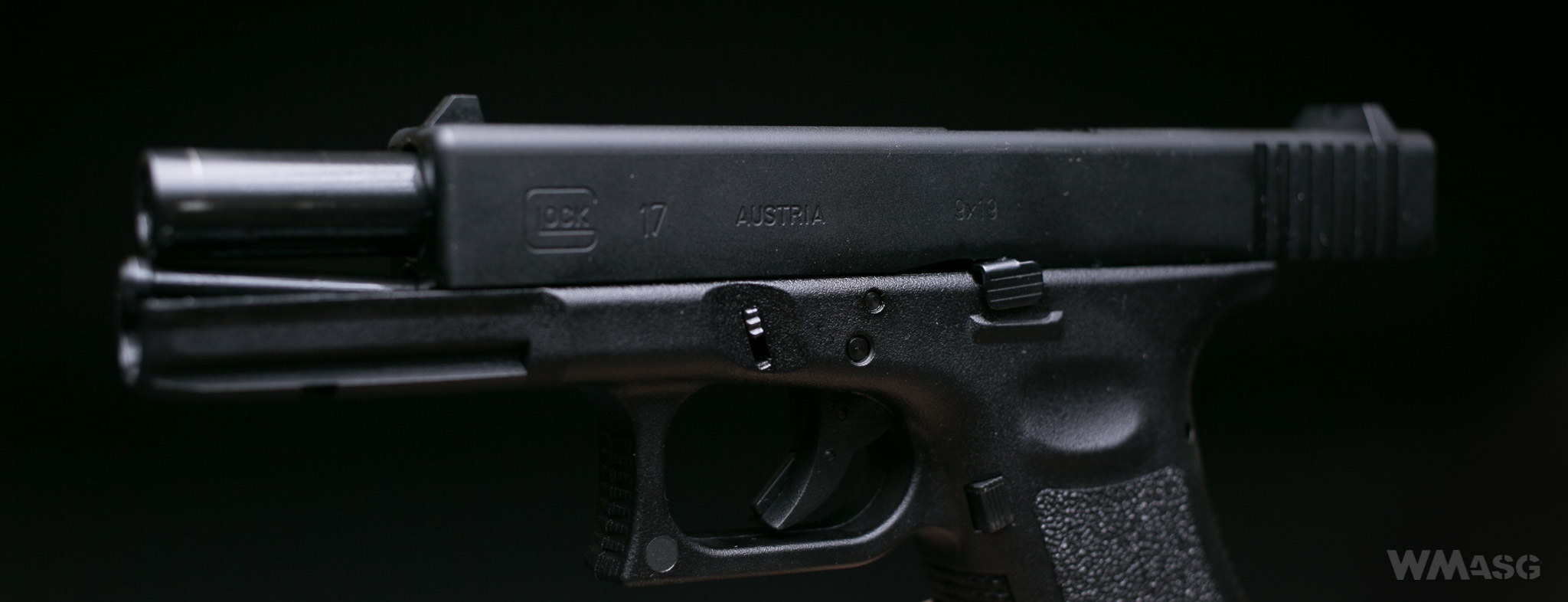

Thanks to the official Glock license, the VFC Deluxe version is delivered in a black plastic case filled with sponge foam, exactly the one used to sell the real firearm in. After taking the replica into ones hand, you get a brief the impression of holding a real gun. The plastic, from which the pistol grip is made, ideally imitates the one used in the real firearm. The metal slide made using CNC technology also makes a very good impression: there is virtually no slack and you can feel the resistance of the return spring during reloading. This special design of the return mechanism perfectly imitates the work of the slide - this impression is difficult to describe, you just have to try it.
The version by KWC is slightly less outstanding, but also cheaper. The replica comes to us in a gray and black box with the Glock logo on top. The plastic the frame is made off looks quite good, it does not differ much from the Deluxe version. The main difference in the material used for the slide: it can already be seen in the texture of the paint, but the most noticeable is the difference in the workings of the slide. However, it should be noted that both versions present a very high level of workmanship and, compared with other replicas available on the market, they perform much better.

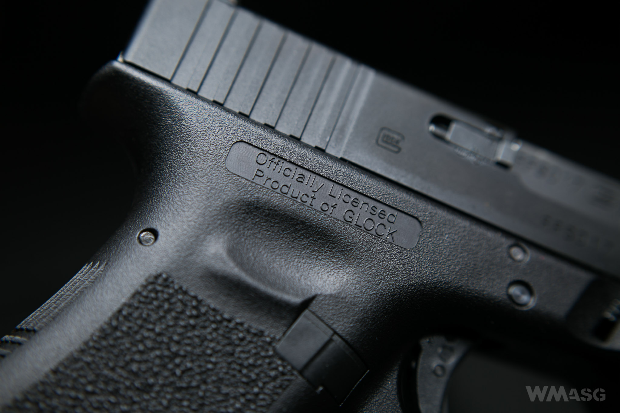

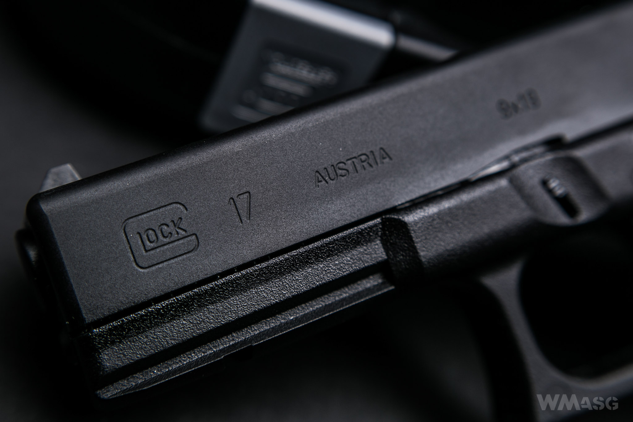

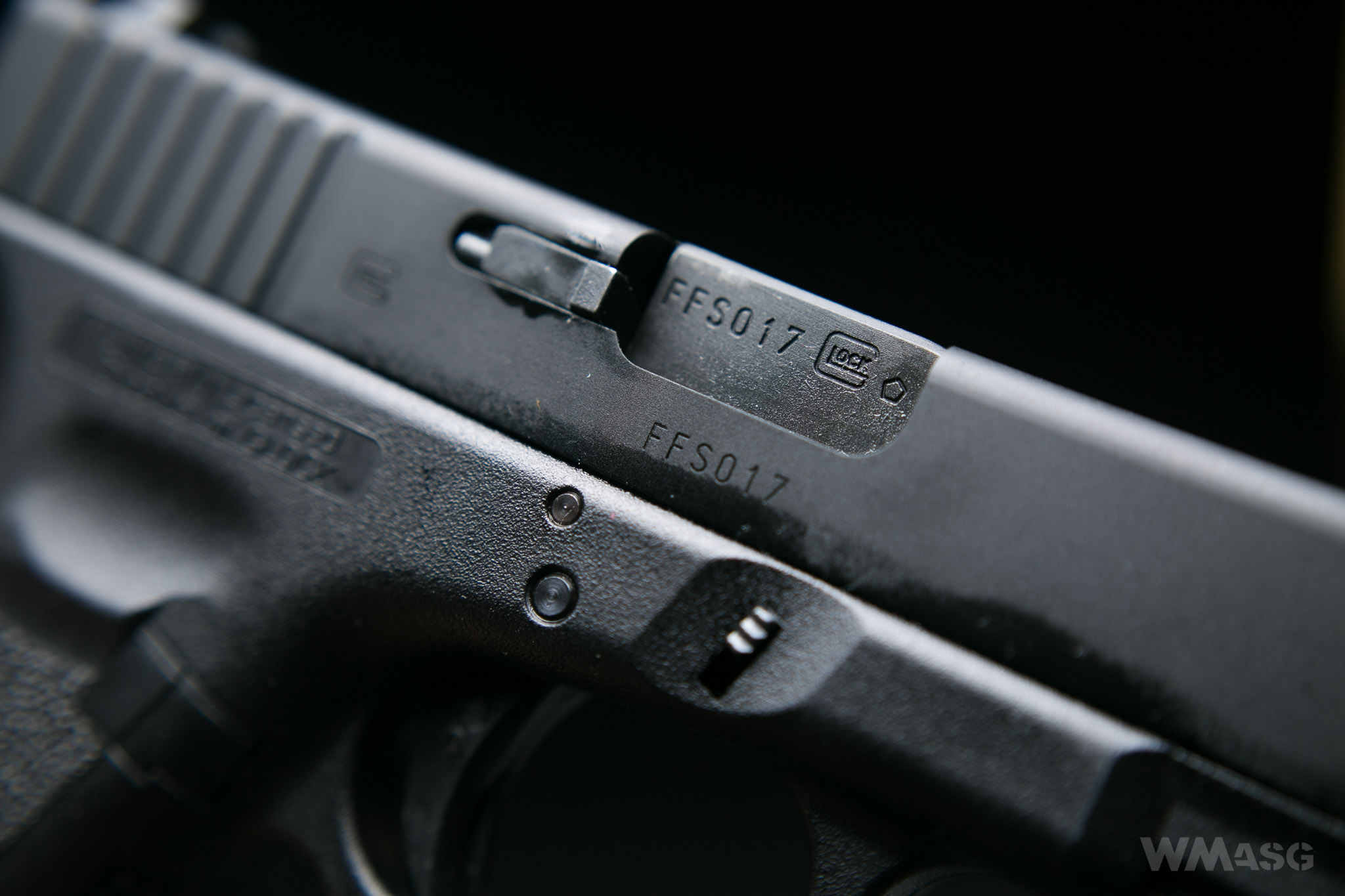

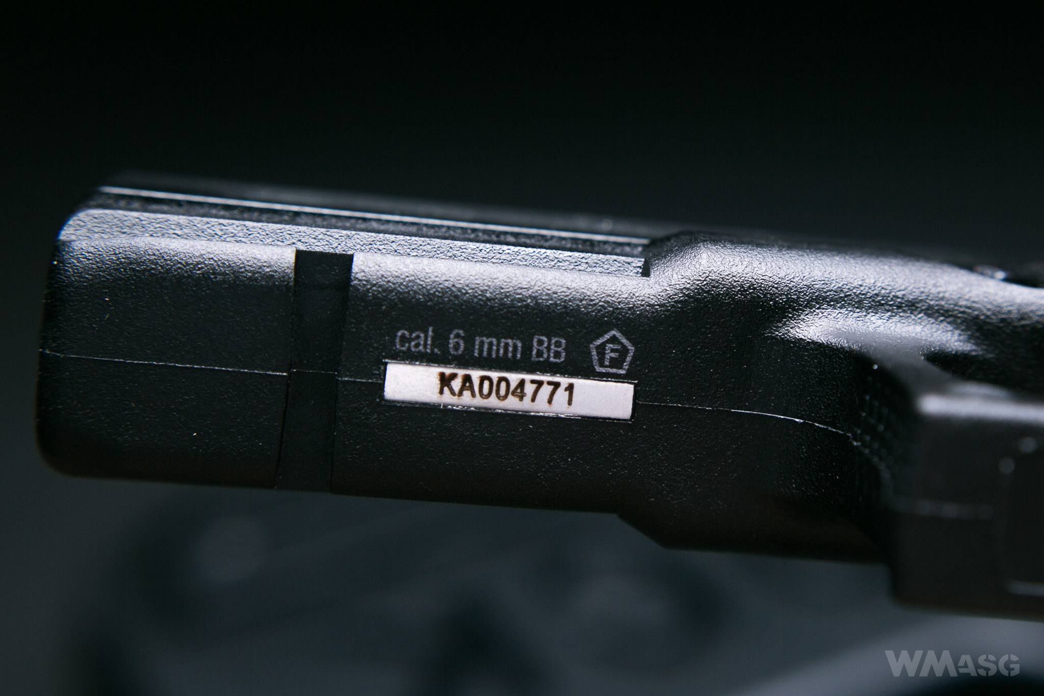

All replicas of the gun from Umarex have full, licensed Glock markings. We will find almost all the elements present in the real firearm: the company's logo on the slide together with the version designation and the standard AUSTRIA note, the markings on the ejection port, corresponding to the ones on the slide and the Glock logo on the pistol grip. An addition, thanks to which we can distinguish the replica from the firearm, is the marking Officially Licensed Product of Glock which replaces the original MADE IN AUSTRIA. It is situated above the pistol grip.

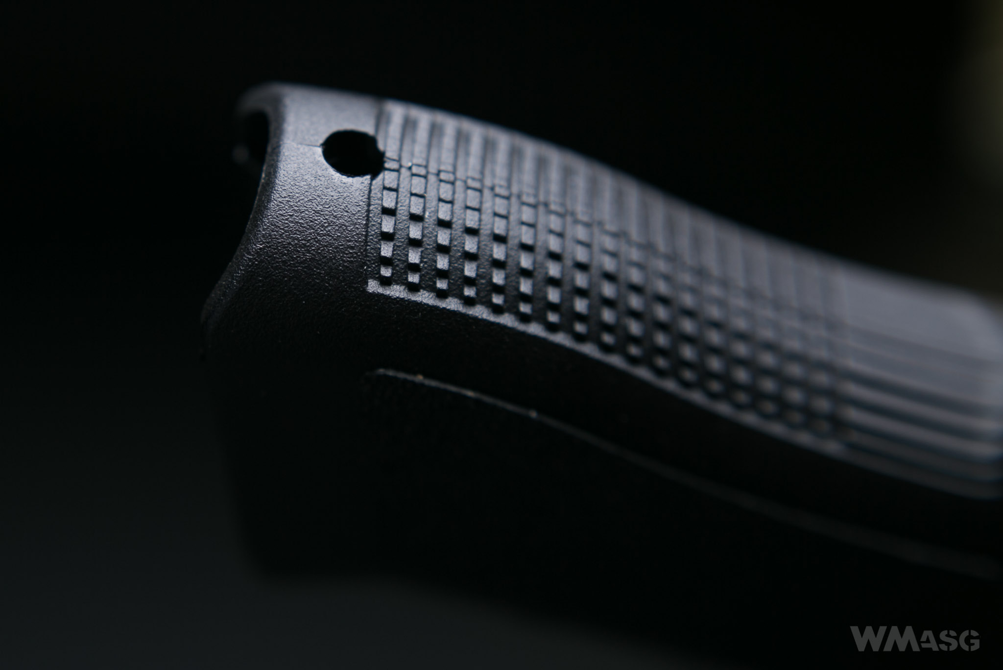

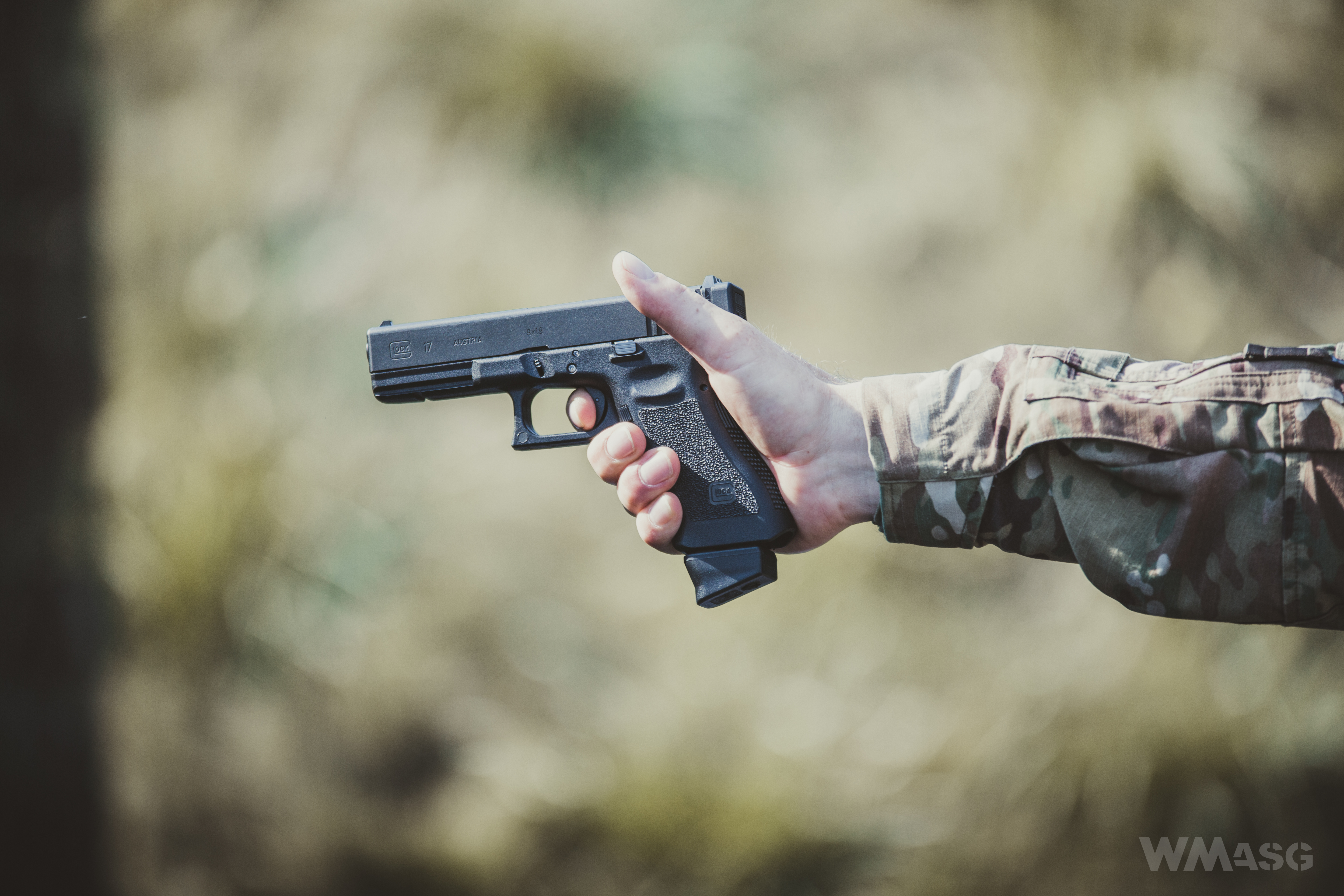

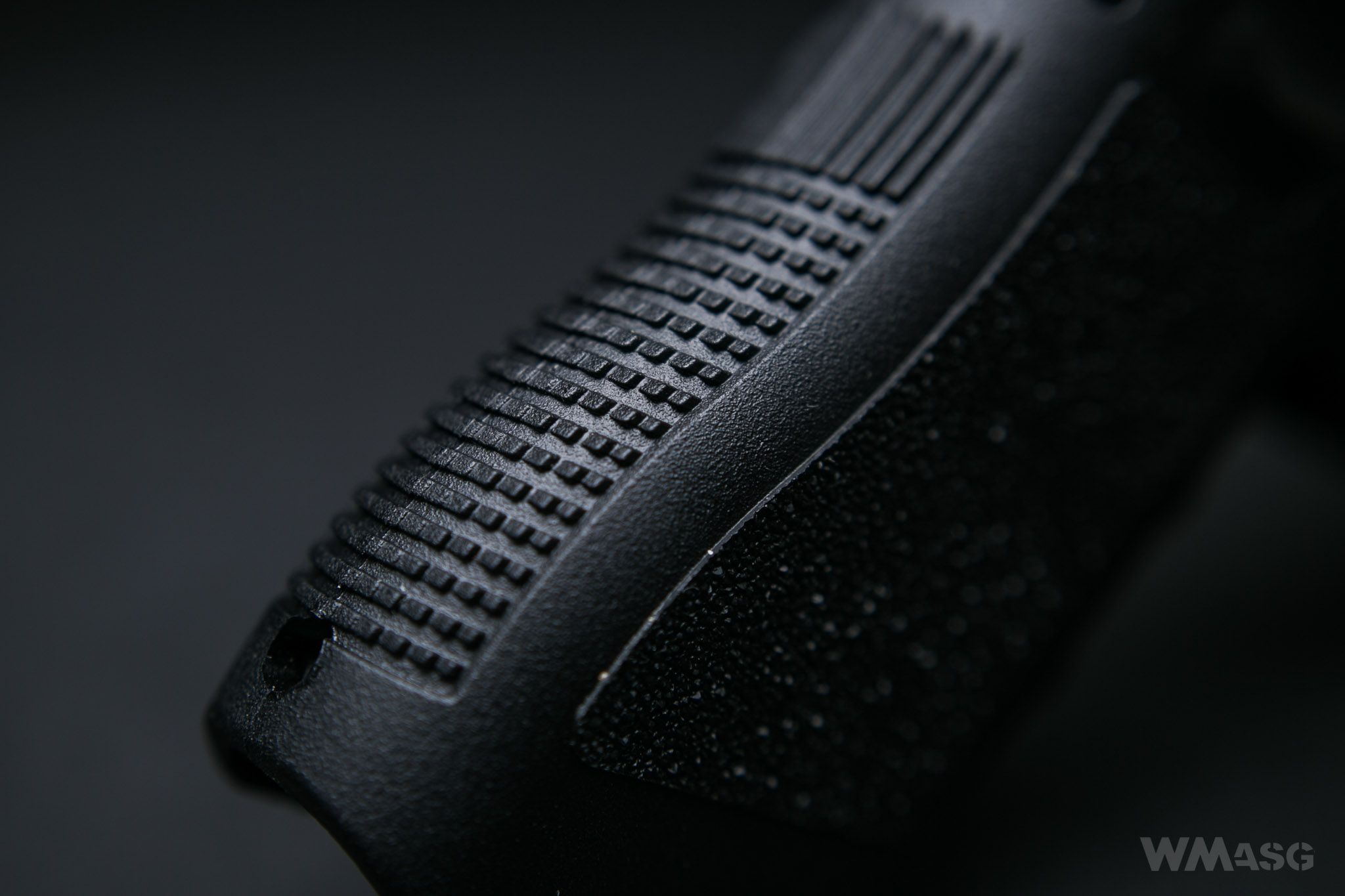

The pistol grip has a anti-slip texture on the sides, reminiscent of Stippling or sandpaper. At the front and back of the grip we can also find anti-slip texture, in the form of small ribs. In addition, the grip on the front has two ergonomic nubs. It should be added that in the case of generation IV Glocks, there is an option of replacing the rear part of the grip to better adjust it to ones hand.

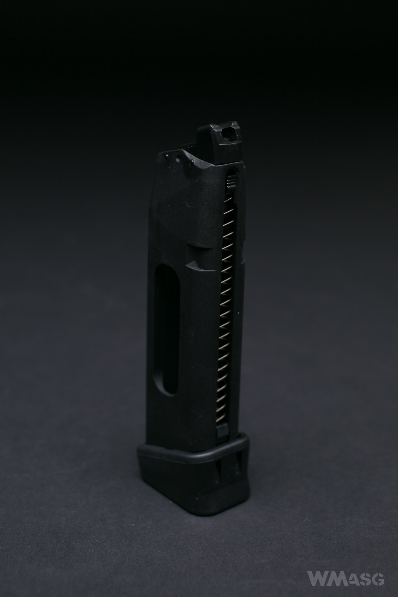

The magazine

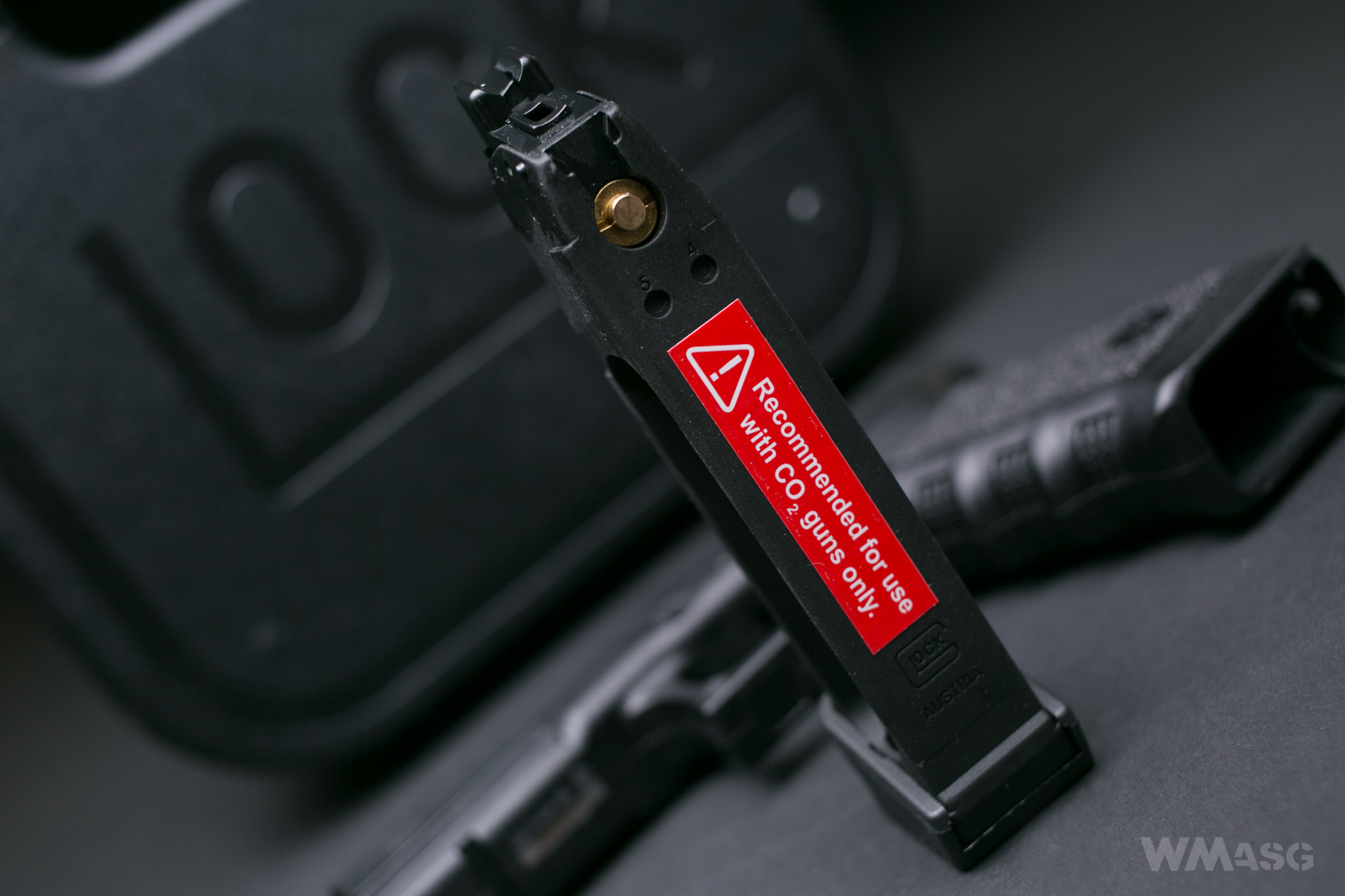

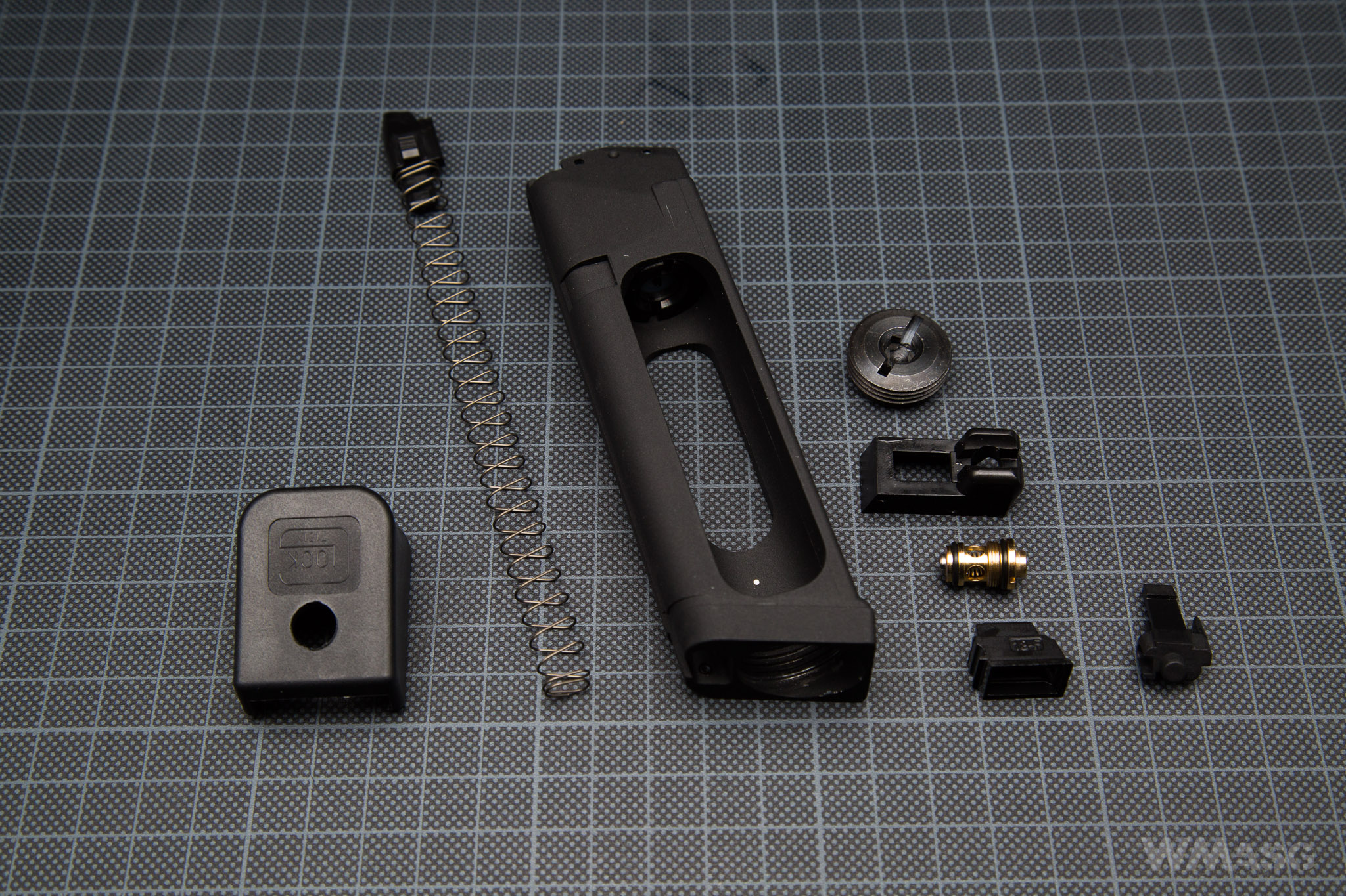

The metal magazine holds 25 BBs. The replica is powered by CO2, and the gas capsule is placed in the magazine by unscrewing a screw, which is located under the plastic floor of the magazine. We can load the gas capsule in two ways. One of them is to insert it from the side, unscrewing the screw with an Allen key through the hole in the bottom of the magazine. Another method is to insert the capsule from the bottom by pulling off the plastic floor, pulling up BB feeder spring and then unscrewing the bottom screw. On the back of the magazine there are imitations of the holes showing how many rounds are left in the magazine, and under it, a small Glock logo. The magazine is gas tight, we did not notice any leakage on in the magazine or the valves. As the replica is made using the TM standard, getting a spare magazine that fits the replica should not be a problem.

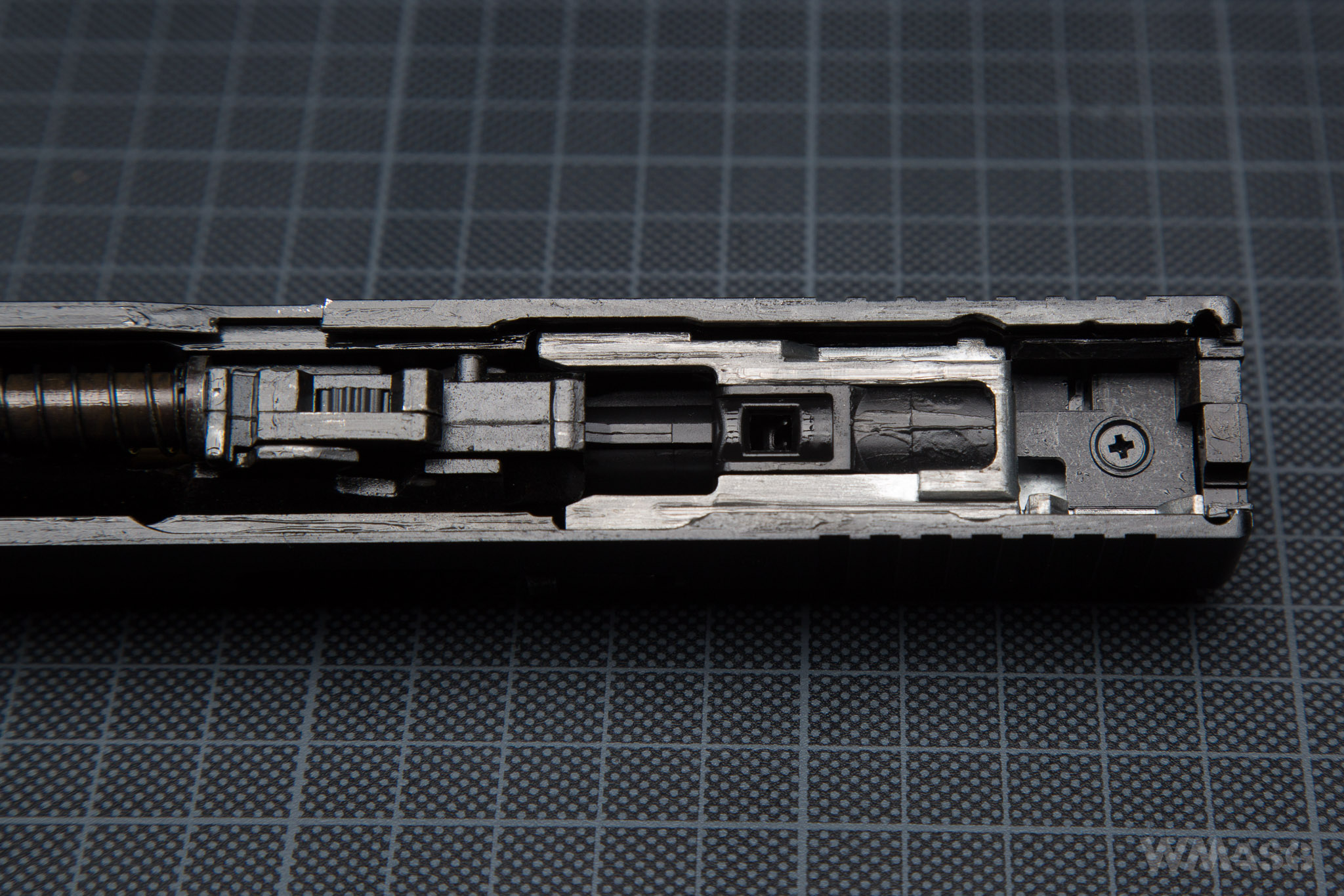

The first stage of taking the replica apart is the same as in a real firearm: you pull out the magazine, pull the slide lock down and pull the slide forward. Thanks to this, we gain access to the hop-up adjustment, which knob is located at the bottom of the slide. The first thing we notice is the spring of the return mechanism, or rather two springs on one guide, a feature present in the real firearm but other Glock models. Whereas a similar solution can also be found in CO2 Glock replicas by KWC, yet in the Deluxe version, the mechanism is much closer to the real one.

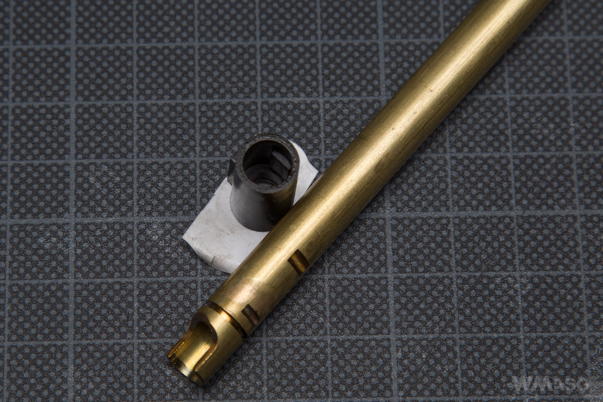

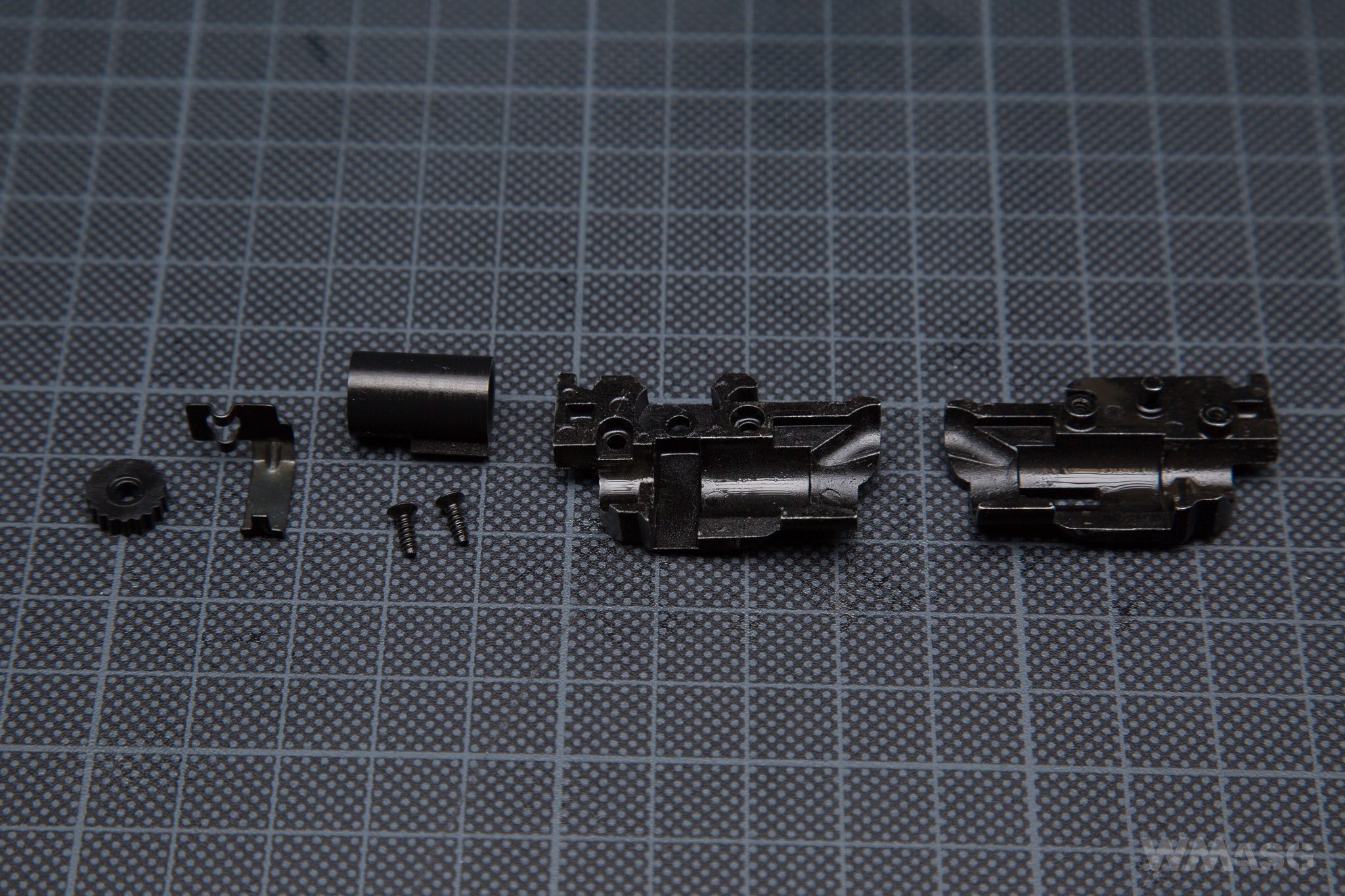

The hop-up chamber
To get to the hop-up, first disassemble the return spring and its guide. After pulling out the return mechanism, we can also pull out the outer barrel together with the chamber. Next, we can take up the chamber with the inner barrel from the outer barrel. The two part chamber is held together with two Phillips screws. After taking it apart, we gain access to the hop-up bucking and the inner barrel. The black bucking is of medium hardness with a standard spinning nub used in GBB type replicas.
Inner barrel

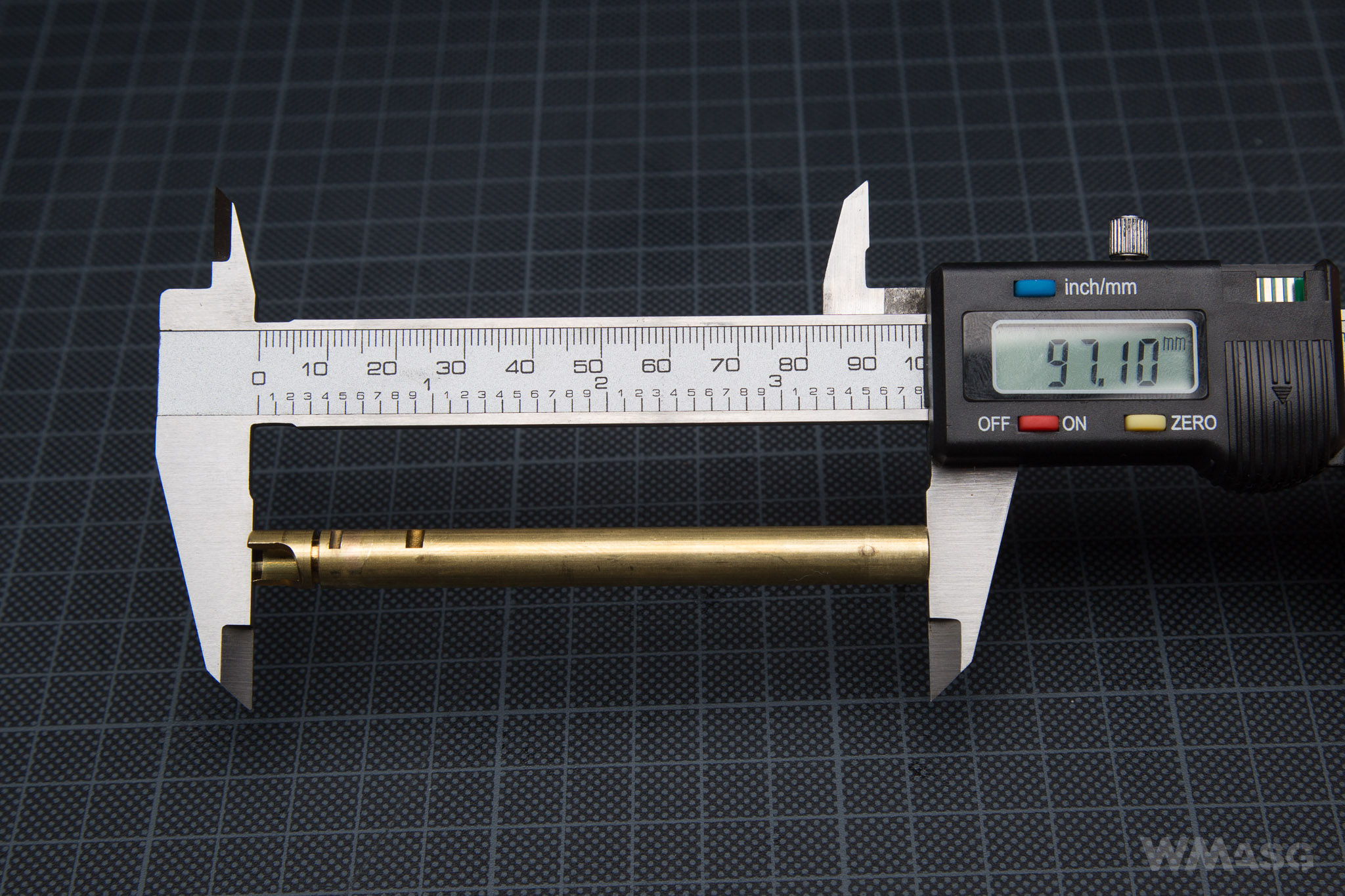

The brass inner barrel is 971 mm long and is beveled at the end.

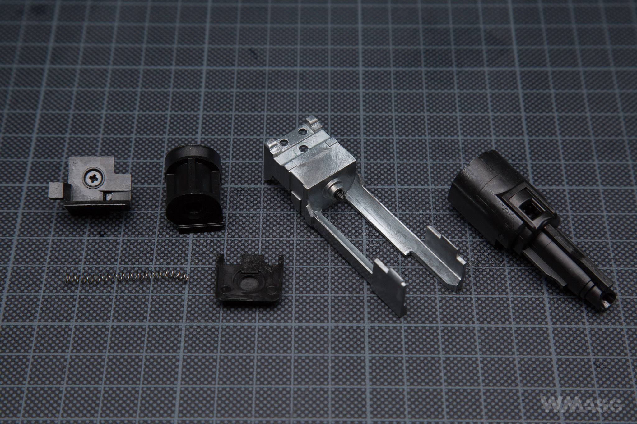

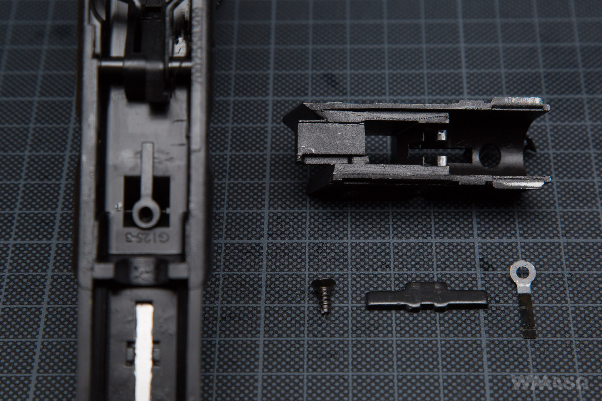

The nozzle, together with the guide and blow-back system, are made of plastic and metal. To get to them, unscrew one screw at the bottom of the slide and then pull the system out.

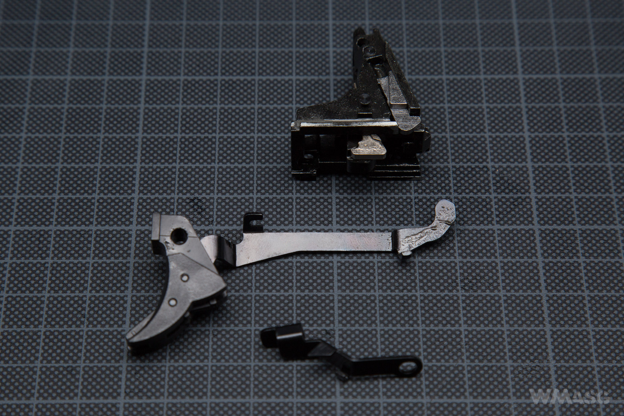

The trigger group

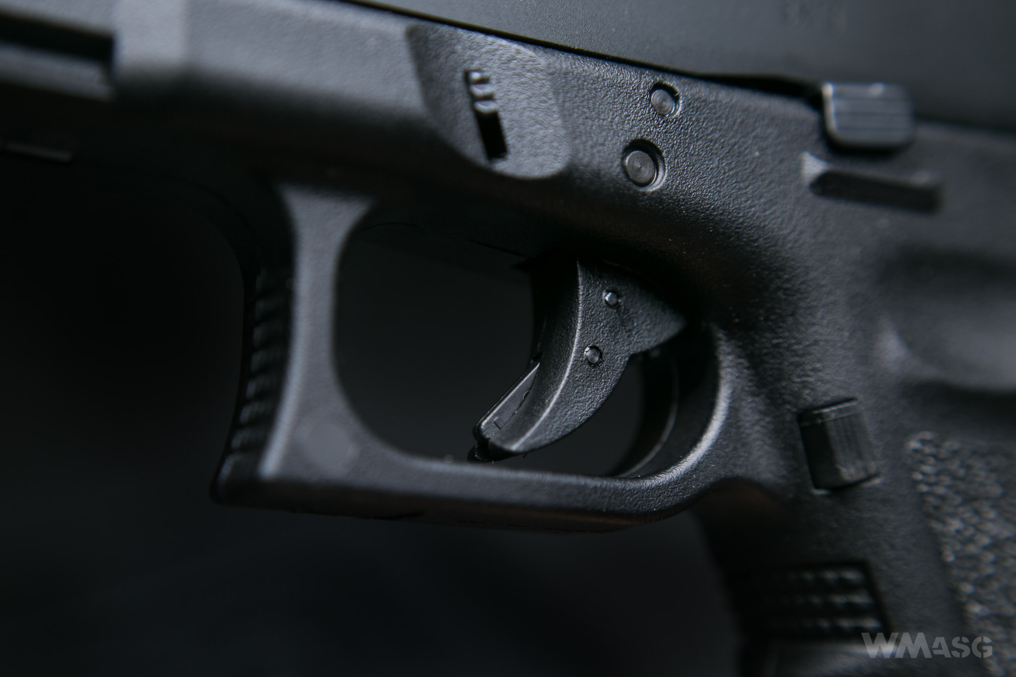

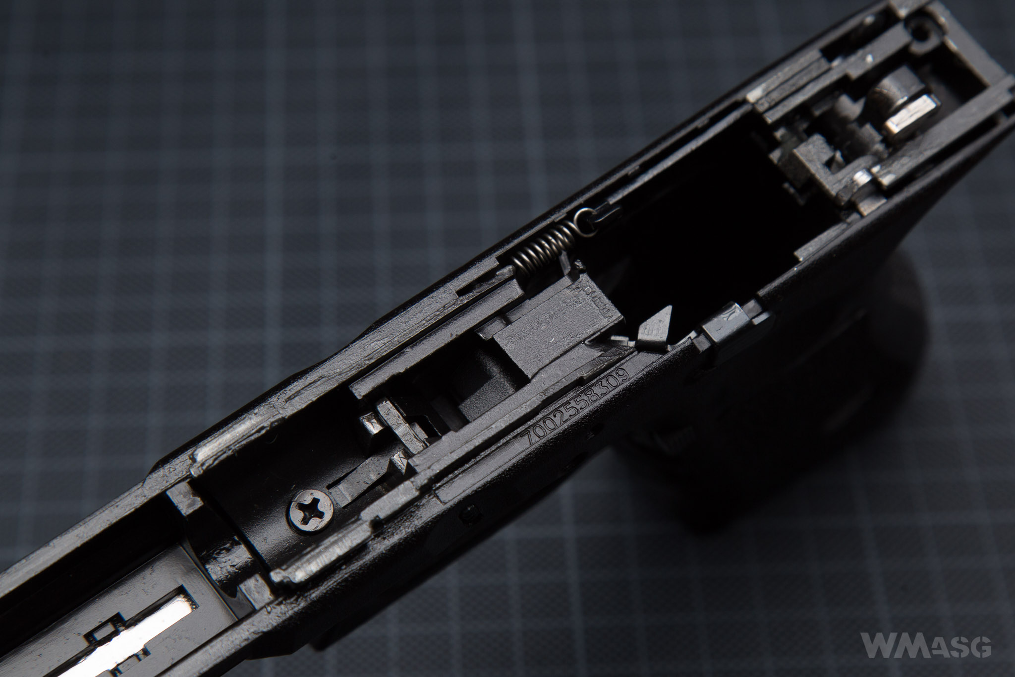

The entire trigger system is made of metal parts. To remove the trigger, unscrew one Phillips screw and then take out the pin located just above the trigger pin. Thanks to this, we can pull the part of the trigger system upwards, beforehand pulling out the slide latch.
In order to fully disassemble the trigger mechanism, it is also necessary to take apart the hammer system in which the steel trigger rail is mounted. We can do it by taking out the back pin and pushing the whole assembly up slightly. Everything looks very robust, so do not be afraid of damaging anything. In the event of a jam, you may suspect that there is some dirt in any of the systems. This should not be a problem for a trained technician to fix. Everything can be disassemble down to its basic parts, cleaned, lubricated and put back together. However, we suggest that you give your pistol to a professional service because you may have a problem with putting the replica back together.

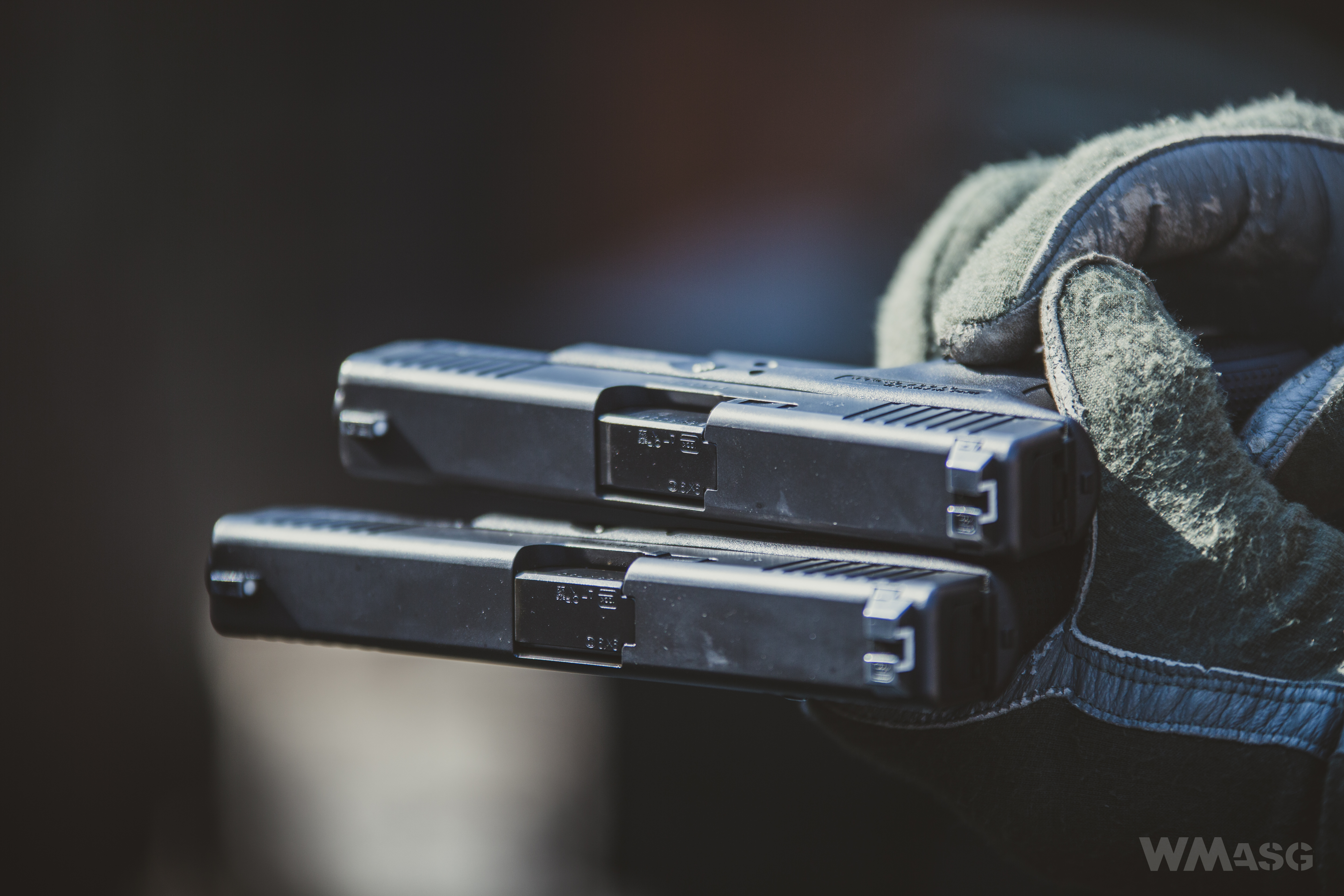

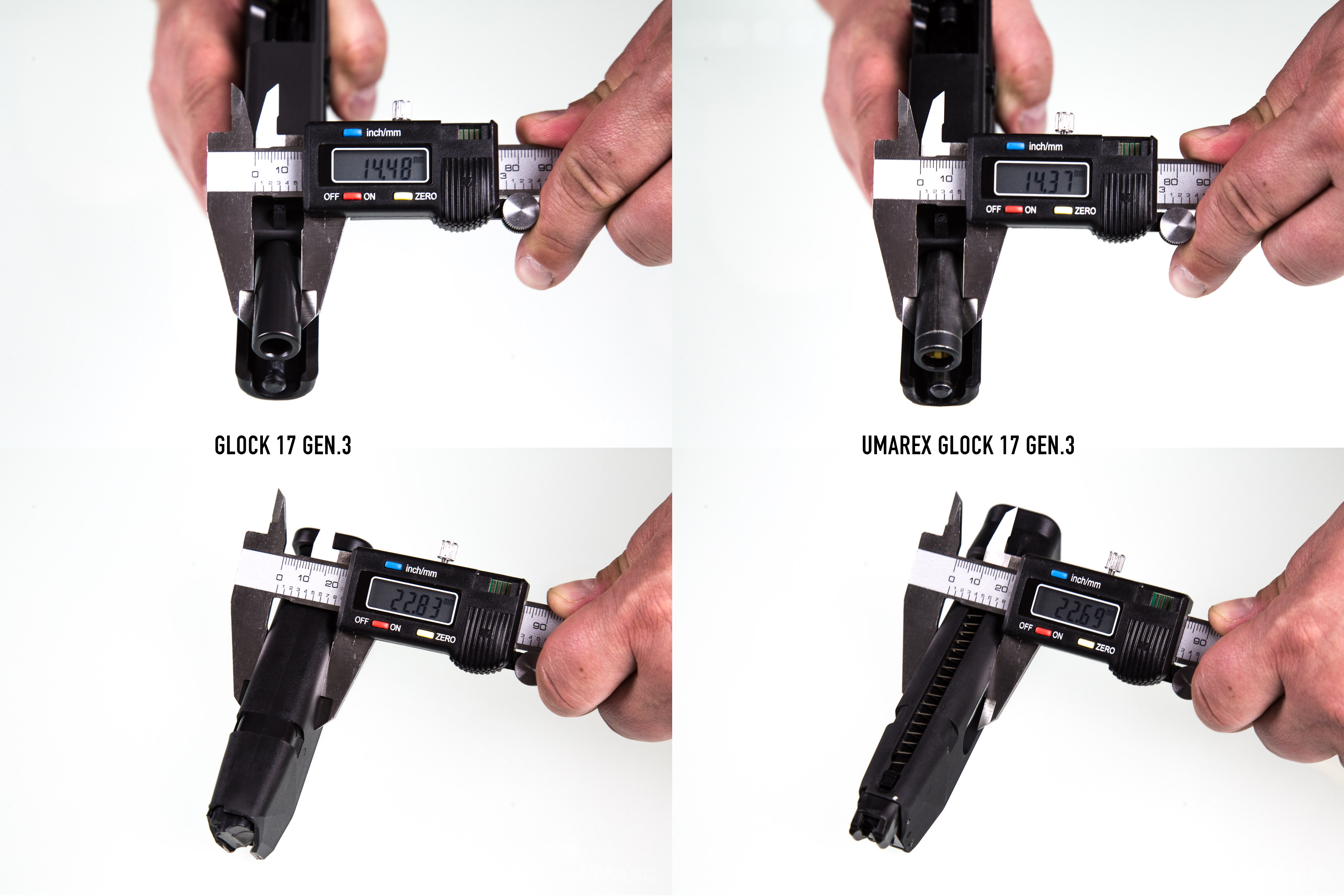

Thank to the courtesy of gunshelp.com we were able to compare the replica of the Glock 17 gen III Deluxe version with the real firearm. Below are the results.

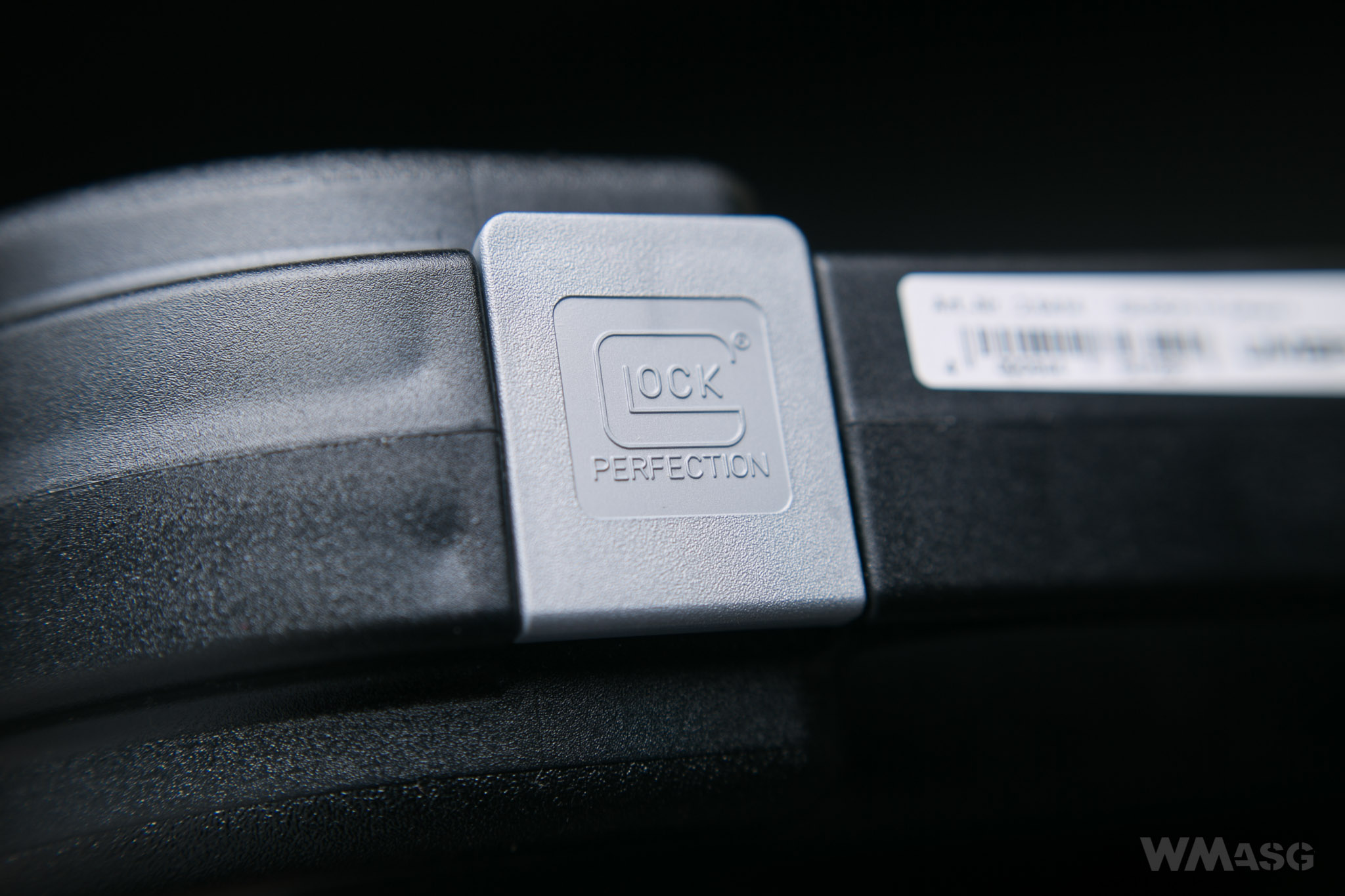

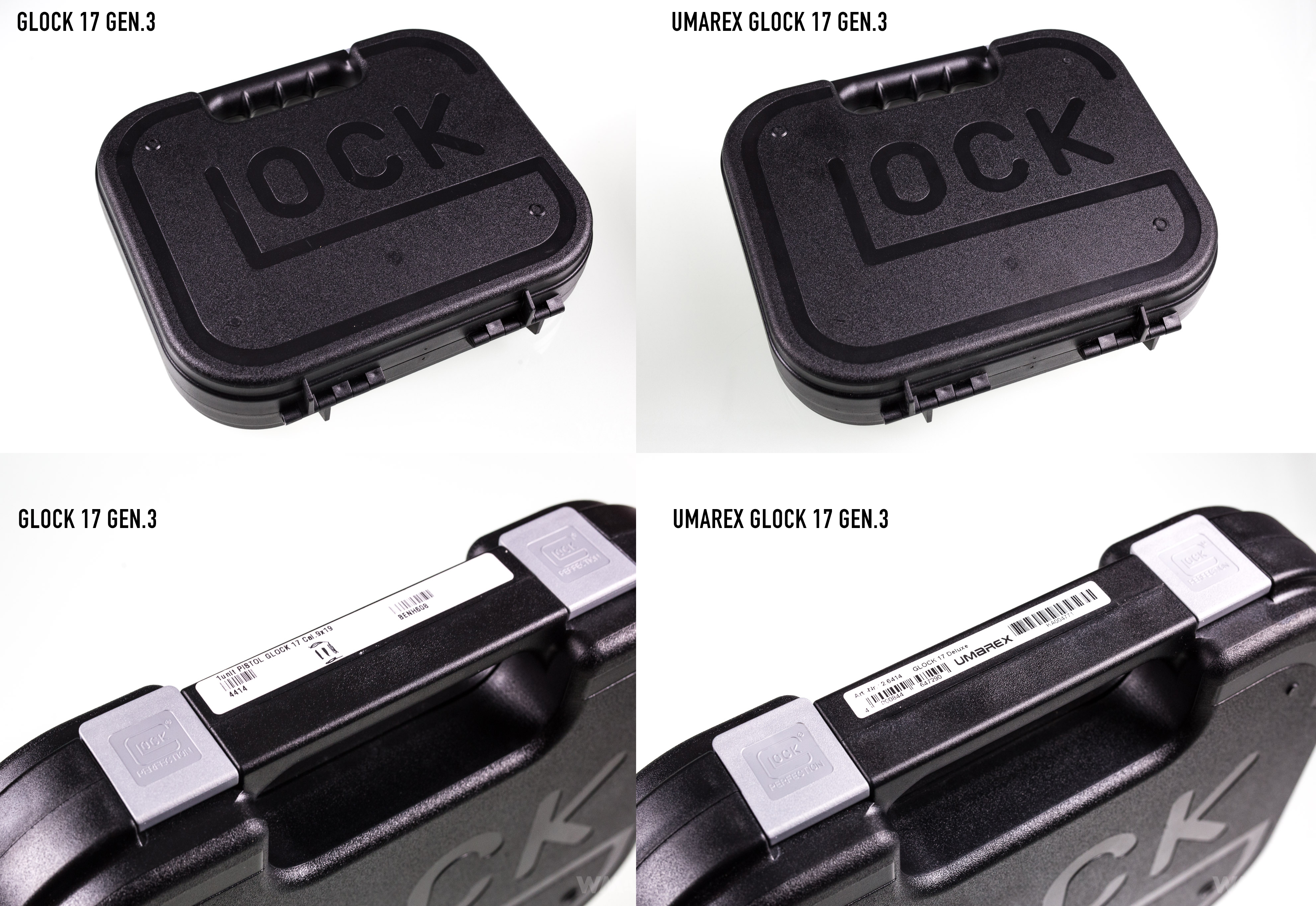

The plastic transport cases are exactly the same, the only difference is the sticker on the carrying handle.
At first glance it is difficult to say which gun is real and which is a replica: the color difference is small, almost unnoticeable to the naked eye. However, as you can see on the photos below, the coating reflects the camera flash a little differently, which makes the replica appear darker.

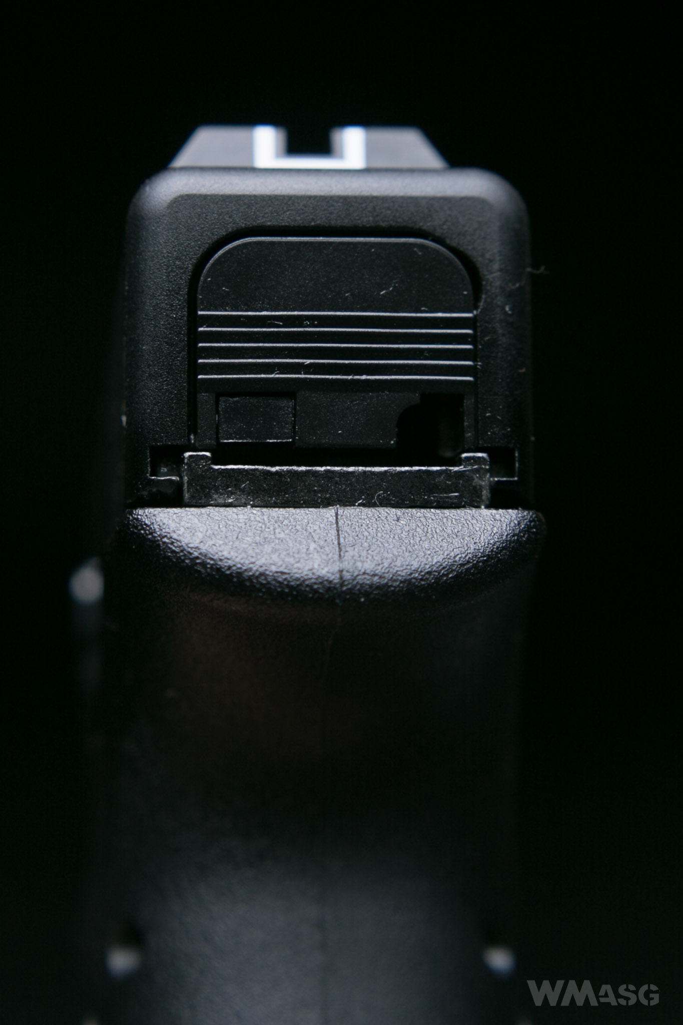

Also, the replica has no marking on the top of the ejection port.

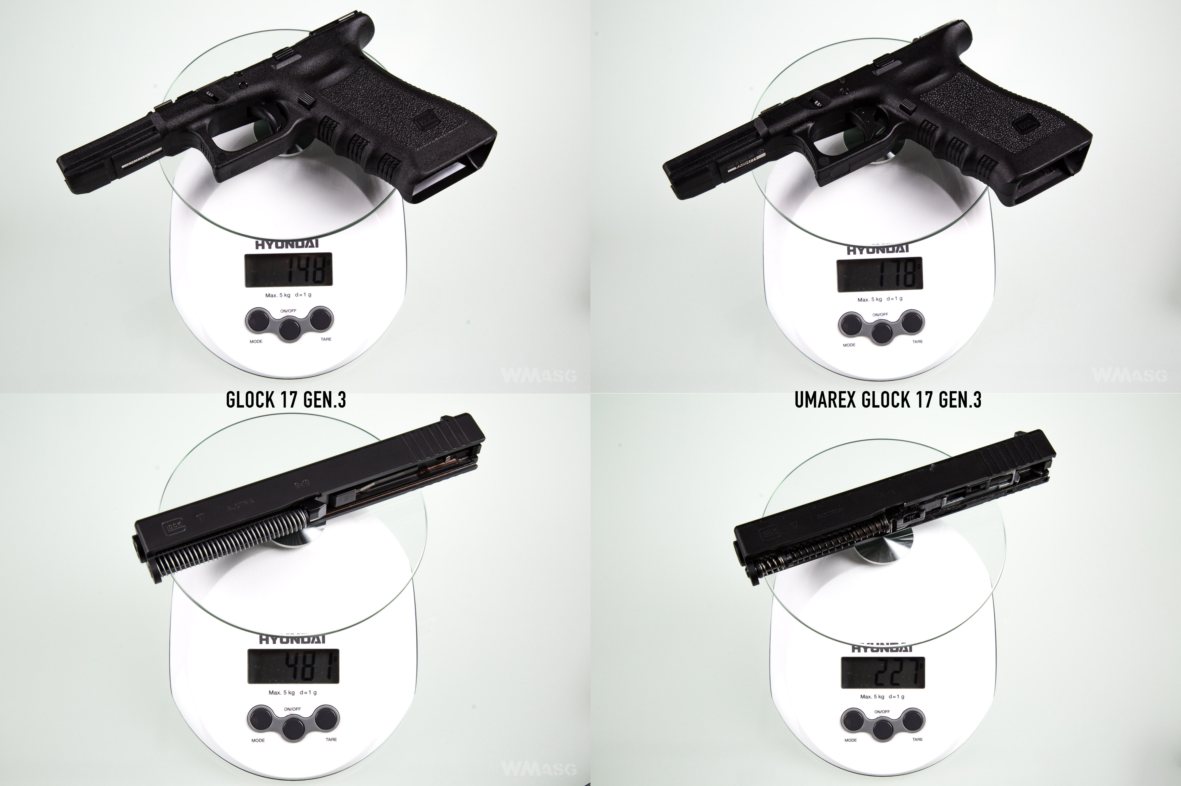

What is interesting, the pistol grip with the trigger unit are heavier in the replica than in the real firearm. The situation is different in the case of the slide, which in the real gun is more than twice as heavy as in the replica, and thus the balance of both pistols is slightly different.
Another interesting fact is that the replica, with an empty magazine and empty CO2 capsule, weighs exactly the same as its real gun with an empty magazine.
As seen on the photos, the difference in dimensions is marginal.
