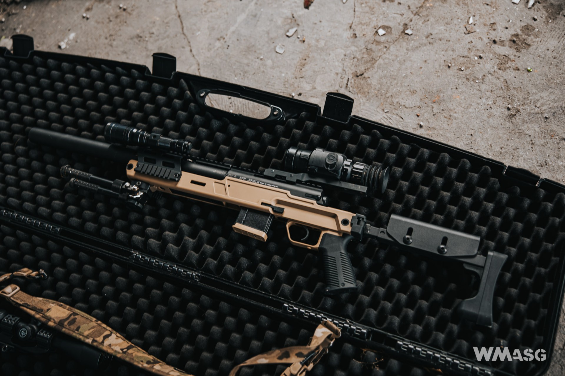

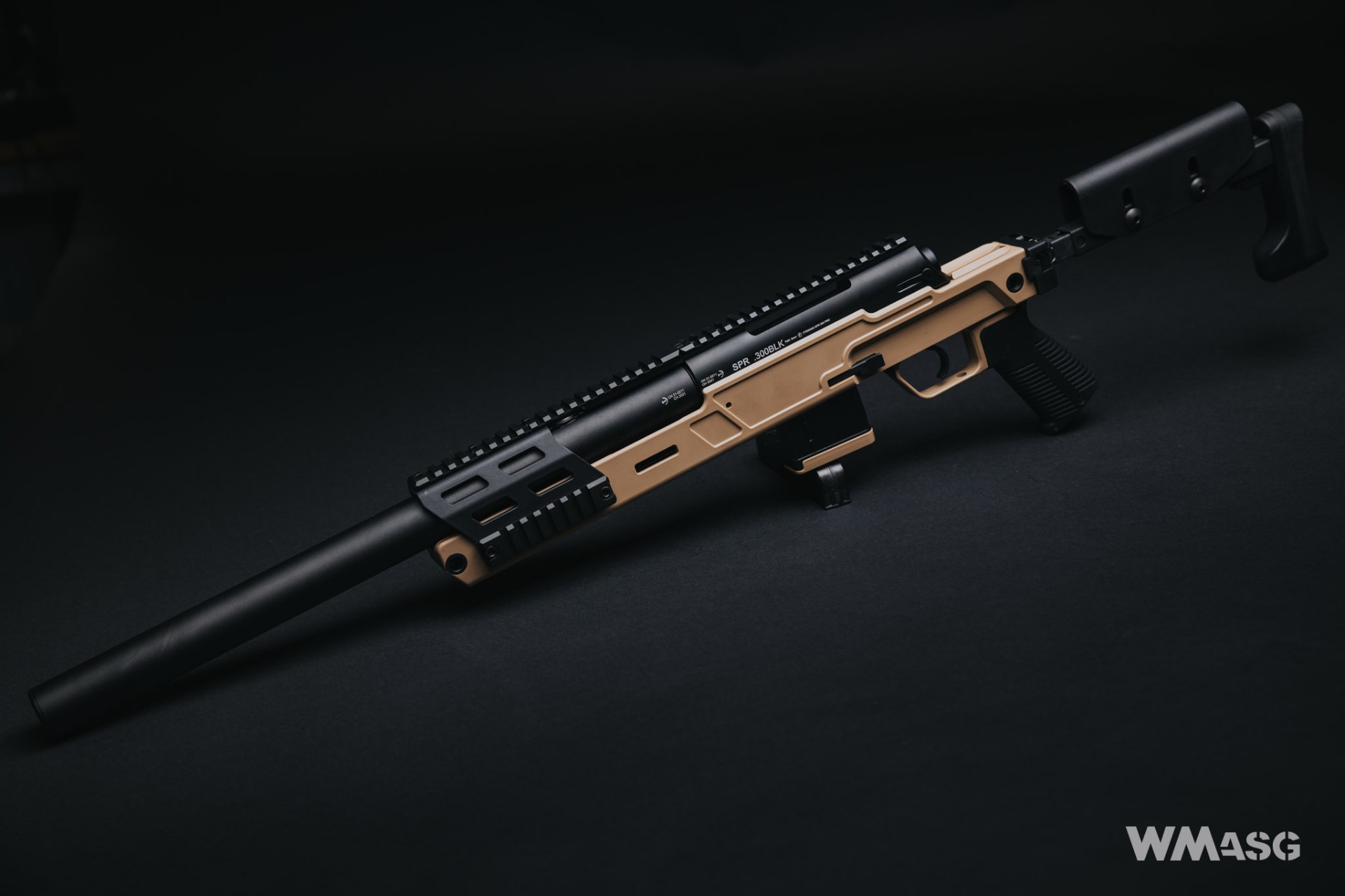

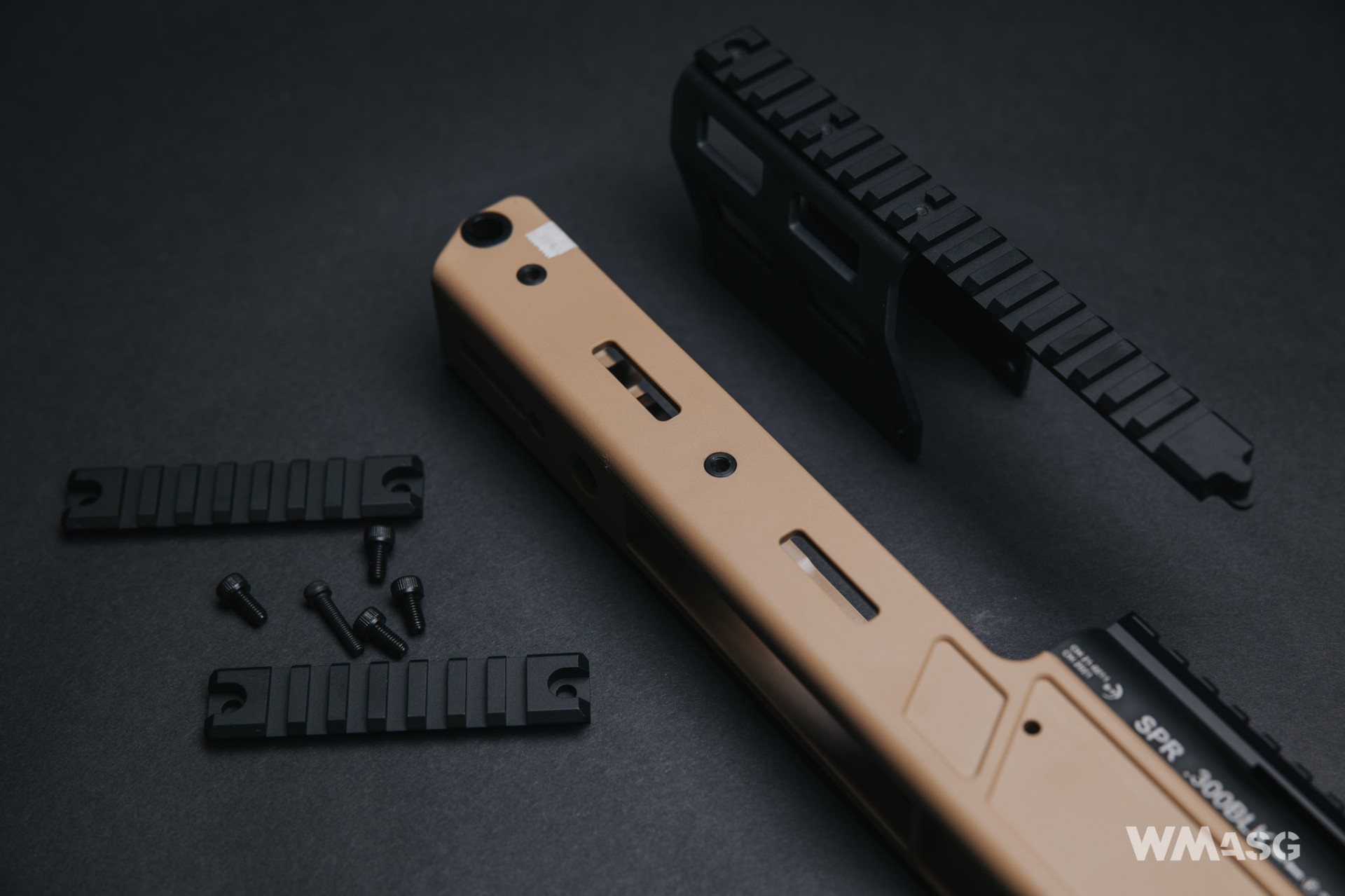

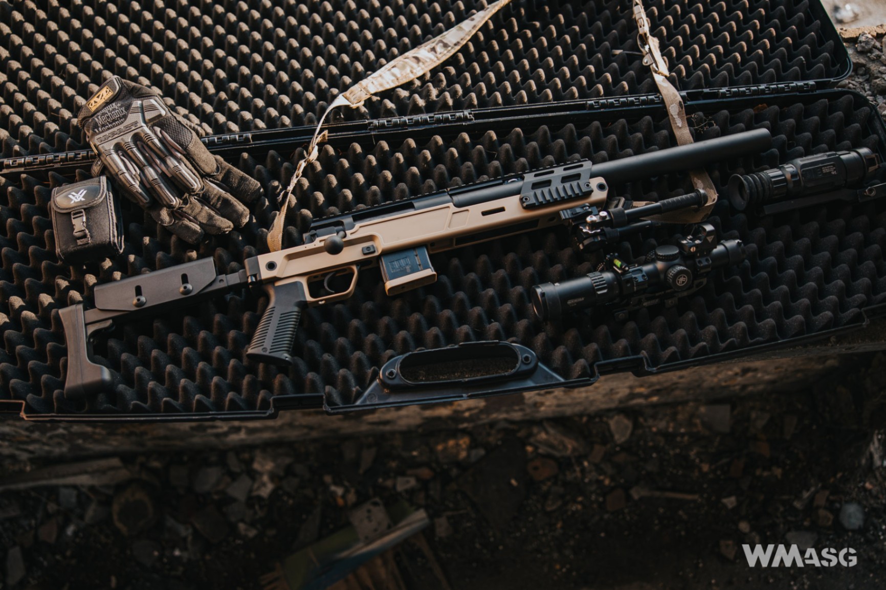

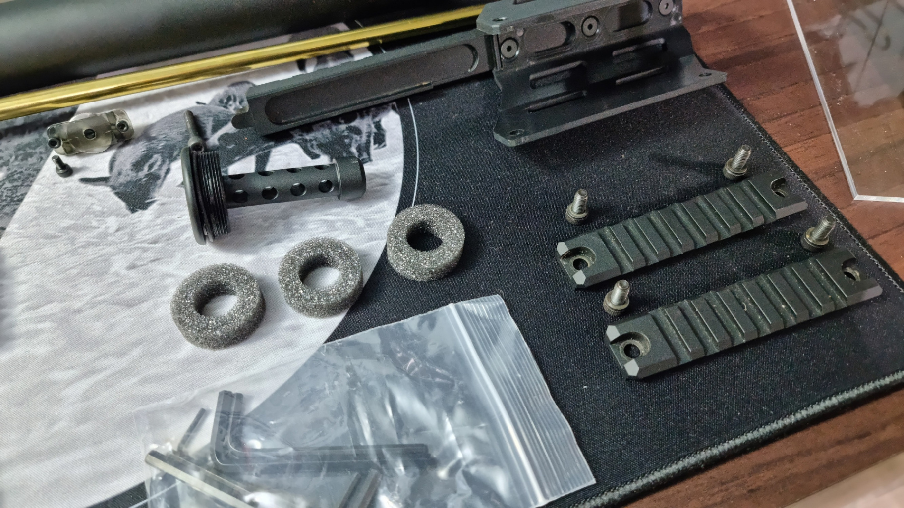

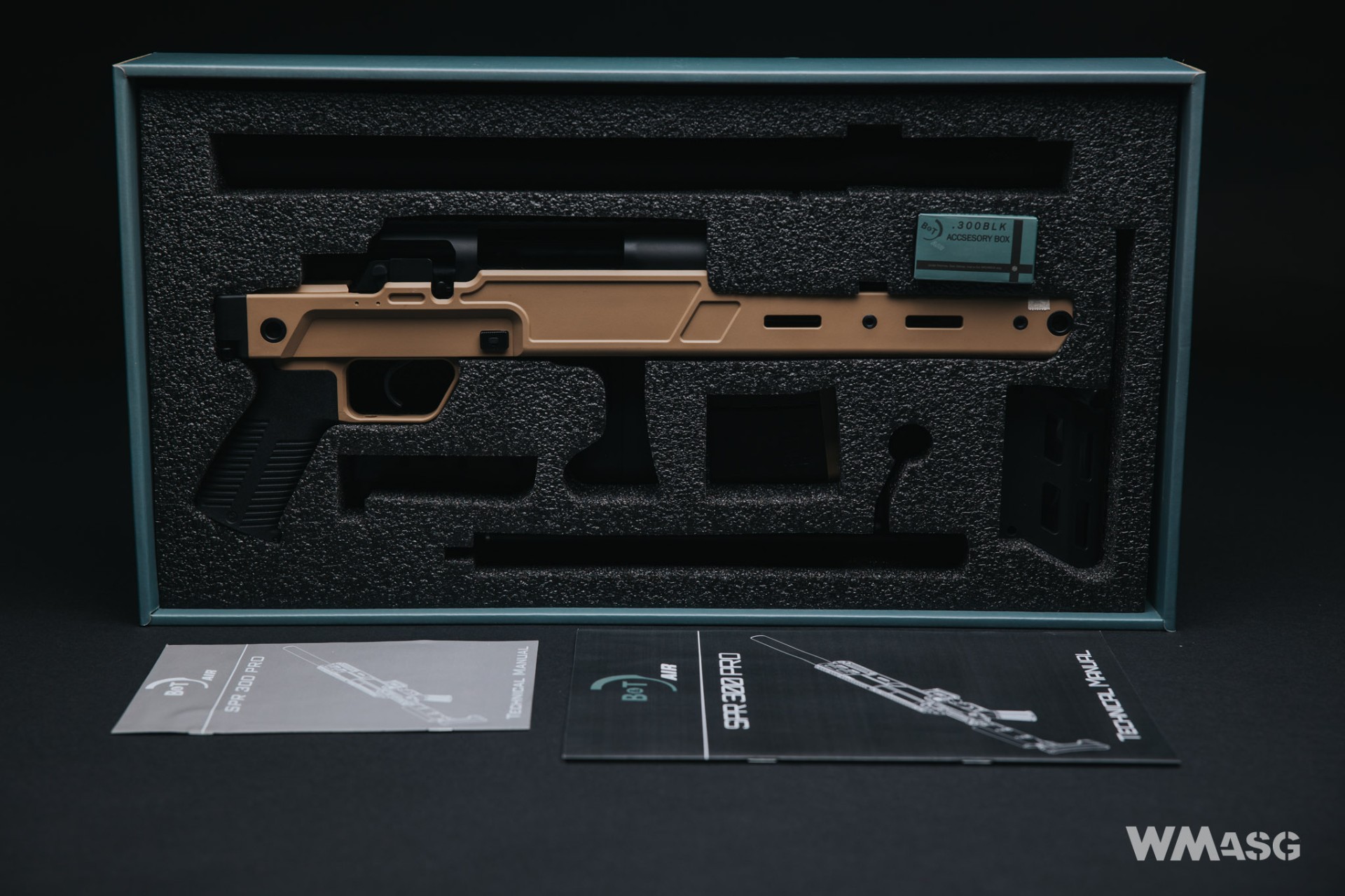

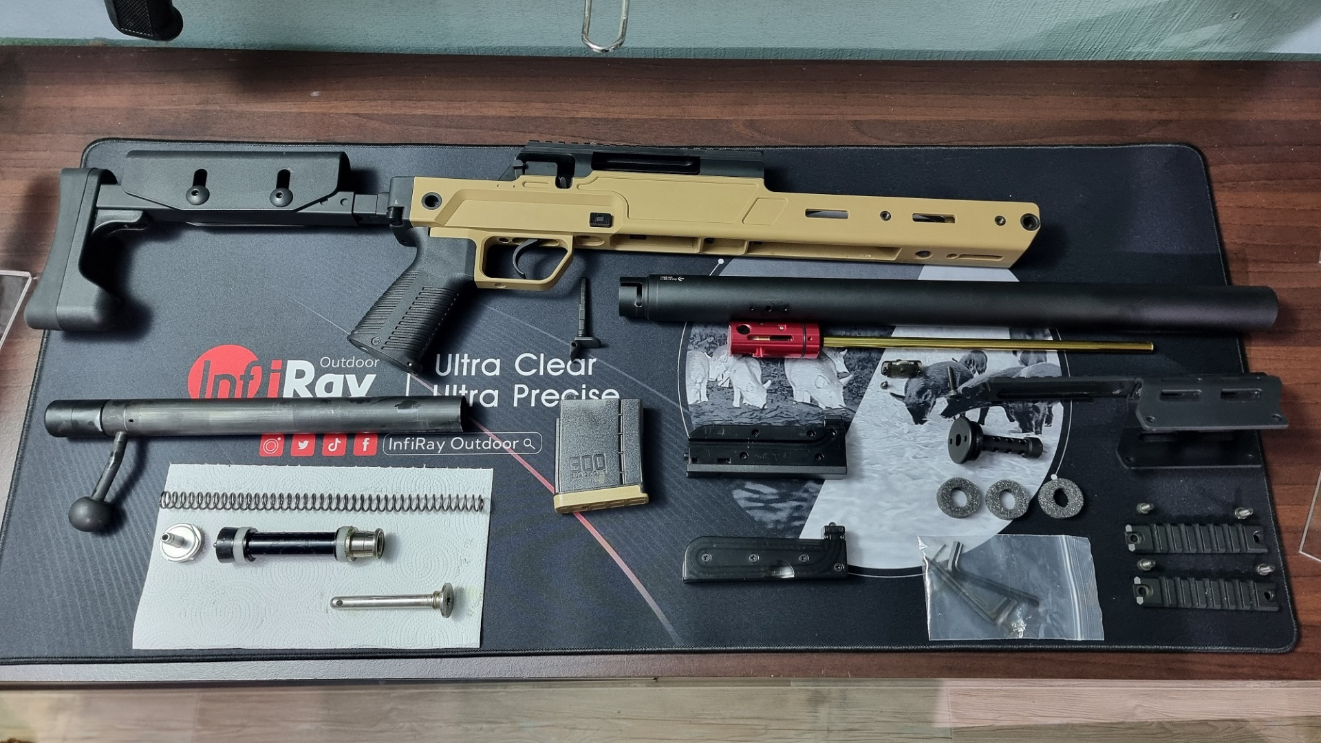

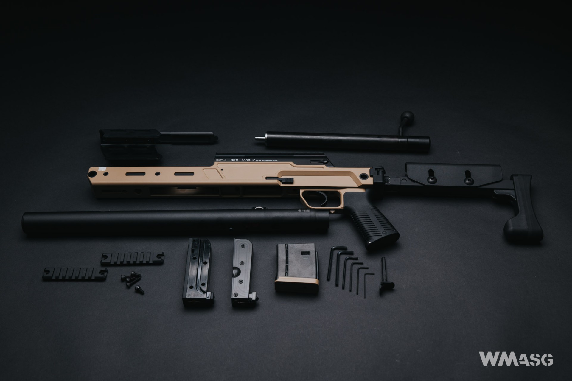

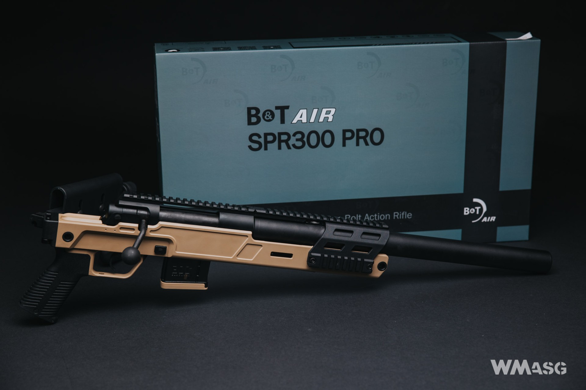

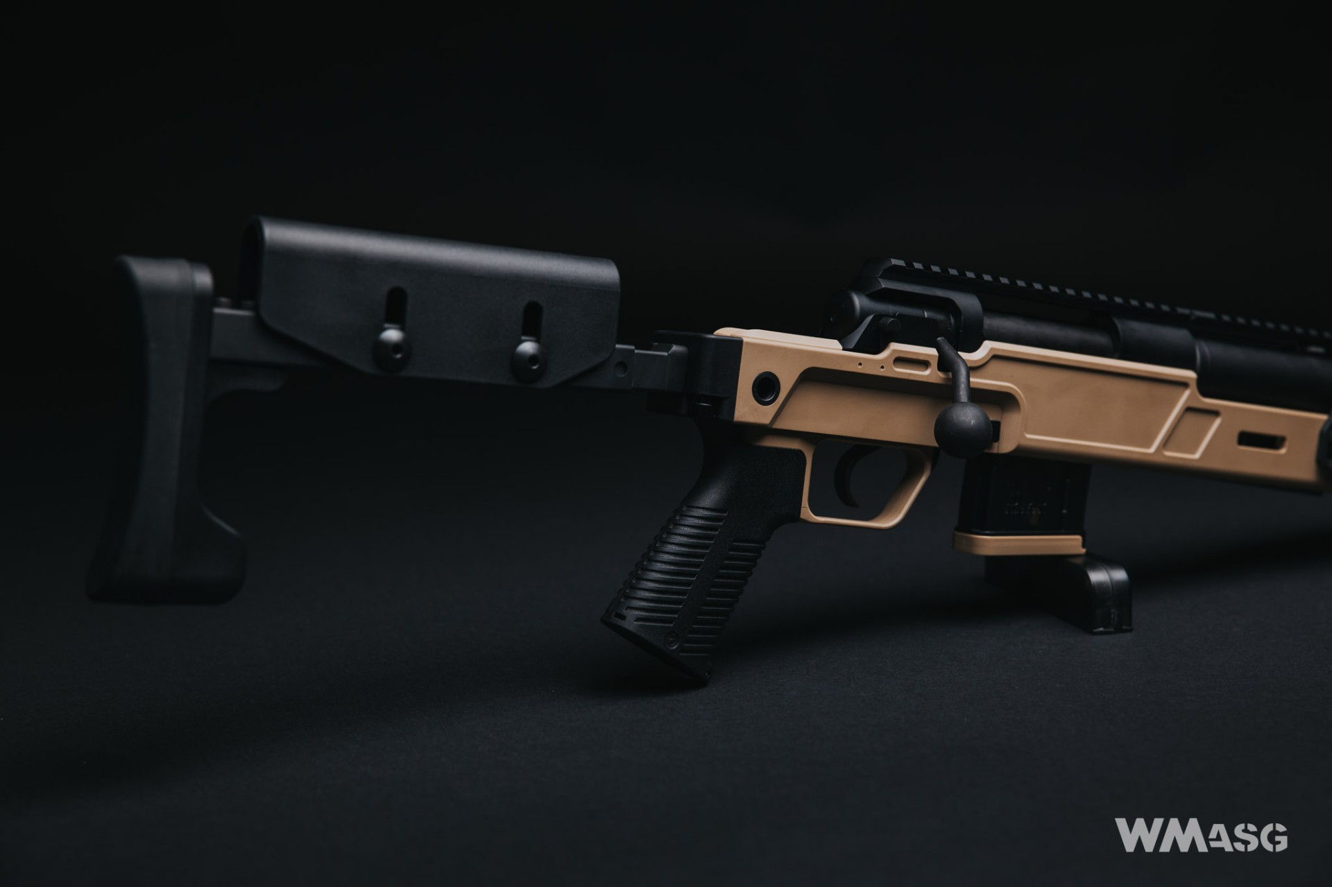

When designing the SPR300 PRO replica, the manufacturer tried to retain as many features of the original firearm as possible. Due to the shape of its packaging, one can check whether folding and unfolding the product is really quick and easy just after opening the box. The buyer receives it in parts: a bed with a receiver, a grip, and a foldable stock, a barrel with an integrated (functional) sound suppressor, an optional Picatinny rail mounted in the front of the forestock with an extension of the upper mounting rail, as well as elements responsible for feeding the BBs.

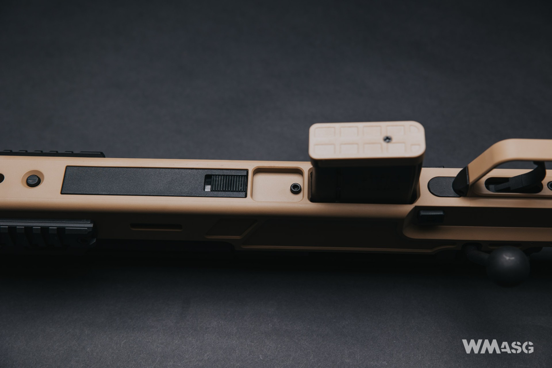

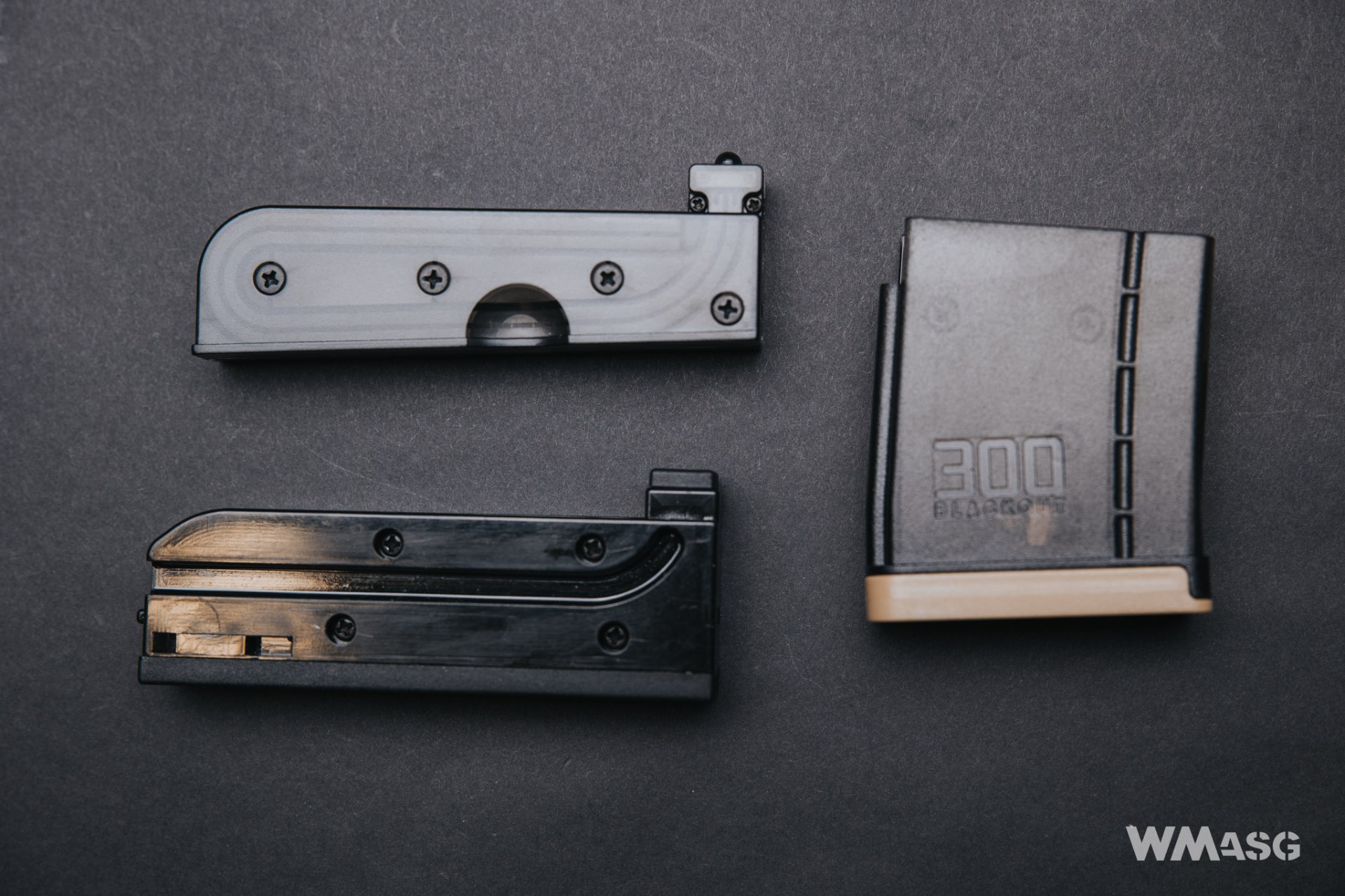

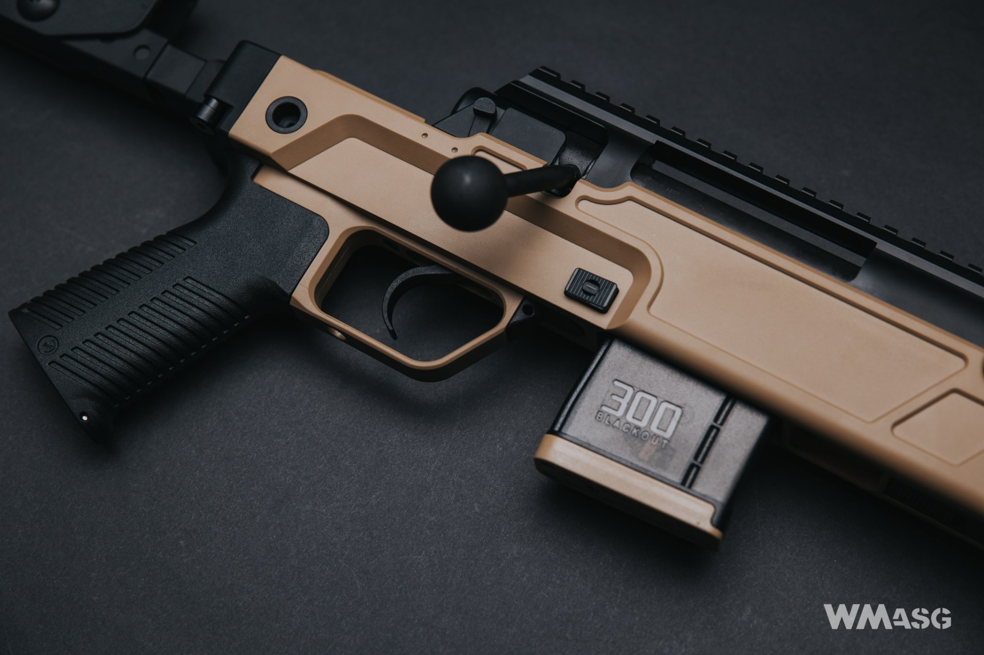

In the case of the latter of these things, there are two different ways of feeding the BBs. The user can either use traditional VSR-style magazines or a box magazine with dimensions consistent with the caliber of the original, i.e. 300 AAC Blackout. If one decides on an option closer to the original, a special ramp included in the set should be installed in the VSR magazine slot, which is responsible for transferring the BBs to the hop-up chamber. This solution forces the box magazine (with a capacity of 50 pieces) to be loaded twice with BBs before the first use of the replica, because after the first connection, a large part of them will be released and fed to the mentioned chamber. It is also worth remembering that, due to the way the system works, it is not possible to use both types of magazines at the same time.
Although it can be expected that assembling a replica prepared in this way should be simple (the package includes detailed pictorial instructions and links to videos devoted to this task), I encountered a certain problem at the very beginning: a slight discrepancy in the position of the mounting screw hole in the barrel and in the forestock. Some flexibility of the material and the use of force allowed these parts to be assembled, but a similar obstacle recurred when screwing the front RIS module. Ultimately, the replica was assembled, but it took more time and was definitely less pleasant than one could expect from a product of this class. However, browsing social media and places on the Internet devoted to the SPR300 PRO from Archwick, one can assume that this was an isolated case of the tested unit.
Fortunately, after a few days of testing the replica and having to disassemble it for basic cleaning, it turned out that the above mentioned parts fit together better. From that moment on, the replica could be easily disassembled and reassembled.

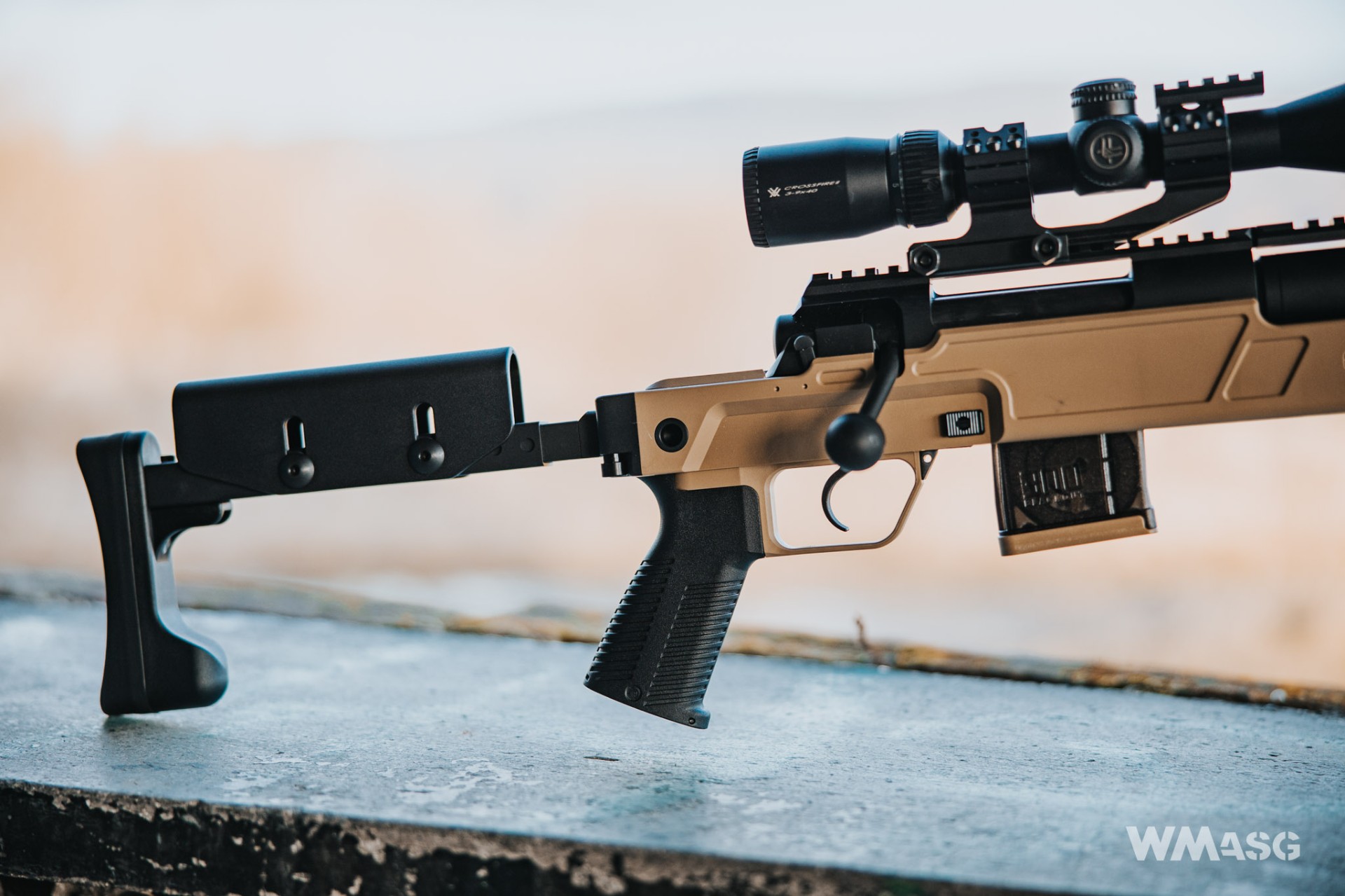

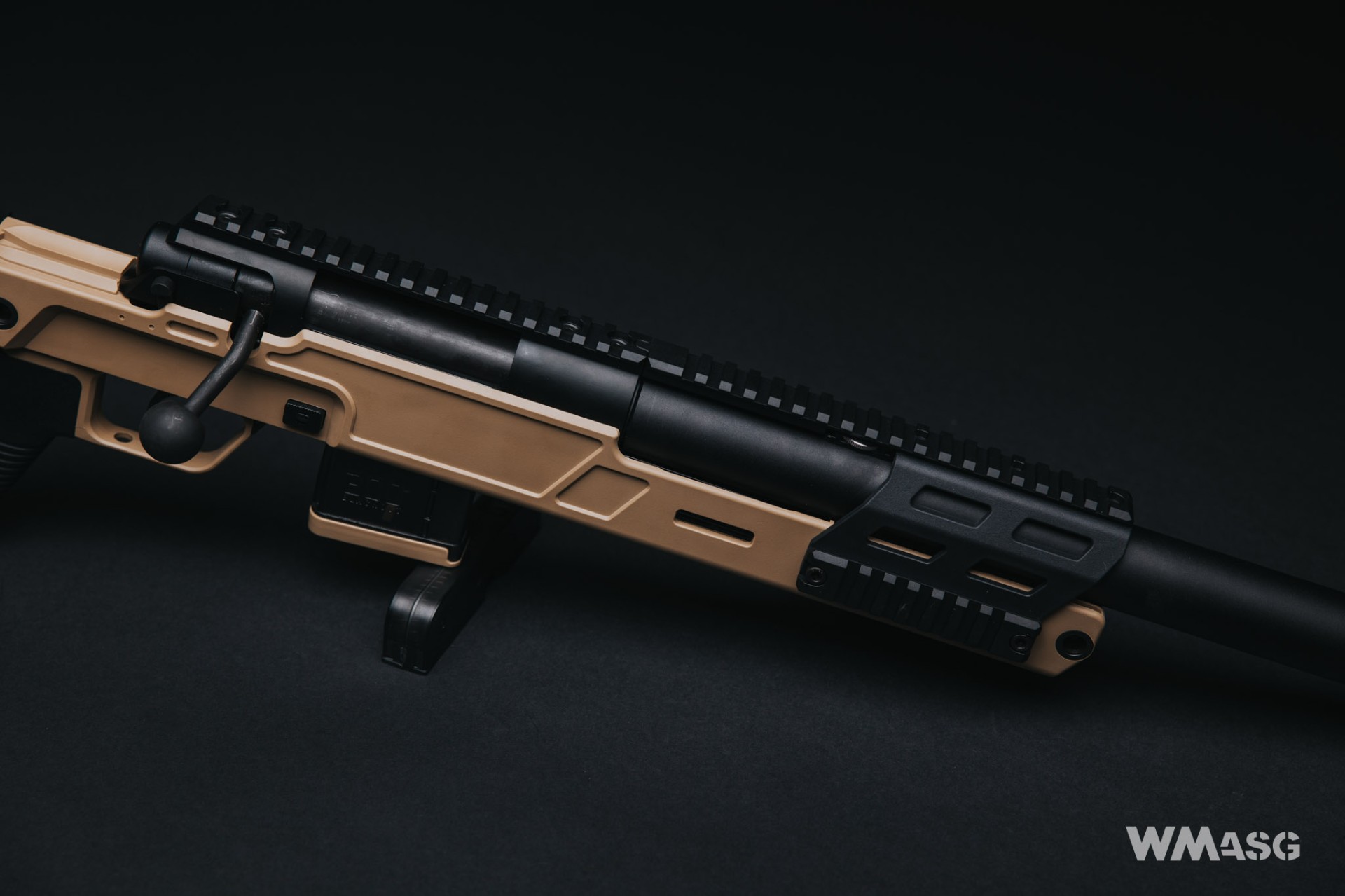

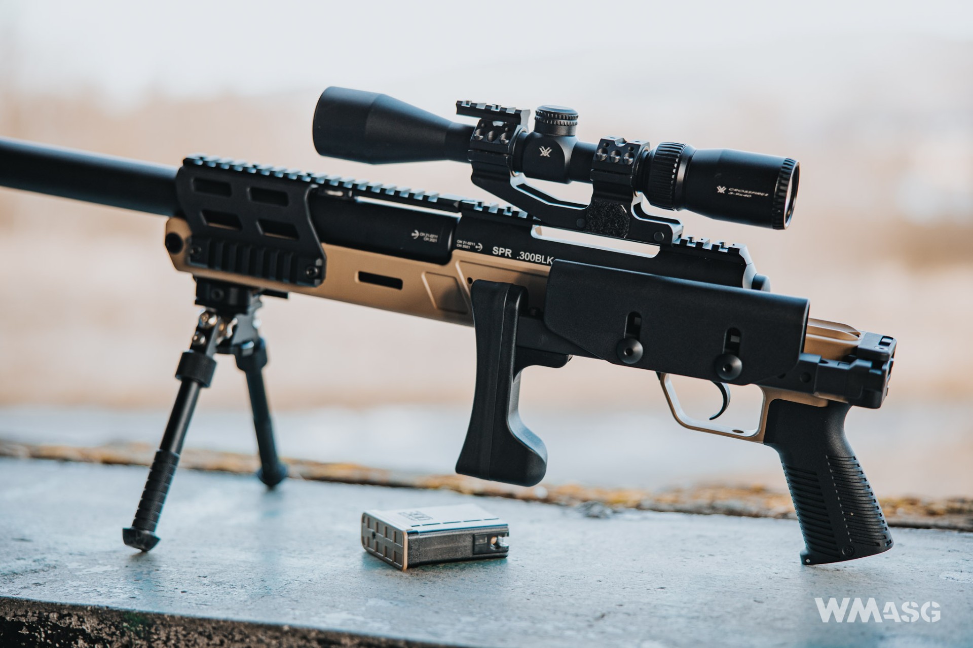

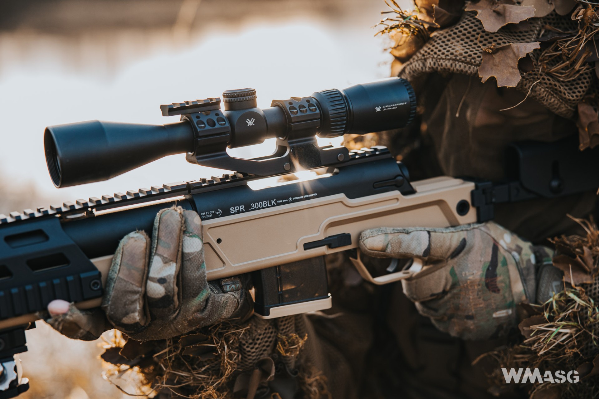

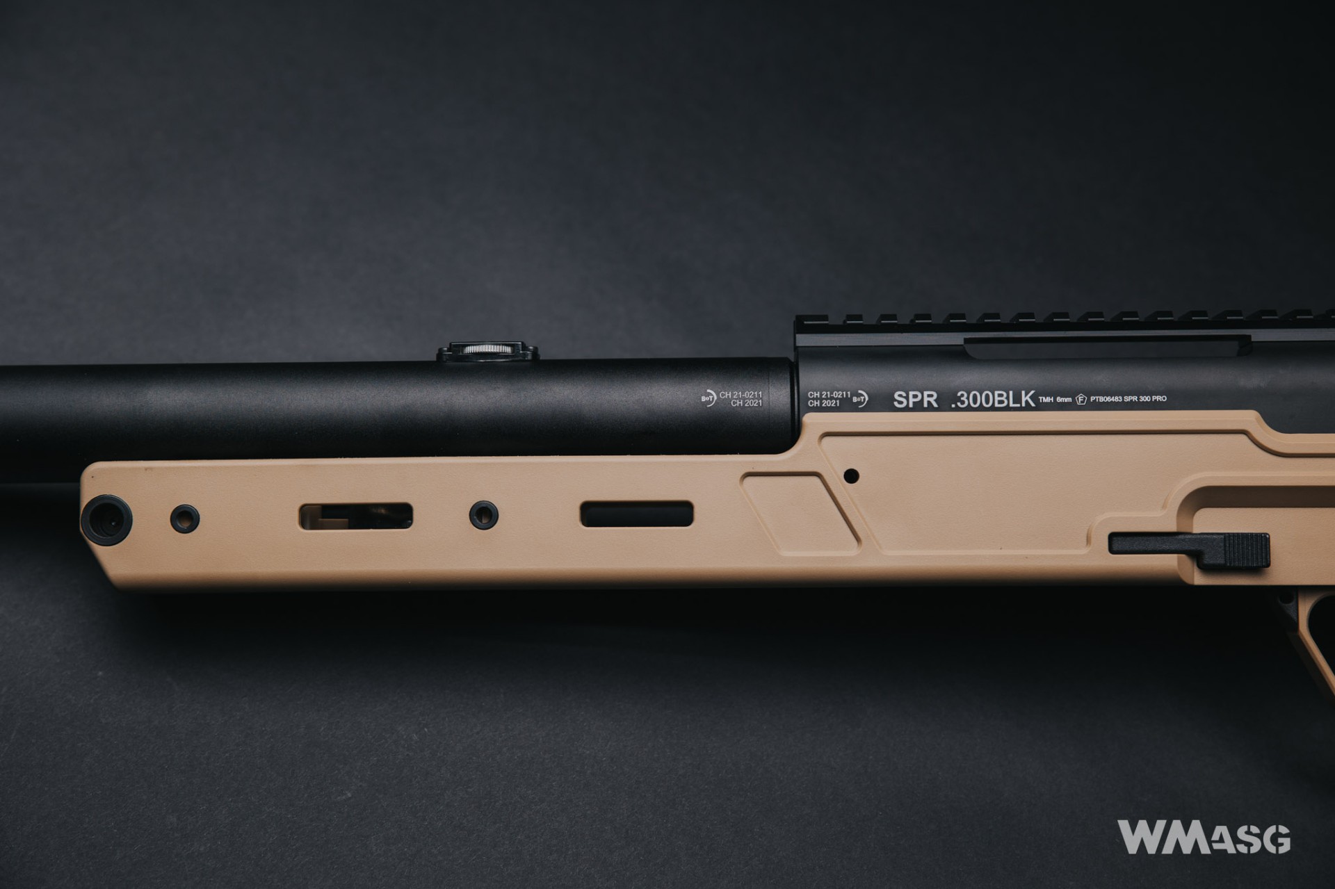

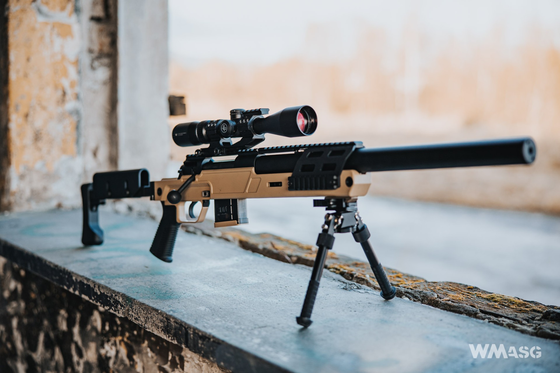

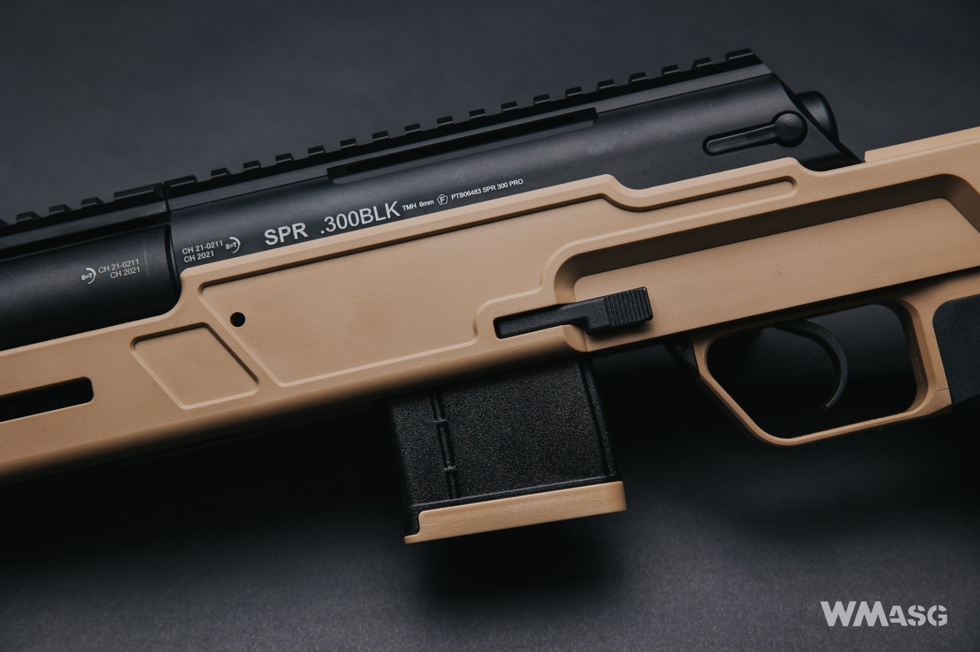

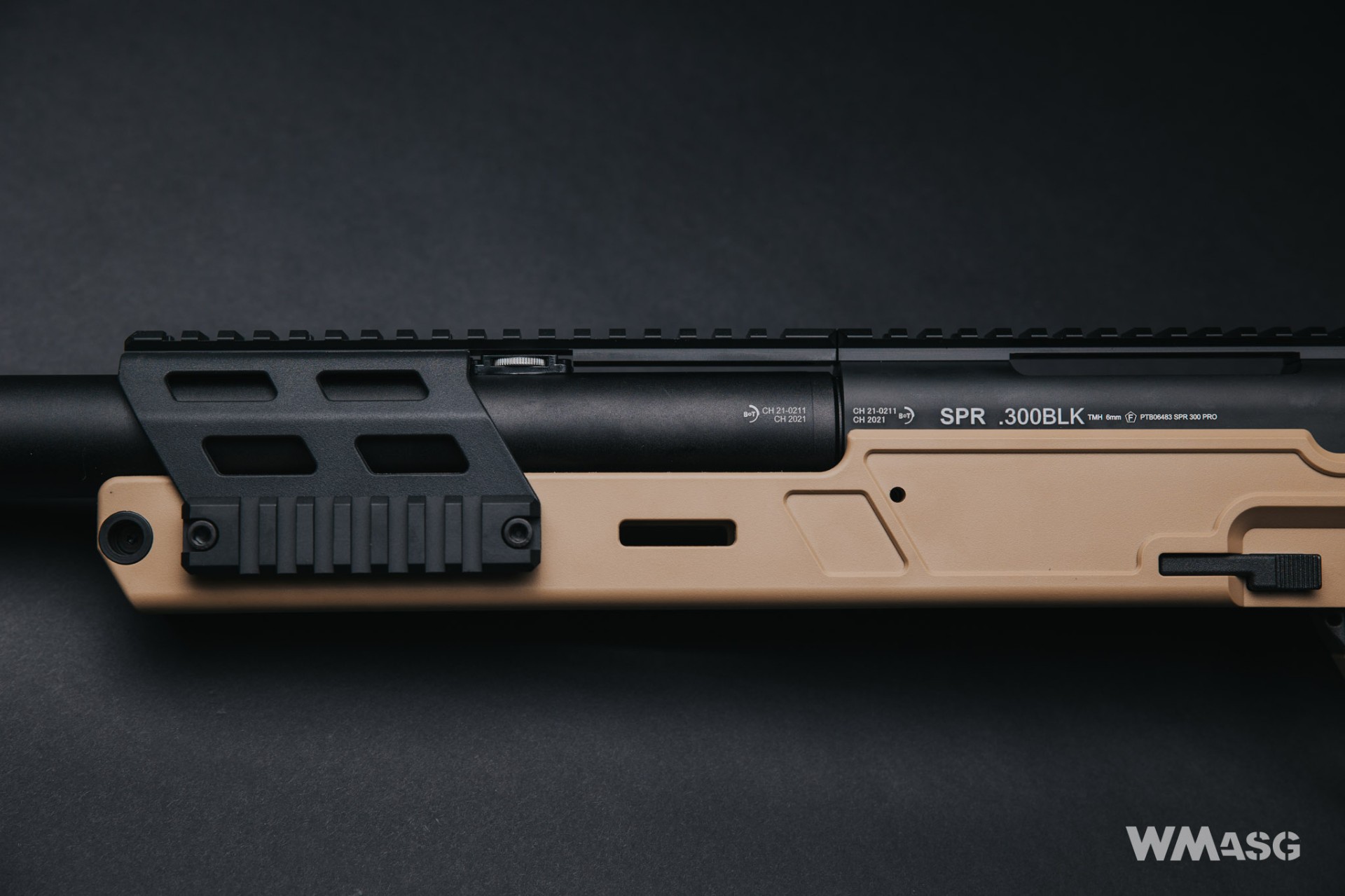

The fully assembled replica is sufficiently stiff and looks good. Only minor looseness in the stock assembly is noticeable. The quality of the materials used certainly influences the positive reception of the product. The main structure of the bolt and the trigger are made of steel, an aluminum alloy was used for the production of the barrel, stock, and mounting rails, and the forestock, rail frame, pistol grip, and adjustable cheek pad are made of a pleasant-to-the-touch plastic. In the stock itself, there is space for four steel QD slots ("press dots") for mounting the carrying sling swivels and additional M-LOK slots at both sided and the bottom (enabling, among other things, the installation of a bipod). The Achilles heel of the design seems to be the plastic magazines: they are soft and have a shiny texture. They don't make a good impression. Moreover, the VSR version of the feeder initially had problems with feeding the BBs, and it was necessary to use a bit of lubricant (the use of which is most often avoided when maintaining magazines) and start the mechanism to make it work properly.

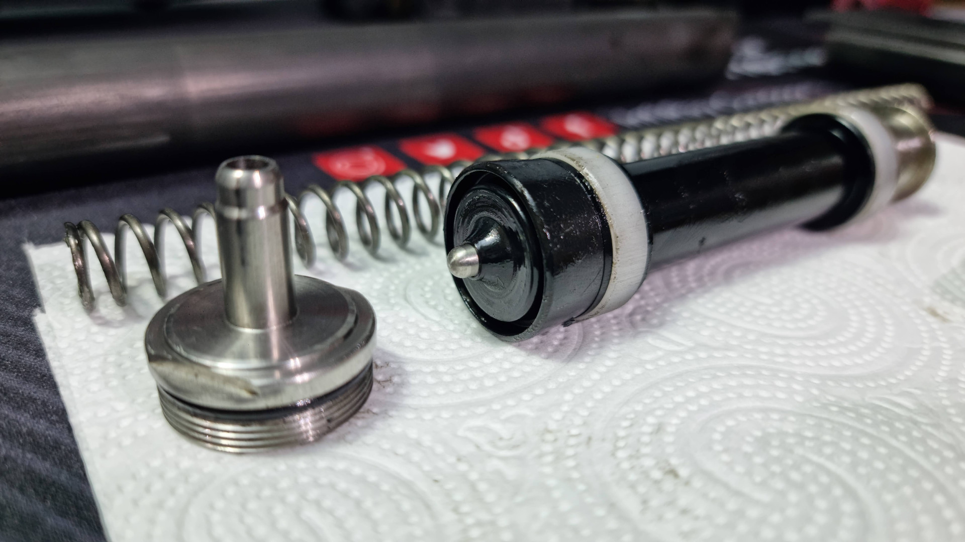

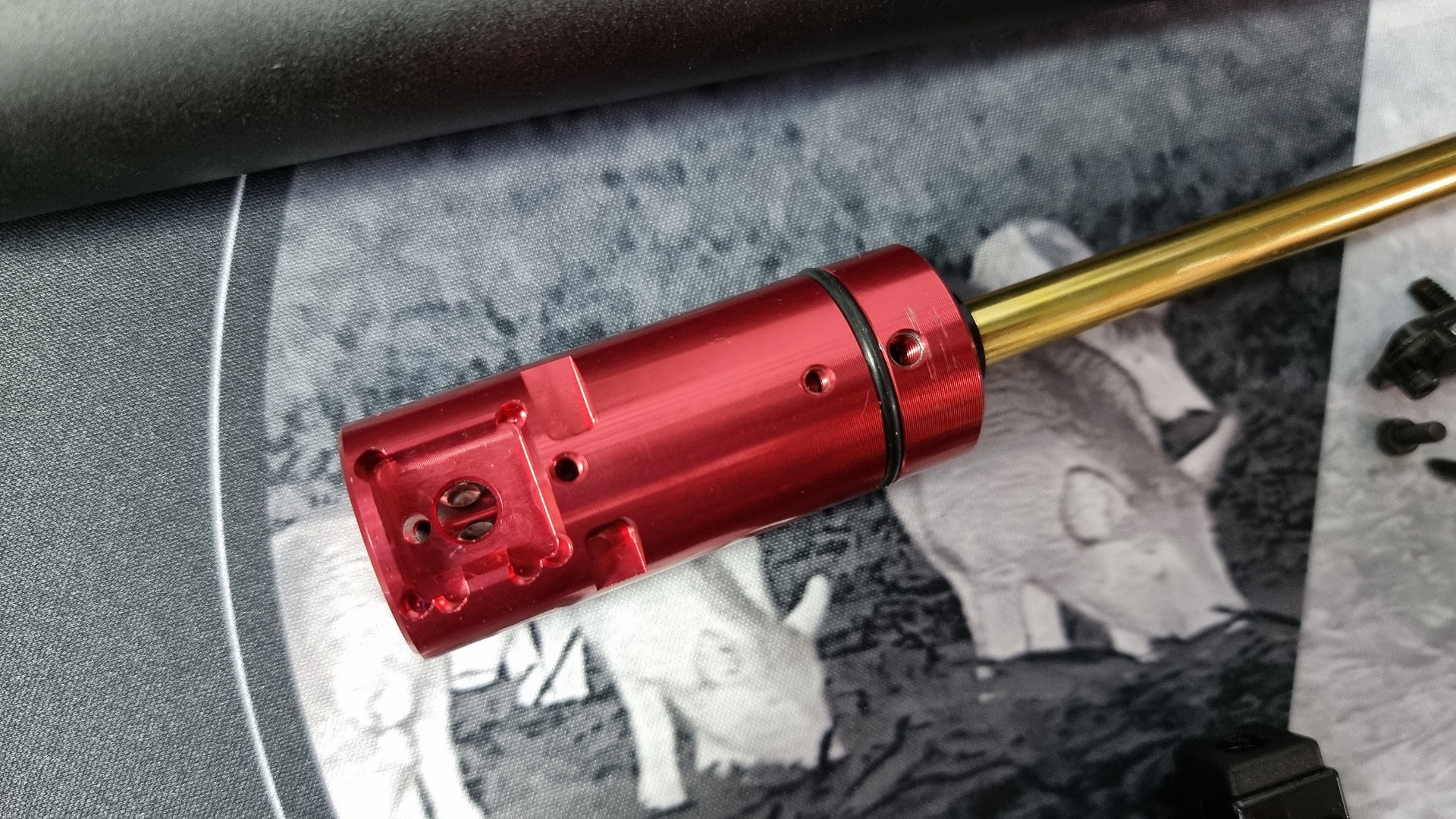

The interior of the Archwick SPR300 PRO replica contains many reinforced parts made of steel and aluminum, made using CNC machines. According to the manufacturer, they are able to work even with M170 springs. Some solutions are noteworthy, such as the use of a 45 cc cylinder or an aluminum hop-up chamber with TDC adjustment (smooth, stepless). A nice touch is also the fact that the product is factory equipped with a 6.03 mm precision barrel. At the end of the testing period, after firing several hundred BBS, the replica was disassembled again for cleaning: the condition of the internal parts was satisfactory.

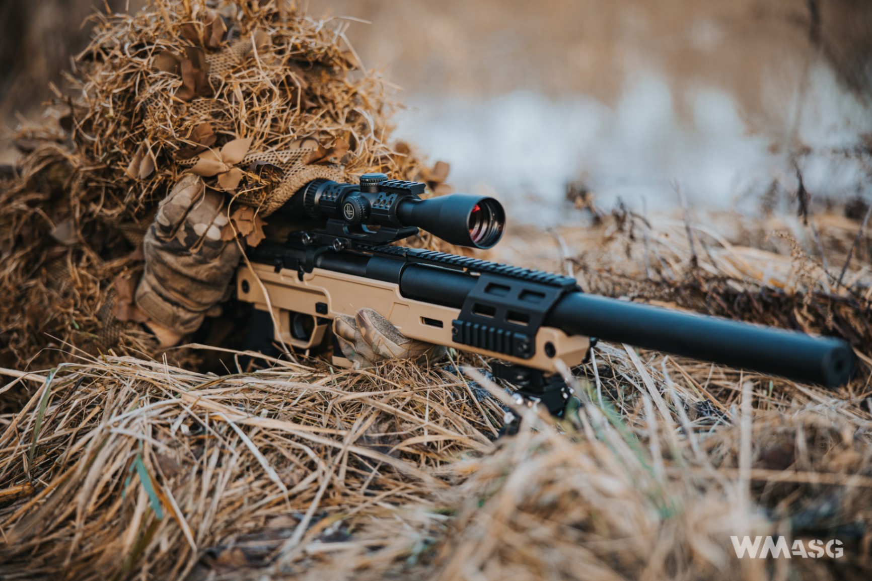

I went outdoors to see how the replica would work when shooting at static targets. During the tests, is was cloudy and humidity was high, the temperature reached 8°C, and there was some side wind. It was weak, but its strength was enough to slightly influence the final phase of the BBs' flight path (they drifted to the right).
Since in our review we wanted to see in this product could aspire to the role of the airsoft holy grail (a sniper replica "out of the box"), shooting tests were carried out at long ranges: 60, 80, and 100 meters (measured using a Vortex laser rangefinder). I used a mat and a shooting rest to minimize the influence of variables. I installed a 3-9x40 scope and a Runcam Scopecam 2 4K camera to record the results of the test. I placed an additional camera near the target to make it easier to record where the BBs hit it.
A helmet and a plate carrier, suspended on a tripod, were used as the target. This was to simulate airsoft conditions in which the player's silhouette shot at is most often partially covered. Behind the target, there was a tree that caught missed shots.
The results are not perfect, but they are still satisfying. One should always bear in mind that we are talking about a replica in a factory configuration. A total of about 100 shots were fired, including those needed to set the hop-up and correct the scope settings. On average, 1-2 BBs from each series of 10-shots fired at the target had unnatural deviations that resulted from excessive or insufficient spin of the BB. In general, their flight path during the test turned out to be quite predictable and repeatable.
From a distance of 60 meters, on average 7/10 shots hit the target. The remaining ones did not fly beyond the outline of the tree in the background. I would define this range as the optimal. Until the shooter makes a mistake, hitting an exposed opponent located about 60 meters away should be a formality.
I spent most of my time shooting from 80 meters. Due to the small size of the target and less than ideal weather conditions, there were about 3 hits in each series. A similar number of BBs ended their flight on the tree behind the target. This means that when firing at a distance of up to 80 meters, the shooter has a real chance of hitting their opponent.
Finally, I fired 10 shots from 100 meters. No direct hits were recorded, but a camera near the target confirmed that at least some of the BBs reached this distance. In theory, it is possible to hit another player at such a range using a factory, unmodified replica.
Later in this text I linked an example recording made during the tests, depictingsix consecutive shots made from a distance of 80 meters. You can see both the shots that hit and the flight path of the BBs that missed, including one of the shots when the hop-up system worked unpredictably.
