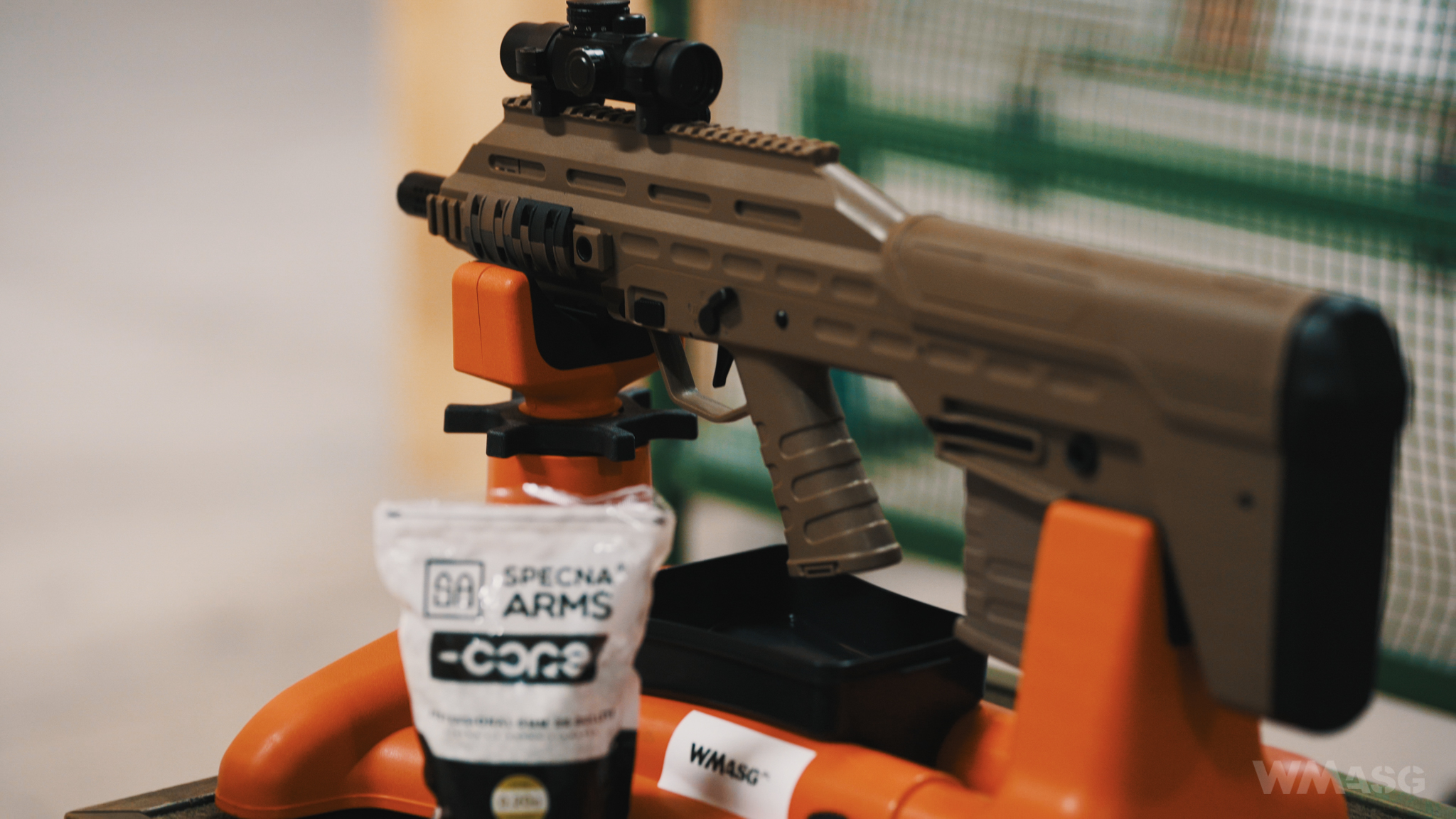

Platforma testowa:
The test platform was the UAR carbine by APS which underwent a thorough upgrade.
Configuration:
- SHS 18:1 gears on ball bearings,
- SHS piston with 14 steel teeth,
- Ultimate silent piston head with a bearing,
- Ultimate cylinder head,
- APS stock nozzle with an o-ring,
- APS stock spring guide with a ball bearing,
- Element Ultra Torque motor,
- low-resistance 16 AWG wires,
- Gate Pico SSR3 mosfet,
- APS stock 363 mm barrel,
- G&G green elastic bucking.
Battery: 11.1 V 1800 mAh 45C Brainergy.
Hop-Up set at zero.

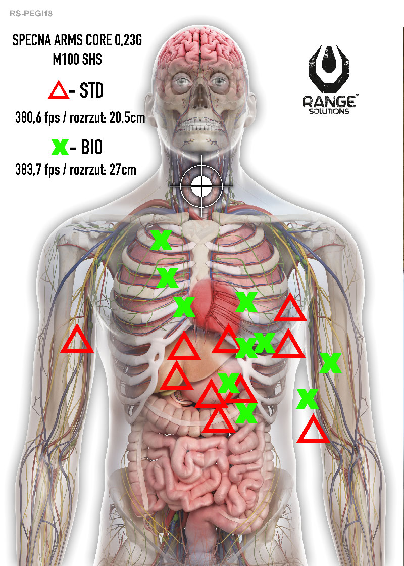

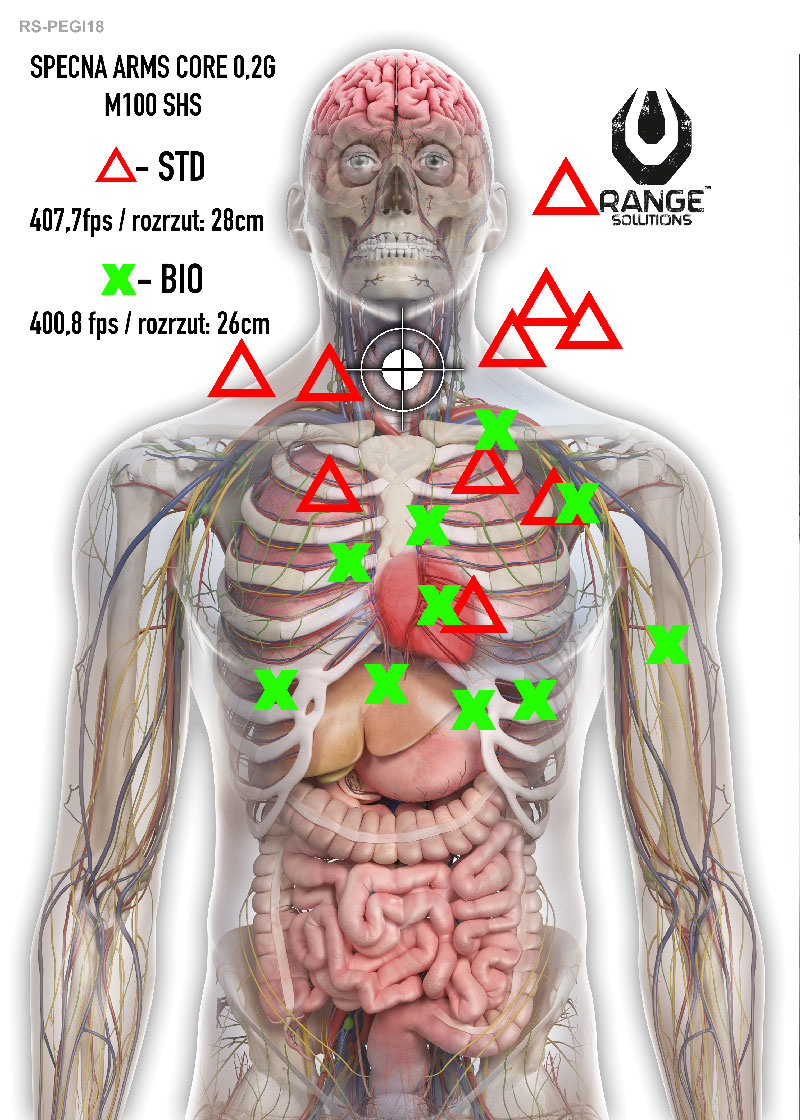

The aiming point was always the same, marked on the photo with the symbol of a scope reticle.
Core 0,2 g BBs
(rozrzut - ang. grouping)
Core 0,23 g BBs

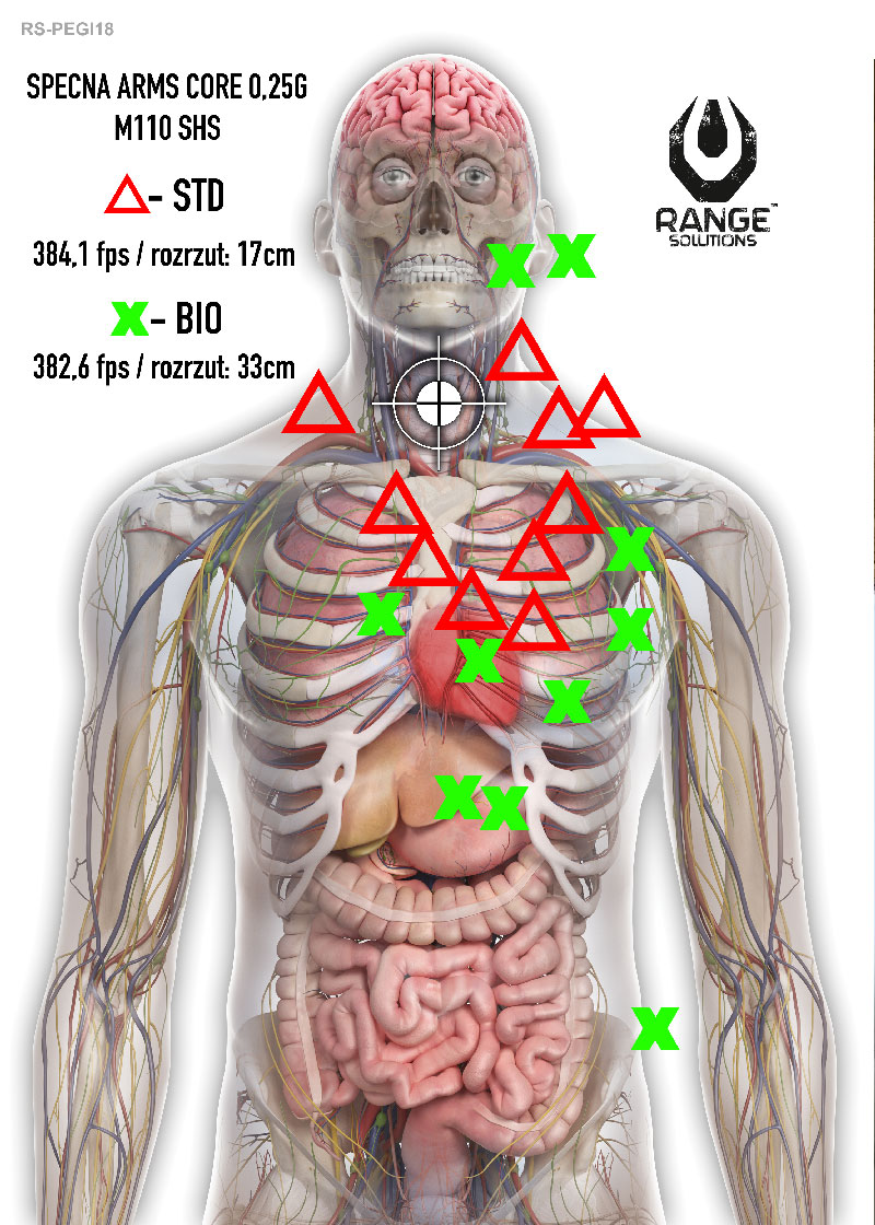

Core 0,25 g BBs

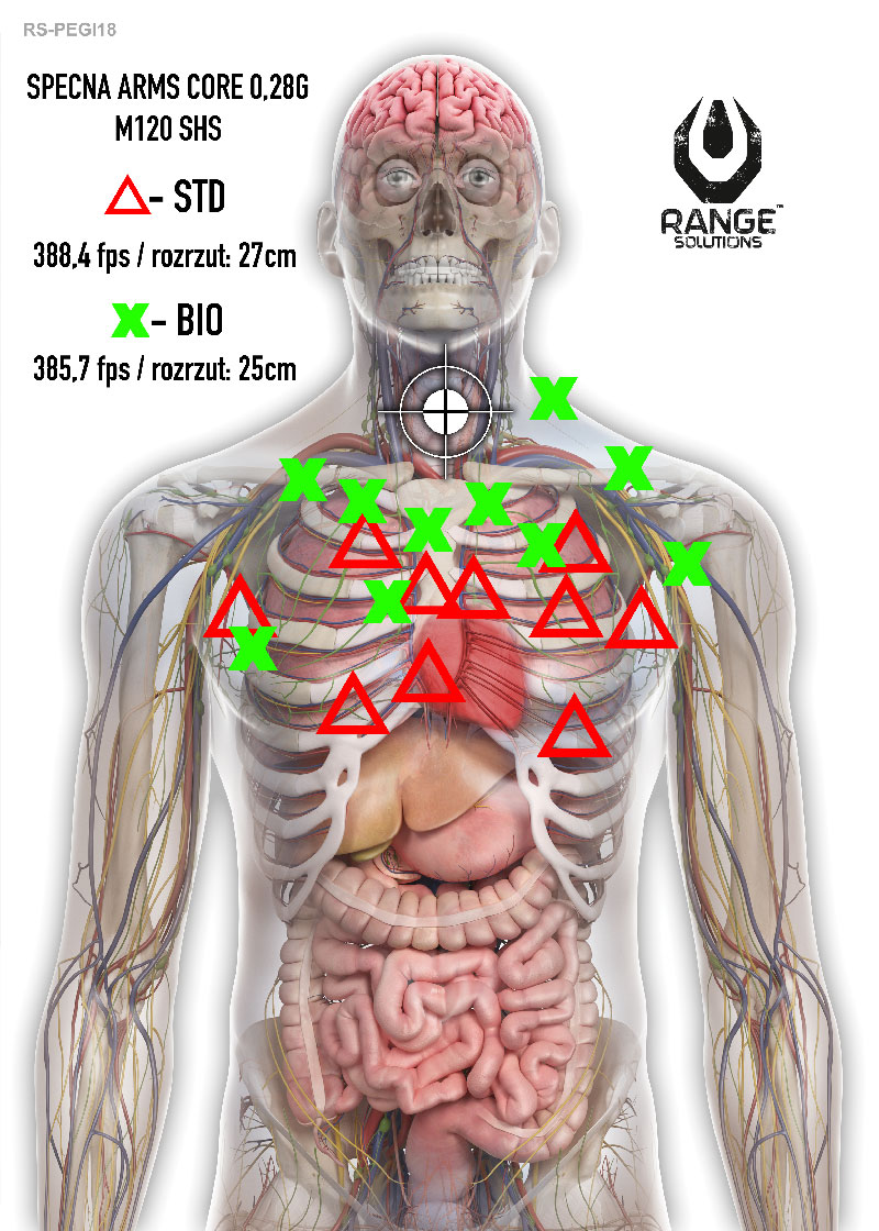

Core 0,28 g BBs

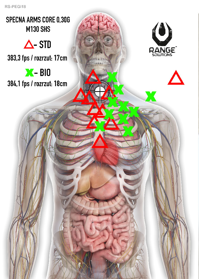

Core 0,3 g BBs

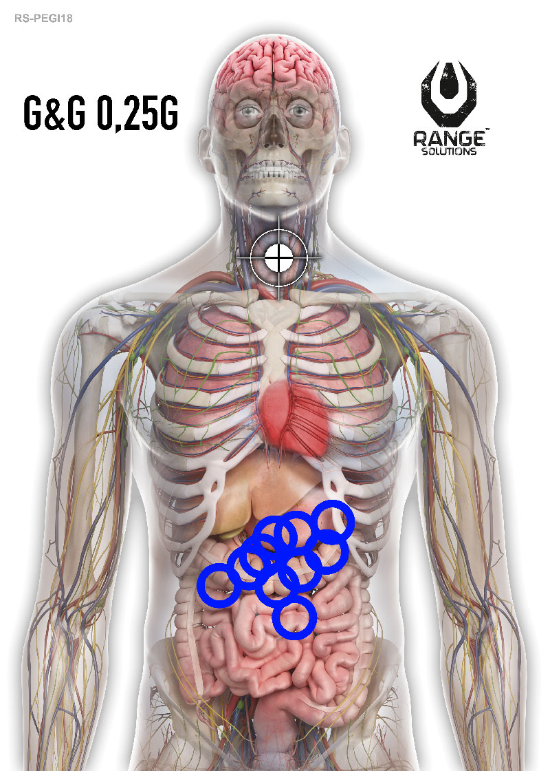

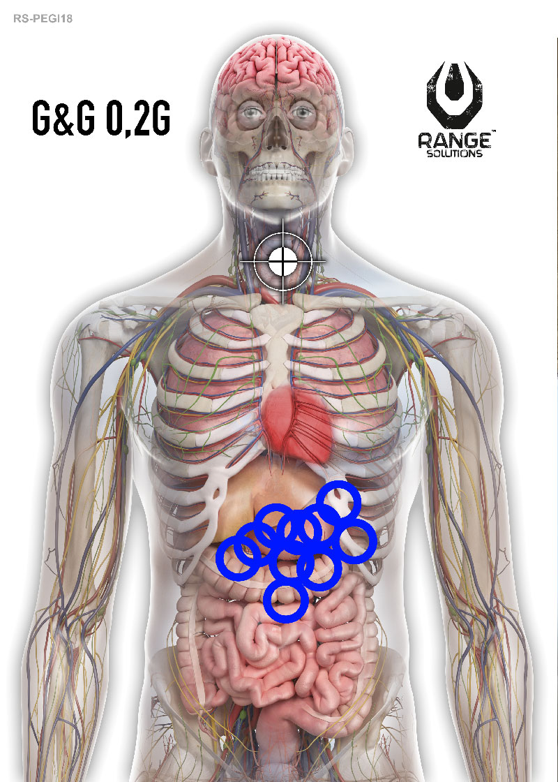

Comparison with 0,2 g G&G BBs:
and 0,25 g G&G BBs:
Whereas in the case of muzzle velocity the differences between Core and G&G BBs were very small, the difference in grouping is very noticeable. What is the cause? The only possible cause might be the quality (uniformity) of the plastic the BBs are made from. The plastic in G&G product must be more uniform, lacking microbubbles of air, which results in very similar, predictable trajectory of each BB. The geometric centre must be closer to the center of mass of the BB. In the budged product of Specna Arms the grouping is wider but still acceptable for support weapons and many assault rifles. Despite all of the above there is always the question of "quid pro quo" - in this test we compared popular budged level BBs with one of the best BBs available on the market. Bearing that in mind I think that the Core Specna Arms BBs fared surprisingly well.
