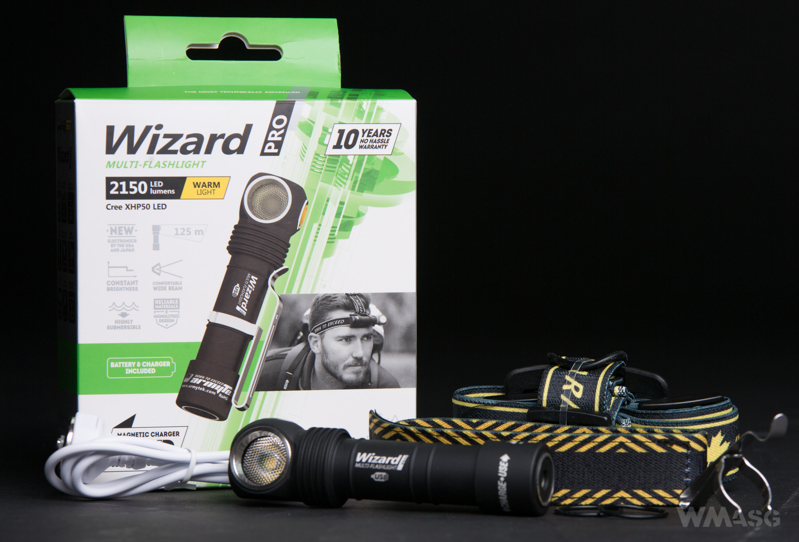

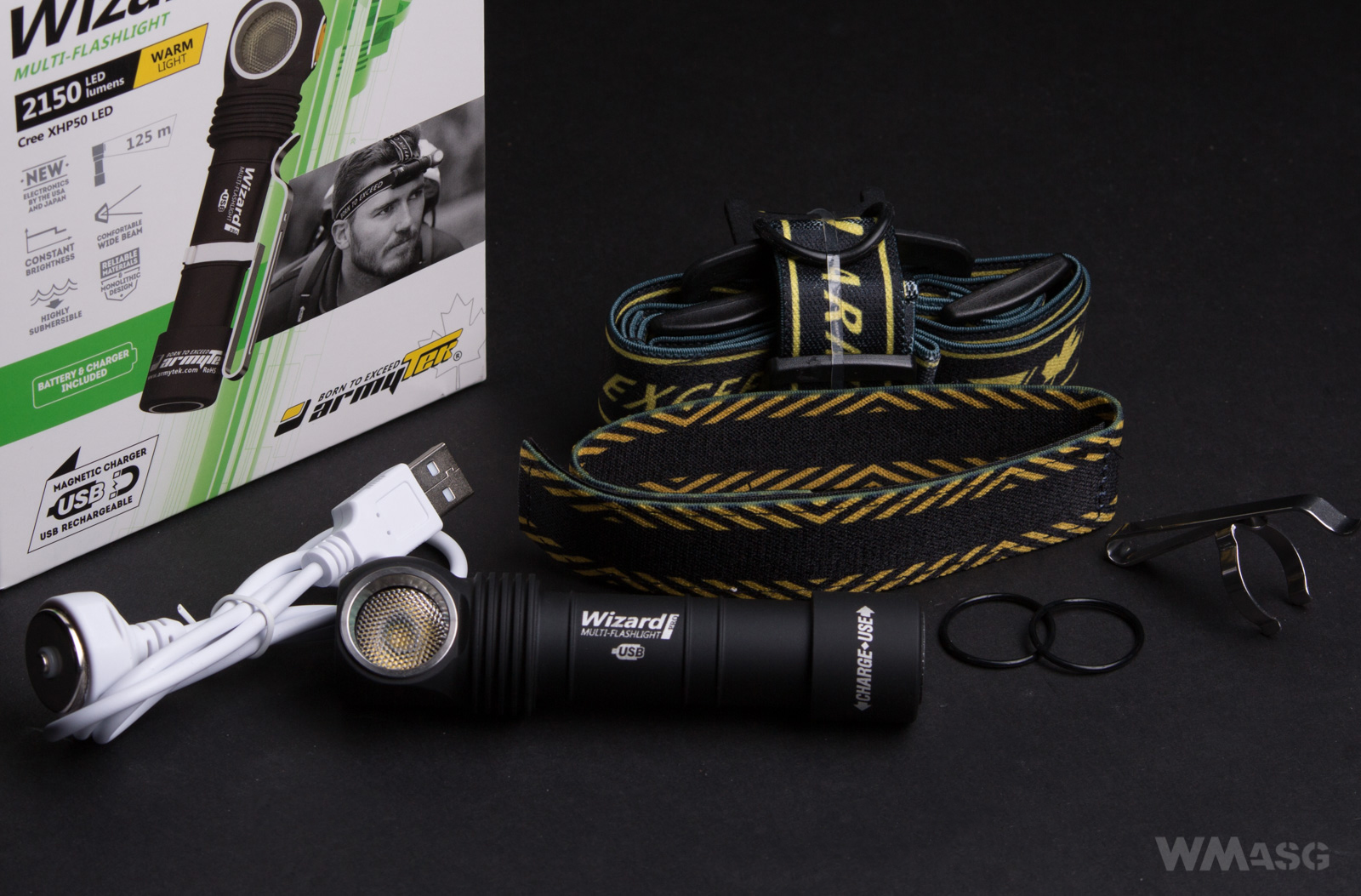

PACKAGING AND CONTENTS OF THE SET

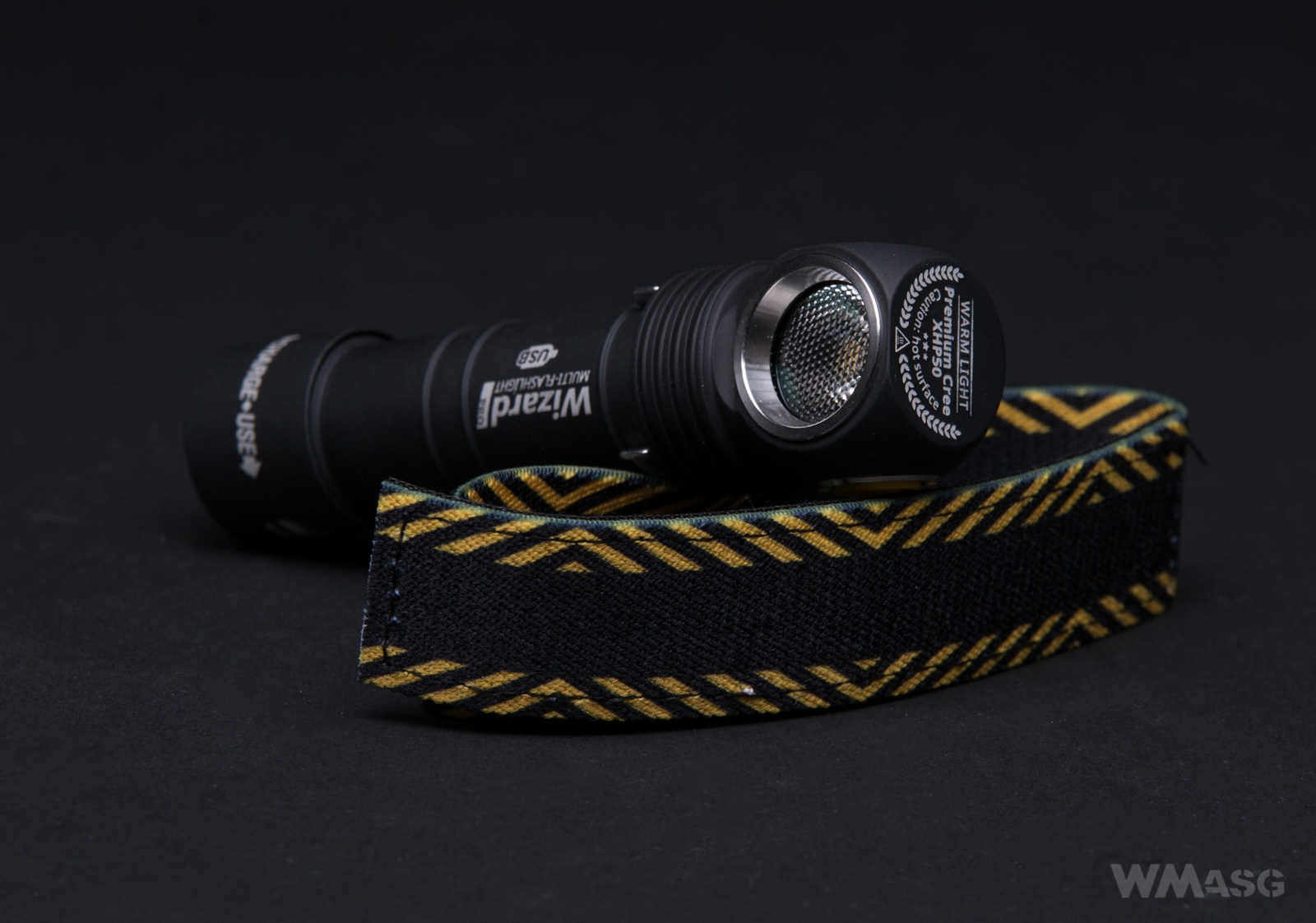

Armytek Wizard Pro USB Warm flashlight, with its whole set of accessories, is packed in a modest cardboard box. It is maintained in pleasant, white and green colors and perfectly fulfills its marketing and informative role. The quantity of technical details concerning the product, its features and specs printed on the box, presents an almost complete list. Inside the package, the kit parts are placed in a blister. In the context of the packaging itself, everything is done correctly. I would be even better if the manufacturer had decided to put the flashlight and its components in a small case so that you can always have them with you.

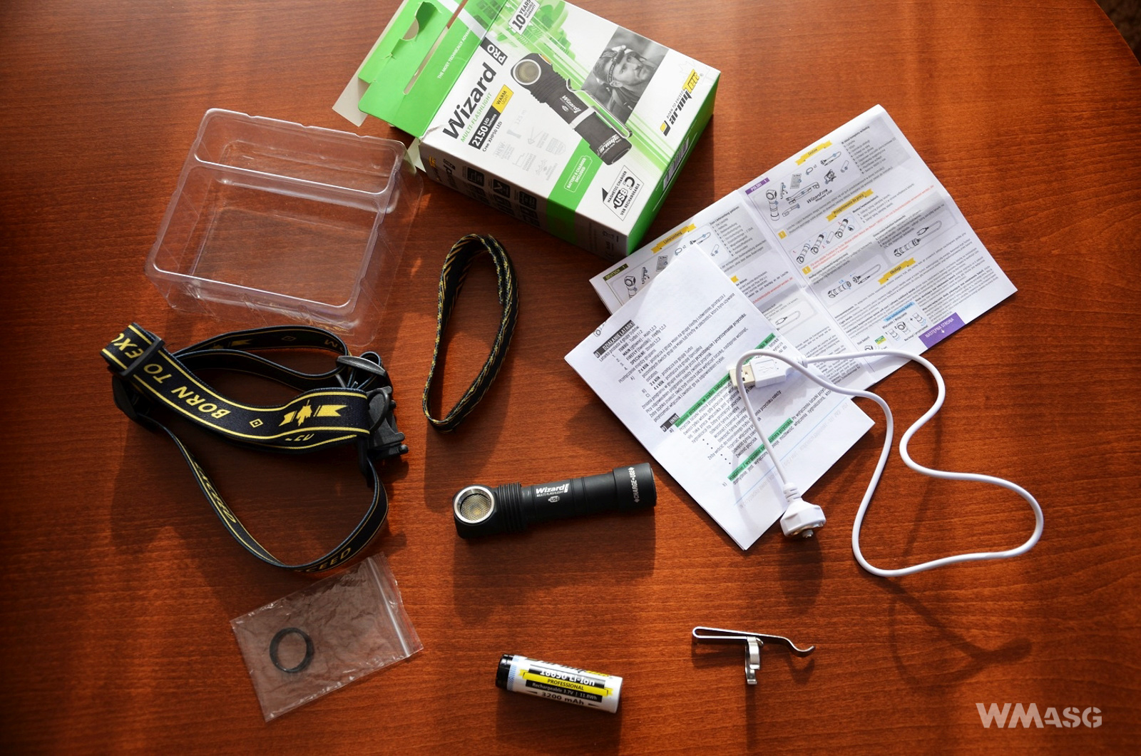

In addition to the light itself, in the packaging the buyer will find a detailed illustrated instruction manual in Polish, spare o-rings, a head mounting strap, a clip, a wrist strap, a battery and a magnetic charger.

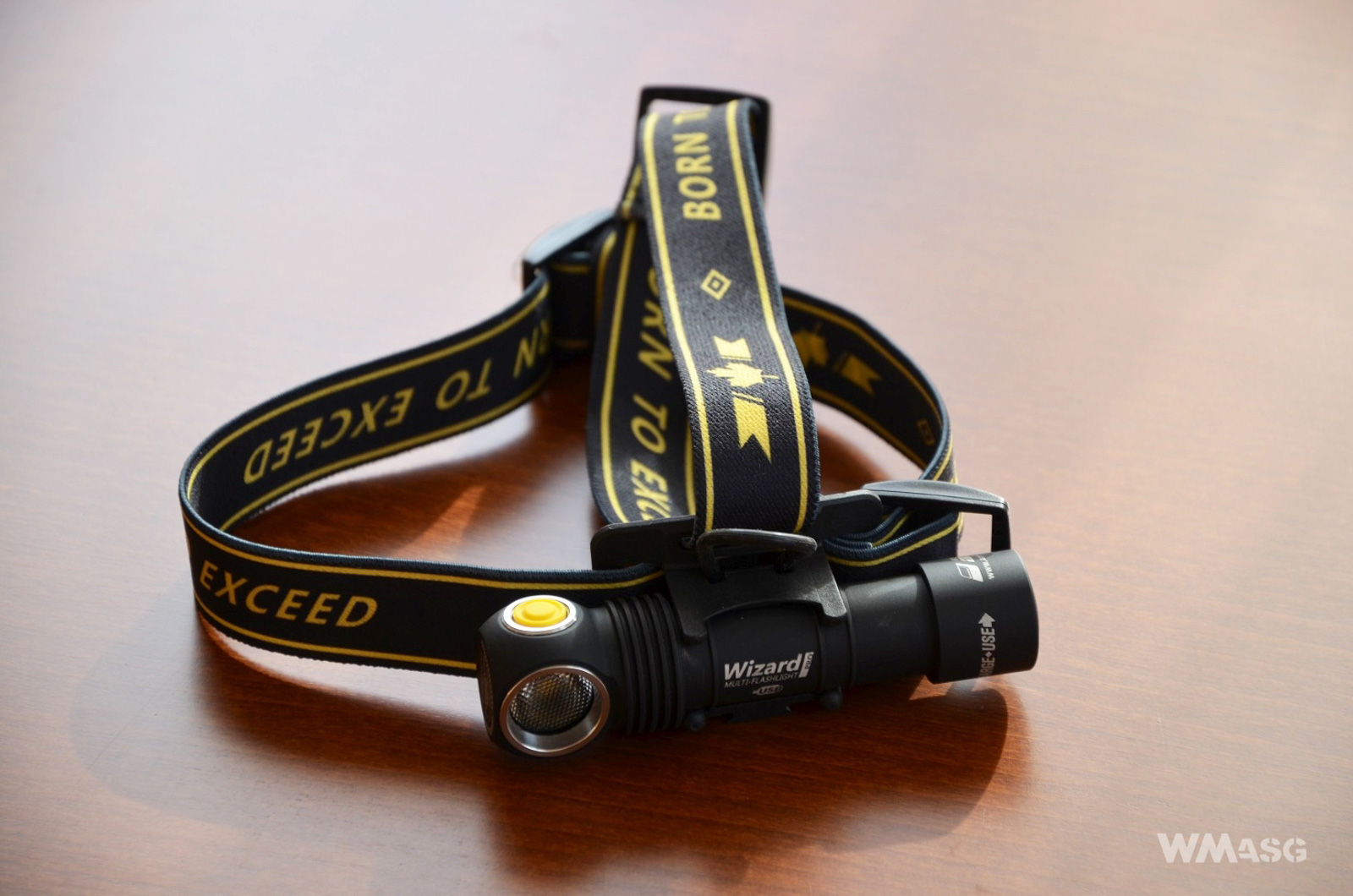

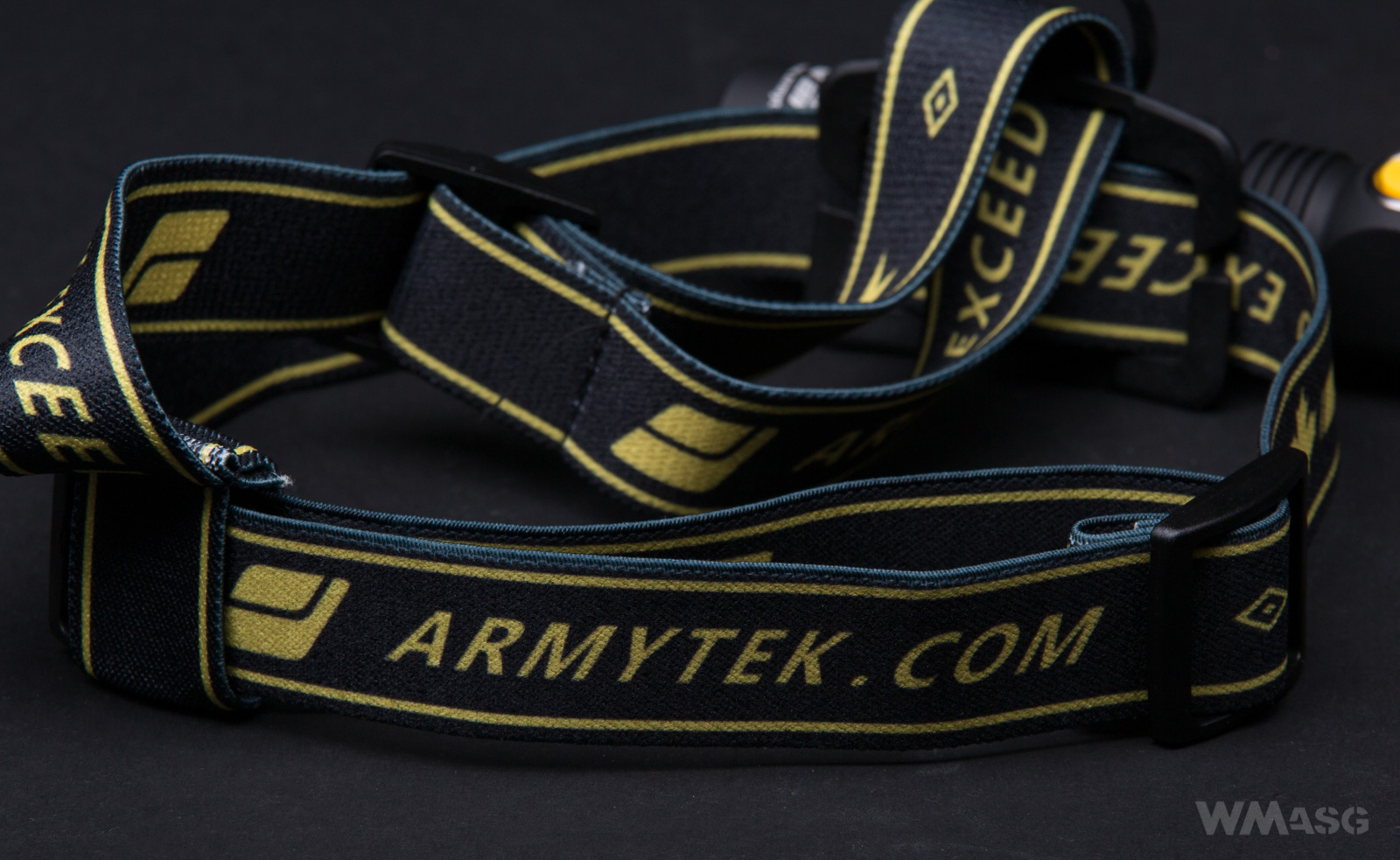

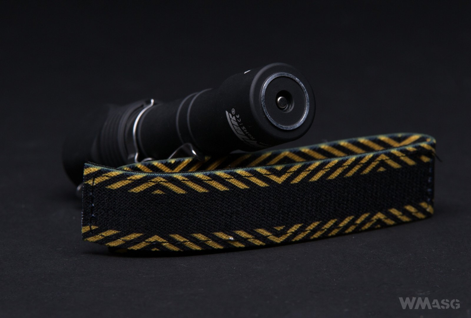

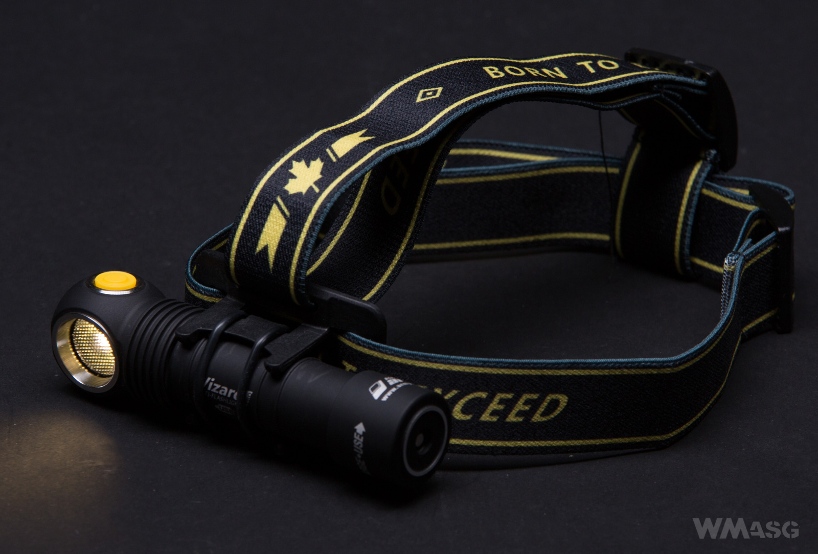

The head mounting is made of elastic straps in yellow and black colors. The plastic buckles allow you to carry it along with an additional strap passing through the top of the head. Due to the slightly higher weight of the Wizard model, in comparison to the more compact headlamps, the use of this centre strap may be necessary. The head mounting itself has is adjustable, fits well and does not slip of ones head. In the front there is a plastic clamp (which gives the impression of being durable), to which the flashlight is mounted.

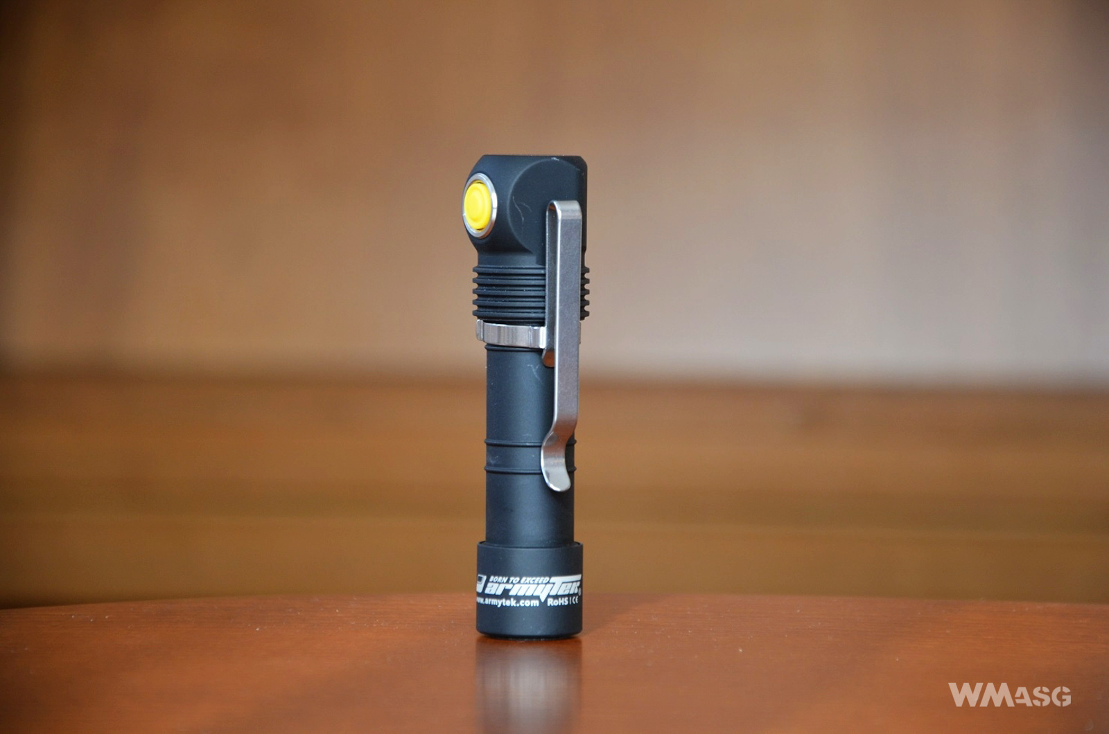

Alternatively for the head mounting, a steel clip can be used. It's well made, it snaps on on the flashlight firmly and it's difficult to take it off.

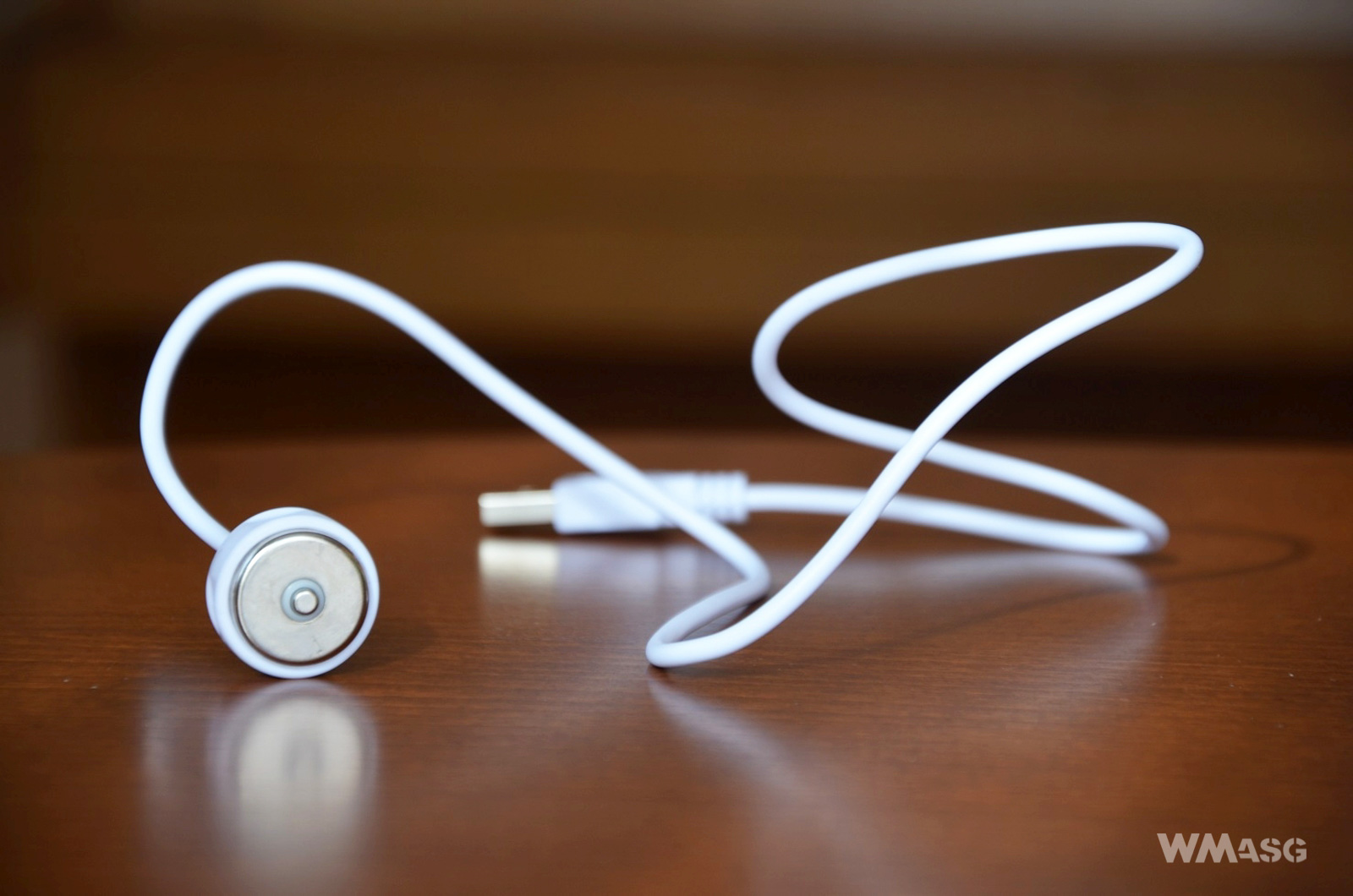

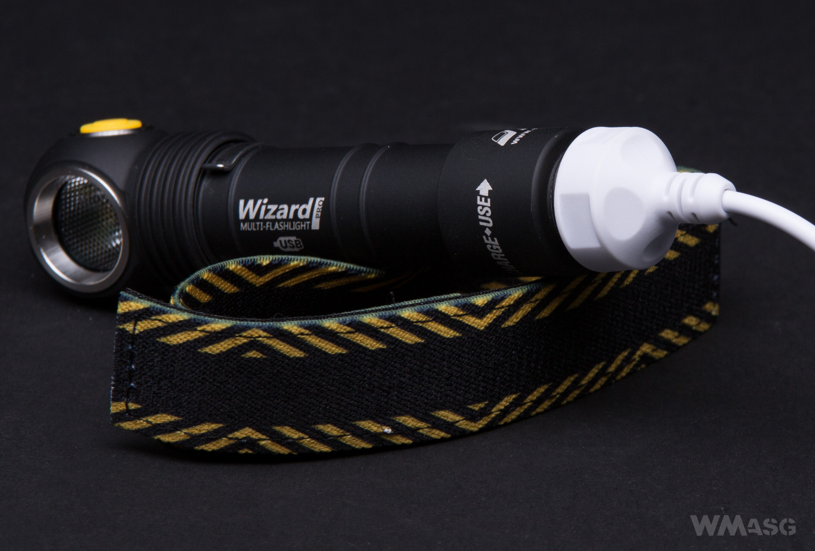

A very useful part of the set is the already mentioned magnetic charger. On one side it ends with a module that has a magnet that works with the flashlight, and on the other side is a USB plug. Thanks to this, you can use it both with the phone charger, as well as directly, e.g. with a computer. The charger is equipped with a two-color diode, which informs us about the state of the charging process (green color means that that charger connected to a power supply or that the charging process has ended, red: charging is in progress, flashing red: the flashlight is not in charging mode).

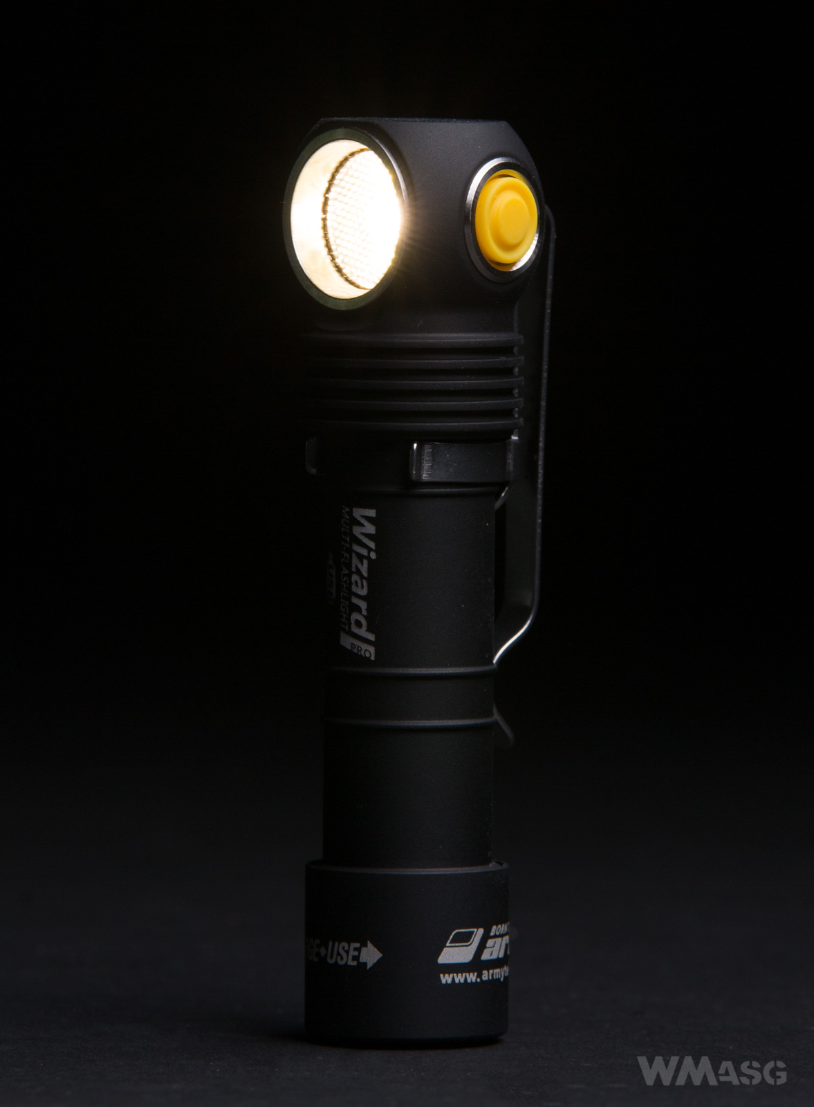

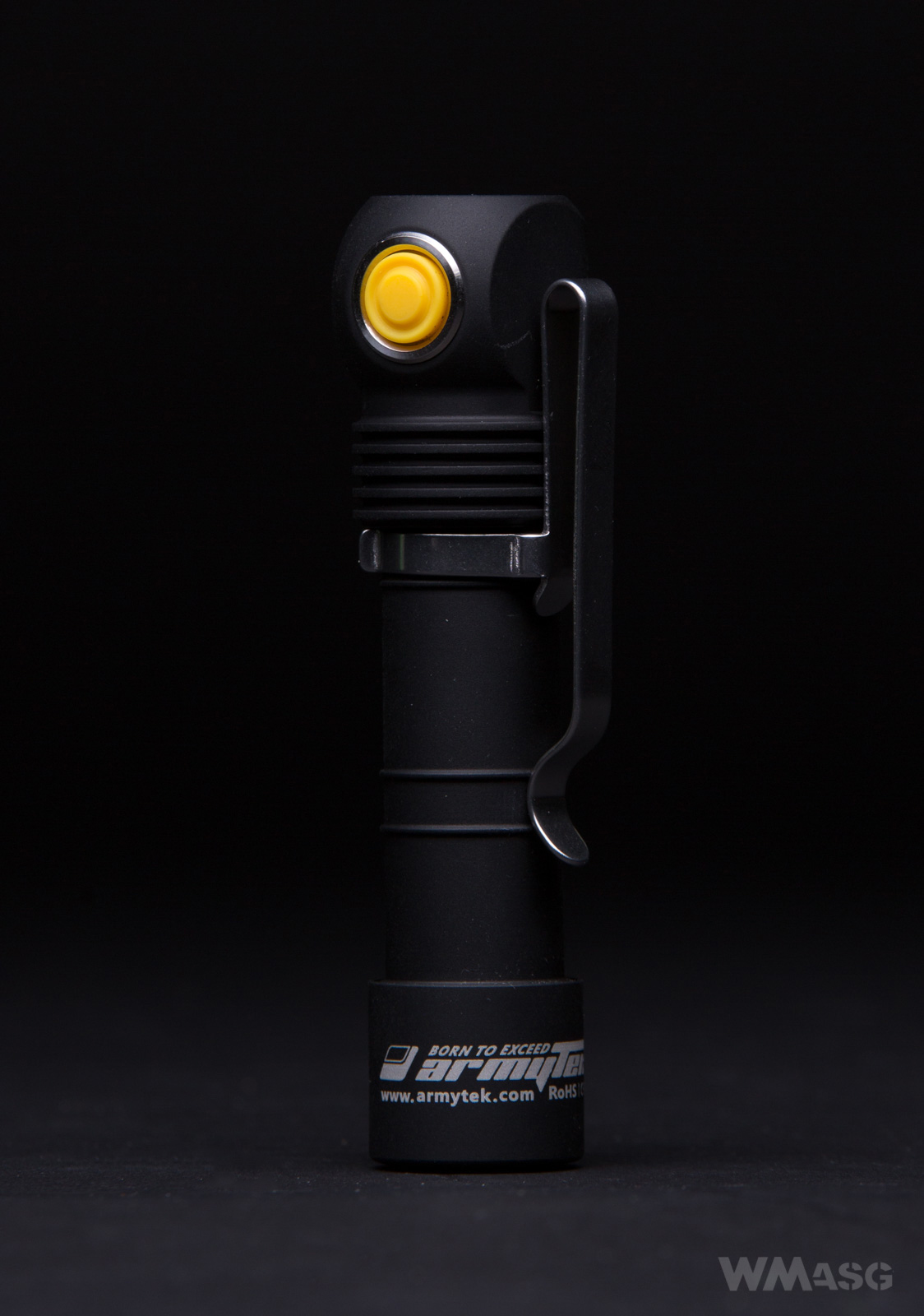

DESIGN AND MANUFACTURING QUALITY

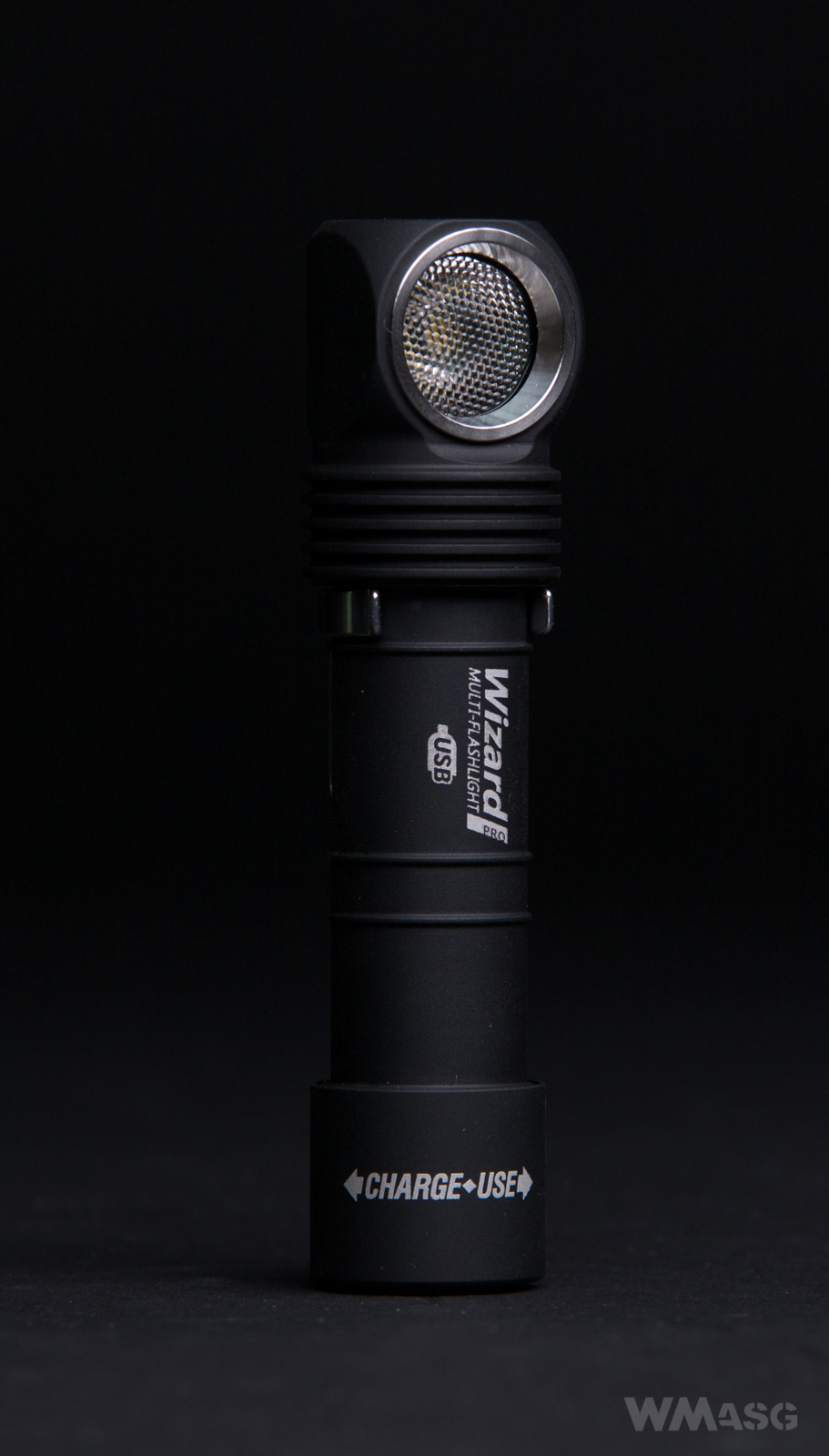

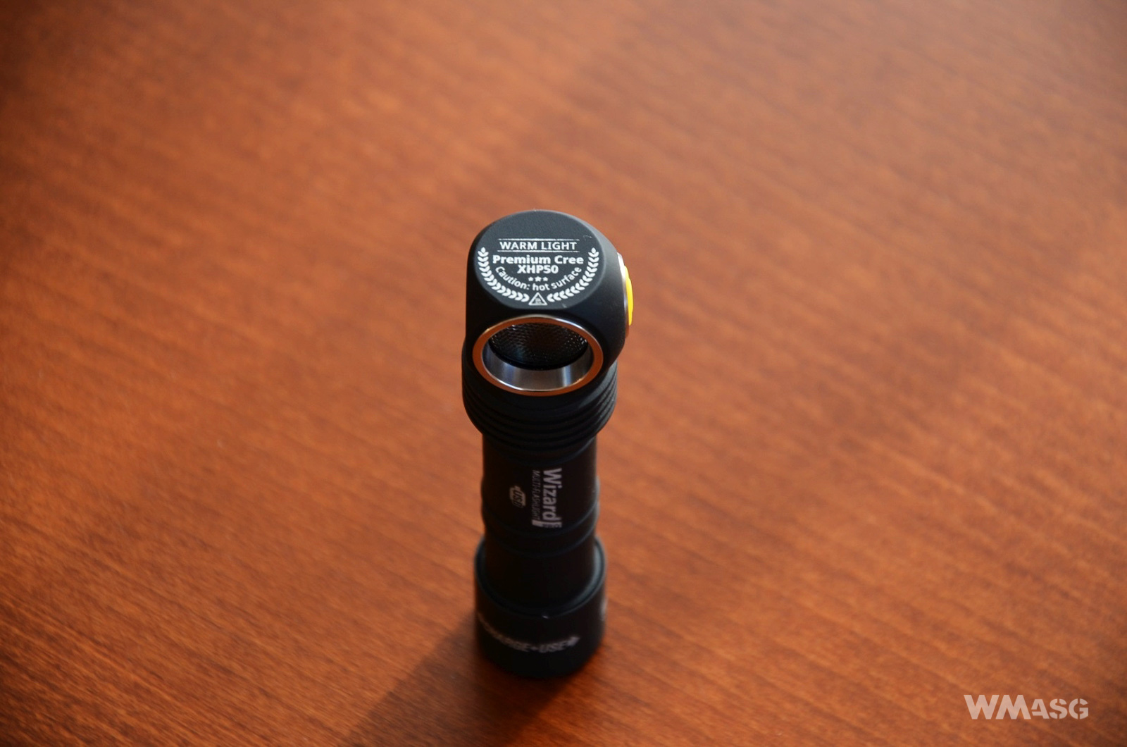

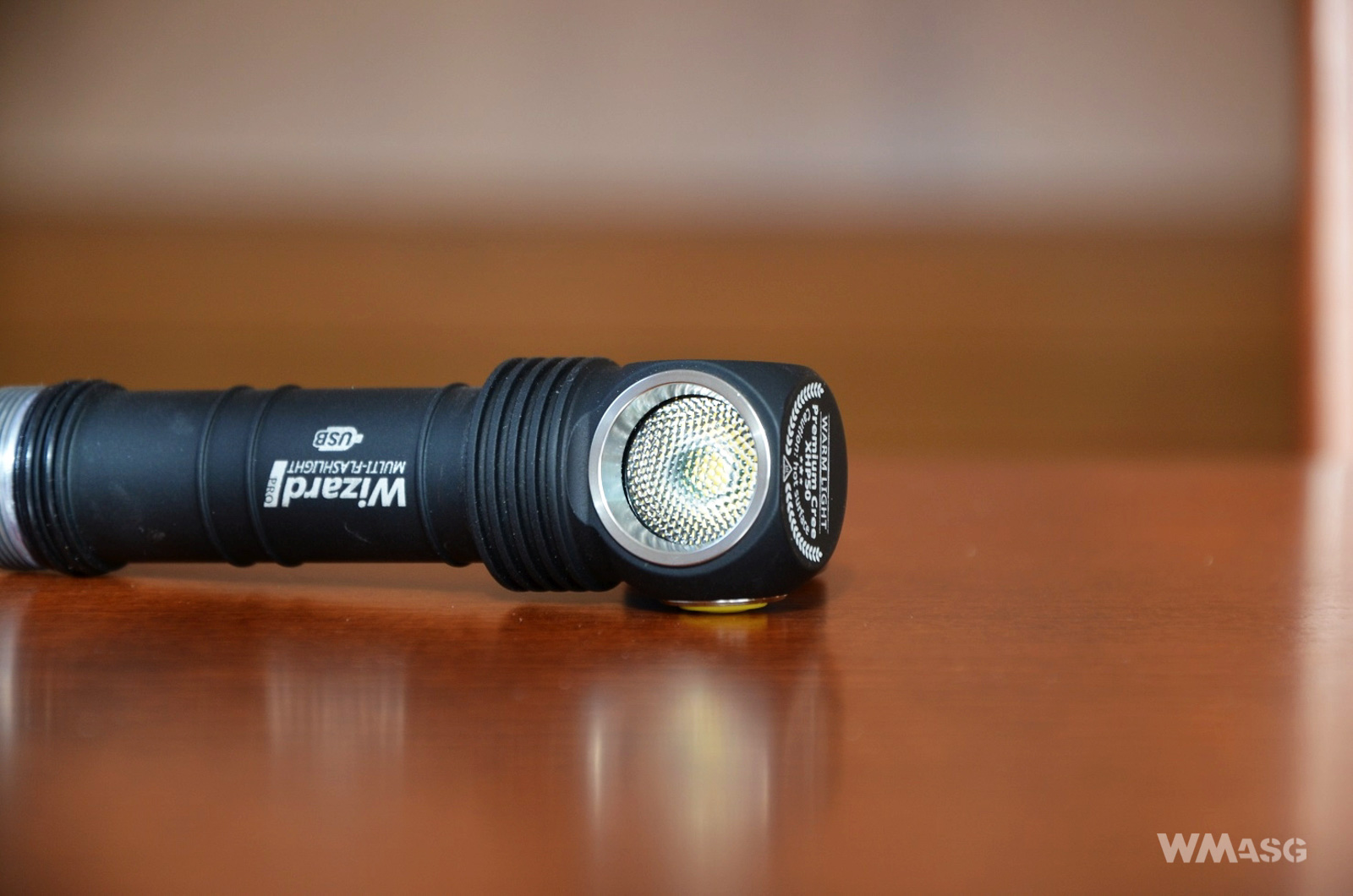

The Armytek Wizard flashlights (there are several models differing in the diode used, programming possibilities and the spectrum of light produced) have a design characteristic of headlamp/angle flashlights. What distinguishes such flashlights from others is the placement of the optics and emitter on the side of its head, instead of its top. Such design allows both to mount the flashlight on an appropriate head mounting as well as fastening it with a clip onto your gear. However, it is practically impossible to mount such a flashlight on a weapon or its replica in any useful way.
According to information found on the Internet, this equipment is made of durable aircraft grade aluminum coated with an anodized, matte coating. The design is compact, devoid of any clearances and gives an impression of being very robust . It can not be otherwise, given that the manufacturer declares that flashlight is resistant to falls from a height of up to 10 meters. The Wizard consists of three main parts: a rear cap, a tube and a head. Each of these parts is very thoughtfully and carefully designed because, in addition to aesthetic issues, all parts play an important role in the operation and functionality of the flashlight.

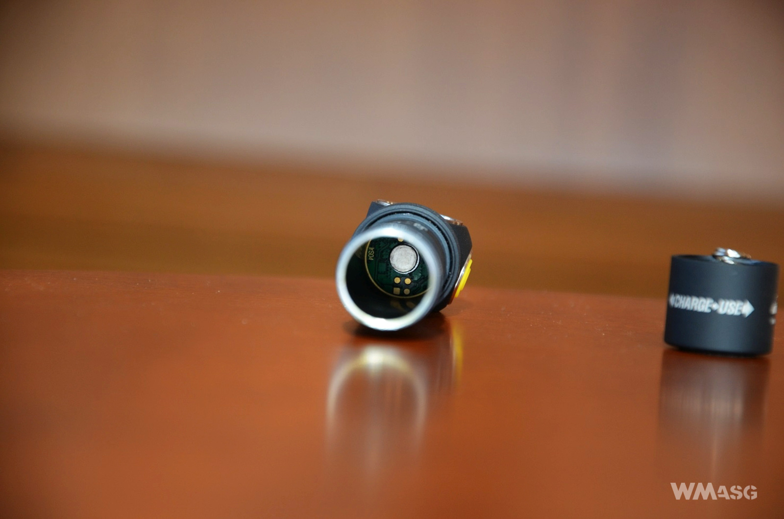

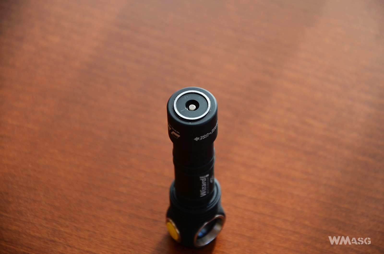

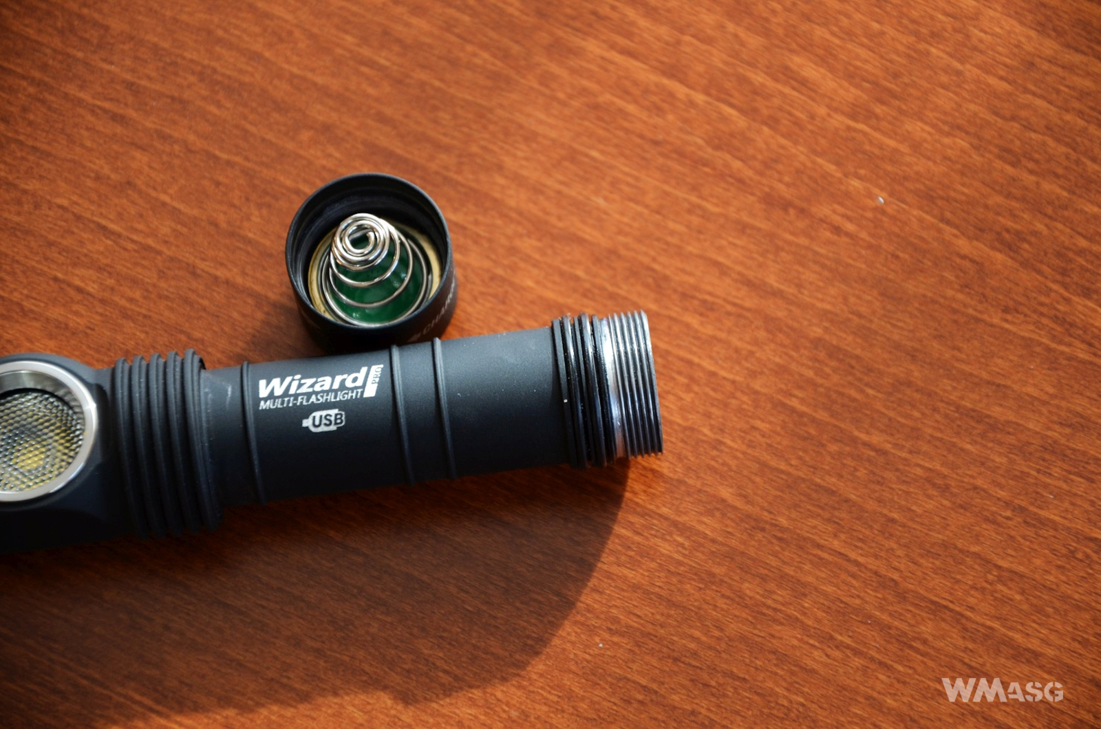

The rear cap unscrews and turns silently and with a clear, uniform resistance. The thread is made very precisely. The diameter of the cap is 24 mm, and its length is 21 mm. On the side wall you can find the manufacturer's logo, basic information about the standards it complies with, as well as a concise graphic reminding you to slightly loosen the back nut in order to charge the battery inside the flashlight. The nut works with the magnetic charger from the set, so that it is possible not only to charge the device without removing the battery, but also to charge another standard 18650 or 18350 type cell (the manufacturer provided such a possibility and put an appropriate annotation in the manual).
And that are not all the functions that the cap provides to the flashlight. Due to its flat bottom and good balance of the whole flashlight, it is possible to use the light "in candle mode", which means putting it vertically. Not only that, as the manufacturer has put a strong magnet in the cap! This is not a very useful function in airsoft, but when using the flashlight as an EDC (everyday carry) device, it will certainly be useful many times during various small jobs, when the Wizard can be attached to many metal surfaces, both horizontal and verical.
The rear cap also influences the way the flashlight works and is programmed. This can be read in the further part of the article describing on the operation of the device.
In addition to all these goodies, the rear cap also fulfills its basic role, that is, provides access to the inside of the tube, which in turn is a compartment for a 18650 battery (as well as a 18350 battery or two CR123 batteries).

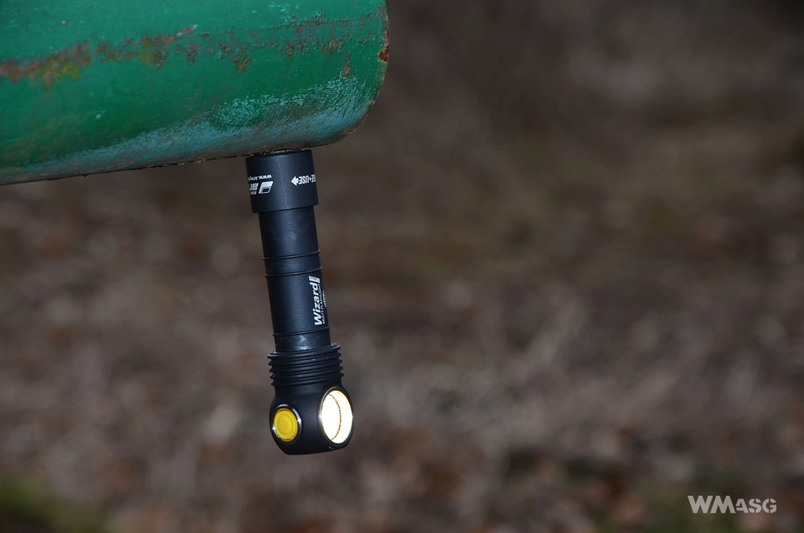

Another part  of the Armytek flashlight is its tube. Its length is about 65 mm, and the diameter on most surfaces: 20 mm. In another piece of equipment it would probably be an ordinary tube, not worth much attention, but not here. In addition to the model logotype of the flashlight (Wizard Pro Multi-flashlight USB), you can find on it two grooves which act as support for the mounting clip or for the dedicated head mounting. Both types of mountings fit perfectly and stiffen sufficiently to maintain mental comfort of not losing the flashlight. There only thing to remember. You can use either the clip or the head mounting, you can not mount them both on the flashlight at the same time.
On the connection side with the rear cap, the tube thread is double-sealed with o-rings and a lubricant. According to the manufacturer's assurances, the Wizard flshlight can withstand 2 hours of continuous immersion in water up to a depth of 10 meters.

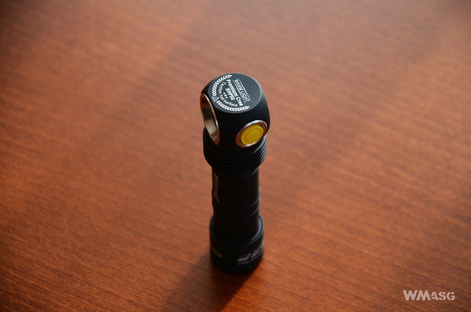

The last part of the flashlight is its head. It has a very characteristic shape: on the side of the connection with the tube one can see several ribbed rings that act as a heat sink, while the actual part of the head resembles a cube with rounded sides. The front side houses the TIR optics with knurled lens that facilitates even distribution of light. Behind it lies the heart of the flashlight, a relatively modern and efficient CREE XHP50 LED emitter. On the neighboring (left from the optics) side there is a rubber switch (yellow in color). This single button, together with the rear cap, is responsible for the full control of the flashlight functions. Armytek made sure that the Wizard's switch could communicate with the user and equipped him with a two-color illumination that fulfills many functions (details later in the article).
The upper part of the head is adorned with the information that the CREE XHP50 LED is a premium class emitter and that the flashlight itself is a Warm version, characterized by a warmer color of light. There is also a warning about the hot surface of the head.

To start using the Wizard flashlight, unscrew the rear cap and insert the popular 18650 battery into it. The plus polarity pole is located on the side of the head.
The manufacturer supplies the set with a high quality Li-Ion 3.7V 3200mAh battery, without a PCB protection. It is flat top type (with a flat plus pole), but you can use a standard type cell instead.
After inserting the battery, tighten the rear cap. Unscrewing it by 1/4 turn will switch the flashlight into the standby mode for charging, as well as protect it against accidental activation.
The charging process is simple. To start it, attach the included USB charger to the top of the rear cap. The charging time will be marked by a red charger LED, green LED means a full charge, and if the user forgets to loosen the read cap, the charger will inform him about it with a pulsating red light.
