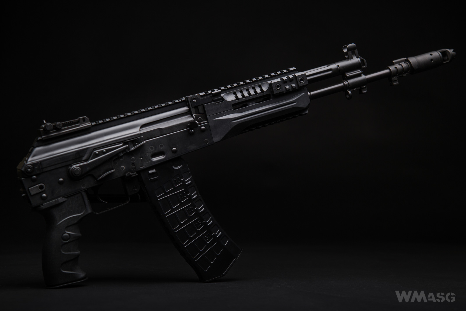

Basic parameters:
- total length (folded/unfolded buttstock): 685/945 mm;
- length of the inner barrel: 435 mm;
- mass (without the battery and with an empty magazine): 3800 g;
- power supply: stick battery placed under the receiver cover;
- magazine capacity: mid-cap holding 130 BBs;
- muzzle velocity (using 0.2 g BBs): about 390 fps.

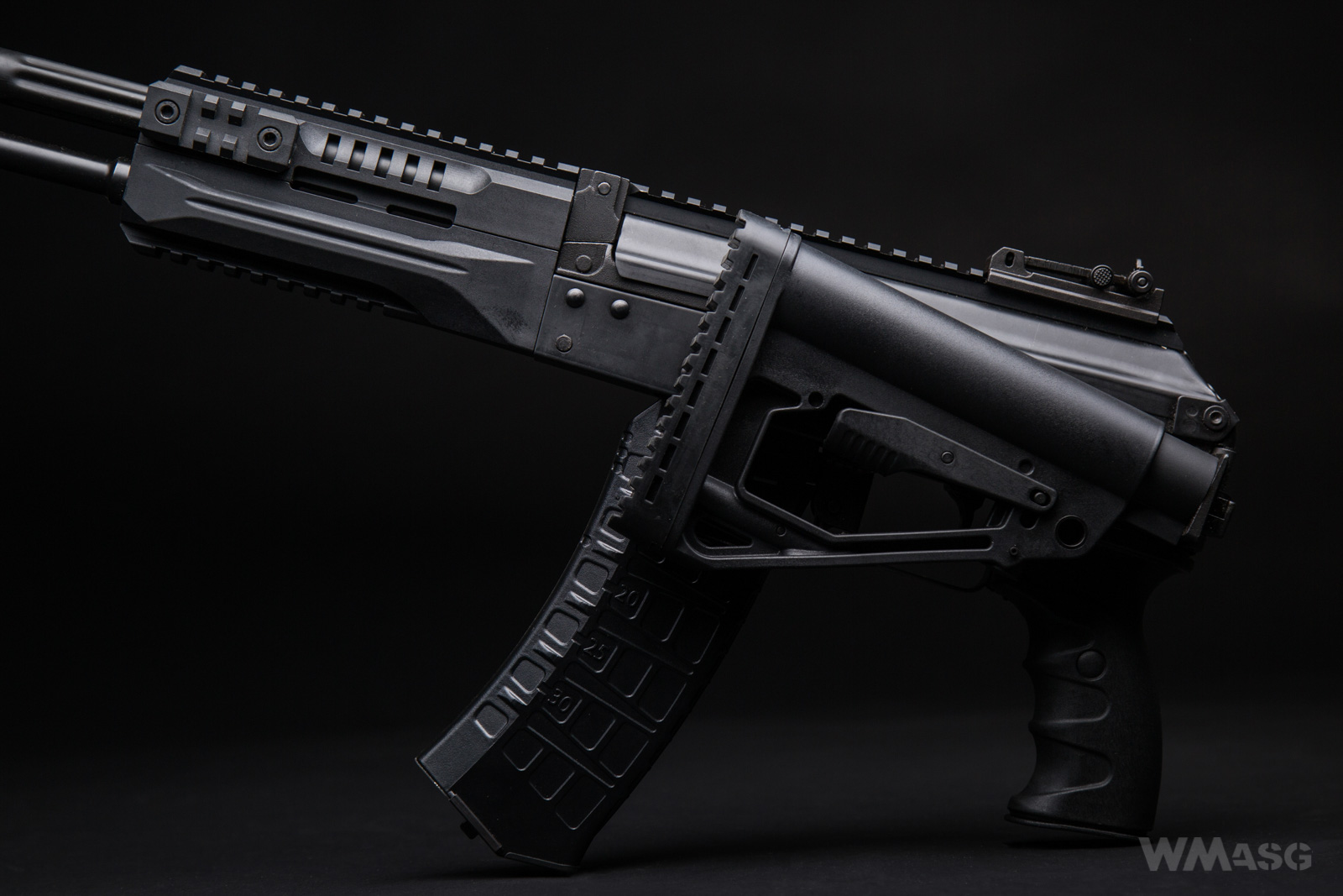

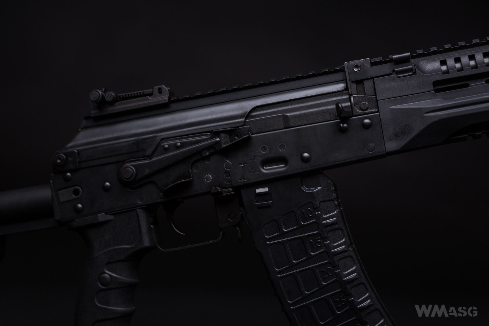

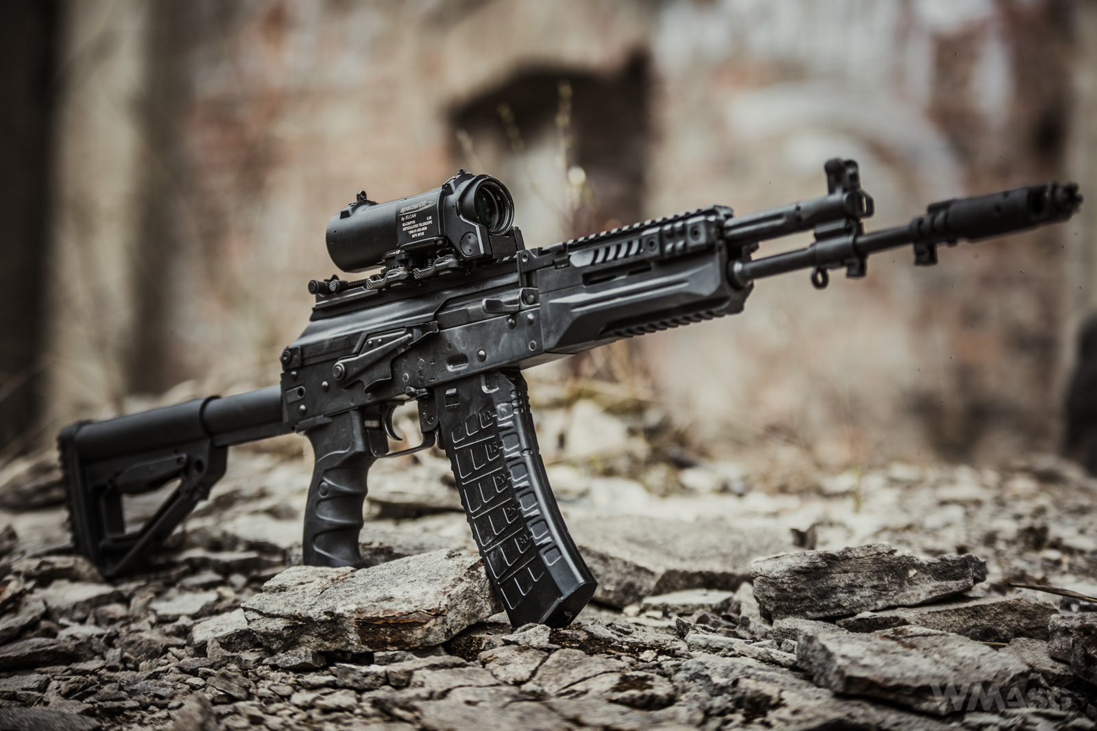

First impression
For someone who does not like AKs as a principle, the replica will not make a great impression. It ill be just another AK (as if other ARs were not just another AR). I respect the AKs. And I like them. For me, this AK-12 is amazing. Steel, oxidation, steel, oxidation, hard polymer. After taking into my hands, the impression does not go away. The weight does its job (the replicas slightly heavier on the barrel side). Then it comes to ergonomics, the AK-12 is still lacking, although the possibility of adjusting the length of the buttstock certainly a good thing. But, once again. this is a Kalashnikov carbine.
Of course, I could not compare the replica with the real carbine. Nevertheless, by looking and taking the replica in my hands I have the impression that it is very "believable".
Shooting it also does bring any surprises. It is still a replica of an AK. There are no inventions or controversial solutions in therms of airsoft technology. It is used in the same manner that I've been used to for many years. And it can not be otherwise, because the Russians themselves, after many years of attempts, have come full circle and the final AK-12 is basically a modernized AK-74M. Is that good? I do not feel competent to comment on the choices and decisions of Russian weapons specialists. I think they know what they are doing.

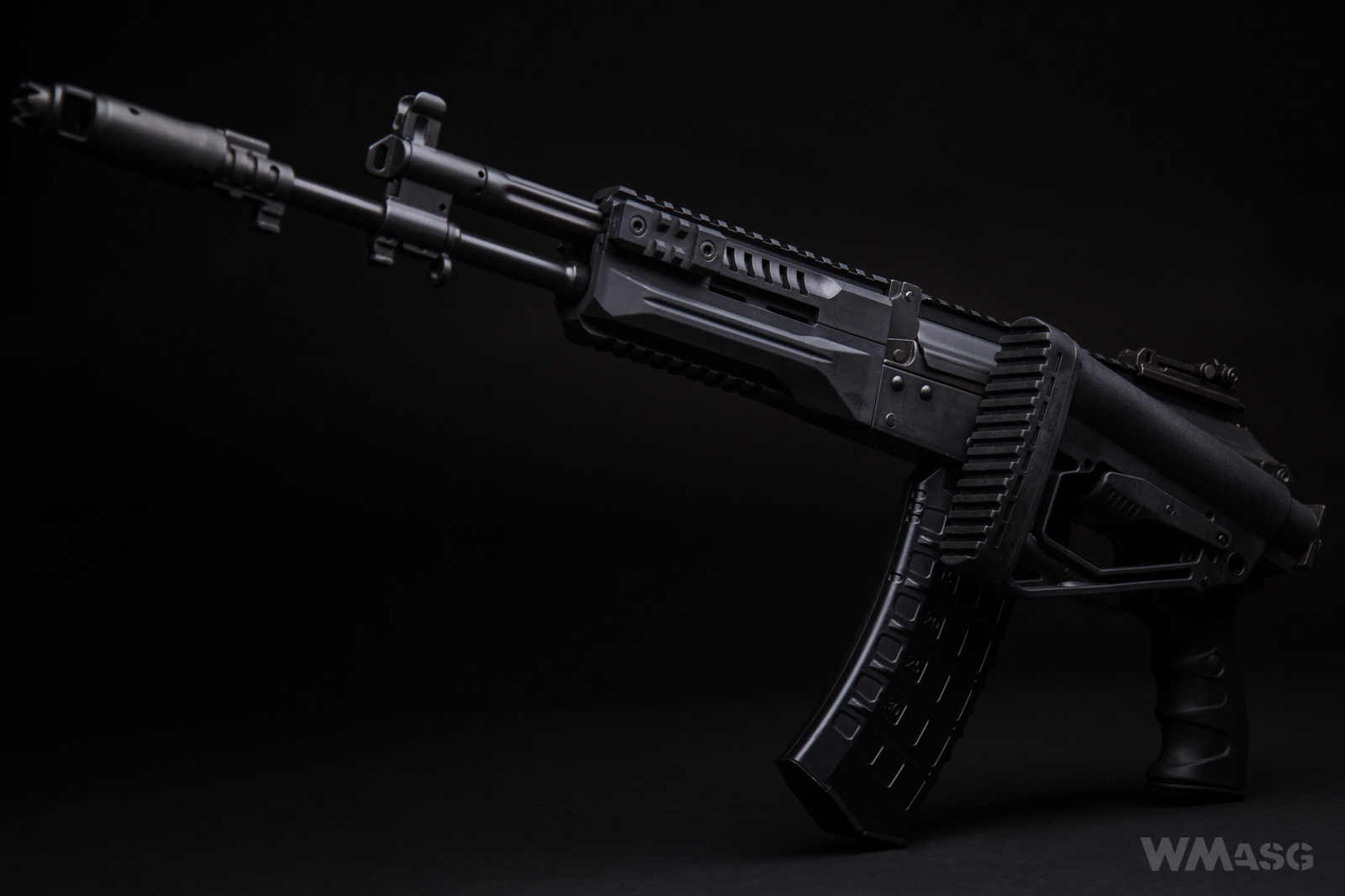

External design

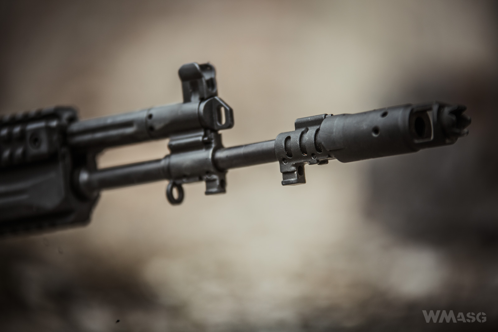

The flash hider

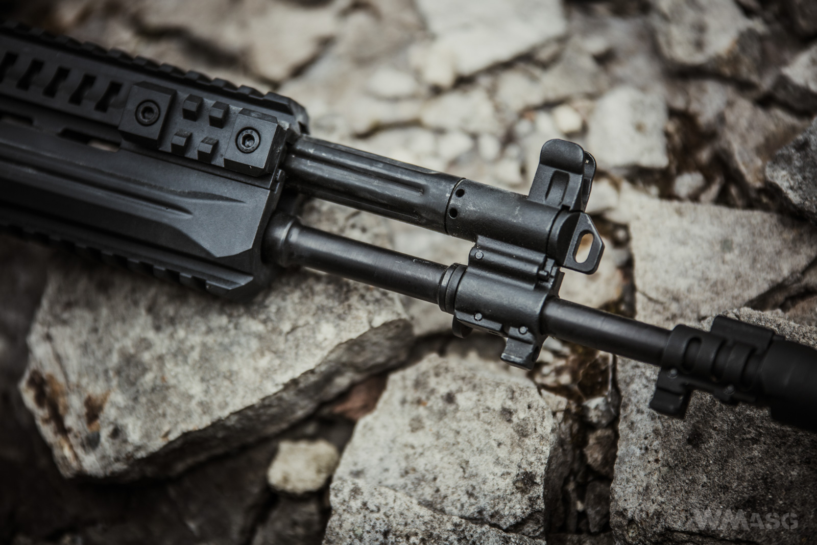

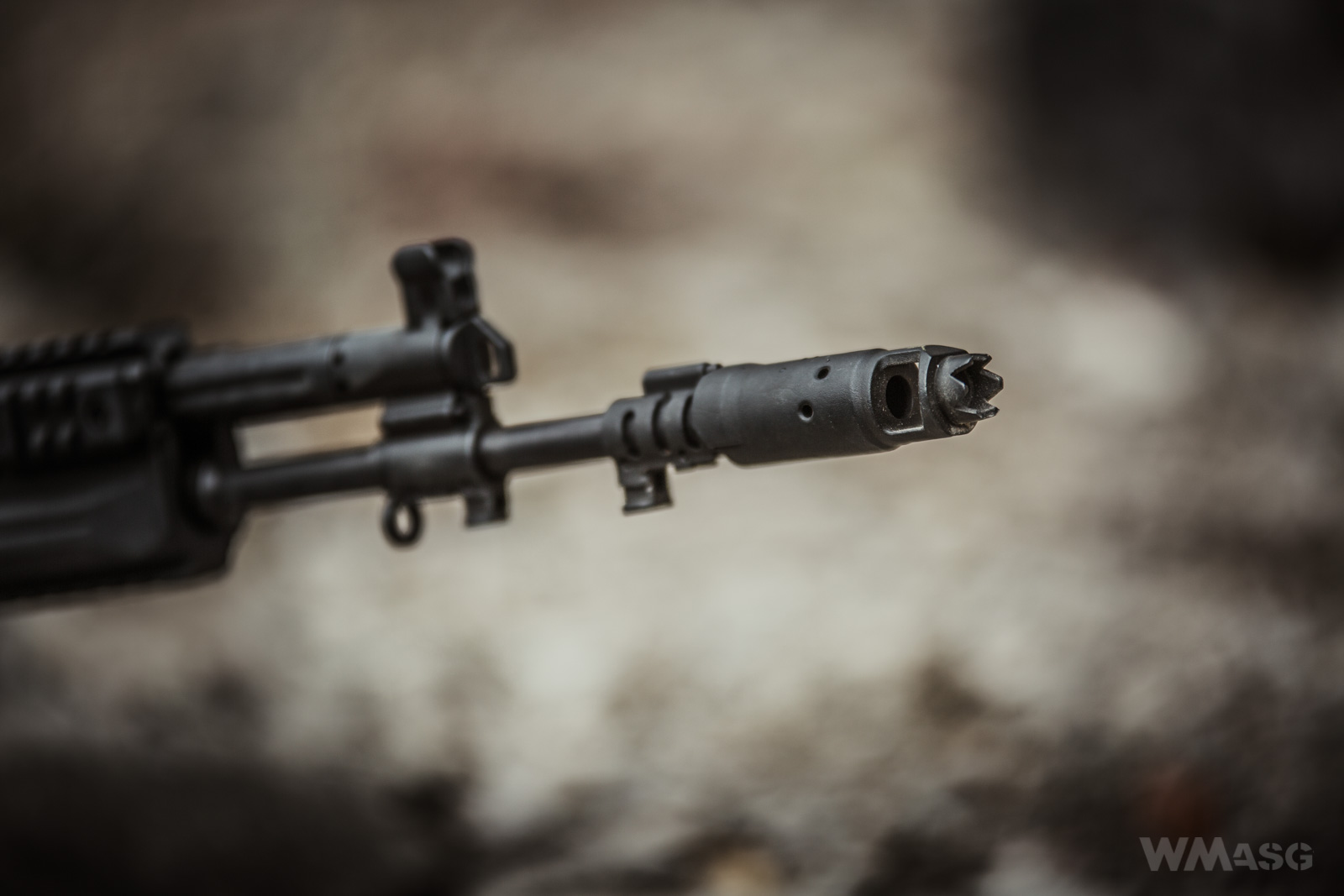

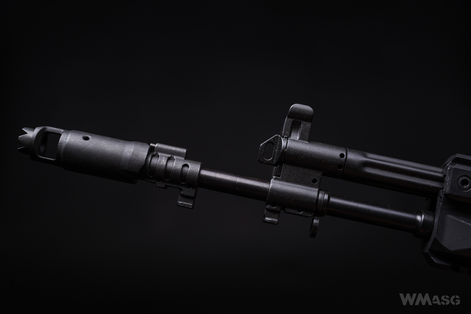

Starting from the front. The flash hider is somewhat reminiscent of the one used in the AK-74, but only slightly. The mounting method is fundamentally different. There is no thread here. After pressing the locking pin, you turn the hider by a quarter of a turn (to unlock it) and slide towards off barrel. As there is no thread you cannot used airsoft silencers. Until, of course, LCT launches a dedicated silencer for the replica. By the way, the fit is very tight, you have to really put a lot of effort to take it off.
The arrows indicate the parts that must be interlocked.
Here is the locking protrusion from a different perspective (the inner barrel has been take out):

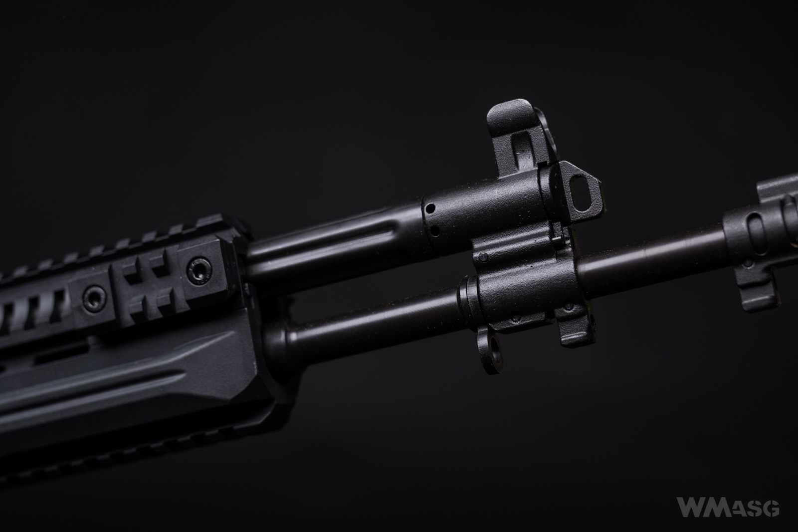

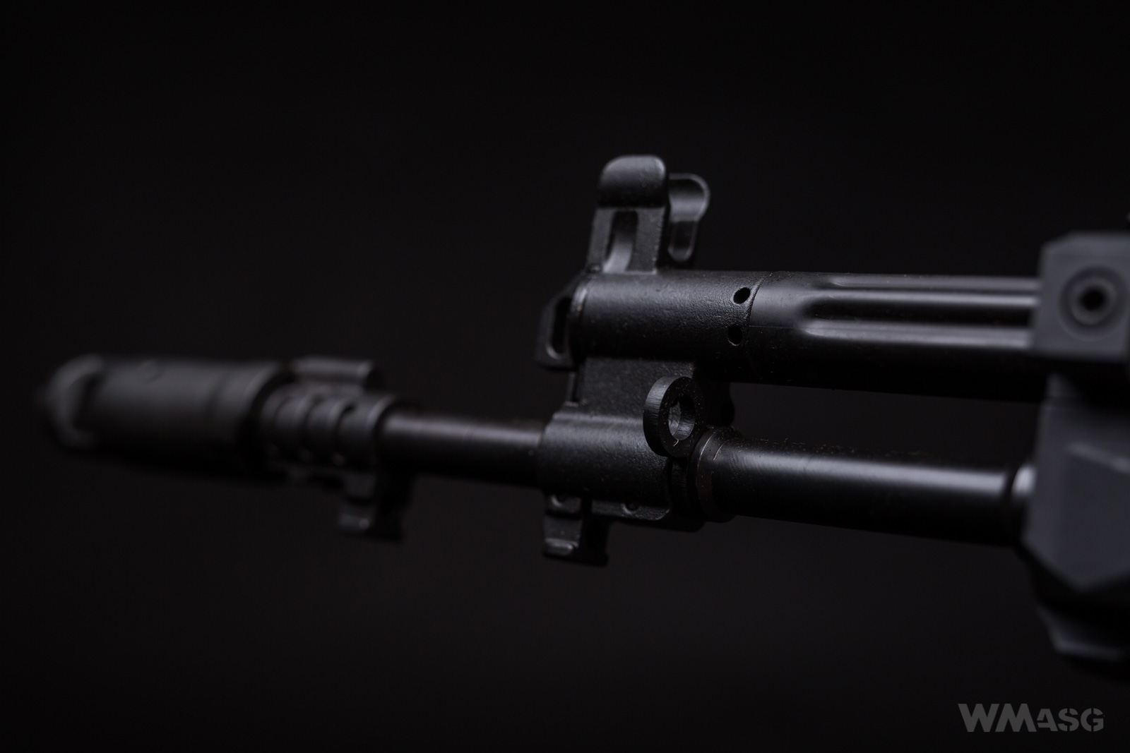

The gas block
Like all the parts at the end of the barrel, everything here is made of steel. The yellow arrow indicates the carrying sling attachment point that rotates around the barrel. The red arrow, contrary the appearances, is not a gas block regulator, but an bottom of a gas pipe plug that can be opened. I will explain. The AK-12, unlike the earlier versions, has a permanently attached gas tube and it cannot be disassembled in field conditions. It was therefore necessary to equip it with a hole for cleaning and maintenance. The part indicated by the red arrow is closing this hole.
The red arrow below indicates a typical pin with a spring that is locking the plug in place. To disassemble it you have to press the pin, turn it by a quarter of a turn and than remove it.

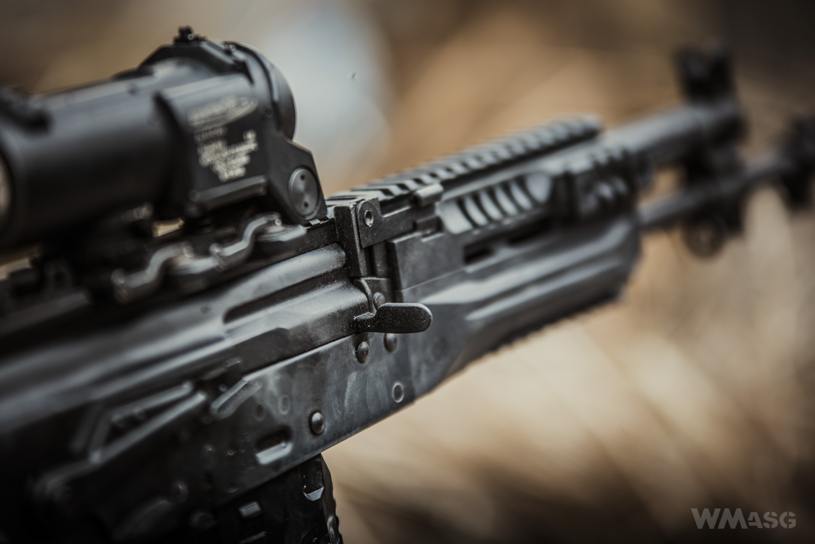

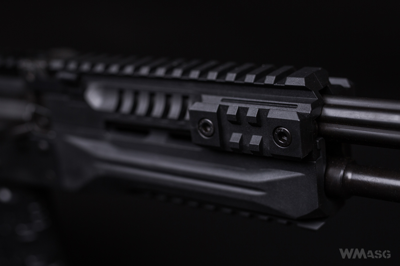

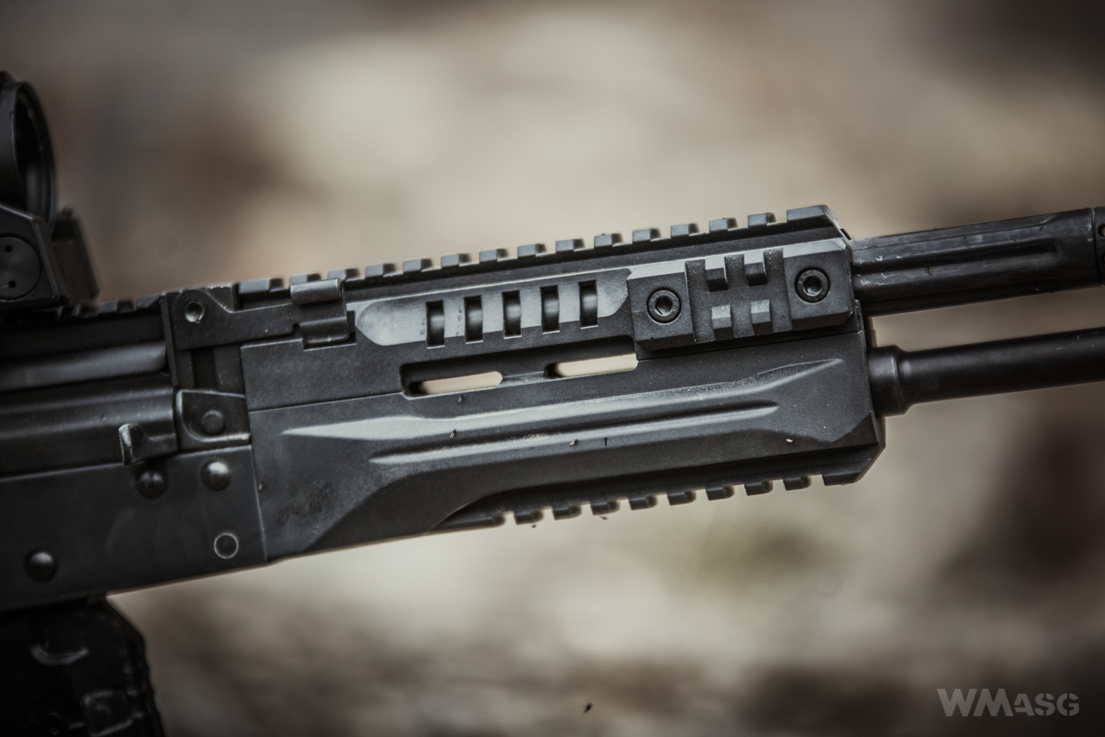

The lower and the upper handguard
Both parts are made of very hard plastic reinforced with microfibers. It looks so good that I would not be surprised by the military origin of this material. Bottom of the lower handguard is formed into one long Picatinny rail. Similarly with the upper handguard where the upper part of it is just a rail. The short side rails are detachable, but they can not be mounted elsewhere.

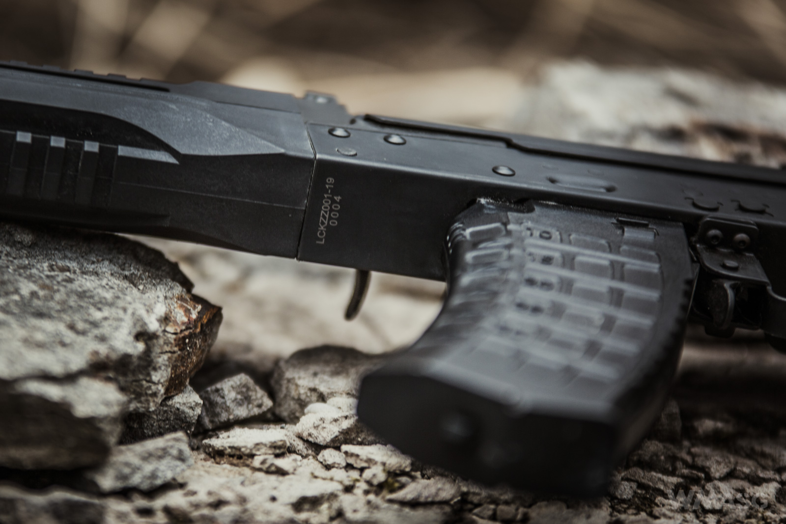

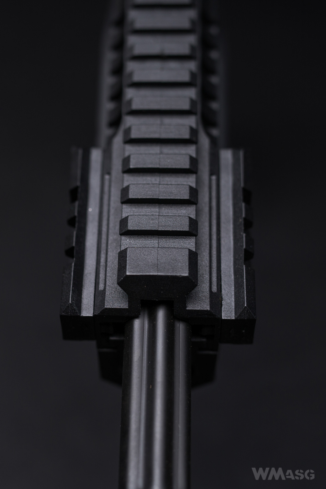

The mounting method of the lower and upper handguard on the carbine is completely different from those used so far. First of all, the AK-12 does not have a locking bolt for the lower and upper handguard. Secondly, the those parts, which are joined together, form a single part, which is attached to the carbine as a monolith. Thirdly, the whole is mounted with an additional pin that is a new addition to the AK-12.
It is done in the following manner. First the lower and upper handguard:
The method of connecting both parts is as follows. We put the upper handguard on top of the middle section of the lower handguard and it forward. Of course, it should be done on the barrel of the carbine as the assembled parts will not pass through the flash hider and the gas block with the front sight base atached.
The assembled part. At the bottom left the hole for the mounting pin is visible.
The red arrow indicates the location of pinning the lower handguard in the receiver. A bit higher, one of the few compromise simplifications that the LCT used. The pin that holds the barrel in the real carbine is a dummy in the replica.The receiver

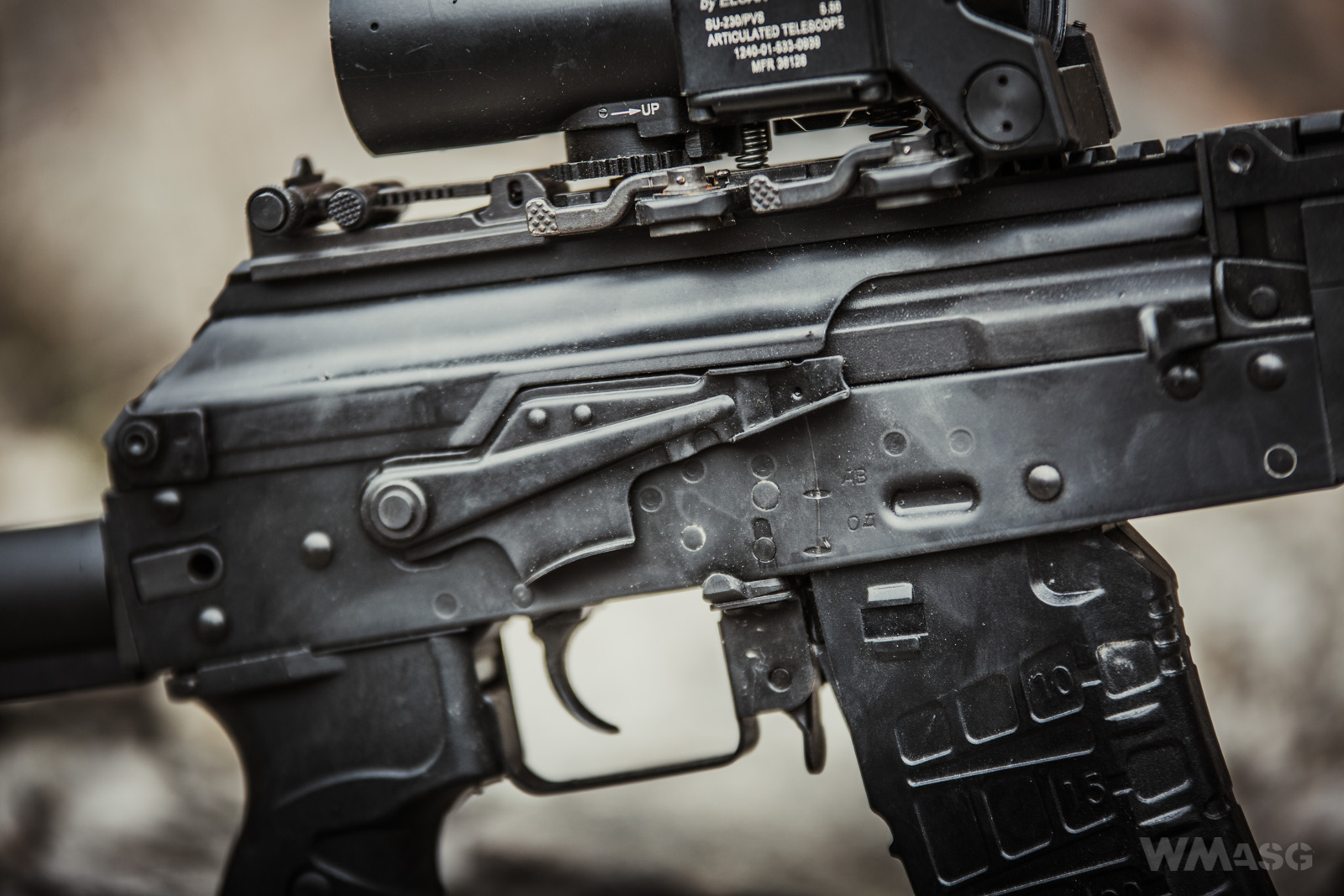

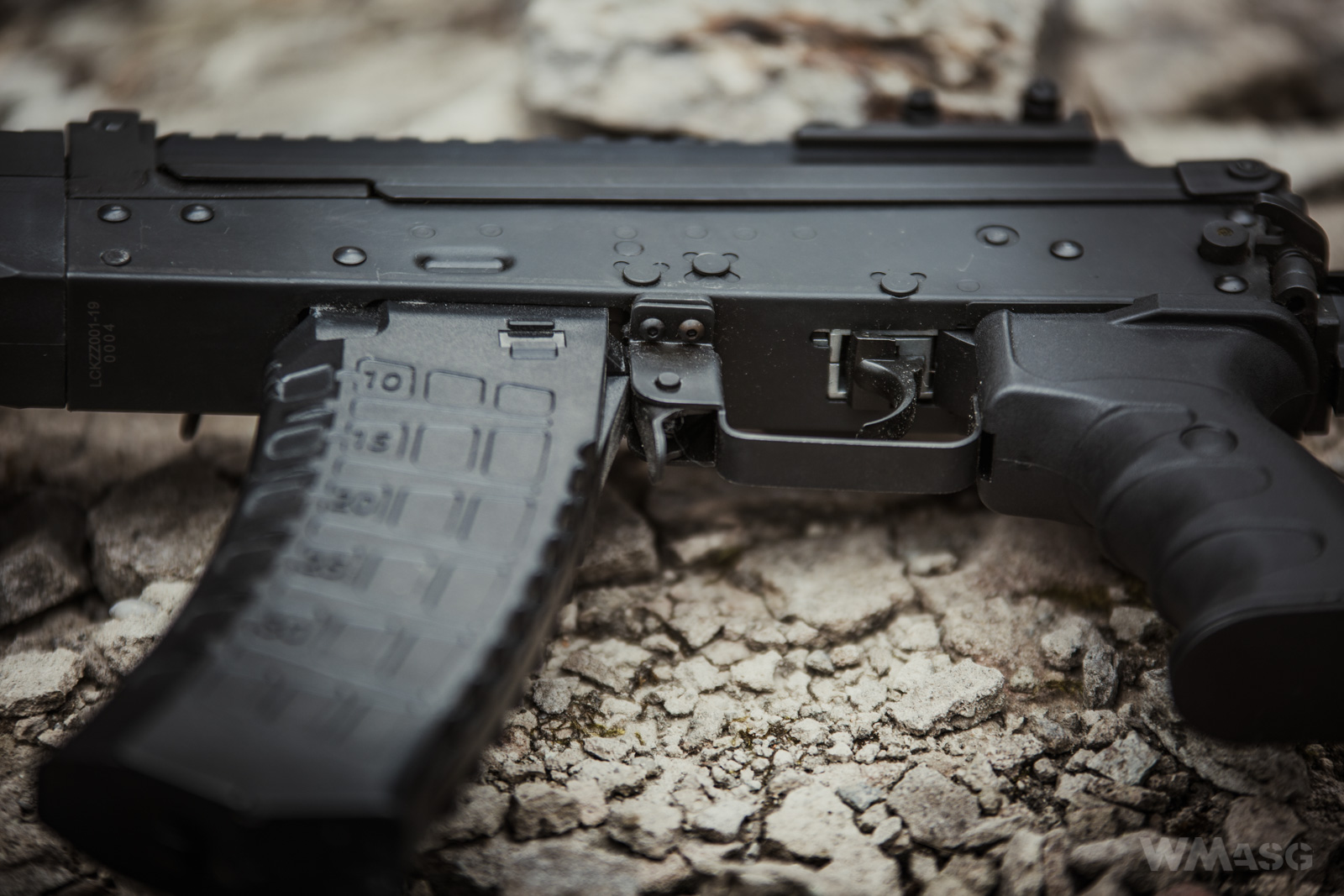

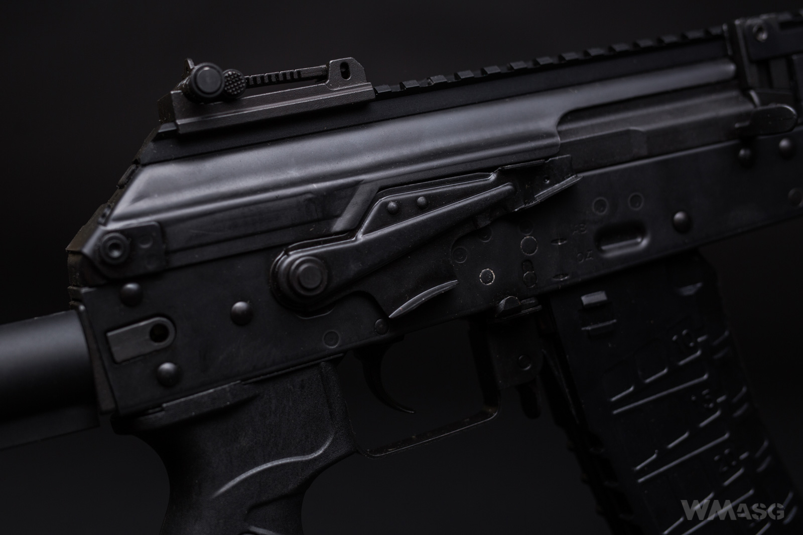

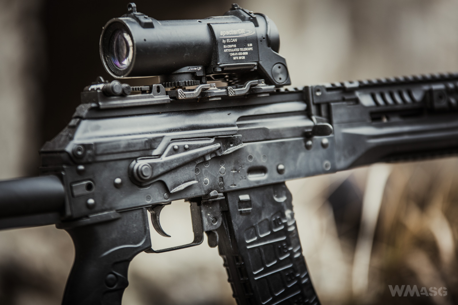

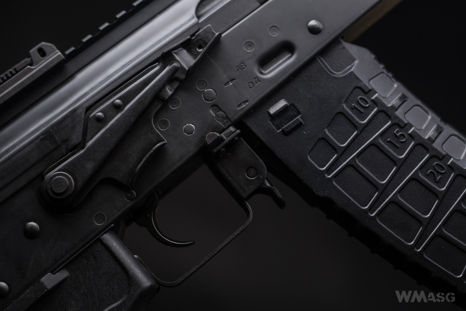

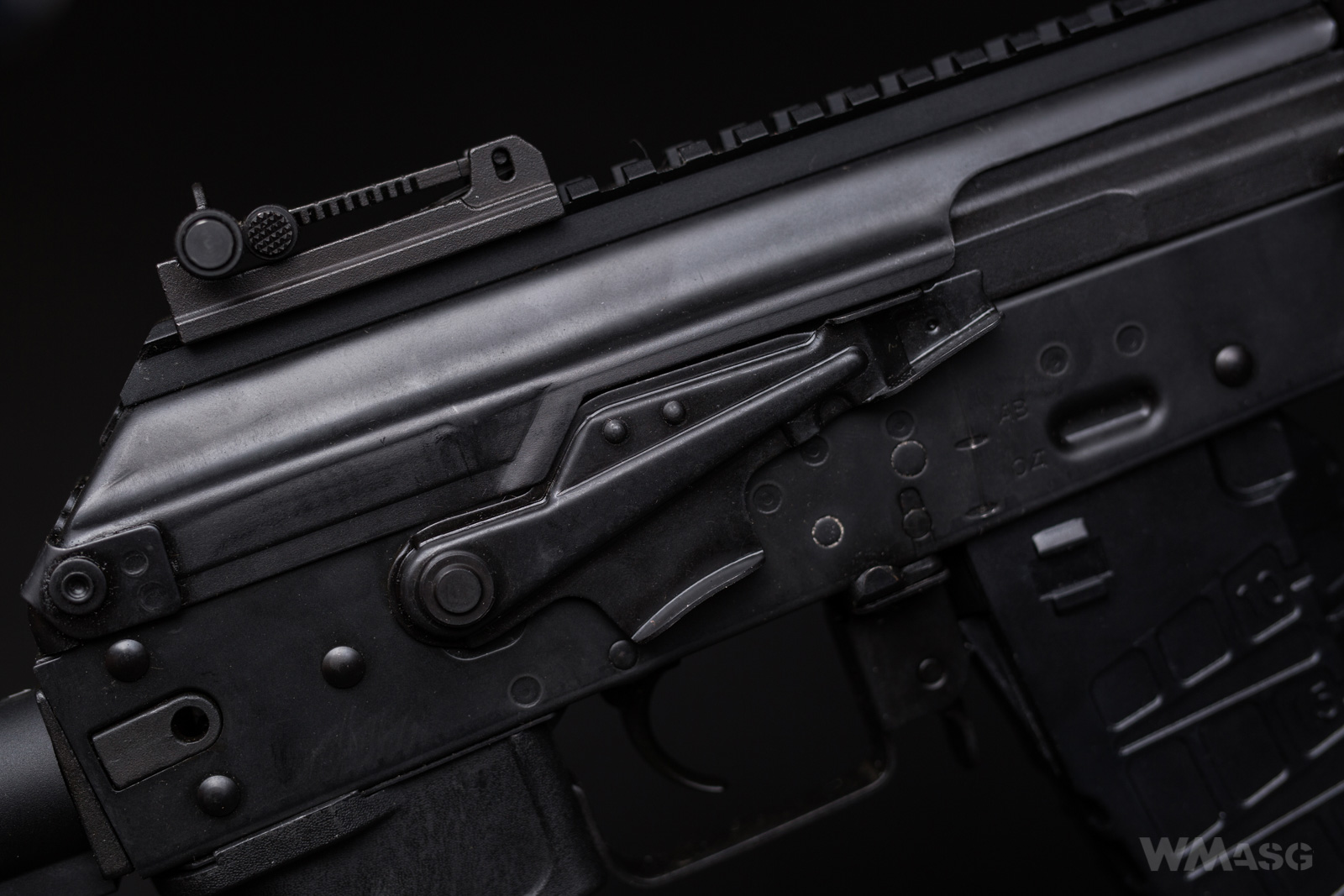

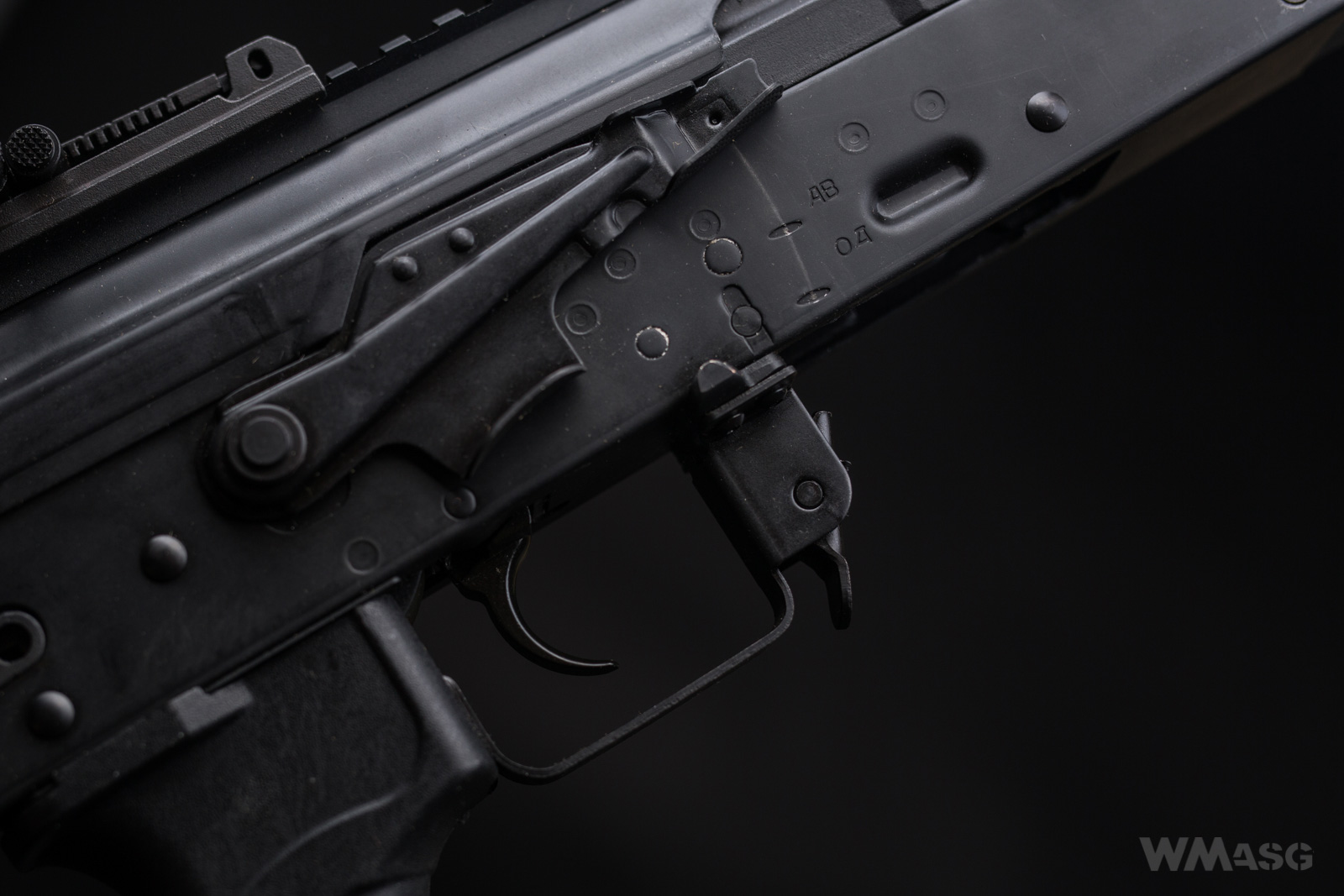

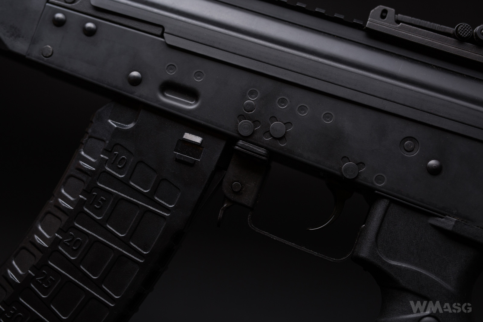

Right side of the receiver. In the place of the former gas tube retaining pin the AK-12 has a different one, used to lock receiver cover.The safety selector lever is equipped with a "shelf" to facilitate operation. In practice, the lever moves with great resistance. It's hard to move it with your finger, especially downwards.
On the miniature, the same part in the real carbine. The safety selector lever has four settings: safe/full-auto/three round bust/single fire (red arrow). The replica does not shoot with the three round bust mode and thus has only three settings, standard for earlier AK versions (safe/full-auto/single fire). This is a disappointment.
The other side of the receiver. It looks ordinary. A round button for folding the buttstock is visible. You can also see that the AK-12 does not have a typical receiver cover latch.
The AK-12 does not have the "claw" that locks a folded buttstock on the side as in the AK-74S, AK-74M or AKS-74U carbines. Locking of the buttstock has been solved in a different way. I do not know how it works in the original carbine but the solution used in the replica is an average one in my opinion, but I think it can be improved on my own.

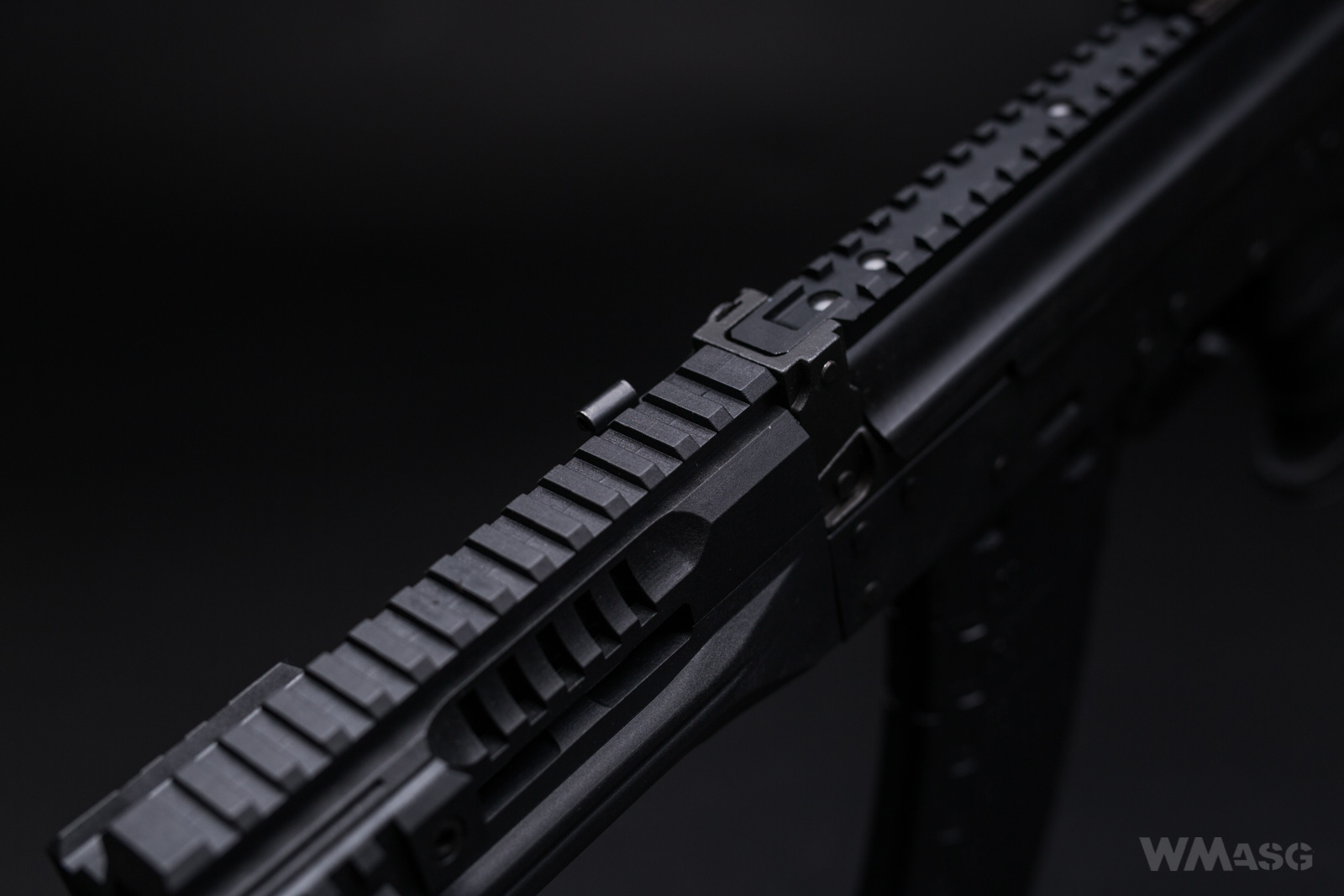

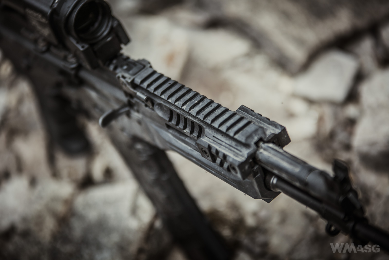

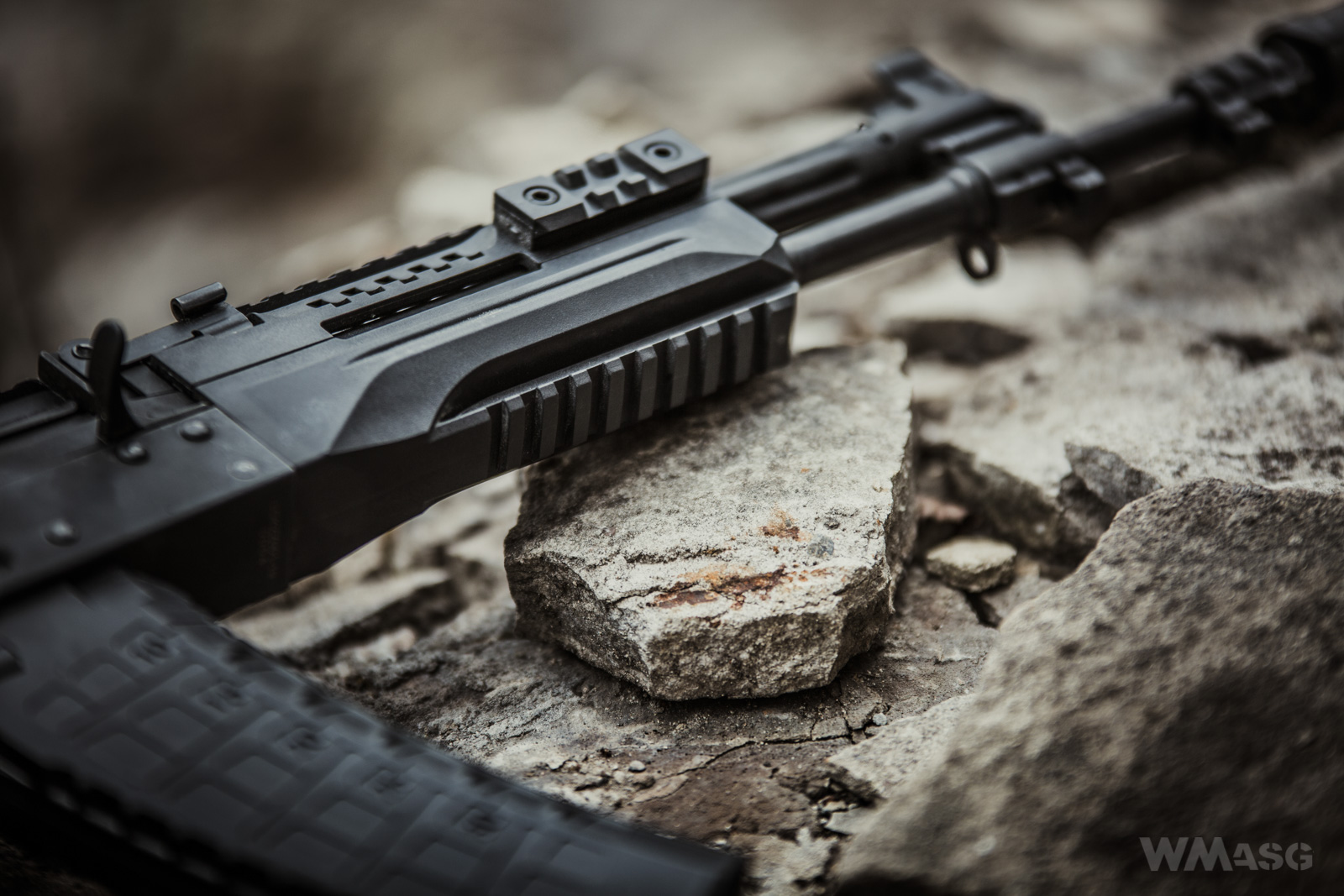

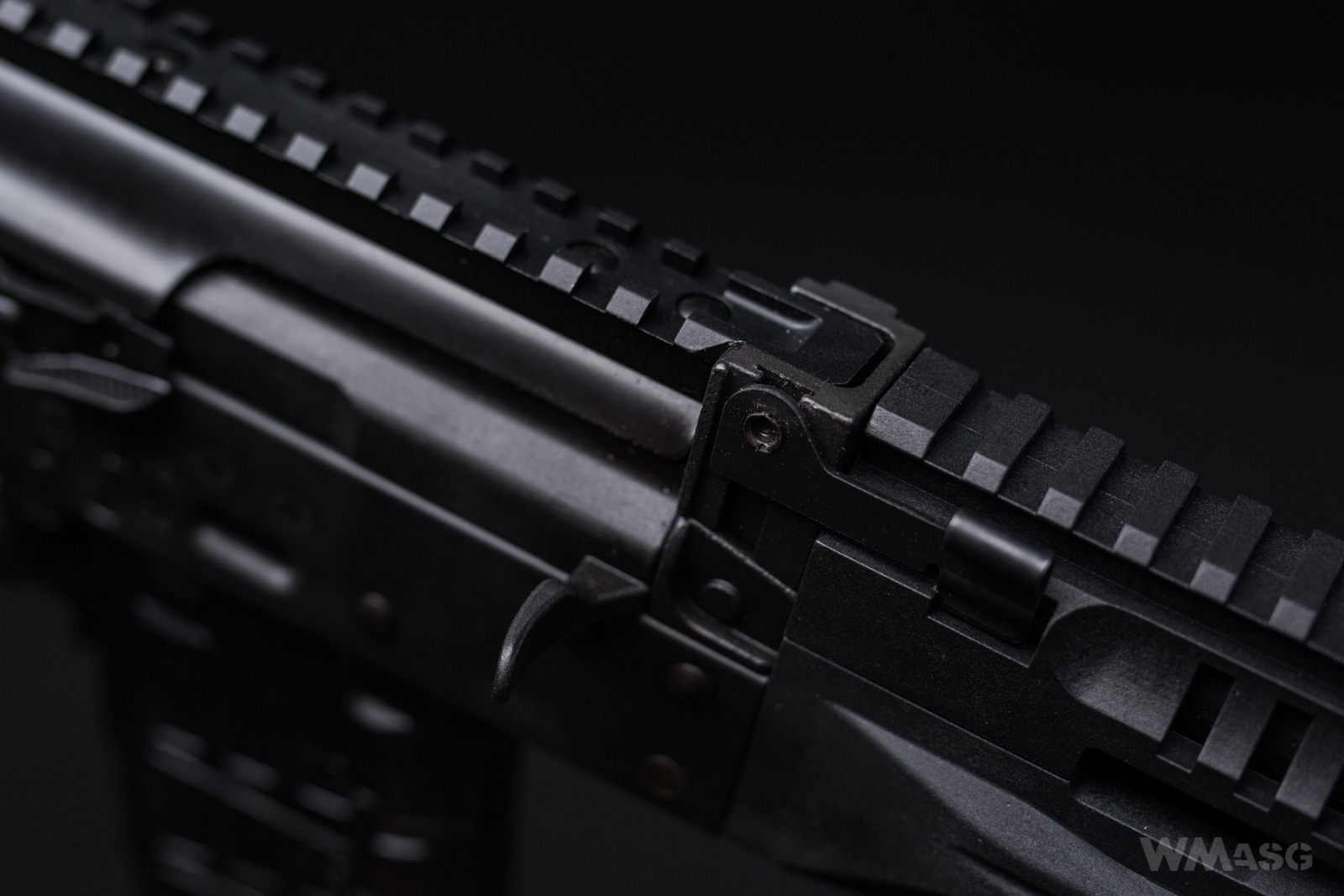

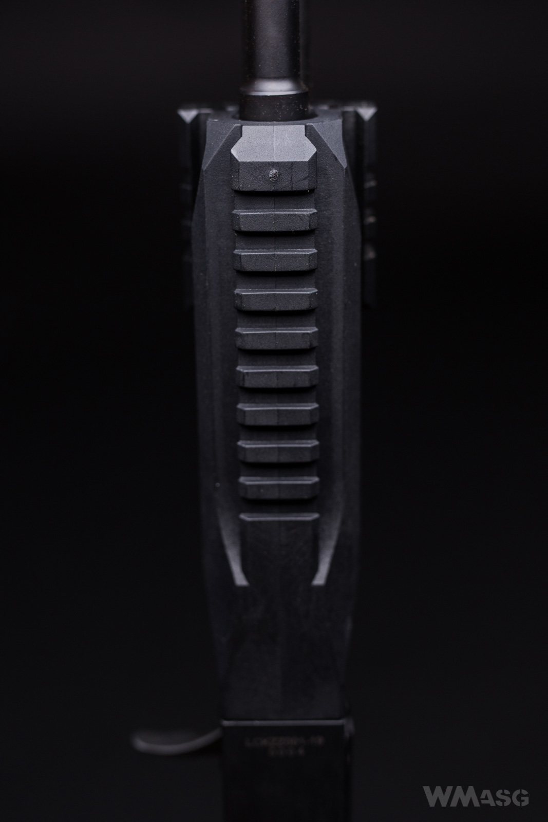

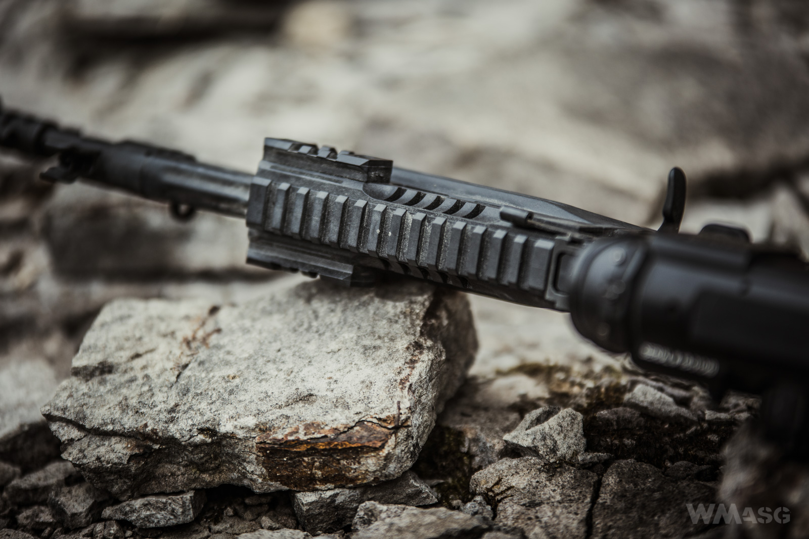

The receiver cover
The receiver cover is another distinctive feature of the AK-12. First of all, it has a permanently riveted Picatinny rail. Secondly, due to the transfer of the rear sight assembly (iron and optical) directly to the cover, the method of mounting it has been changed. Until now, the receiver cover was held in place with a rear latch and wobbled to a lesser or greater extent. Now it is firmly secured to the receiver.
The method of removing the cover will be discussed in a moment, because the compartment for a stick type battery is provided under it. Meanwhile, the view of the connection between the receiver cover rail and the rail on top of the upper handguard. It is not perfectly aligned, but it is off by less than 1 millimeter.
And a view from the back showing the place where the receiver cover latch used to be.

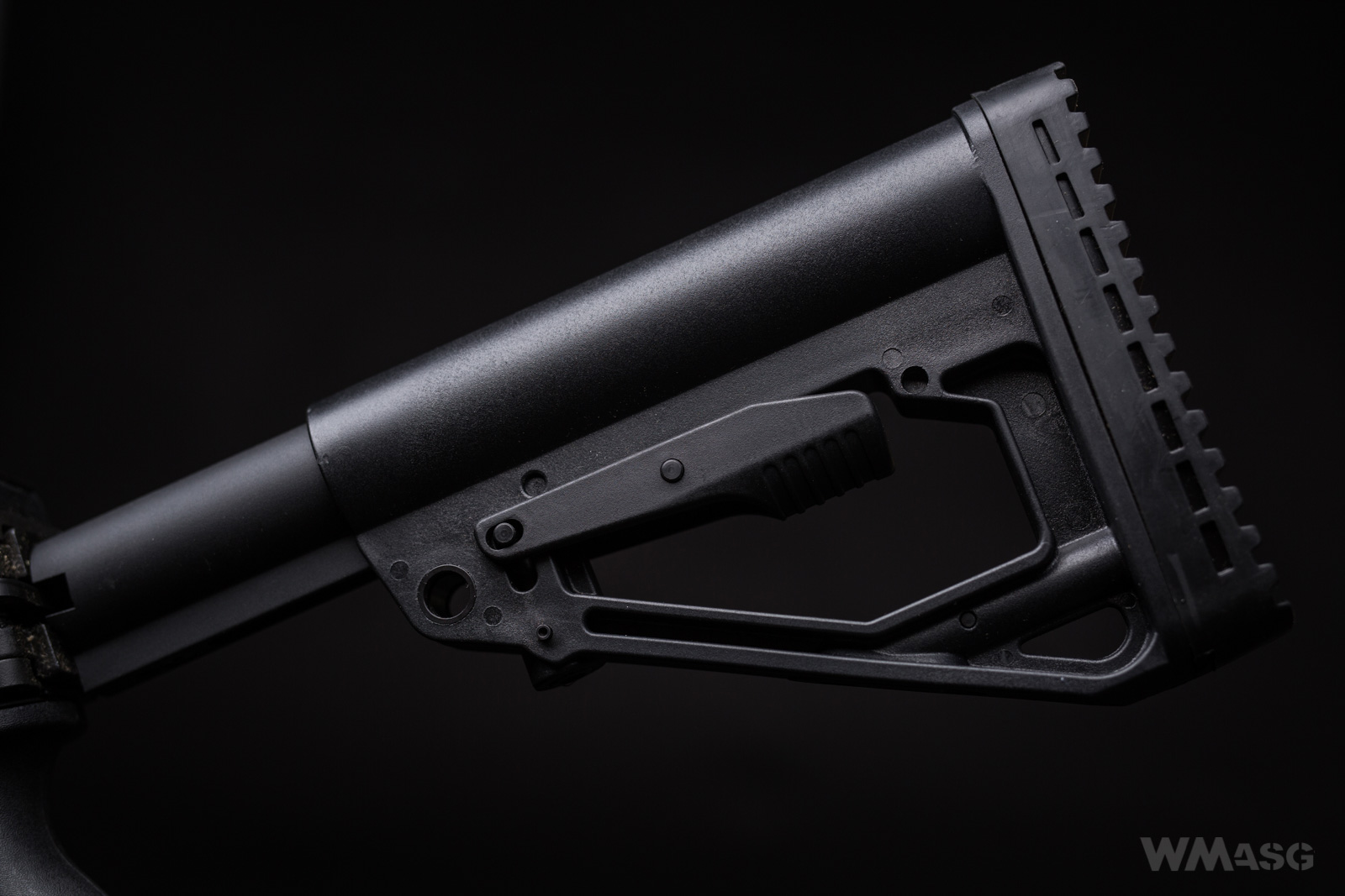

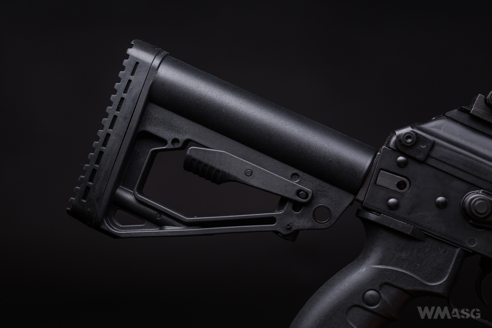

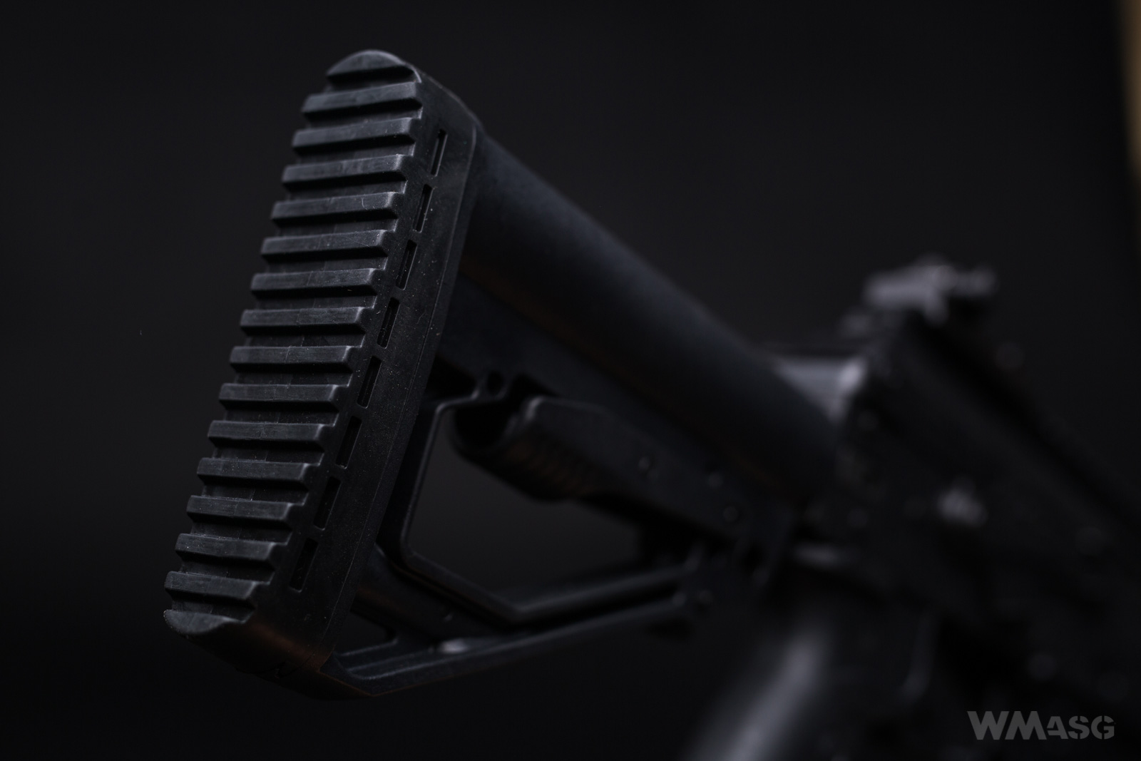

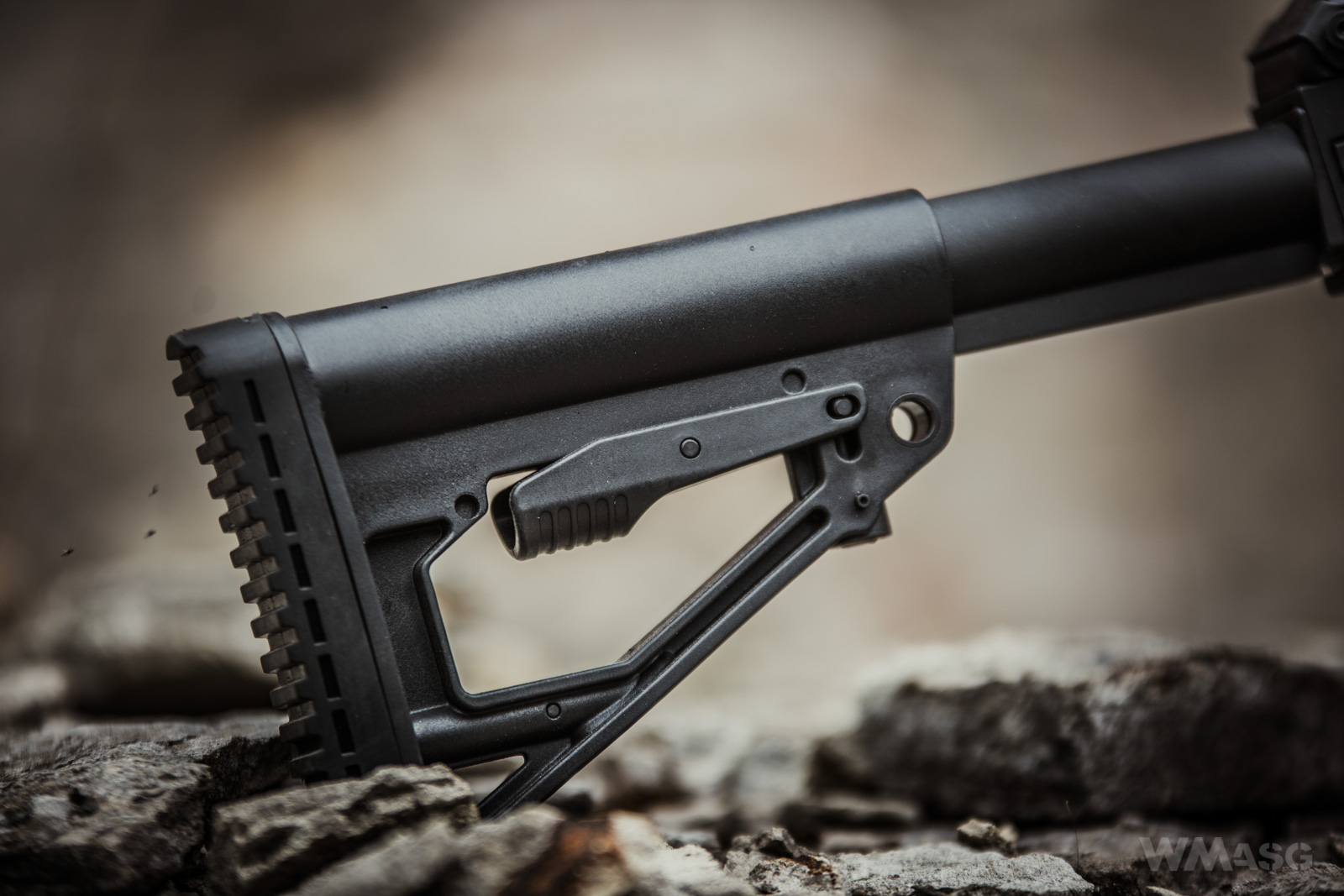

The buttstock

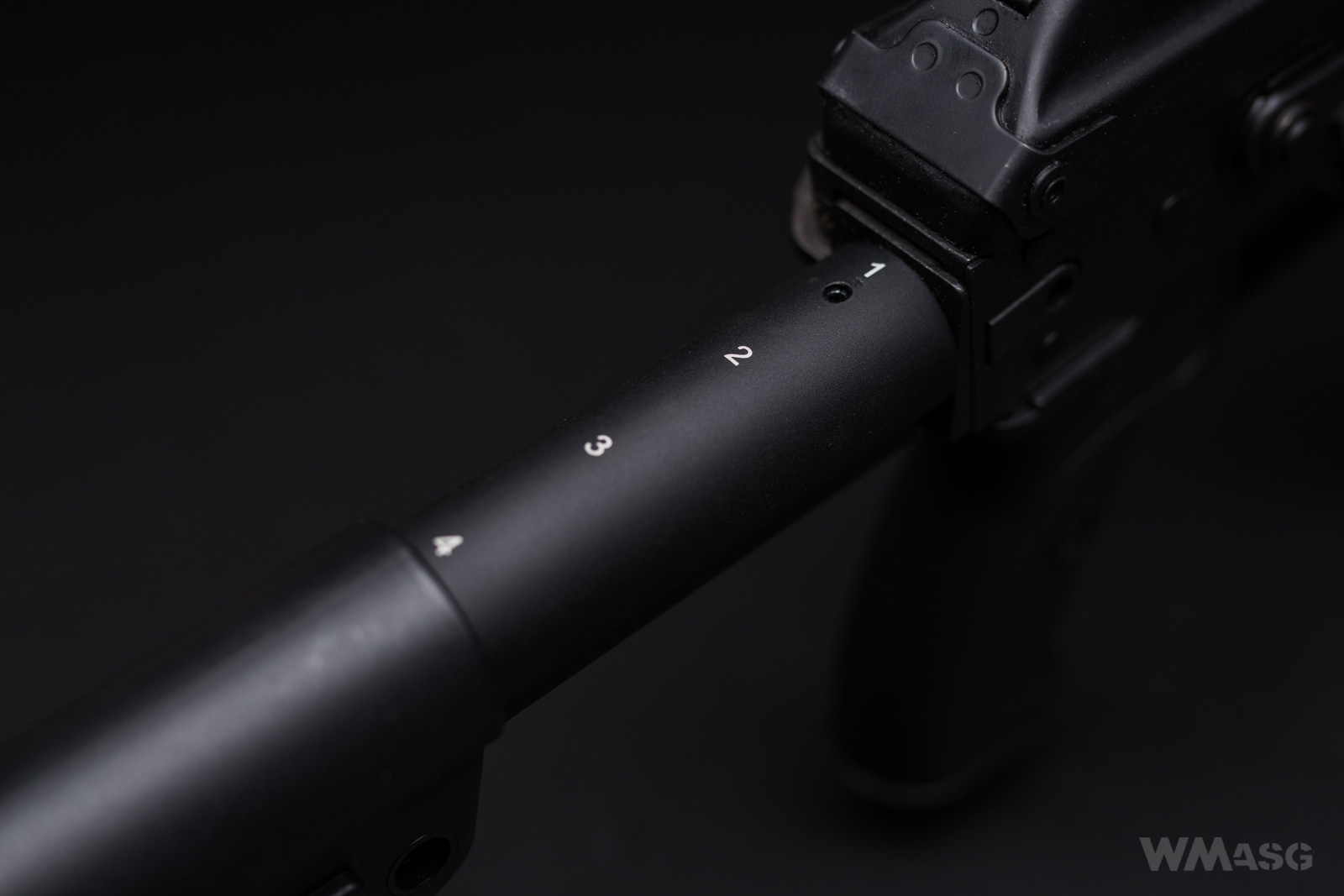

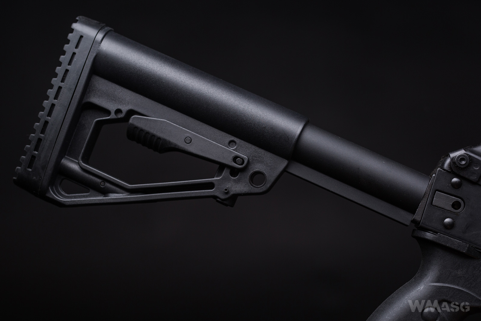

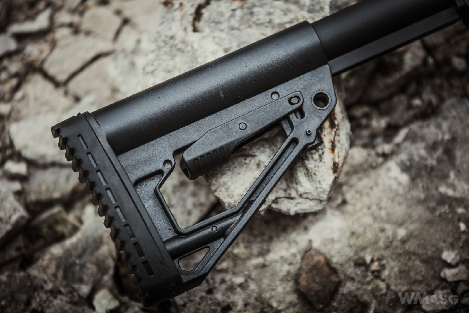

The AK-12 has a side folded buttstock of adjustable length (with five settings). It folds to the left side. The buttstock is made of very hard plastic. Theoretically, there are no obstacles to using a replica with a buttstock folded to the side. However, the locking method leaves a lot to be desired. The buttstock does not stick to the receiver and moves slightly. This is the obvious the fault of the hook that does not keep it in one position.
In the original, you can probably use aftermarket buttstocks complying with the AR-15 standard, because the stock guide looks very similar. Our efforts with the replica gave mixed results. That is, several AR-15 replicas' buttstocks fit right off the bat. In several other cases, it would be necessary to intervene with a file.
It is worth mentioning two things here. The first one is QD type carrying sling mounting point, which is clearly visible in the photo above. The second is the possibility of sliding the rubber back plate off.
The original in the buttstock guide houses a toolbox with a multi part cleaning rod strut and a key for adjusting the front sight. There is no toolbox in the replica. Unfortunately, I can not say if the one from the real carbine would fit inside the guide.

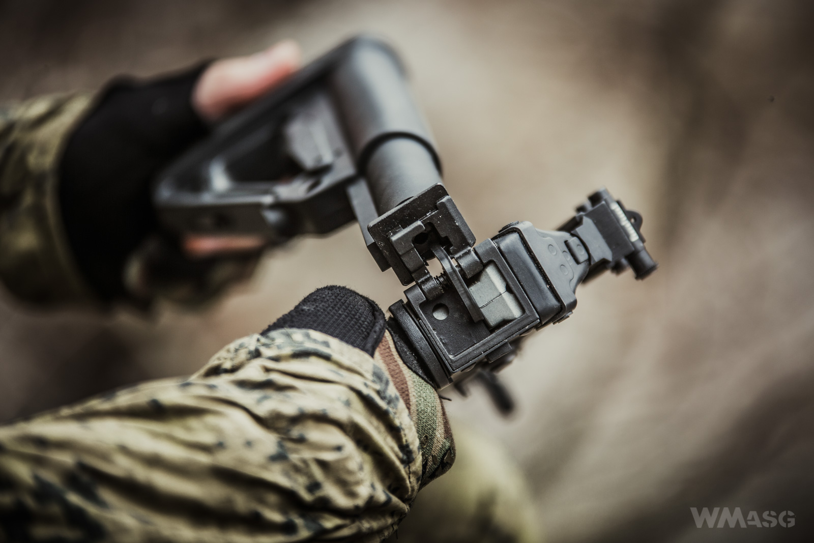

Folding and unfolding of the buttstock
View of the latch - stock folded.
To unfold the buttstock, press and hold the latch and unfold the buttstock at the same time.

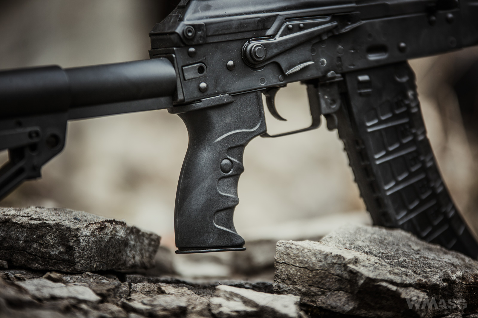

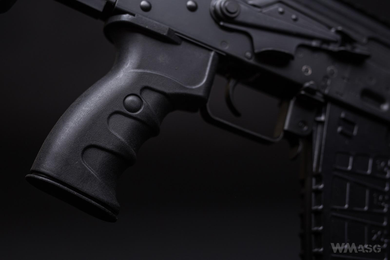

The pistol grip
The AK-12 has a small storage compartment in pistol grip.
The replica's grip looks very similar. For obvious reasons (the motor) round part, which in the real grip is a two-sided button used to open the storage compartment tray, in the airsoft version is just a deco.
The mounting screw and motor adjustment screw are hidden under the bottom cap similar to the bottom of the storage compartment tray.

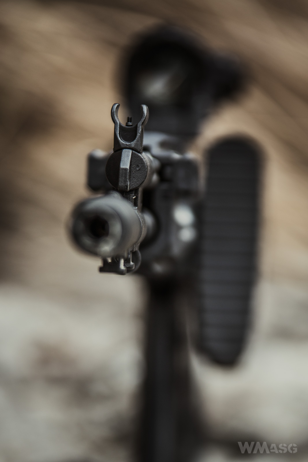

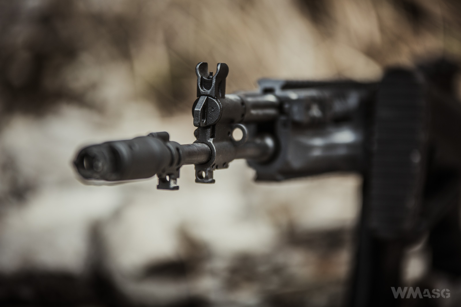

The front sight is adjusted vertically by screwing it into and from the base. The drum that allowed you to move right or left has been dropped.

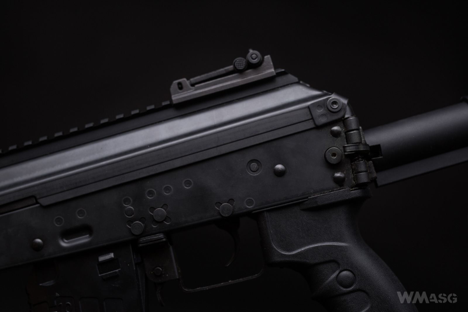

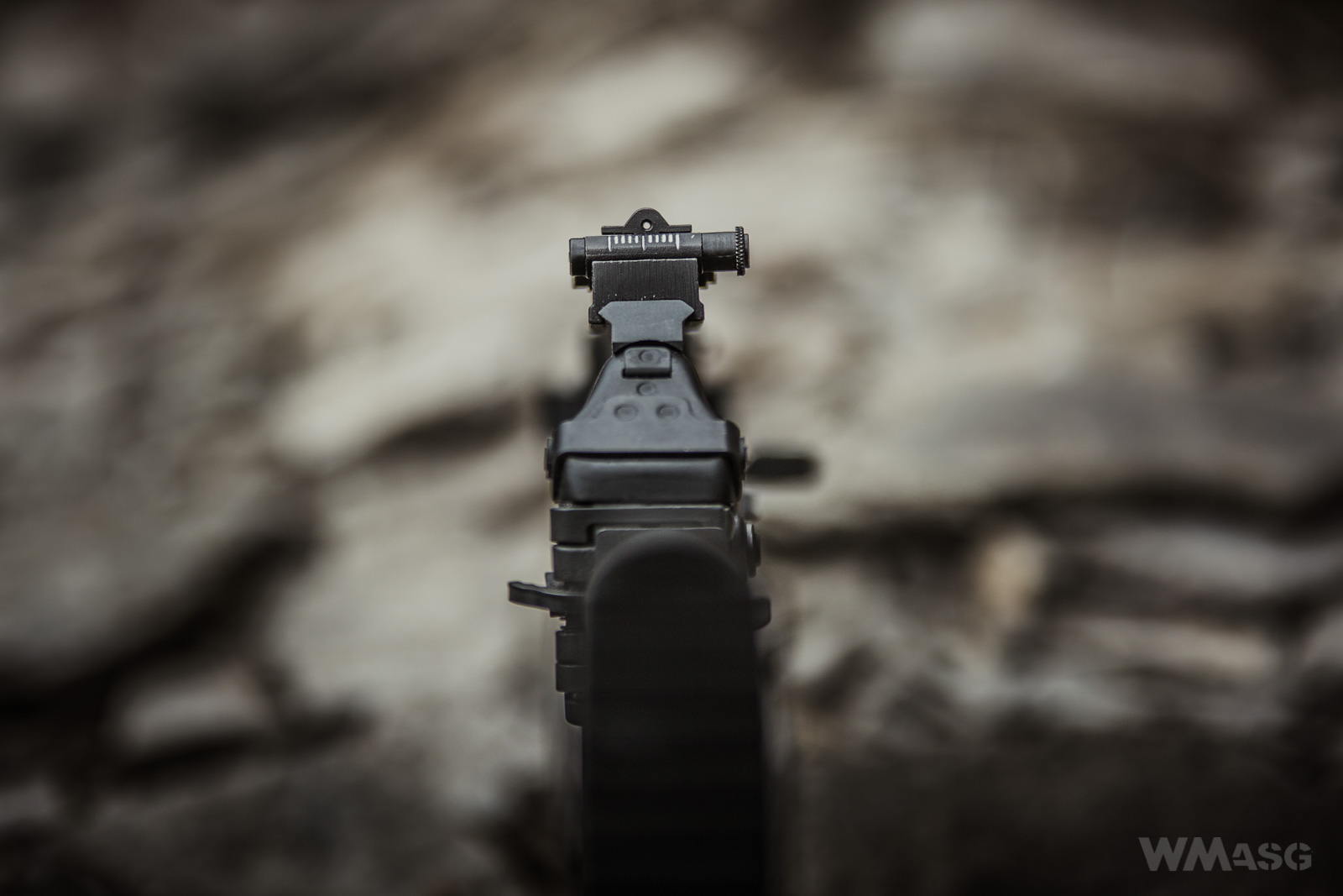

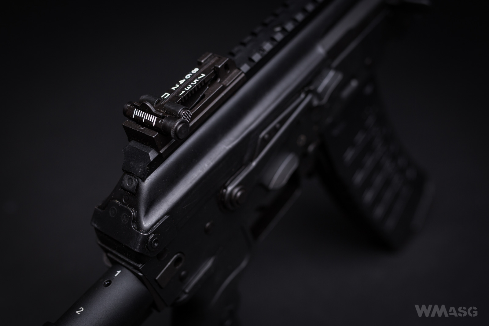

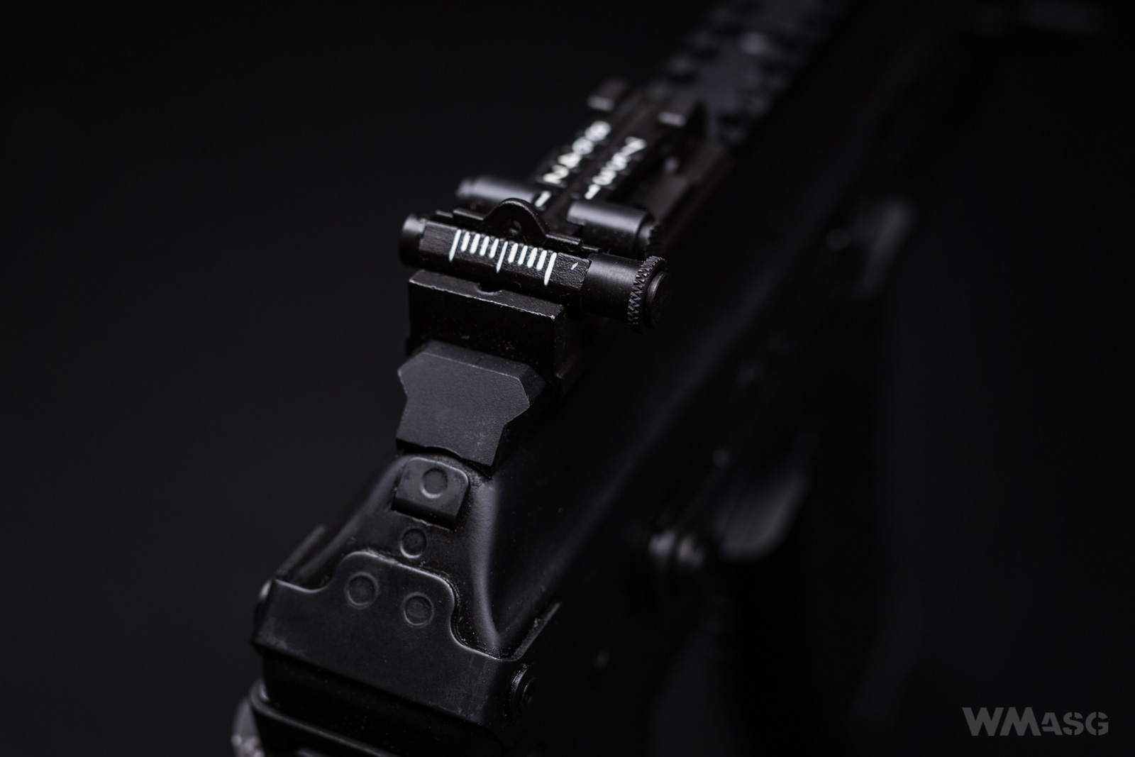

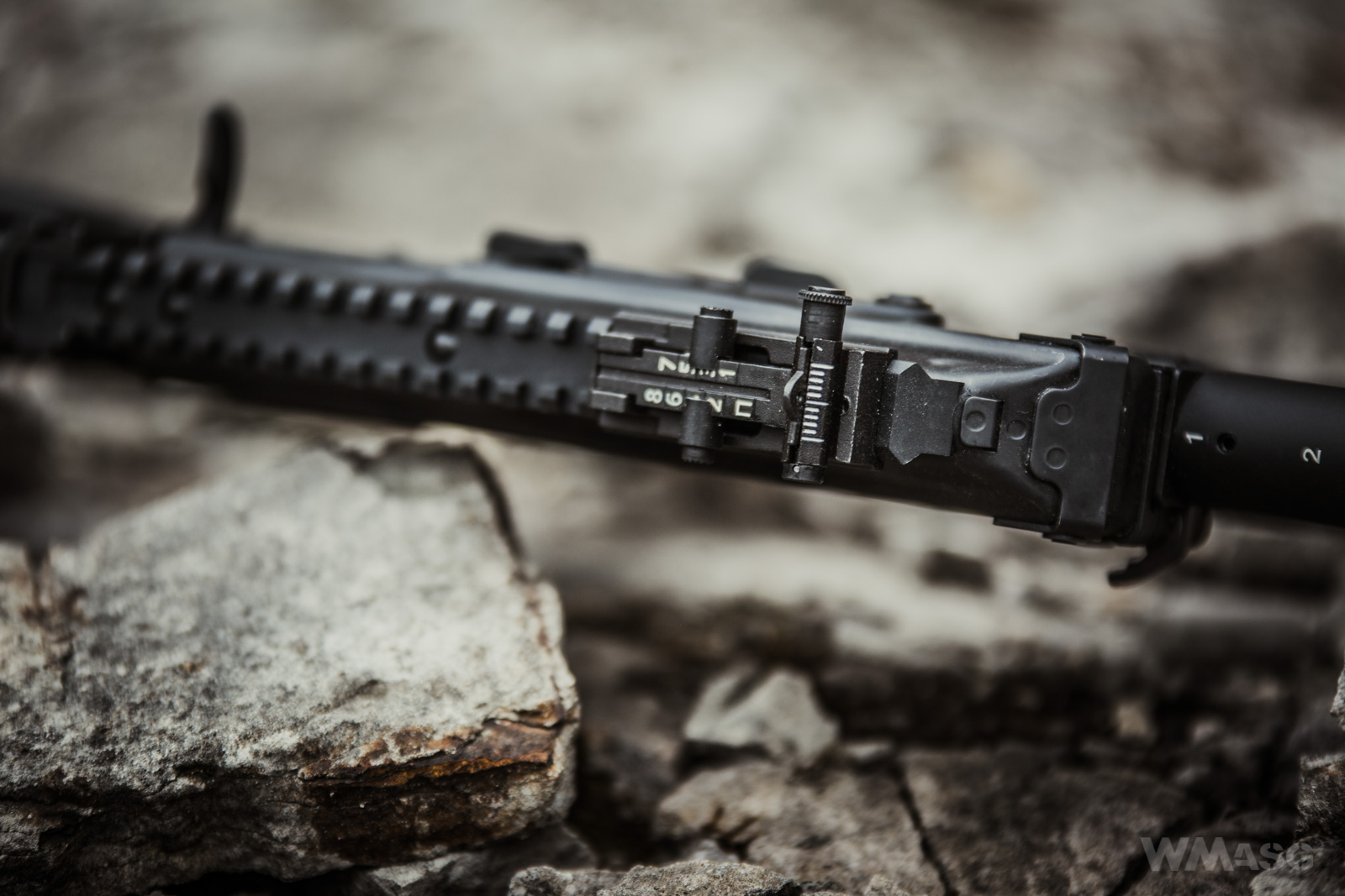

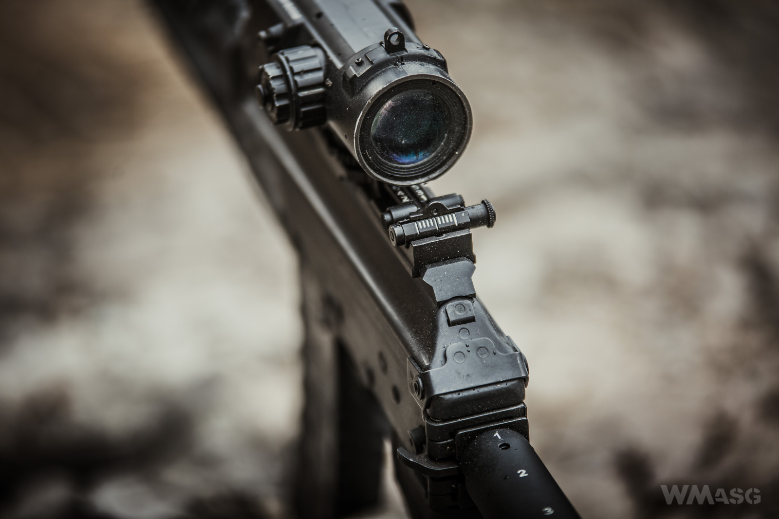

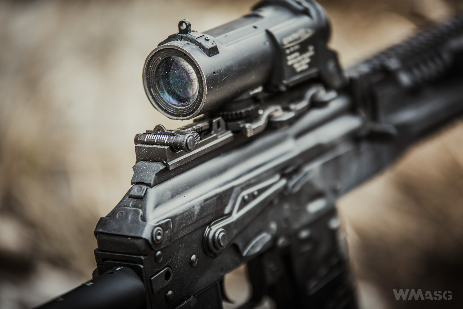

The rear sight used is a certain novelty.First off all, it was moved backwards to the edge of the receiver cover to extend the aiming line and thus improve the accuracy of the weapon. Secondly, an aperture has been used in place of the open sight which has been in used for many years now. Thirdly, apart from the standard adjustment (scaling according to the distance from the target) there is also a left/right adjustment that resembles sight found in support weapons.
I'm being picky, but while discussing the sight's aperture, I will pay attention to two imperfections. First of all, the sight's base has a small clearance. When moving the sight with your fingers, we move the aperture hole by more than a millimeter.
Secondly, the aperture also moves backwards and forwards slightly.
Both things things definitely affect the accuracy of the replica. But on the other hand, we are shooting with plastic BBs which have close to none ballistics at a distance of 50-60 meters. And above all, the looseness can be deleted.

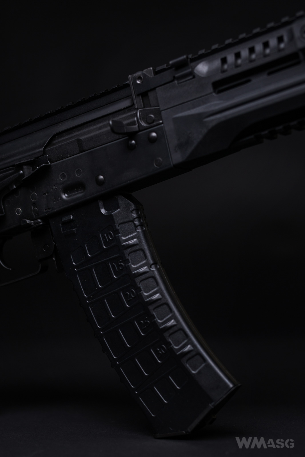

The magazine

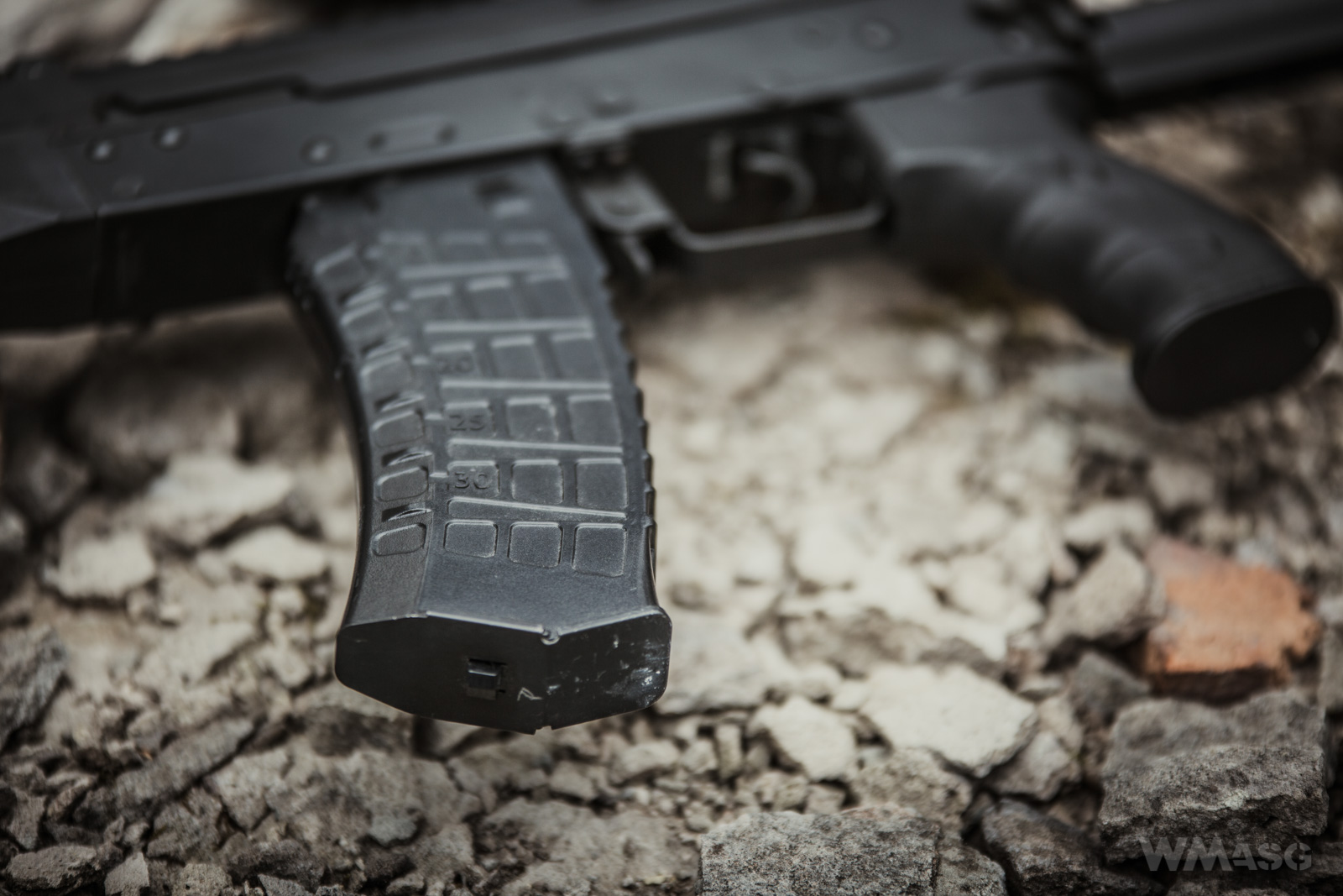

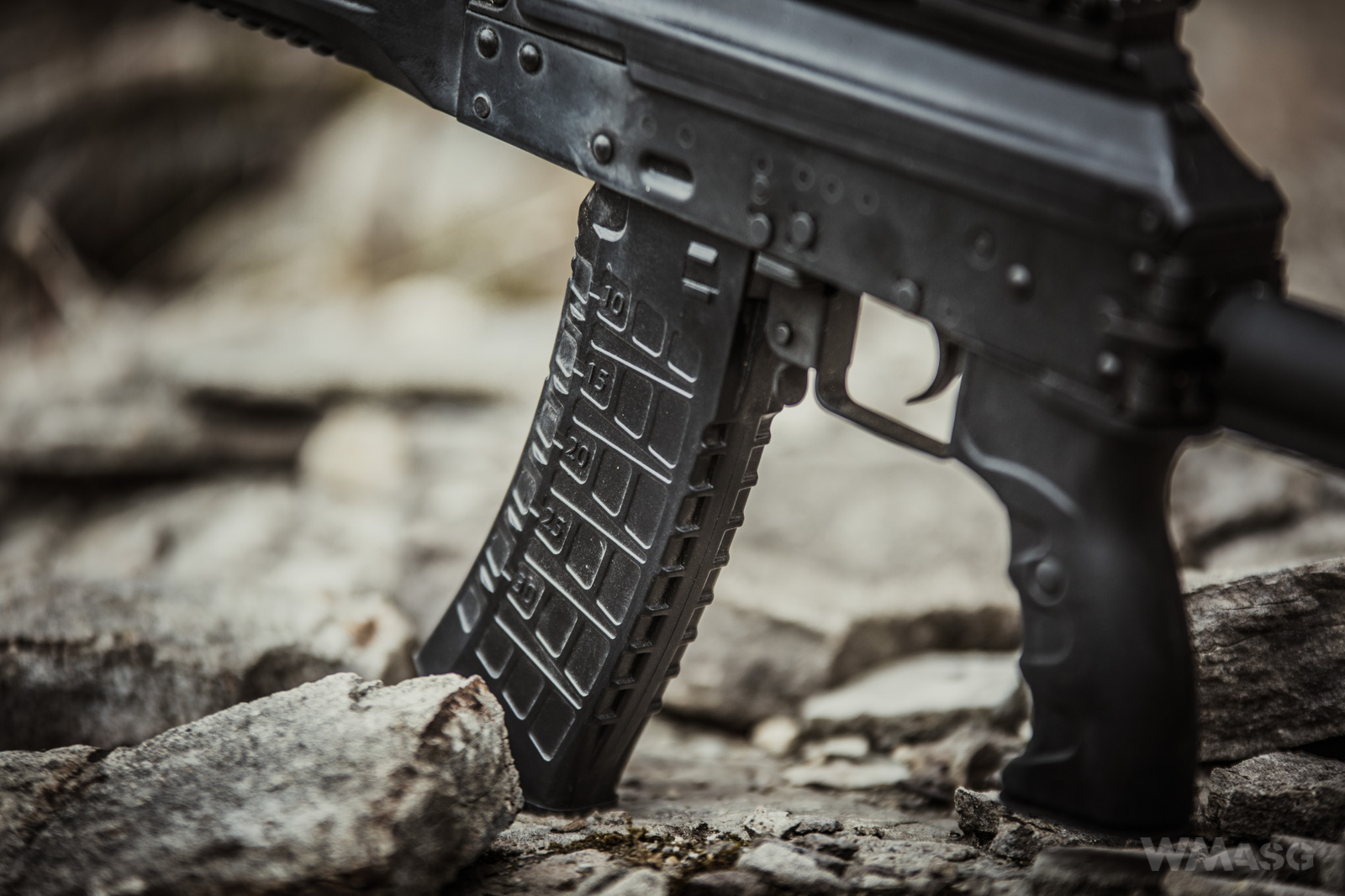

The tested replica is the AK-12, that's why in the set we received a replica of a magazine for the 5.45x39 mm round. It's a mid-cap holding 130 BBs.
