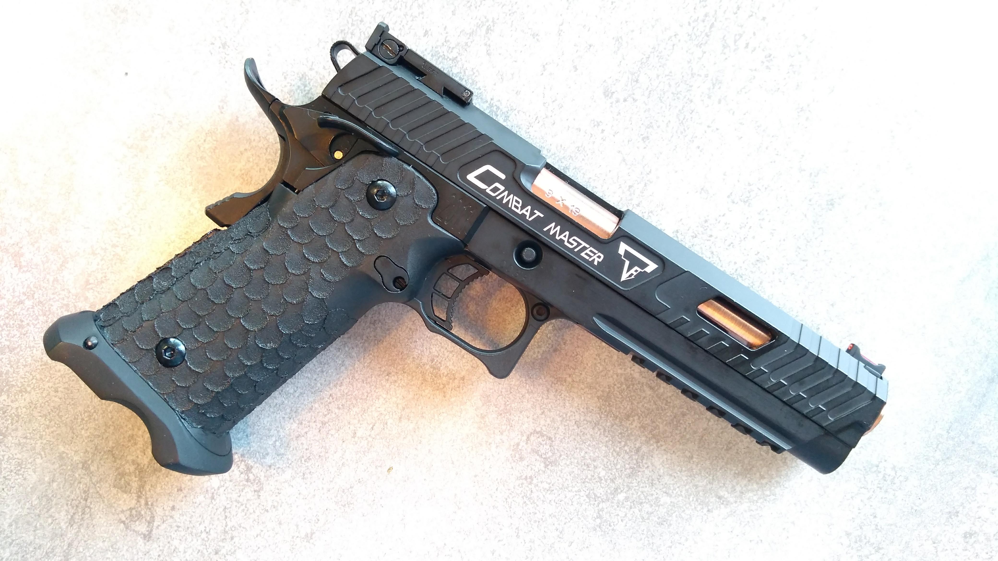

Both new Army Armament pistols, the five-inch R601 and the four-inch R501 we tested, are replicas of custom Colt STIs. So Army, a bit like Tokyo Marui, made two versions of Hi-Capa: a long and a short one. Below is the R601 (the STI Taran Tactical Combat Master), John Wick's weapon from the third movie.

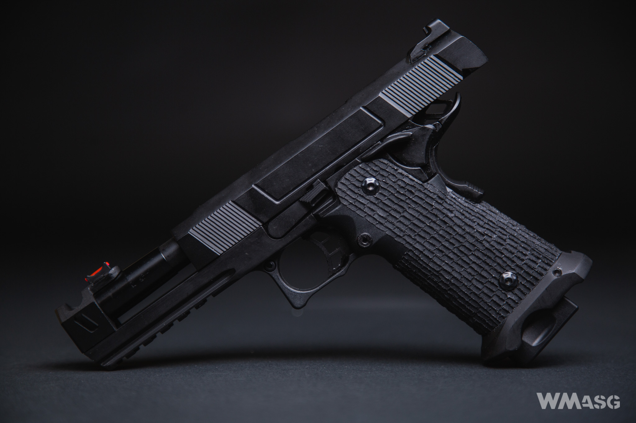

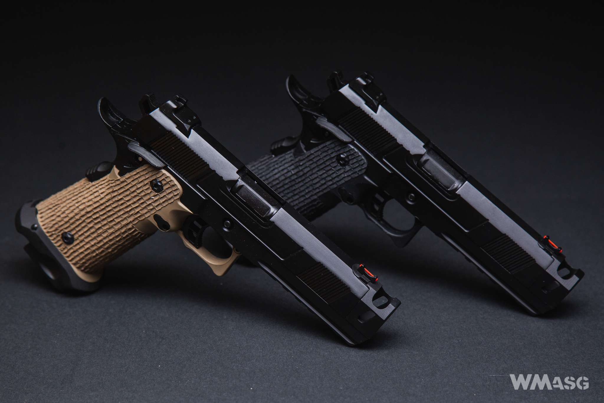

The R501 featured here is a compact gun, factory equipped with a muzzle climb compensator. It is a full metal design, with a metal frame and a slide.

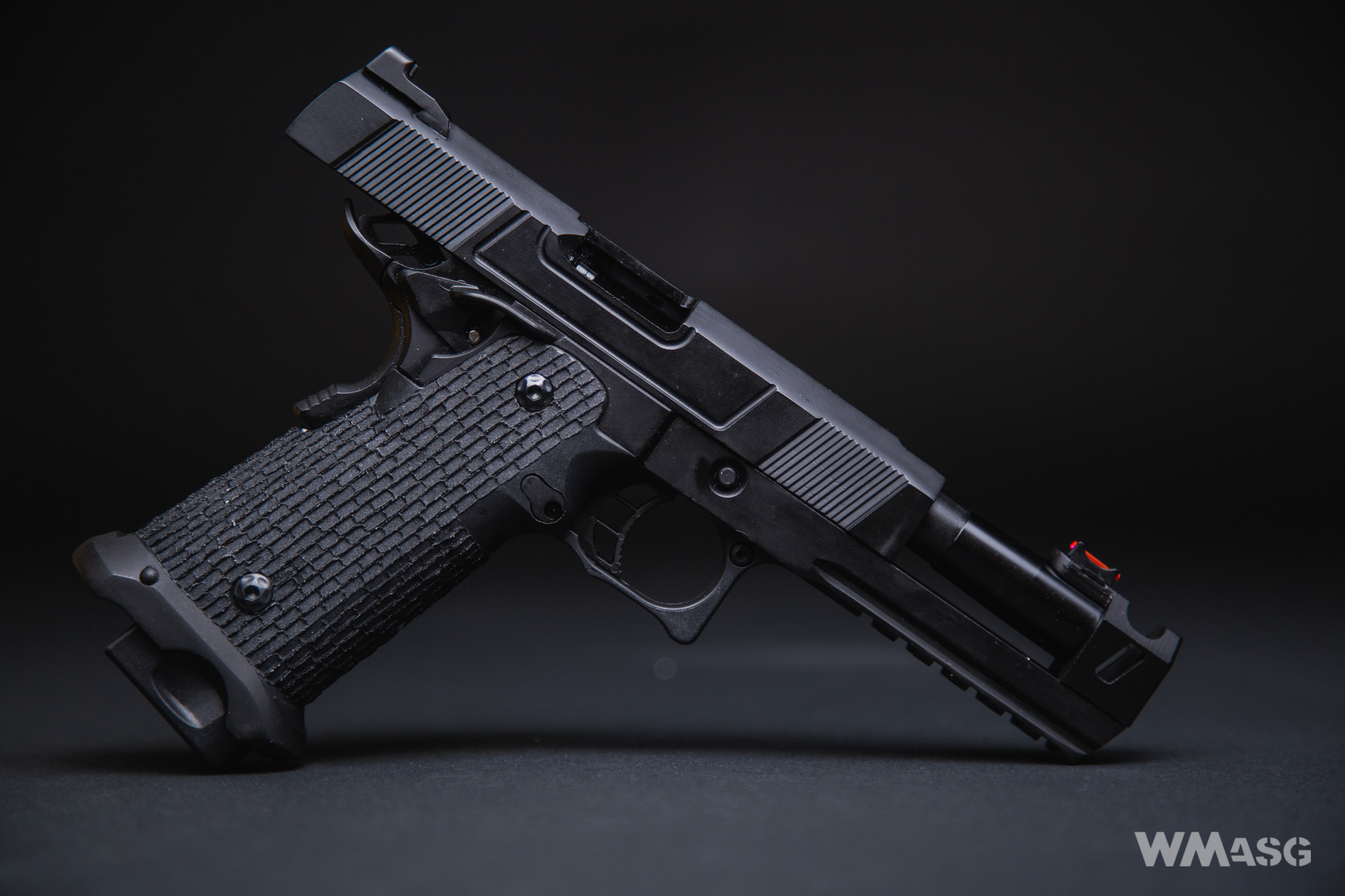

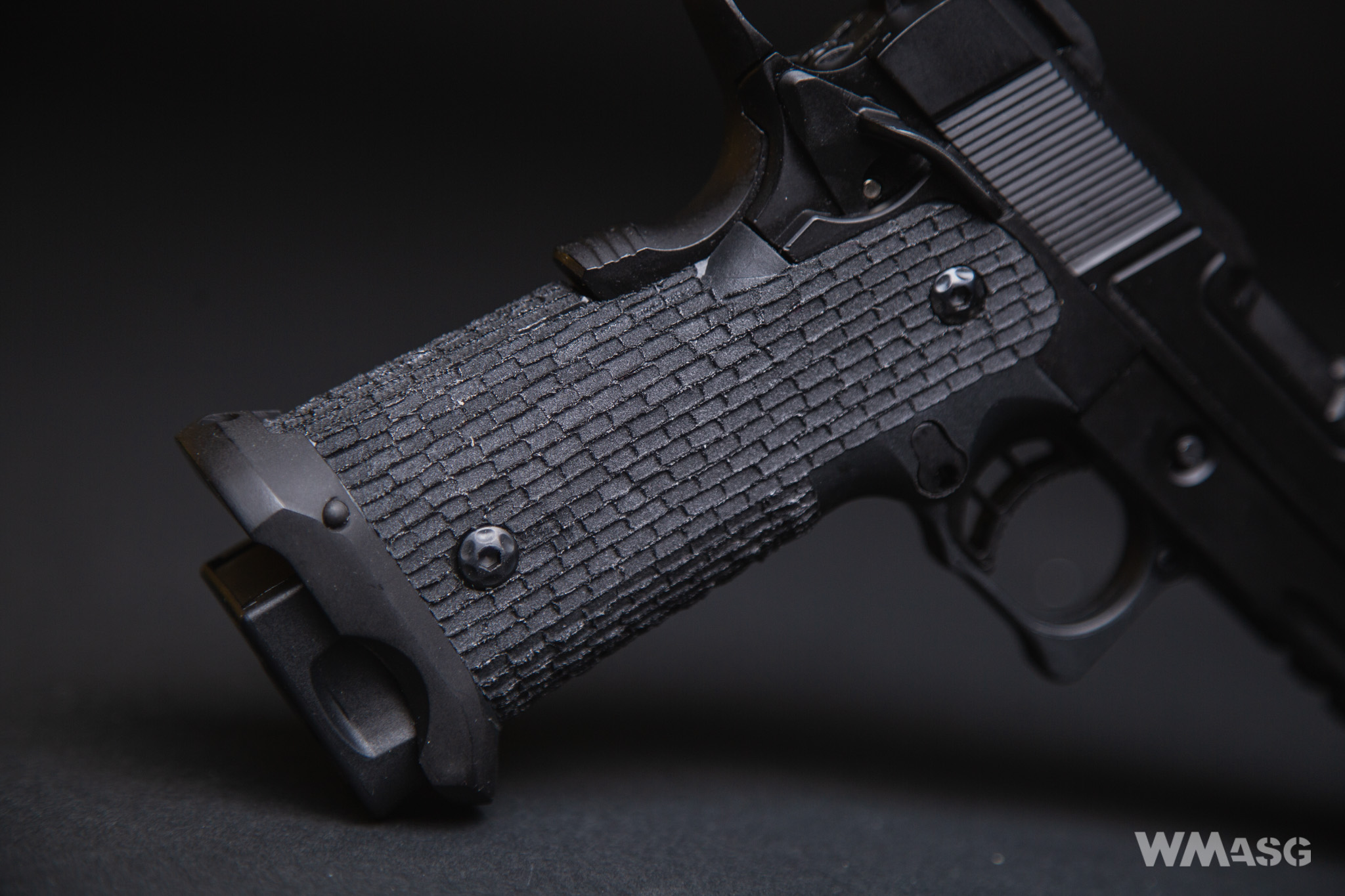

The replica is a variation on the Colt design so it fits in your hand like any Colt. You won't see anything new here. The situation is similar with the location and access to manipulators. Ergonomics are not as good here as in completely modern designs. But two things will undoubtedly get your attention when You will take the replica in your hands. First of all, thanks to the characteristic stippling, with which the grip's surface is finished, the gun literally "sticks" to the hand. We have not yet seen with a replica that could be held and aimed more confidently.
The second thing is fitting the slide. The vast majority of pistol replicas have a slight clearance between the slide and the frame. The effect is a distinct rattling of the slide. In the R501 there is no clearance between the slide and the frame. The slide fits perfectly.

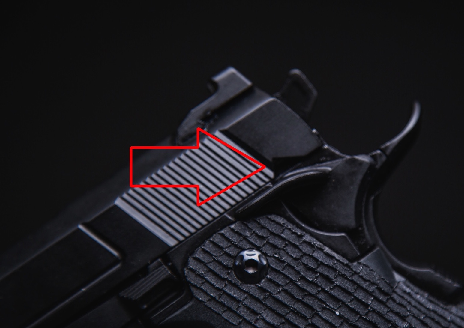

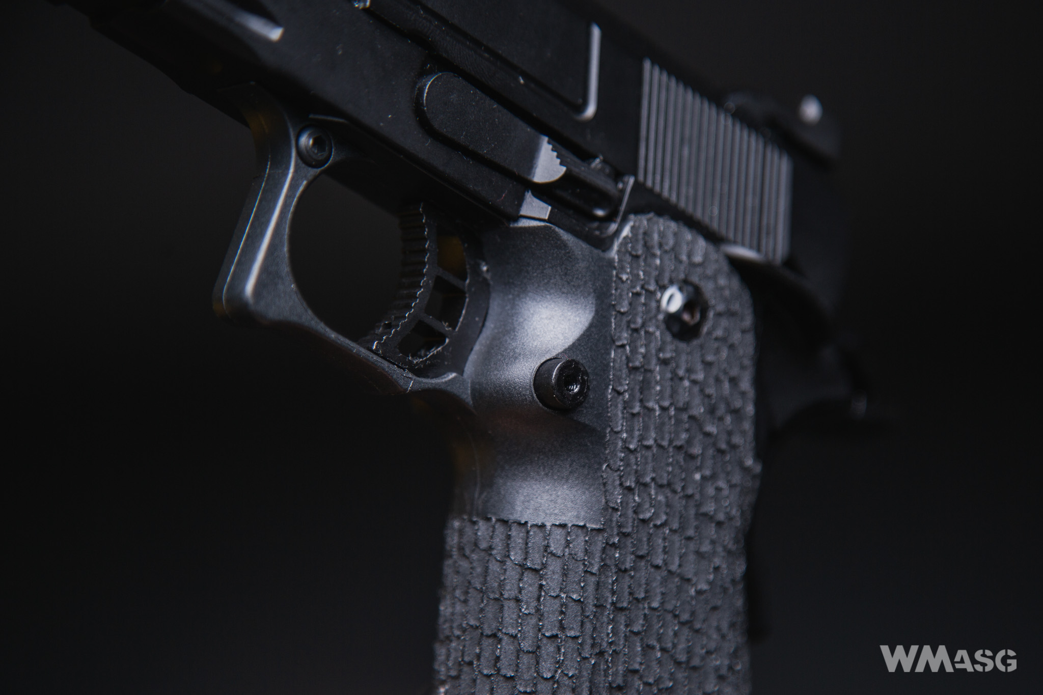

The manipulators mentioned earlier have the shape, functionality and arrangement typical of 1911 clones. Let's start with the safety. The basic safety switch is in the grip, a pressure lever at the back.
The role and principle of operation are simple - unless you properly hold the gun in your hand, the trigger remains stiff, firing is impossible. To be precise: in the replica the trigger is not rigidly locked, it is possible to pull the trigger by about 2 mm, the lock prevents pulling it further. The grip safety works regardless of whether the trigger mechanism is cocked (hammer pulled back) or not.

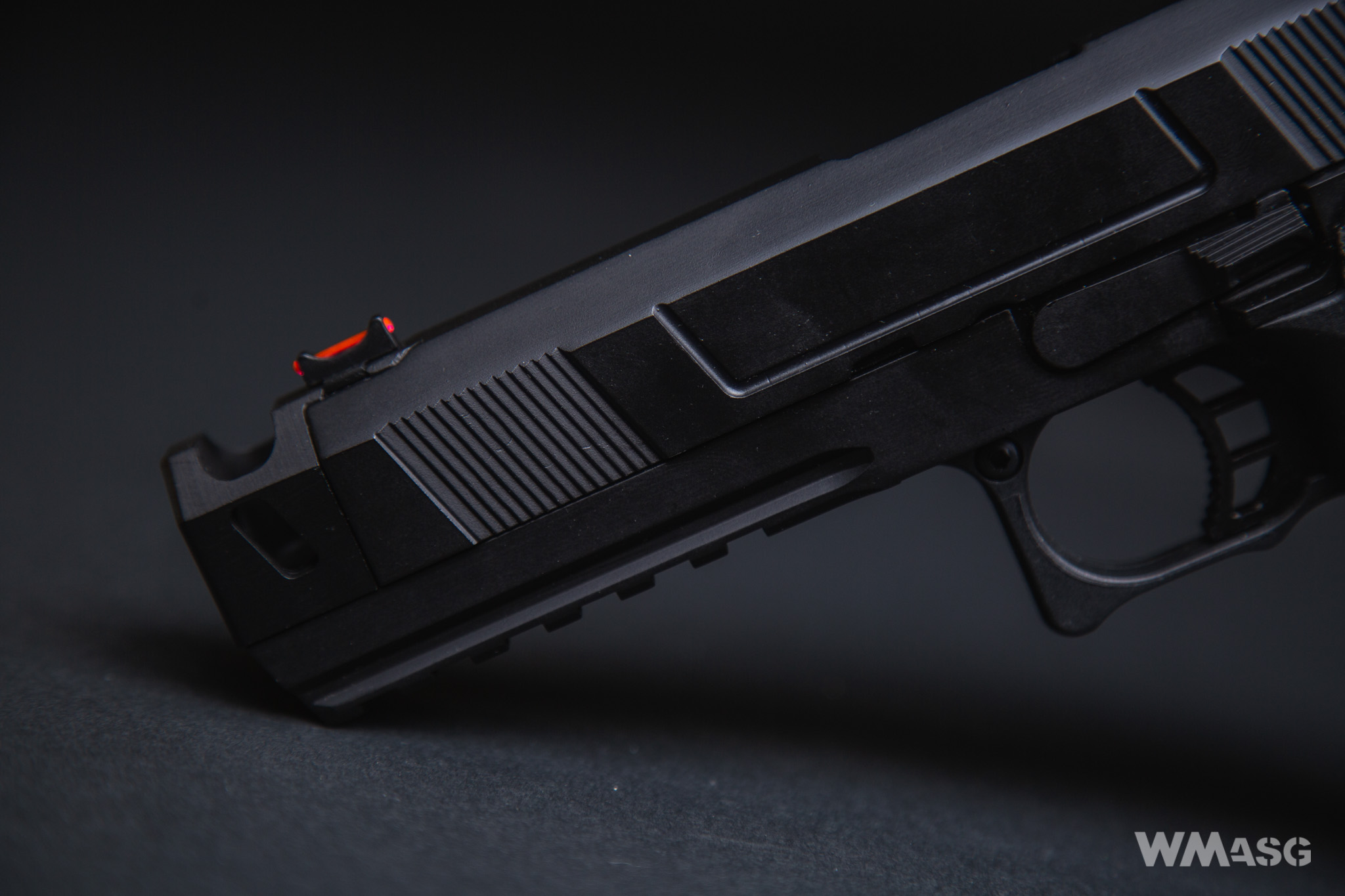

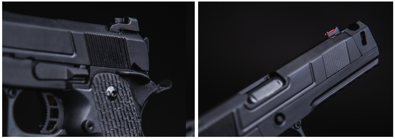

The gun has fixed sights. At the back there is a classic rear sight, at the front a "fiber optic" front sight, which in normal lighting conditions makes aiming easier. In low light it doesn't work as well as you'd expect, but it's clearly better than if it was made in the color of a slide.

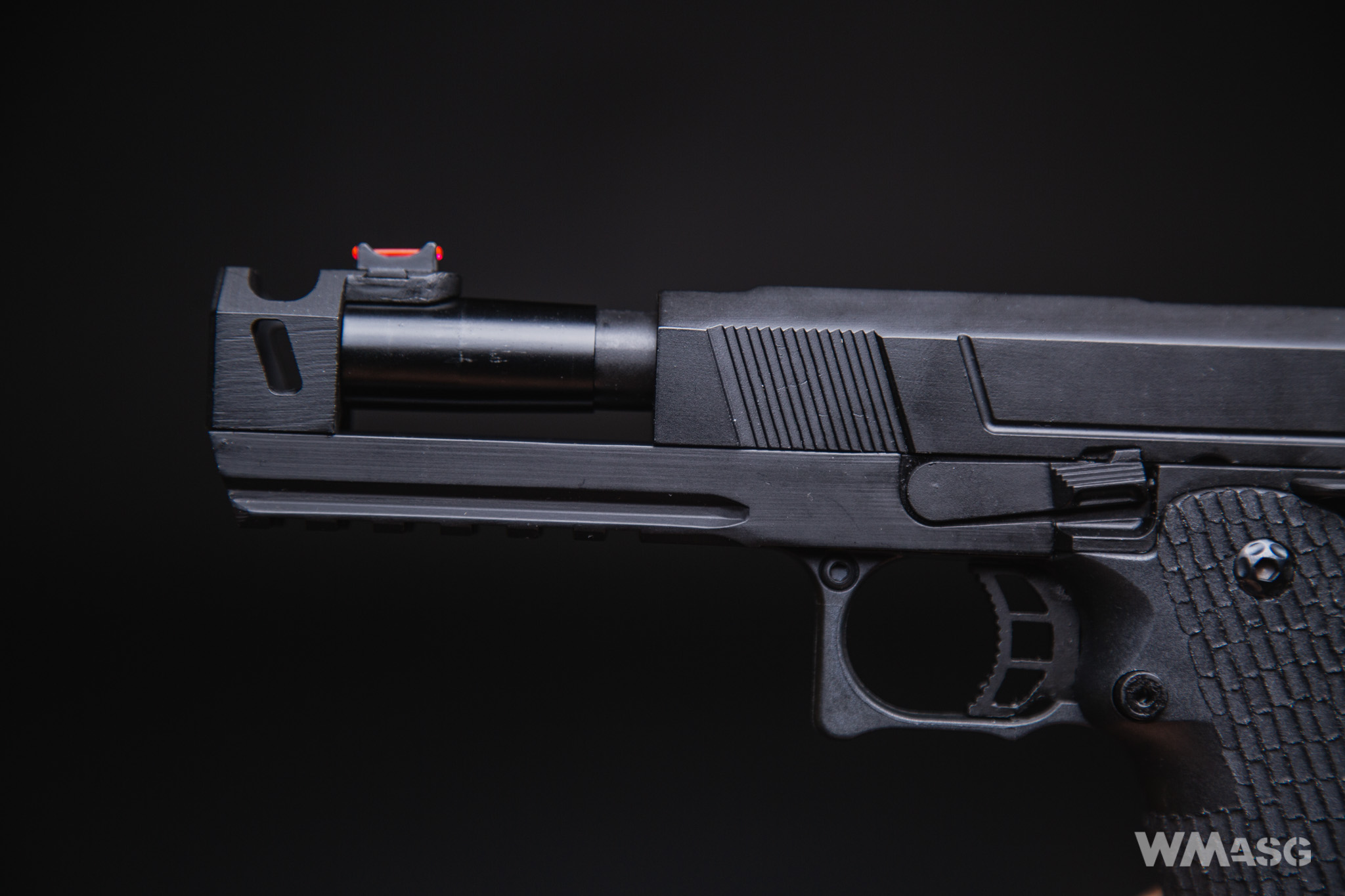

However, the basic and most important distinguishing feature of the R501 pistol is the compensator and the island barrel type barrel.
Of course, both of these parts in the replica do not give the user any measurable benefits. Nevertheless, they are there because the R501 is heavily modeled after the Costa Carry Comp pistol, and Chris Costa has been promoting the idea of using compensators for some time also in service weapons, not just sporting ones. The aforementioned Carry Comp is the first mass-produced service pistol with a compensator. Therefore, the R501 also has a compensator and looks pretty good with it.

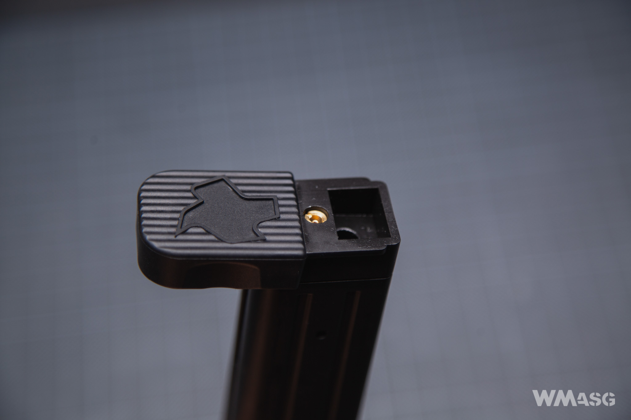

The last two external parts that should be noted are the under-barrel accessory rail, visible in the photos above, and the magwel at the bottom of the grip. We checked the rail functionality by mounting a flashlight on it, which you can see in the attached video. The characteristic undercuts of the magwell and the magazine floor plate, which role is to facilitate grip and speed up magazine change, also work.

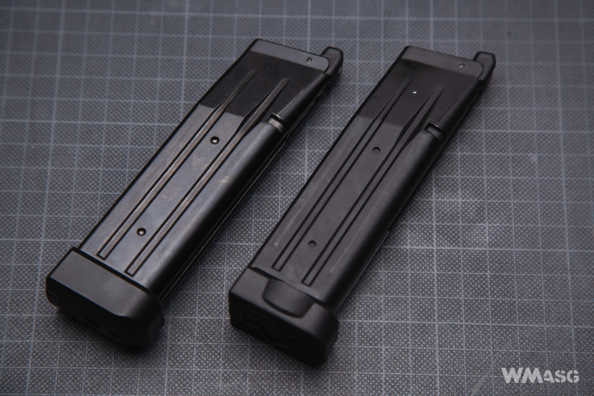

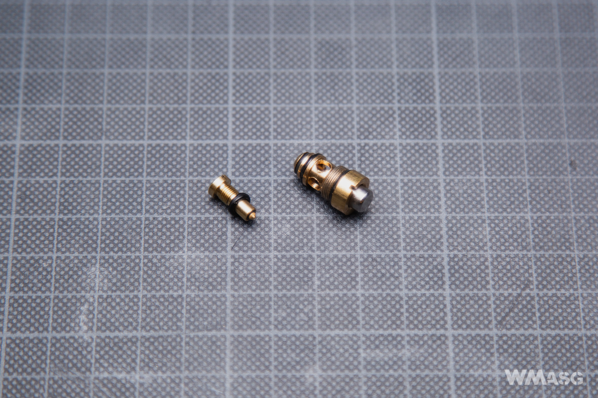

And since we are talking about the magazines ... The currently available ones are sold with magazines powered by Green Gas. These magazines are of a new design, equipped with new tighter valves, the quality of which cannot be assessed by a visual inspection.
Knowing the opinions about the seal of older Army Armament gas magazines, we did a simple test. We immersed a gas-filled magazine in a transparent container with water. And nothing happened. No gas bubbles escaped from the magazine, which indicates the seal of the new type of valves and the magazine housing itself is good. The immersion lasted for 10 minutes. We conducted the test twice on both magazines that we had at our disposal. After the first test, the magazines were dried and loaded with BBs. After all the gas had been used, they were refilled and re-immersed in water for another 10 minutes. The result was the same. After another drying session, we loaded the BBs and emptied the magazines. We did not notice any difference in the operation of the pistols after submerging two magazines twice. For better visibility, the tests were carried out with the floor plate completely disassembled, which task is to protect the lower magazine's valve.

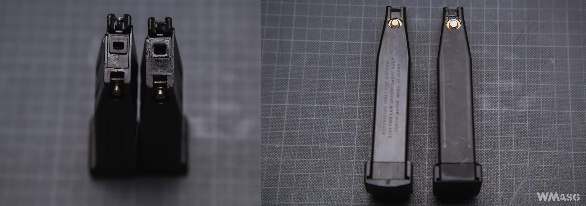

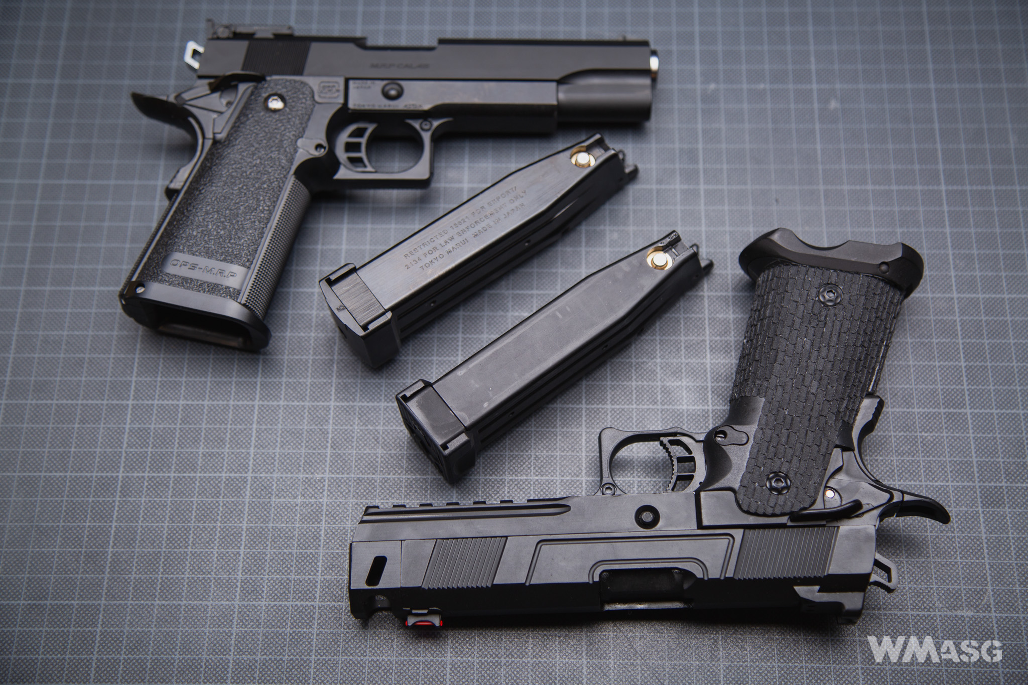

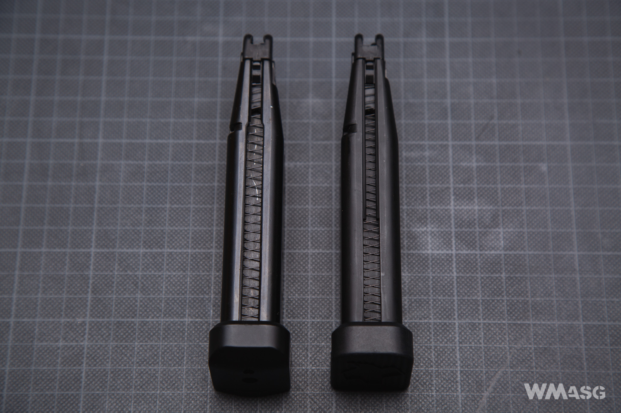

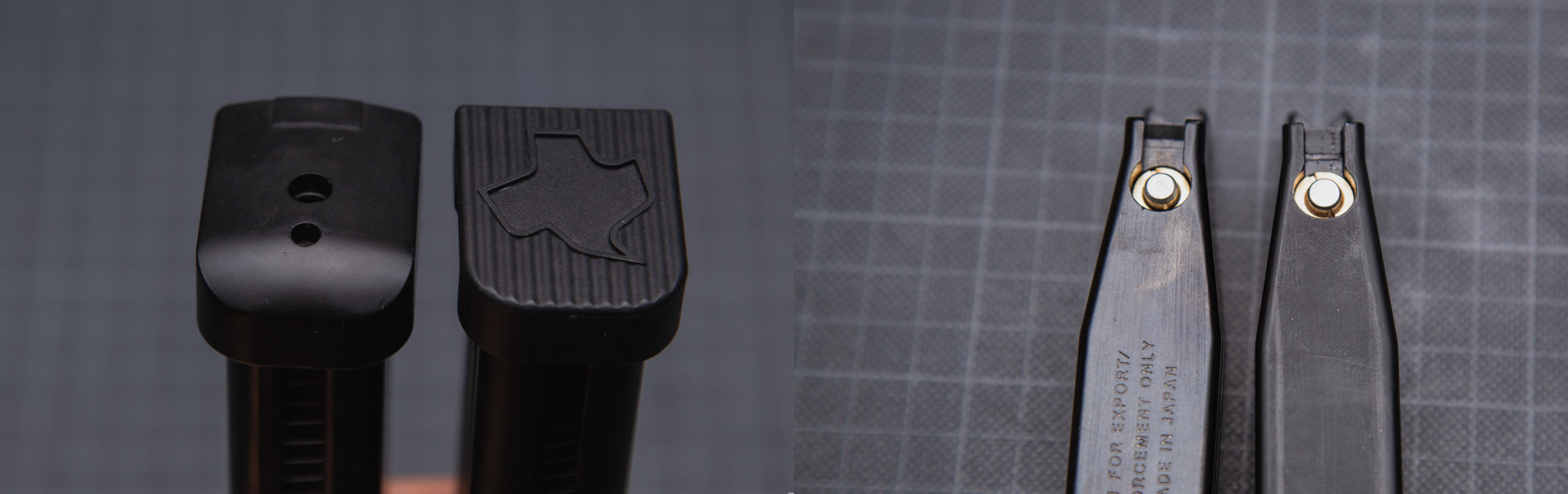

The second magazine test was a compatibility test. We used the R501 magazines interchangeably in a Tokyo Marui Hi-Capa 5.1 pistol and the Marui magazine in the Army pistol. Compatibility is maintained in both directions, with Army valves dispensing a larger portion of gas as the muzzle velocity of both guns using these magazines is slightly higher.
This information may be useful, but rather for owners of Marui replicas as Army Armament magazines cost about 16 EUR. Below are the Army and Tokyo Marui magazines. The Army one is on the right.

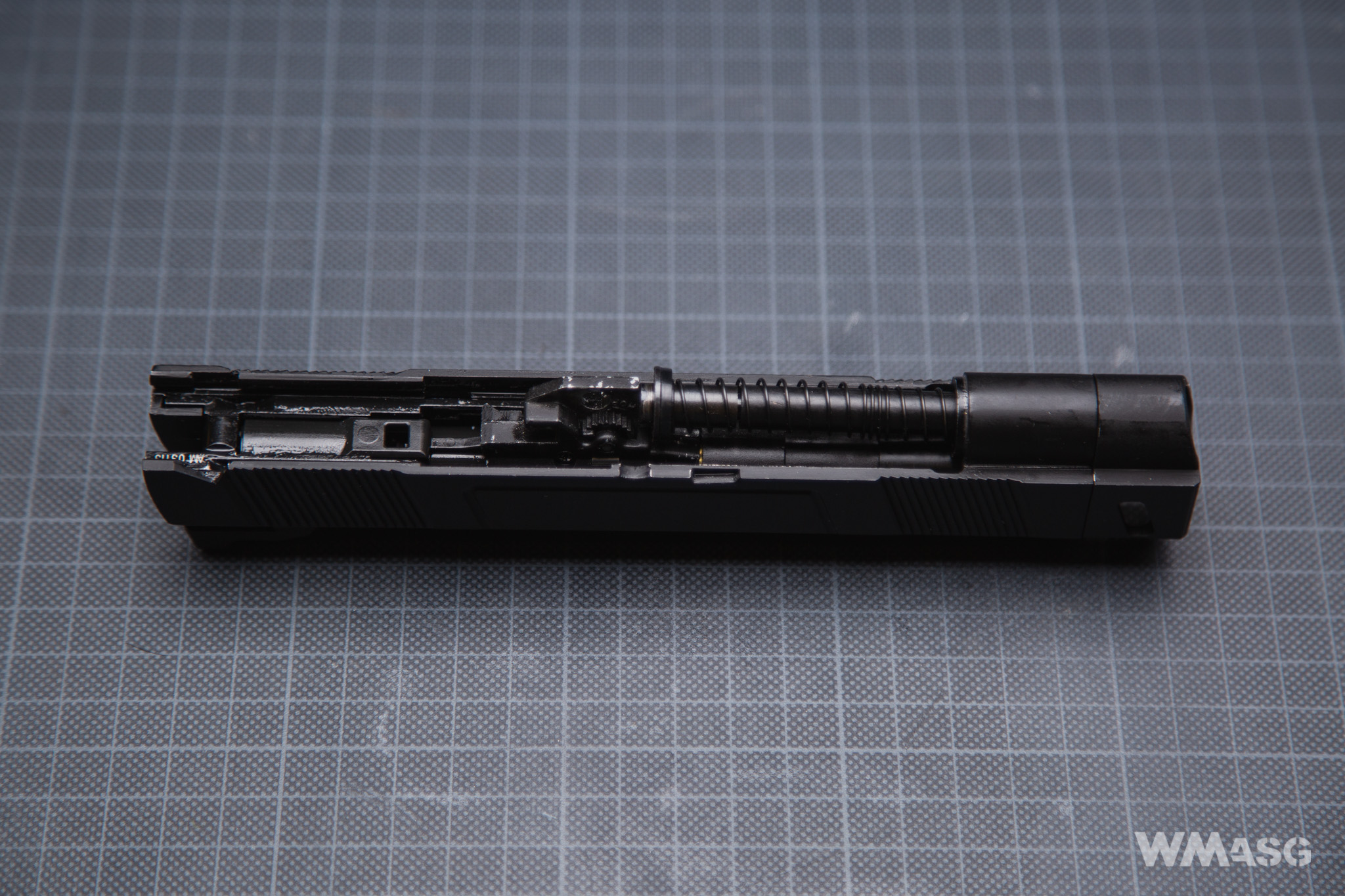

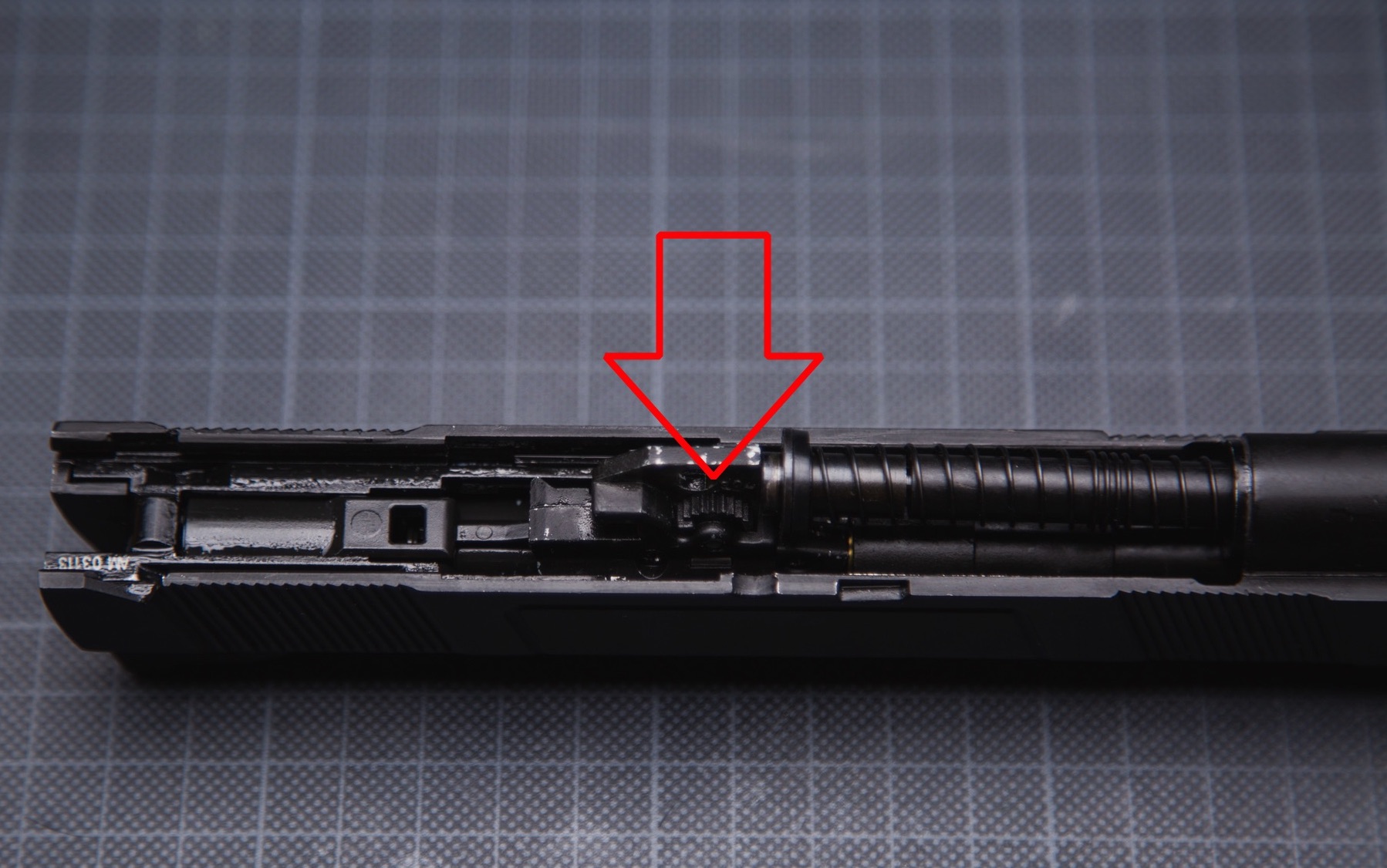

The replica's shooting range test went well. The HopUp adjustment is quite precise and keeps the settings. The problem is, of course, the need to remove the slide, but this is the case with a vast majority of replicas. The slide is pulled off in a typical way: in a replica without a magazine inserted, pull the slide back (but not completely, only the distance to the first notch), remove the blockade, then push the slide forward, towards the barrel front.
The adjustment is done with the knob on the left. Counterclockwise rotation - more HU.
