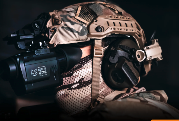

Nightfox has unveiled the Arctic, a lightweight thermal monocular that can be mounted on the head or helmet.

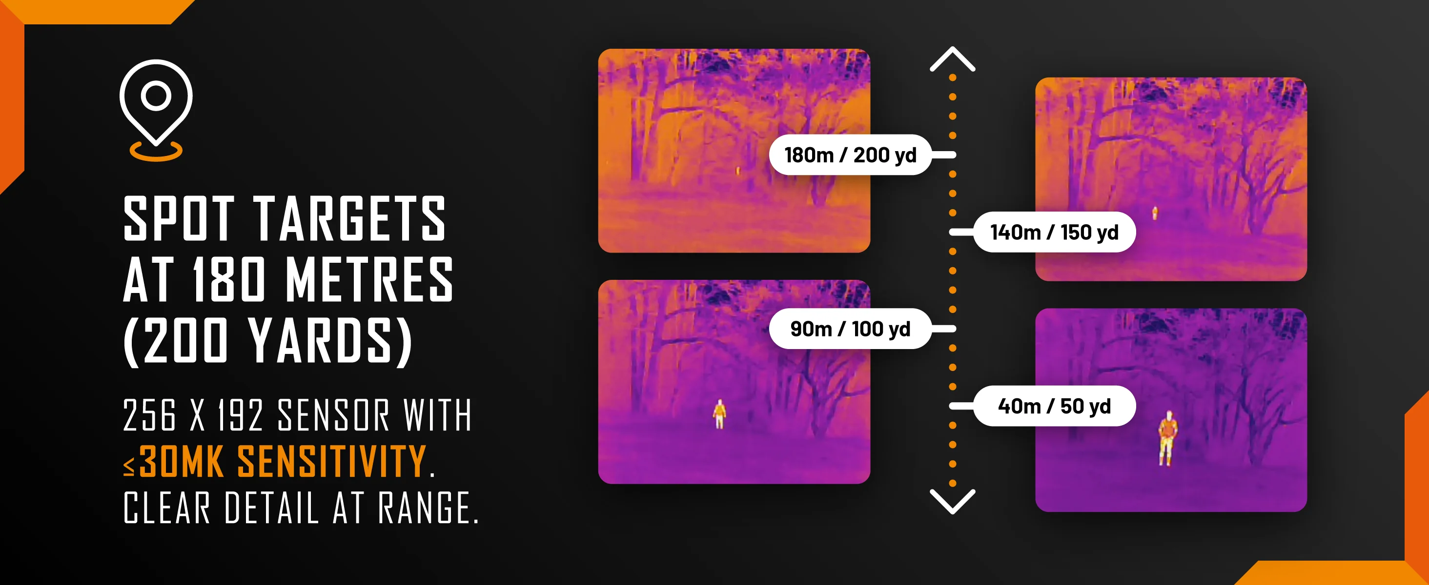

At the heart of the device is an uncooled thermal sensor with a resolution of 256 x 192 pixels, using 12 μm pixel pitch. The sensor operates at a 50 Hz refresh rate and has a NETD sensitivity of ≤30 mK. The high refresh rate is intended to reduce the less fluid image and latency found in simpler thermal imaging devices, which can be important when observing moving objects or while on the move. According to the manufacturer, the Nightfox Arctic can detect heat sources at a distance of approximately 180 meters, while object recognition is possible at around 100 meters.

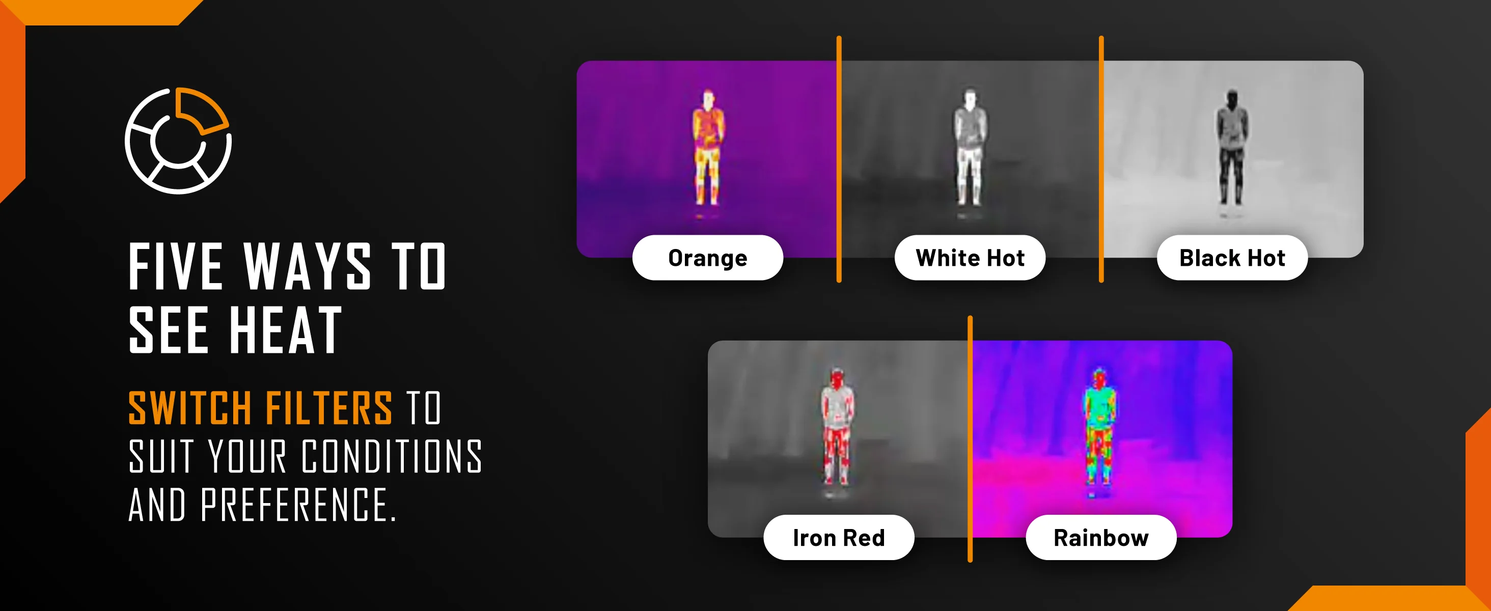

Its operation does not depend on visible light. The sensor analyzes thermal radiation emitted by objects, allowing it to operate even in complete darkness. The image is displayed on a 2.06-inch (5.2 cm) AMOLED screen with a resolution of 410 x 502 pixels. The use of this type of display is intended to improve image contrast and readability compared with less expensive designs equipped with standard LCD panels. Several color palettes are also available, allowing the image presentation to be adapted to observation conditions, including the default tint and optional rainbow, iron red, white hot, and black hot modes.

The monocular offers a basic 1x magnification and digital zoom of up to 4x. The 7 mm-diameter lens features fixed focus, while its field of view is approximately 23.8° horizontally and 17.4° vertically. This allows a larger area to be scanned more quickly and makes it easier to maintain situational awareness while observing terrain. One of the key features of the design is hands-free operation. The package includes an adjustable head strap and a dovetail-type adapter for helmet mounting (or another platform equipped with a suitable mount). The Arctic is also compatible with the Nightfox Prowl 2 mounting system, allowing it to be used as part of a larger setup combining thermal imaging with digital night vision.
