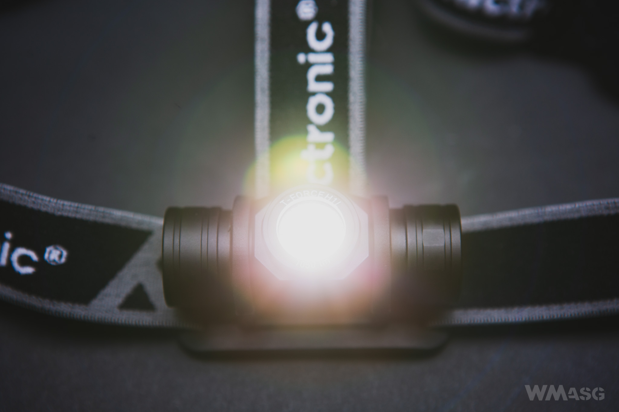

The first thing that catches one's attention when picking up the headlamp, is how light it is. It weighs only 34 g without the battery. In terms of design, the H1L does not stand out from similar modern flashlights made by other manufacturers. The head is located in the center of the tube, on one of the side of the device. The length of the flashlight is only 65 mm, the diameter of the tube at the widest point is about 23 mm (counting with the head its 27 mm), and the diameter of the head is about 21 mm. The housing of the device is made almost entirely of aircraft grade aluminium, and the switch located above the head is made of rubber.
The diameter of the tube changes practically along its entire length. In the central part it is wider as it is the base for the switch and the head. In the rear part there are ribs to improve the dissipation of heat emitted by the diode. At both ends of the tube there is the Mactronic logo. One of the two ends of the tube, the knurled one, turns out to be a cap that allows you to get inside the flashlight.
The head of the headlamp has a small, deeply-set and well-protected reflector. The head ring has the "T-FORCE H1L" and "1050 lm" makings on it. The first one is, of course, the designation of the headlamp line and model, the second one is the luminous flux value declared by the manufacturer. The reflector itself is only 12 mm in diameter and has a texture of an "orange peel", which affects a more even distribution of light. At the bottom of the reflector is a CREE XP-L LED emitter in HD version. Although this LED has been on the market for about 5 years now, it is still very popular and can be found in many good quality tactical flashlights.
By unscrewing the cap on one of the edges of the tube, you can get inside the battery compartment. Adapting the Mactronic T-Force H1L headlamp to different power sources in the popular size AA standard was a great idea. This solution has a very positive effect on the universality of the product, especially in the context of providing an emergency power supply. Headlamps can therefore be used with a popular AA battery, both regular and rechargeable one. Therefore you can use both standard 1.2V Ni-MH cells and the less popular 3.7V Li-Ion (type 14500) ones. Of course, despite the fact that the headlamp's driver copes well with various power sources, their properties directly translate into its performance, but I have written about it a bit further.
Coming back to the inside of the battery compartment: it is smooth and finished in black. The battery is inserted into the headlamp plus forward (there is a marking). The nut turns very smoothly on the thread, which is additionally secured with a seal. You can see very accurate workmanship here.
When reviewing previous Mactronic products, I have complained about their relatively low water resistance standards. This time it is exactly as it should be! The T-Force H1L flashlight meets the rigorous IP68 standard, which means that it is very well protected against dust and water in everyday use, including accidental immersion.

The Mactronic T-Force H1L has a wide lighting angle. When illuminating a uniform background at a short distance, you can distinguish the hotspot from the spill. However, the border is not clear and sharp. I would describe the color of light as neutral white.
As I have already mentioned, the flashlight can be powered by one of three power sources: AA batteries, 1.2V Ni-MH rechargeable batteries, and 3.7V Li-Ion cells. However, they affect the maximum performance of the device and its working time.
To take full advantage of the XP-L HD LED, you must use the Li-Ion power source. In his case, in the TURBO operating mode, the flashlight, according to the manufacturer's statements, is able to produce a luminous flux of 1050 lumens. In this mode, however, you can only use it for a few dozen seconds, after which the flashlight will smoothly reduce the light output to around 350 lumens. After a while, you can return to using it at full power by re-activating the TURBO mode. Using this mode, the flashlight is able to work a maximum of 40 minutes, while frequent use of the highest luminous flux will significantly reduce this time. In the intermediate mode, with this type of power supply, you can enjoy the headlamp's light for up to 10 hours at 15 lumens. According to the data in the user's manual, in special modes, one can use the light to up to 29 hours in the MOONLIGHT mode (1 lumen) and up to 12 hours in SOS mode.
For other power sources (a 1.2V Ni-MH battery and AA batteries), the manufacturer declares the maximum possible luminous flux as 270 lumens. Operating times in all modes (excluding special modes) range from about 70-80 minutes (alkaline batteries and 2500mAh Ni-MH batteries) to about 20-22 hours in the 15 lumens mode. In the MOONLIGHT mode, the flashlight can work for up to 60 hours, and in SOS mode for up to 7 hours, using an alkaline battery, or for up to 18 hours, using a Ni-MH 2500mAh battery.
