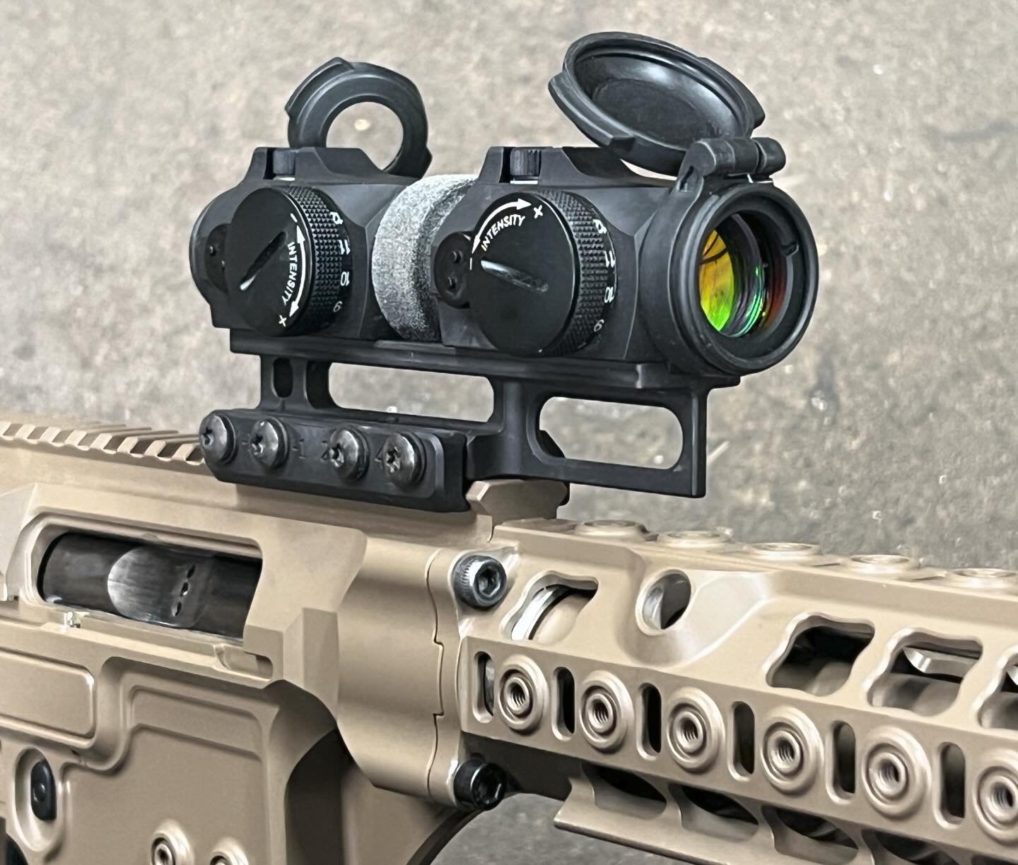

At this point, the simplest possible solution was proposed: a mount visible in the title photo that allows for attaching two identical red dot sights in the main sighting line, set for both types of ammunition. This also did not meet the expectations of the customer, who then turned to the competition for help. According to Spuhr AB (which patented the latter project), the lack of reasonable products on the market allows them to assume that the next contractor did not meet the original requirements.
The entire initiative was not in vain, as the mount patented by the manufacturer was included in the product catalog for 2024.
