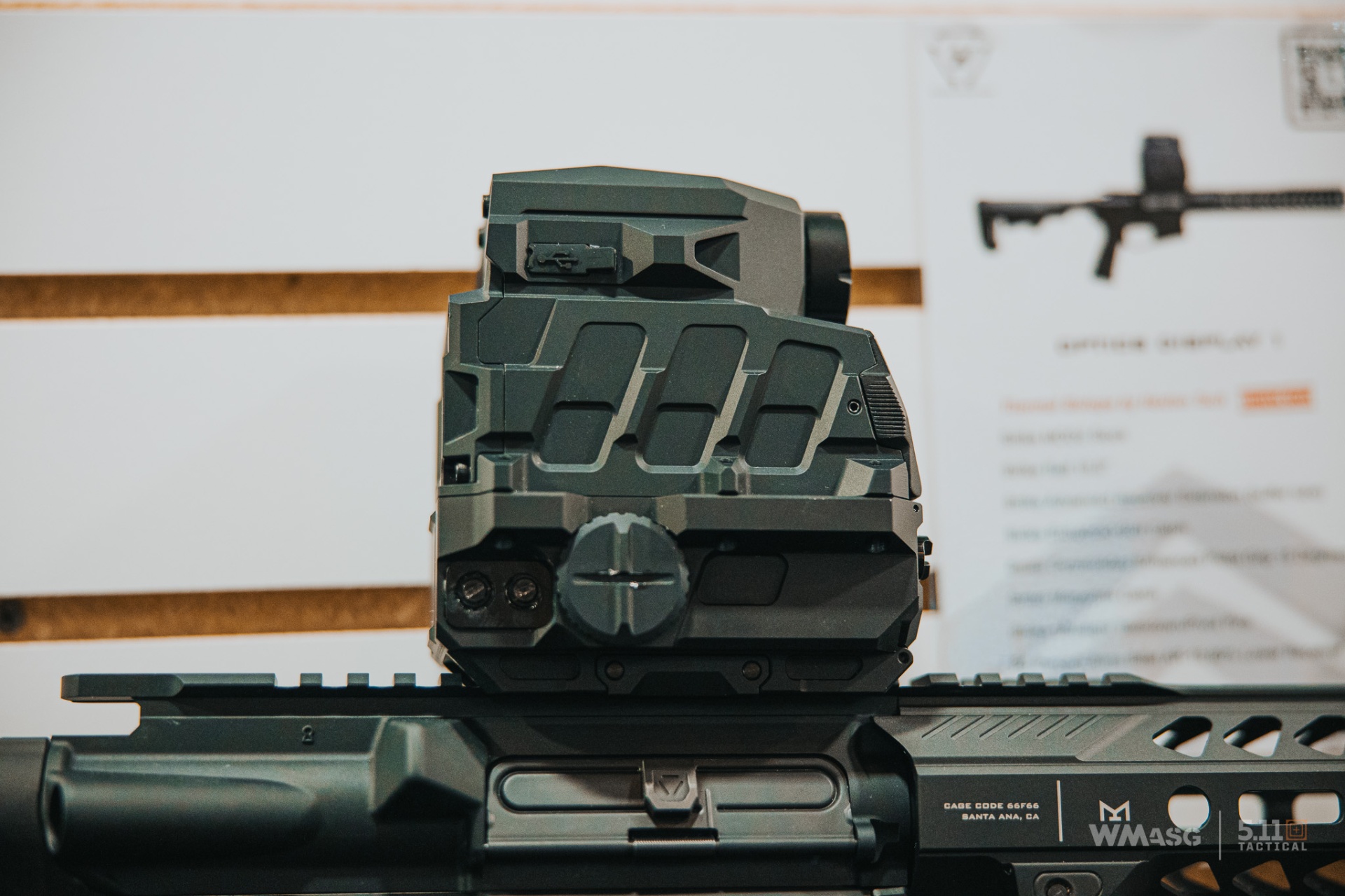

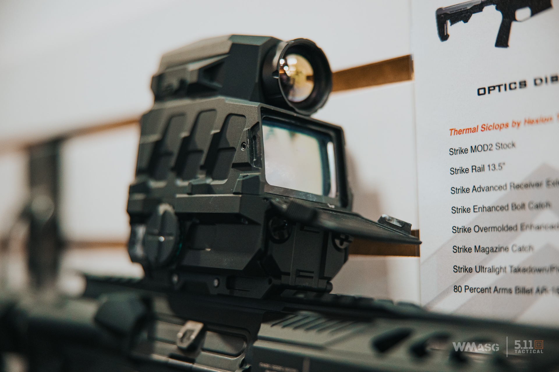

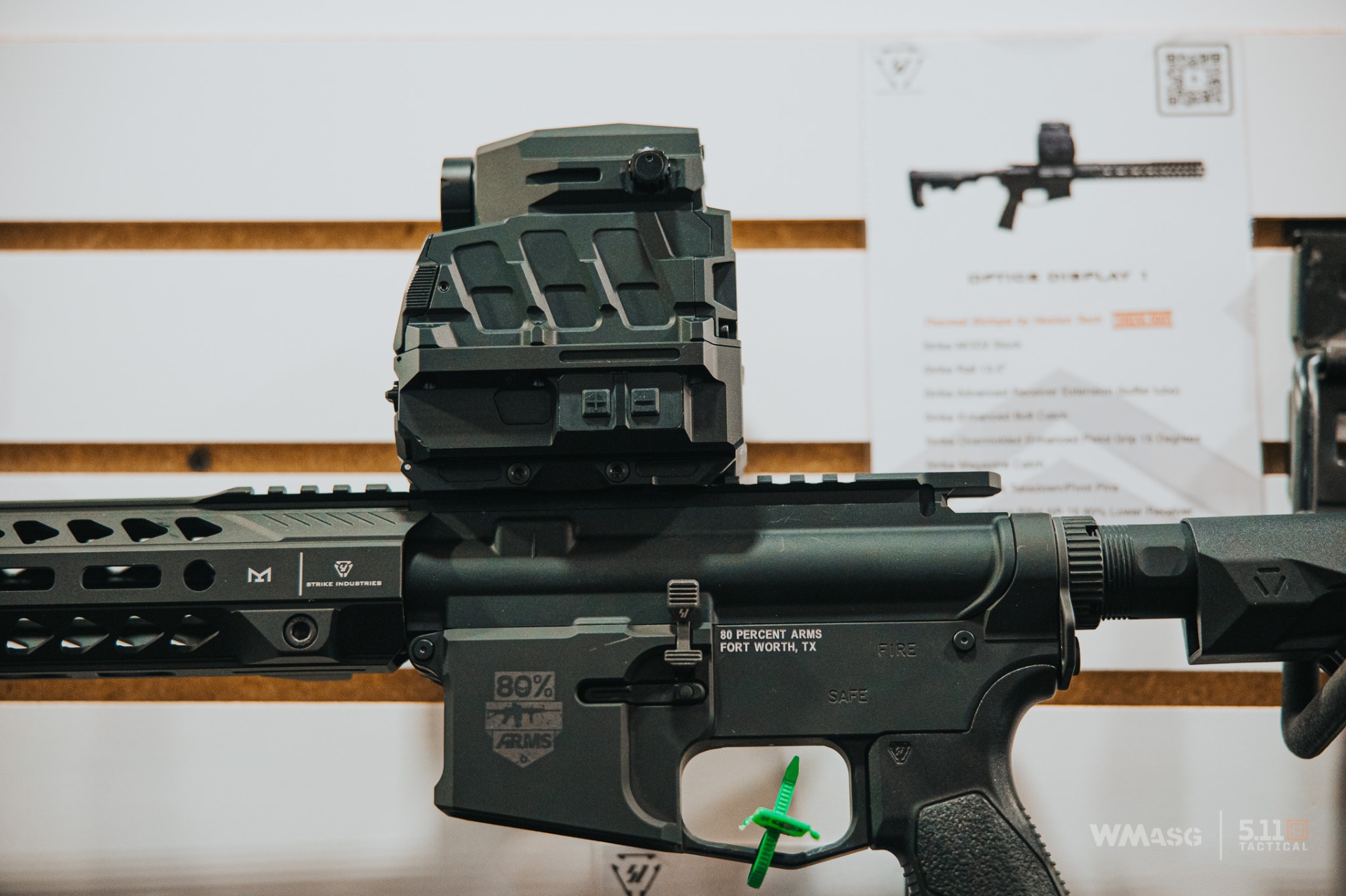

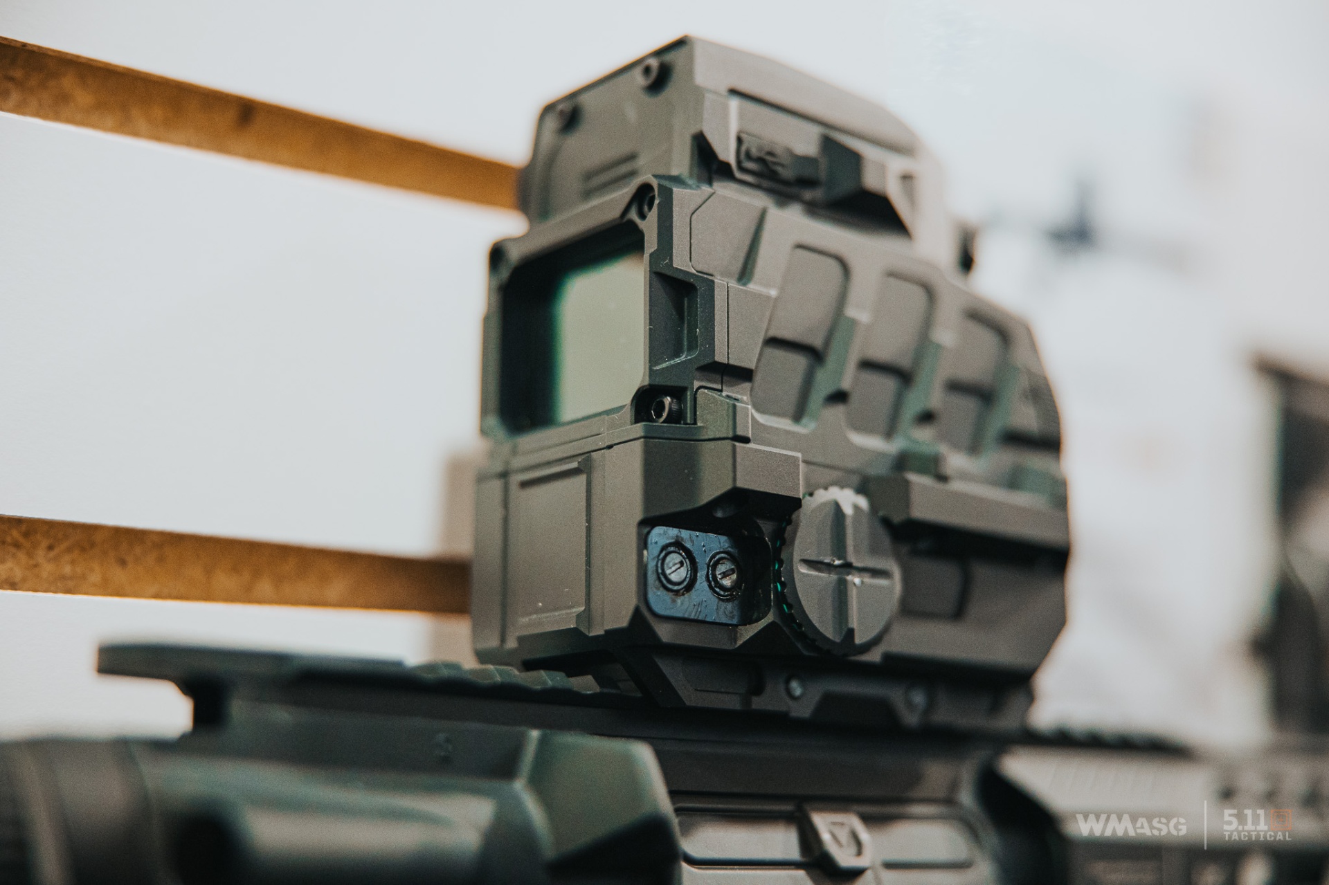

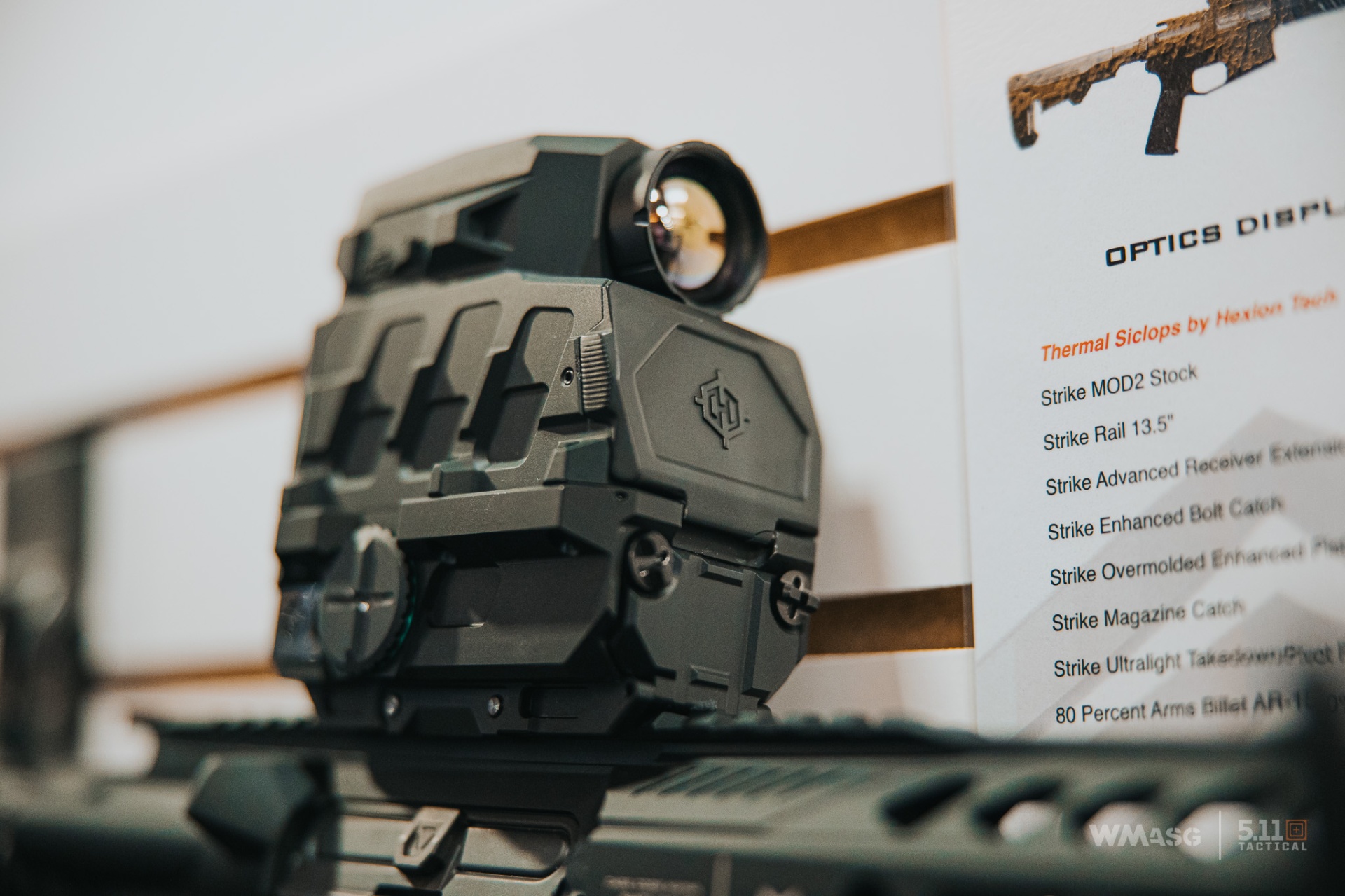

The Hexion Siclops is a solution that combines a refelx sight and a thermal imager in one device. The prototype from Strike Industries is equipped with a thermal sensor with a resolution of 384x288 pixels (12 μm) with a sensitivity of NETD ≤40 mK.

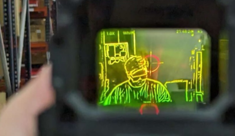

The sight can operate in one of three thermal imaging modes: fusion with a red dot sight, highlighting the warmest objects, and outlining the contours themselves. Advanced AI algorithms are responsible for their correct recognition. The image is superimposed on the optical channel of the red dot sight, which is based on an OLED screen and is refreshed at a frequency of 50 Hz. The optics used together with the sensor allow for detection of an object the size of a human from a distance exceeding 400 meters.
Among the additional features and functions of the sight, it is worth mentioning the possibility of changing the reticle in the red dot sight, recording videos and photos from the thermal imaging layer (on a Micro SD card), the presence of a motion sensor that automatically puts the device into sleep mode and wakes it up, a separate red dot sight battery (CR2032), as well as support for rechargeable equivalents of CR123 batteries (two of them power the thermal imager). Ultimately, the product is to be protected against the adverse effects of dust and water in the high IP67 standard.
