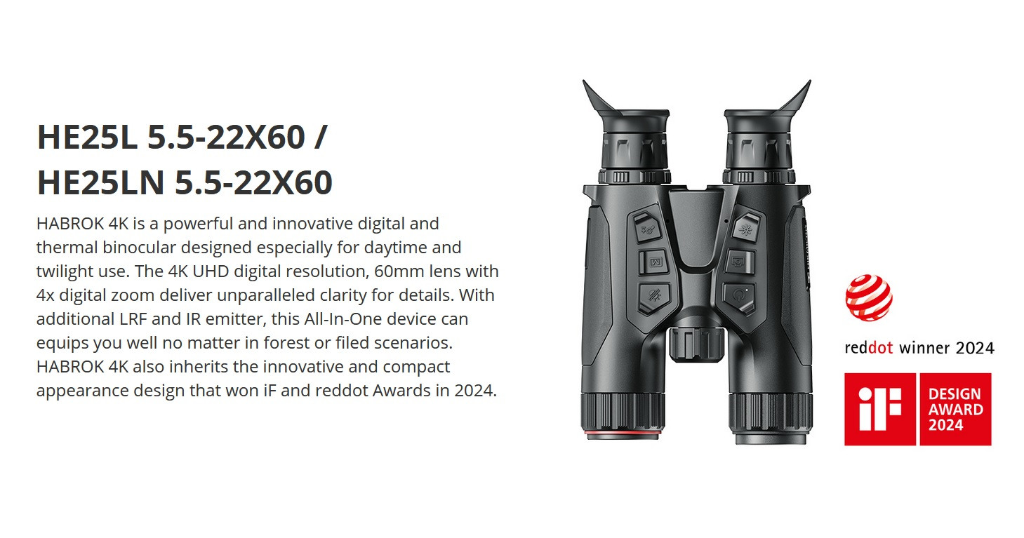

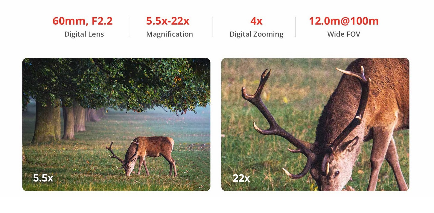

Habrok 4K binoculars marked as HE25L 5.5-22x60 and HE25LN 5.50-22x60 (differing in the wavelength of the IR illuminator, 850 nm and 940 nm respectively) a CMOS matrix with a resolution increased to 3840x2160 px and 60 mm, F2.2 optics was used. The basic magnification of the classic image layer has increased to 5.5x, which results in more detail visible at a longer ranges, additionally enhanced by a larger number of pixels. The effect of the new configuration is a reduced field of view, which is now 6.9° x 4.1° / 12.0 m × 7.2 m (@100 m).
