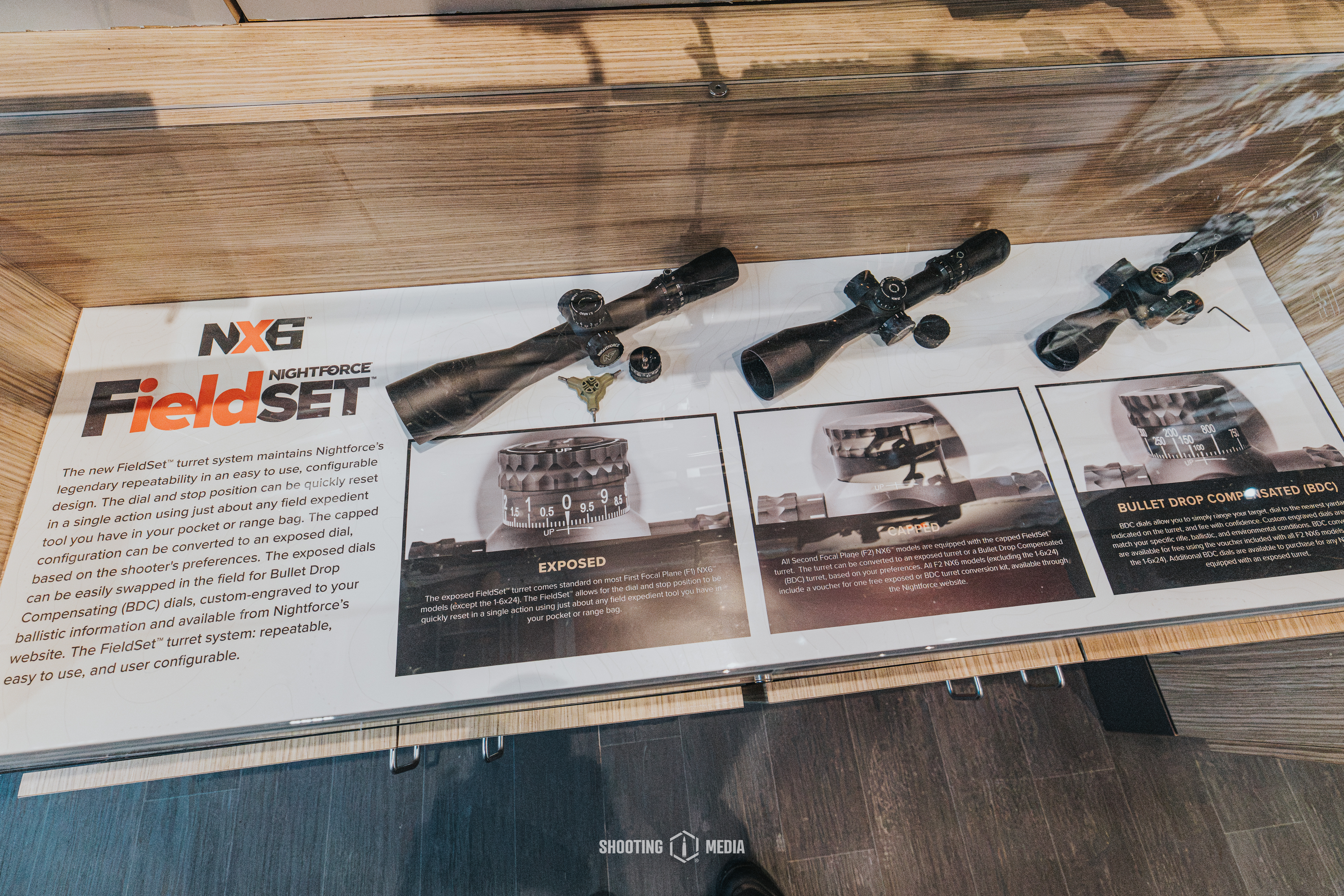

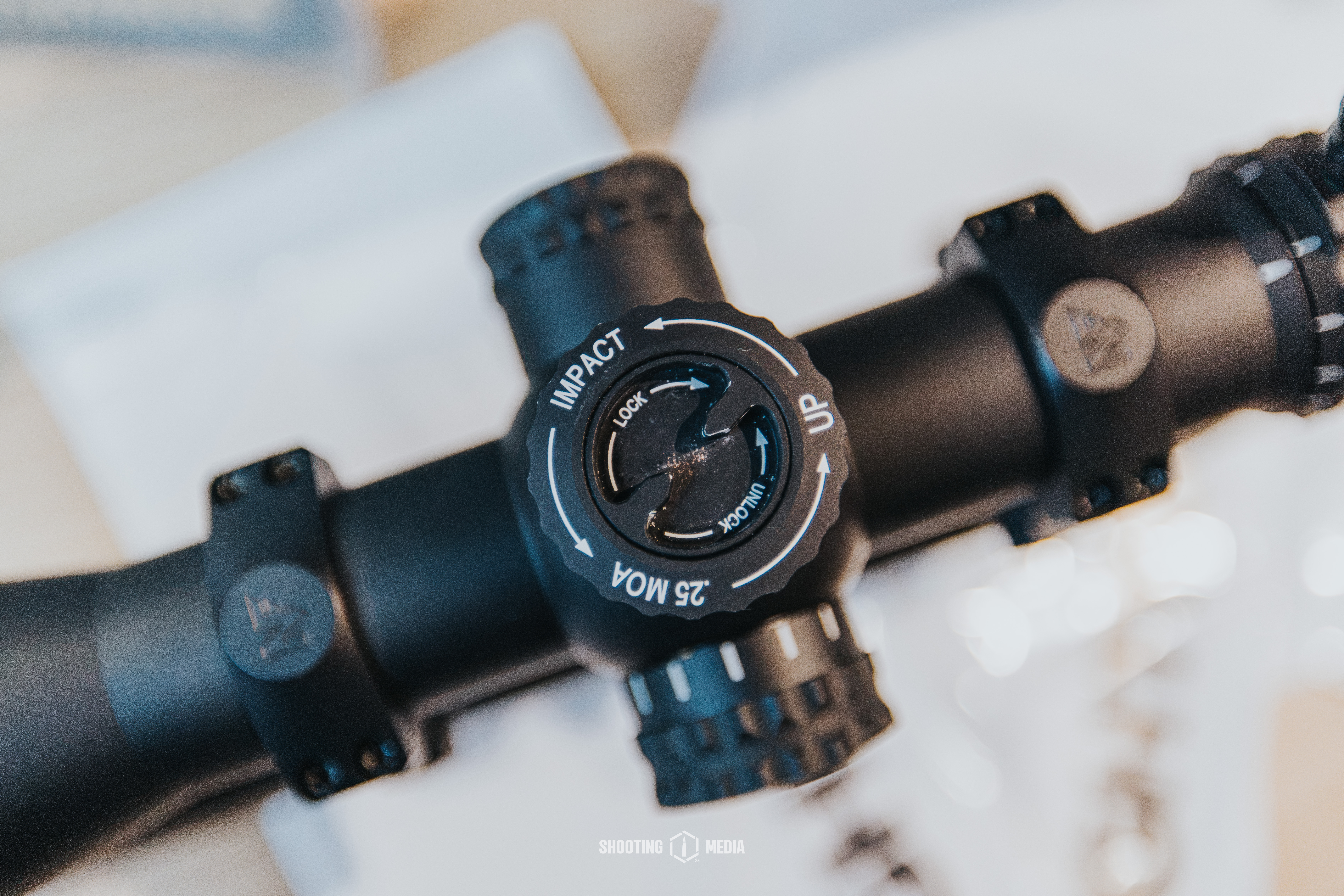

One of the key features of the NX6 is the new FieldSet adjustment system. FieldSet allows the zero to be set quickly without specialized tools, while the turret and stop position can be reset using a readily available tool. The package also includes a dedicated multifunctional NX6 Multi-Tool, which can be used, among other things, to configure the FieldSet system. The system is available in either capped or exposed configurations, while selected models can also use interchangeable BDC turrets whose markings can be customized to specific ballistic data. The two 1–6×24 versions are the exception: they do not feature FieldSet and instead use conventional capped, finger-adjustable turrets. On the remaining F2 models, the factory configuration is capped and can be converted to an exposed setup, while F1 scopes, with the exception of the 1–6×24 F1, come with an exposed FieldSet as standard.

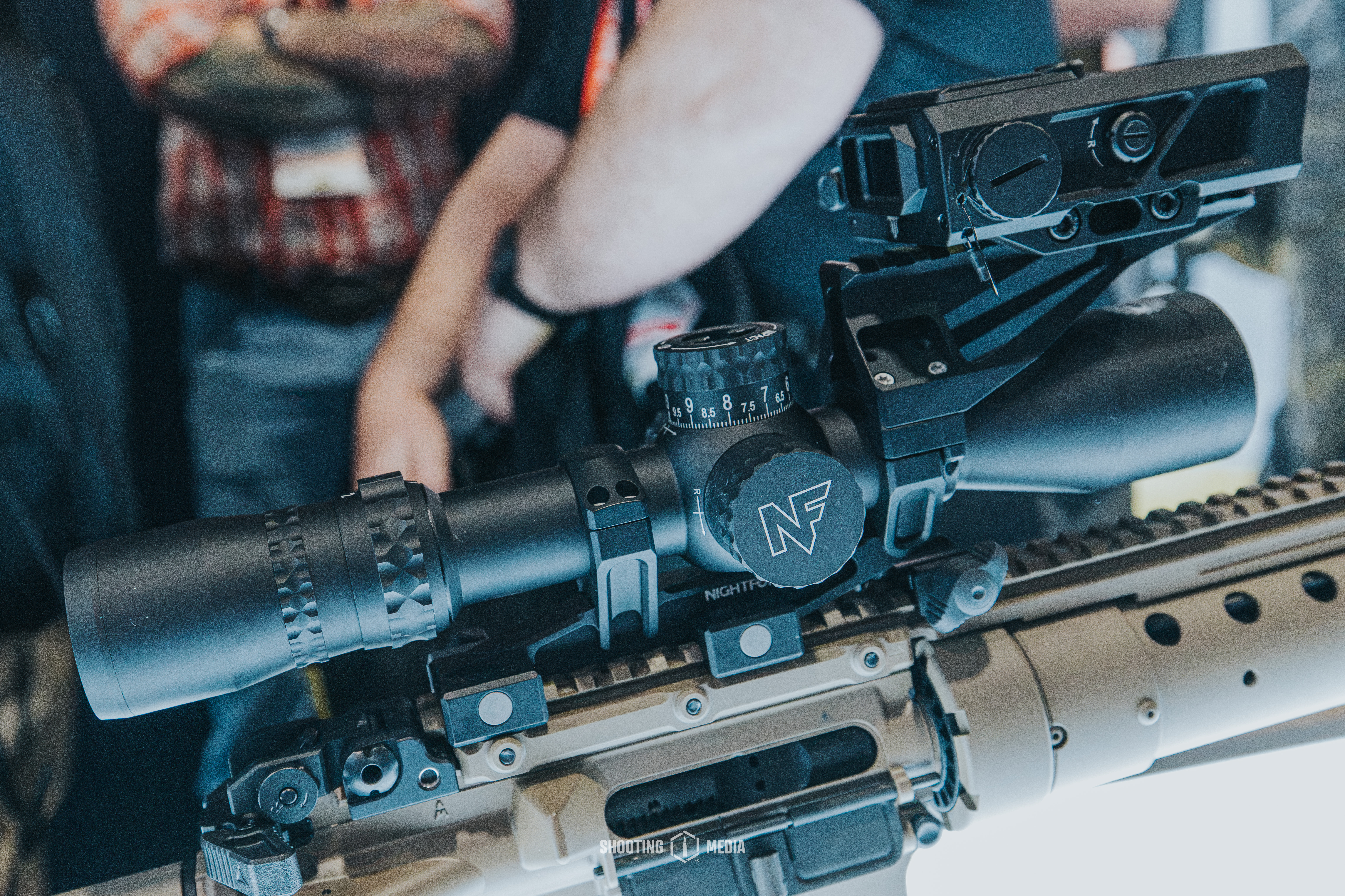

The smallest member of the new family is the NX6 1–6×24 SFP. This scope weighs 541 g and measures 259 mm in length, with a 30 mm tube. Its 1–6× magnification range classifies it as an LPVO, offering a wide field of view at 1× and more detailed observation at 6×. The manufacturer has used a second focal plane, keeping the reticle visually stable as magnification is changed. The scope features conventional capped, finger-adjustable turrets, with 0.5 MOA clicks and 120 MOA of adjustment in both elevation and windage. Parallax is factory-set at 125 yards, or approximately 114 m. The field of view is approximately 38.7 m at 100 m at 1×, decreasing to around 6.4 m at 100 m at 6×. Eye relief is 4 inches, or 101 mm, while exit pupil measures 7.4 mm at 1× and 4.0 mm at 6×. Illumination is provided by an externally adjustable daylight-visible system. This variant is available with two reticles: 4A-i and FC-6c. The NX6 1–6×24 F1 is based on a similar design but differs primarily in its first focal plane and reticle. It is a compact scope measuring 259 mm and weighing 536 g, with a 30 mm tube. It uses a first focal plane reticle. Adjustments are in 0.2 MRAD clicks, with a total adjustment range of 34.9 MRAD in both elevation and windage. Parallax, field of view, eye relief and exit pupil remain the same as in the SFP version. The scope uses the FC-DMx reticle.

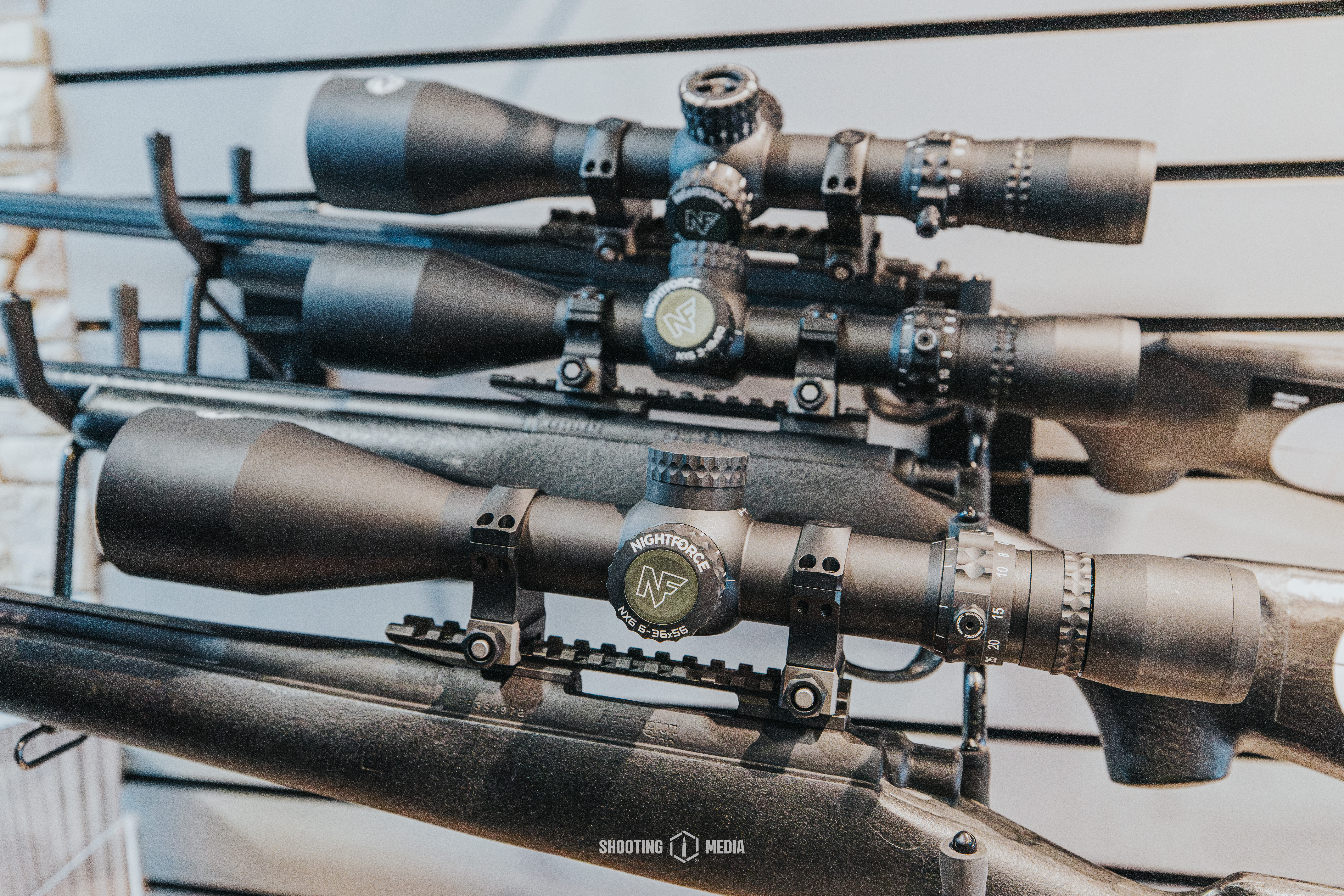

The NX6 2–12×42 SFP weighs 652 g, measures 318 mm and offers a maximum magnification of 12×. The scope has a 30 mm tube, a capped FieldSet turret and 0.25 MOA clicks. The adjustment range is 115 MOA in elevation and 90 MOA in windage. Parallax is adjustable from 10 m to infinity. The field of view is 16.7 m at 2× and 3.3 m at 12× per 100 m. Eye relief is 89 mm, while exit pupil measures 7.5 and 3.5 mm, respectively. Illumination is provided by the Digillum system, allowing the reticle brightness to be adjusted to prevailing lighting conditions. This variant is available with MOAR and 4A-i reticles. The NX6 2–12×42 F1 weighs 655 g and measures 318 mm, uses a 30 mm tube and features an exposed FieldSet. Users can choose between 0.25 MOA or 0.1 MRAD clicks, with an adjustment range of 115 MOA, or 33.4 MRAD, in elevation and 90 MOA, or 26.2 MRAD, in windage. Parallax is adjustable from 10 m to infinity. The field of view is 16.7 m at 2× per 100 m, decreasing to 3.2 m at 12×. Eye relief remains at 89 mm. The model uses the FC-MRx reticle, specifically developed for the 2–12×42 F1.
The NX6 3–18×50 SFP offers magnification up to 18×. It weighs 757 g and measures 353 mm in length, while still using a 30 mm tube. The manufacturer provides 120 MOA of elevation adjustment and 85 MOA of windage adjustment, with 0.25 MOA clicks and parallax adjustment from 10 m to infinity. The field of view is 11.8 m per 100 m at 3× and just 2.4 m at 18×. Exit pupil ranges from 7.4 to 2.8 mm. The scope is equipped with Digillum and a capped FieldSet. The 3–18×50 SFP is available with either the 4A-i or MOAR reticle. The NX6 3–18×50 F1, meanwhile, uses a first focal plane reticle. The scope weighs 768 g, measures 353 mm and also uses a 30 mm tube. Adjustment range is 120 MOA, or 34.9 MRAD, in elevation and 85 MOA, or 24.7 MRAD, in windage. Users can choose between 0.25 MOA or 0.1 MRAD clicks. The FieldSet is exposed on this model. The F1 version offers a considerably wider selection of reticles: MIL-C, MIL-XT, MOA-XT and MOA-C.
Another new model is the NX6 4–24×50, available exclusively in the SFP version. Measuring 353 mm and weighing 774 g, it is only slightly heavier than the 3–18×50, but offers greater maximum magnification. The tube remains 30 mm, adjustment range is 115 MOA in elevation and 85 MOA in windage, while the FieldSet is used in a capped configuration with the option to configure it as exposed. Parallax can be adjusted from 10 m to infinity. The field of view is 8.8 m per 100 m at 4× and 1.7 m at 24×. Eye relief remains at 89 mm, while exit pupil decreases from 7.1 to 2.1 mm. Nightforce describes this model as a solution for, among others, hunters operating in open terrain, predator hunters and law enforcement or military users. The model is available with either the 4A-i or MOAR 20 MOA reticle. The NX6 5–30×56 F1 offers a magnification range more typical of optics intended for long-range shooting. The scope measures 379 mm, weighs 876 g and has a 34 mm tube. Elevation adjustment reaches 120 MOA, or 34.9 MRAD, while windage adjustment is 85 MOA, or 24.7 MRAD. The FieldSet is exposed, clicks can be set to 0.25 MOA or 0.1 MRAD, and parallax adjustment starts at 10 m and extends to infinity. The field of view at 5× is 8.1 m per 100 m, while at 30× it decreases to 1.3 m. Exit pupil measures 7.2 and 1.9 mm, respectively. The model is available with MIL-C, MIL-XT, MOA-C and MOA-XT reticles.
The widest magnification range among the SFP models is offered by the NX6 6–36×56. Adjustment range is 115 MOA in elevation and 85 MOA in windage, clicks are 0.25 MOA, and parallax can be adjusted from 10 m to infinity. The field of view is 6.5 m per 100 m at 6× and 1.1 m at 36×. As magnification increases, the exit pupil decreases from 7.2 mm at 6× to 1.6 mm at 36×. Eye relief is 89 mm. This model features Digillum and a capped FieldSet. The scope weighs 890 g, measures 389 mm in length and has a 34 mm tube. A characteristic feature of the NX6 6–36×56 SFP is the previously described FVR-1 reticle, developed for small and difficult-to-locate targets.
NX6 6–36×56 F1 retains the 389 mm length and 34 mm tube, but its weight increases to 896 g. The model features FFP, an exposed FieldSet, 0.25 MOA or 0.1 MRAD clicks, and an adjustment range of 115 MOA, or 33.4 MRAD, in elevation and 85 MOA, or 24.7 MRAD, in windage. Parallax also starts at 10 m. The field of view remains the same as on the SFP version: 6.5 m per 100 m at 6× and 1.1 m at 36×, while exit pupil measures 7.2 and 1.6 mm, respectively. Eye relief is slightly greater at 90 mm. Available reticles include MIL-C, MIL-XT, MOA-C and MOA-XT.
