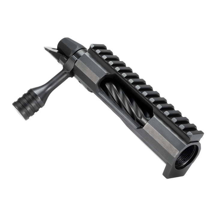

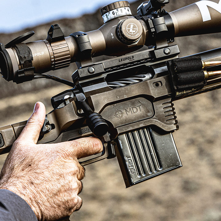

The Fuzion is the steel variant aimed primarily at competition shooters. Its action is made from pre-hardened 416R stainless steel and is nitrided as standard, while the bolt raceways are machined using electrical discharge machining. An integral Picatinny rail with a 20 MOA cant is incorporated into the top of the action. The design also features a side-mounted bolt release that facilitates bolt removal. An Alpine Port version is available, in which the rail is split above the ejection port to reduce weight. The model is offered in both Short Action and Long Action configurations. Short-action variants are available with .223, .308, or Magnum bolt faces, while long-action versions are offered in .308, Magnum, and .338 Lapua Magnum configurations. Both right- and left-handed Short Action versions with a .308 bolt face are available. The short action features a cutout for AW magazines, while the long action has a BDL magazine cutout. The .338 Lapua Magnum version features a cutout for an extended Wyatt magazine. The Short Action version weighs approximately 964 g, the Long Action approximately 1,077 g, the Long Action Alpine approximately 850 g, and the .338 Lapua Magnum version approximately 1,106 g.

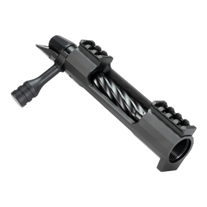

The Fuzion Ti was developed for lightweight hunting rifles. Its action is made from 6Al-4V titanium alloy and coated with DLC, which is intended to reduce friction and surface wear. The integral Picatinny rail with a 20 MOA cant is split by the Alpine Port cutout. The Short Action weighs approximately 595 g, while the Long Action weighs approximately 624 g, making both significantly lighter than the steel Fuzion. The right-handed Fuzion Ti is available in Short Action or Long Action configurations with a .308 or Magnum bolt face. The left-handed version is offered in a Long Action Magnum configuration. All variants feature a 75-degree bolt lift and a BDL magazine cutout. This allows the use of an internal magazine with a hinged floorplate or, when paired with the appropriate bottom metal assembly, a detachable magazine in the AICS standard.

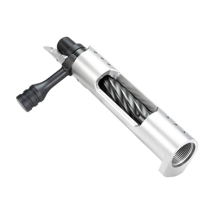

The Razor, meanwhile, is a more affordable alternative to the Fuzion, offering greater flexibility in configuring the optic mounting system. Its action is made from pre-hardened 416R stainless steel, but the rail is not an integral part of the action. An interface using locating pins and screws allows the installation of a full-length aluminum or steel rail, two short rail sections, or compatible rings mounted directly to the action. These components are selected separately depending on the planned rifle configuration. The Razor is available as a Short Action with a .308 bolt face and as a Long Action Magnum. Both variants feature a 75-degree bolt lift, a Wyatt BDL magazine cutout, and bolt raceways machined using electrical discharge machining. The shorter variant weighs approximately 737 g, while the longer one weighs approximately 822 g.
