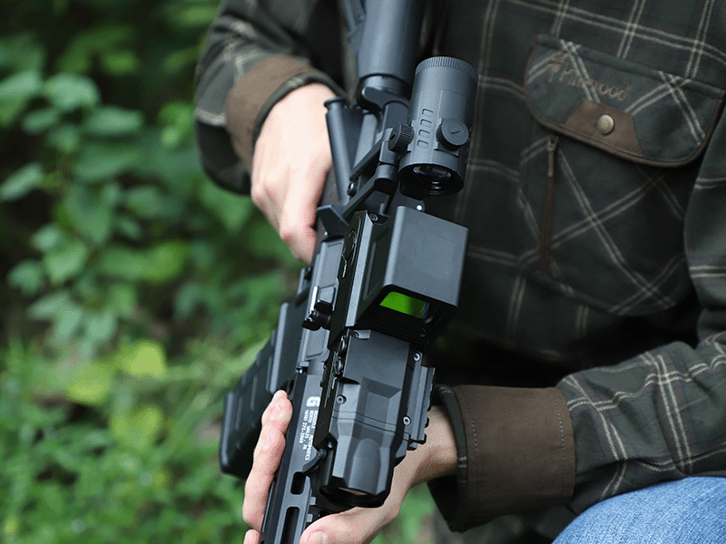

The InfiRay Fast FAH25 offers various modes of applying the thermal layer to the OLED screen (34 mm x 25 mm) showing the optical channel. In addition to the feature of using the device as a traditional red dot sight (the battery life then reaches 65 hours), the user can also highlight the outlines of hot objects, highlight their entire silhouette, and completely switch to thermal imaging. Although the basic optical magnification of the device is 1x, the thermal imager allows to use 2x digital magnification.
In thermal imaging mode, the FAH25 sight works for at least 4 hours using two CR123 batteries. The manufacturer also declares compatibility with rechargeable 3.7 V batteries as well as with an external power source via the USB-C interface.
The sight is adapted for use on weapons (resistance 1200g / 0.3ms) also with a special 3x magnifier with QD mount. The InfiRay Fast FAH25 weighs approximately 652 grams and is protected against the adverse effects of water in the high IP67 standard.
