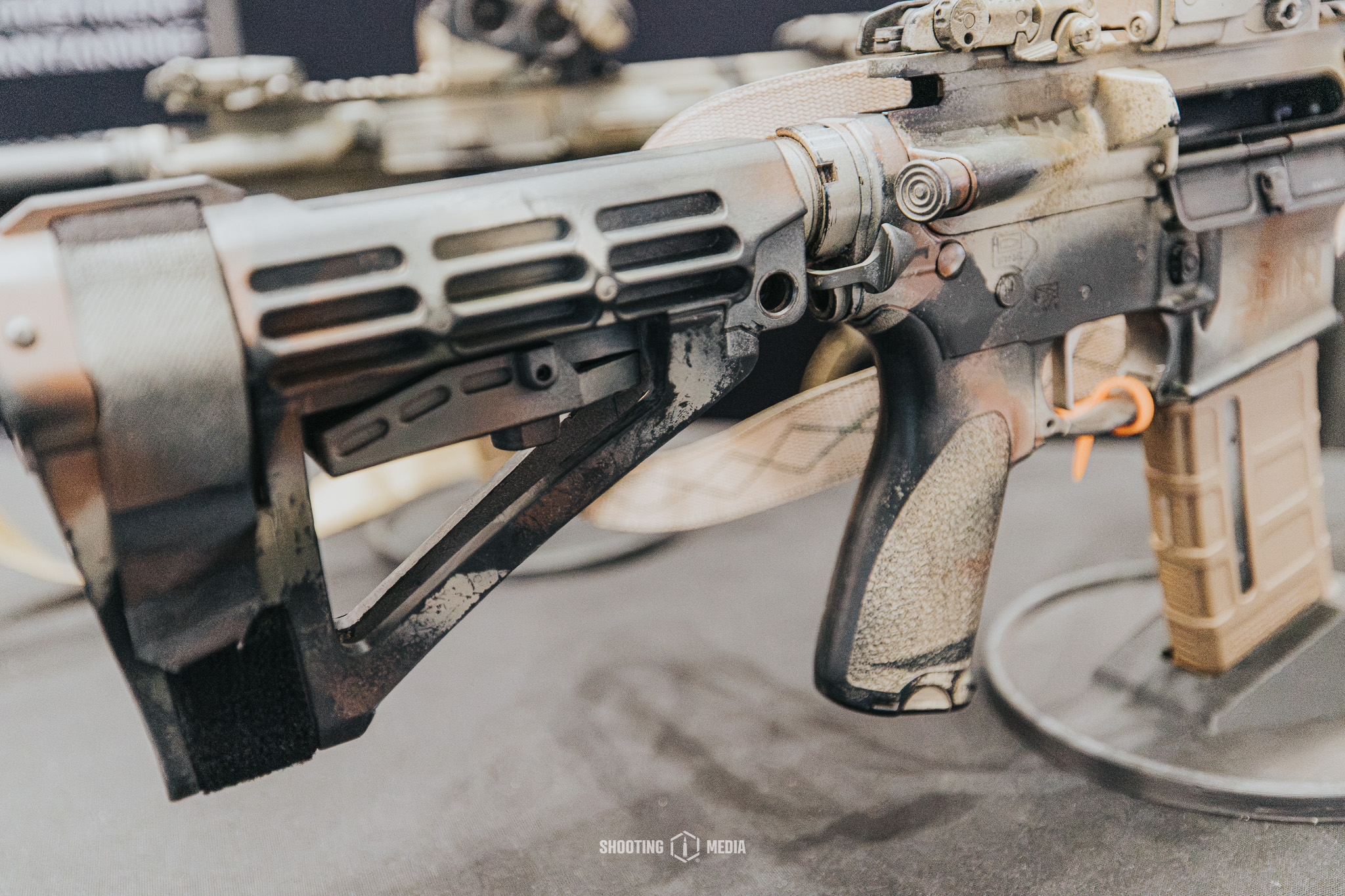

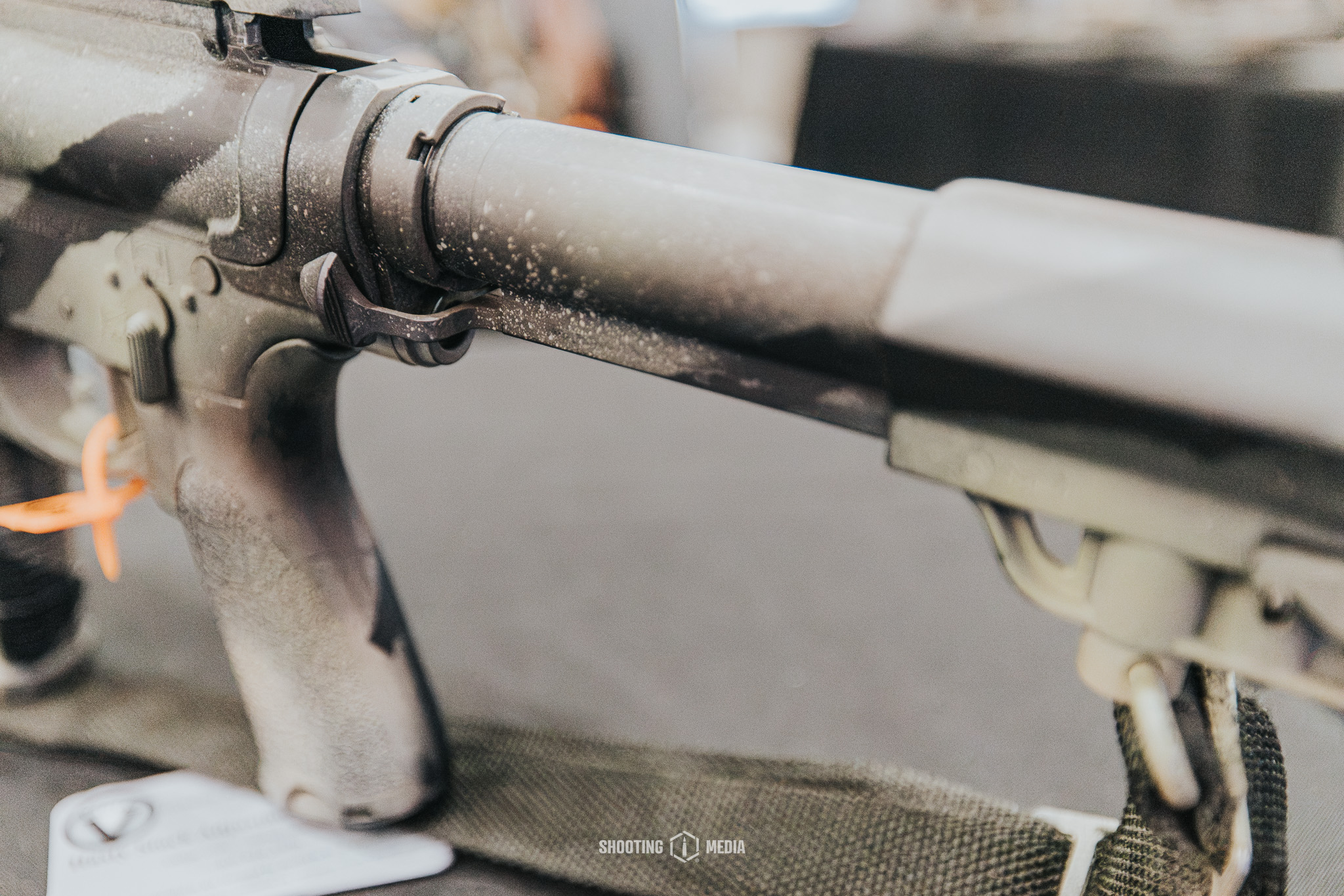

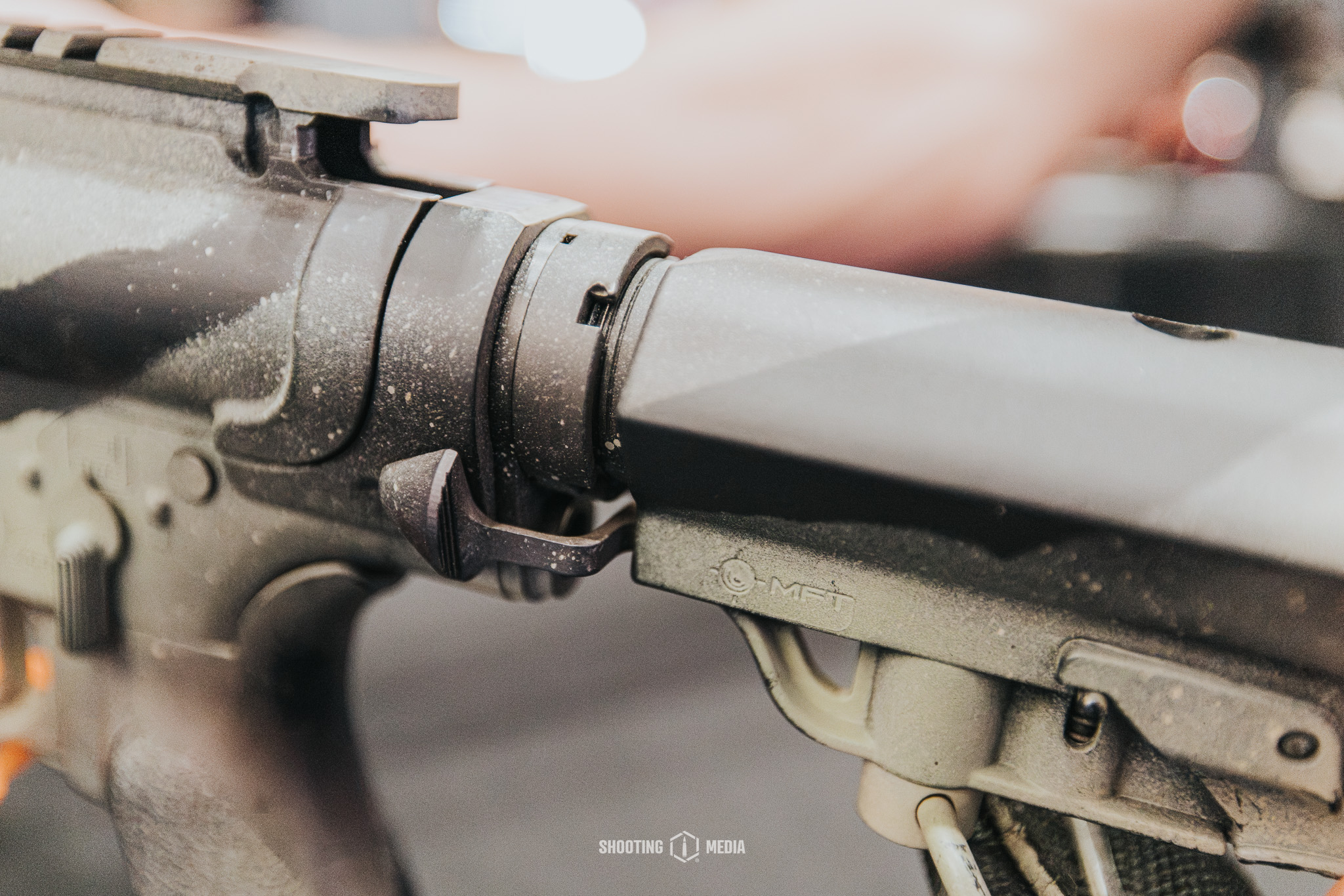

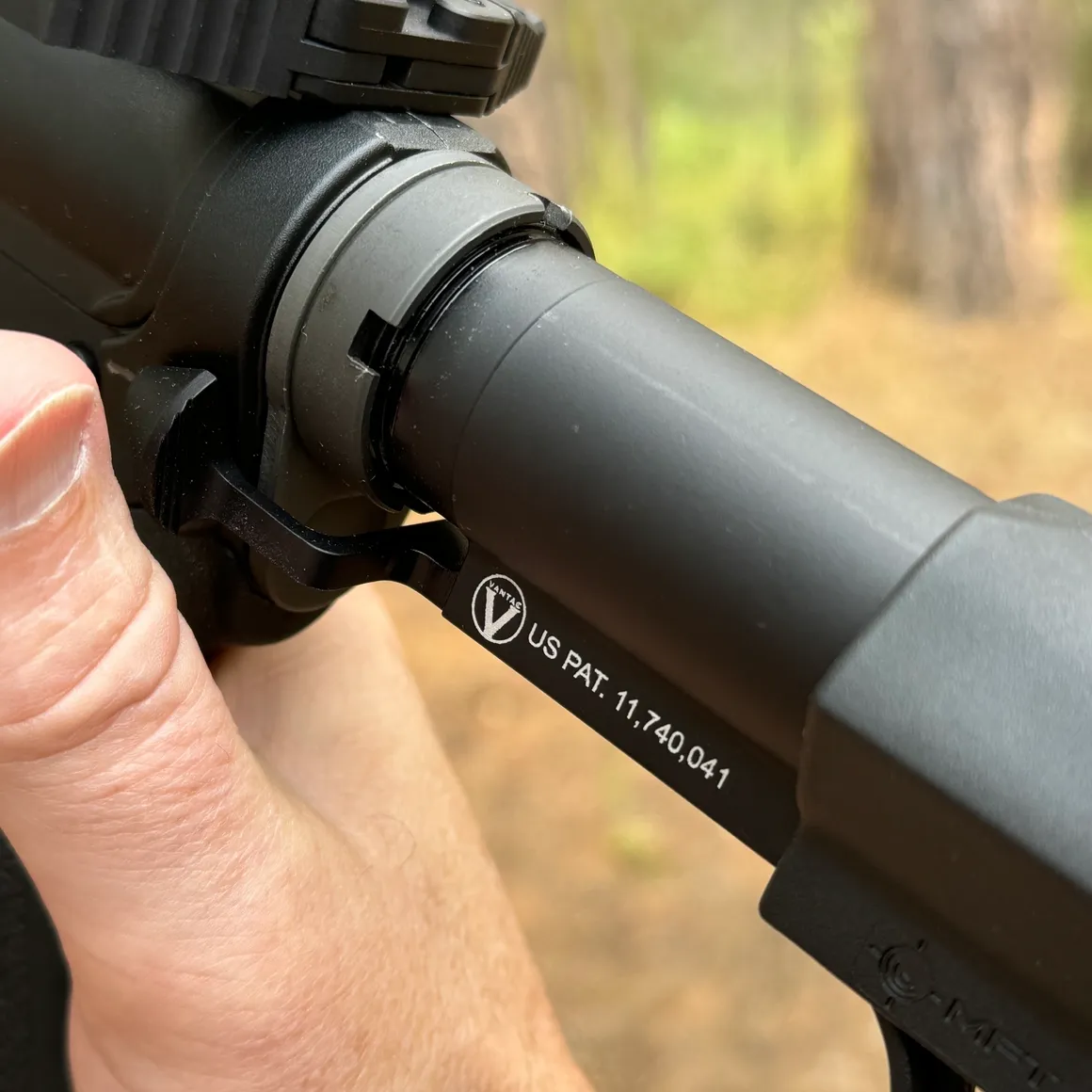

D.A.D.S. is not a dedicated stock, but a specially designed buffer tube that replaces the standard component in a compatible AR-15 configuration. The stock itself is selected separately by the user. The component does more than simply guide the stock, as its design incorporates a locking mechanism. The system uses two ambidextrous controls positioned on both sides of the rear section of the system. Pressing them, which according to the manufacturer requires approximately 8 pounds (3.6 kg) of force, moves the internal locking component and releases the stock. These controls allow the shooter to operate the mechanism with their thumb without changing their grip and with one hand. The design also uses a spring that applies pressure to the stock, allowing it to move toward the extended position once the lock is released. The final position depends on the pressure applied by the user. Vantac provides six adjustment positions, and when the control is released, the mechanism locks the stock again in the selected position.
This operating principle is what distinguishes D.A.D.S. from standard adjustment systems. With traditional solutions, adjustment requires reaching for the lever located directly on the stock and moving it to the desired position. Vantac has moved this mechanism closer to the user's hand, allowing the stock position to be changed without altering the grip. The manufacturer points to the use of D.A.D.S. when operating firearms inside vehicles, watercraft or aircraft, among other applications, where limited space may require the stock to be shortened. A similar problem can occur when changing shooting positions.
D.A.D.S. allows the stock position to be changed without taking the hand off the grip, the head off the stock or the eyes off the optic, offering six adjustment positions.
The list of compatible stocks includes models from Magpul, Mission First Tactical Minimalist, Hogue OverMolded and B5 SOPMOD. Vantac also points out that not all stocks will behave in exactly the same way. The main factors are the locking components used in their design and the characteristics of their springs. Vantac states that proper operation requires a stock with an appropriate amount of clearance around the buffer tube, while models that fit tightly around the tube may make adjustment more difficult. The manufacturer also points to designs using heavier locking-pin springs, which may result in poorer mechanism performance.
The design incorporates, among other components, two elements made from 4140 steel and 7075 aluminum, two pins and three springs. According to the manufacturer, the component adds less than one ounce, or less than 28 grams, to the weight of the platform.
