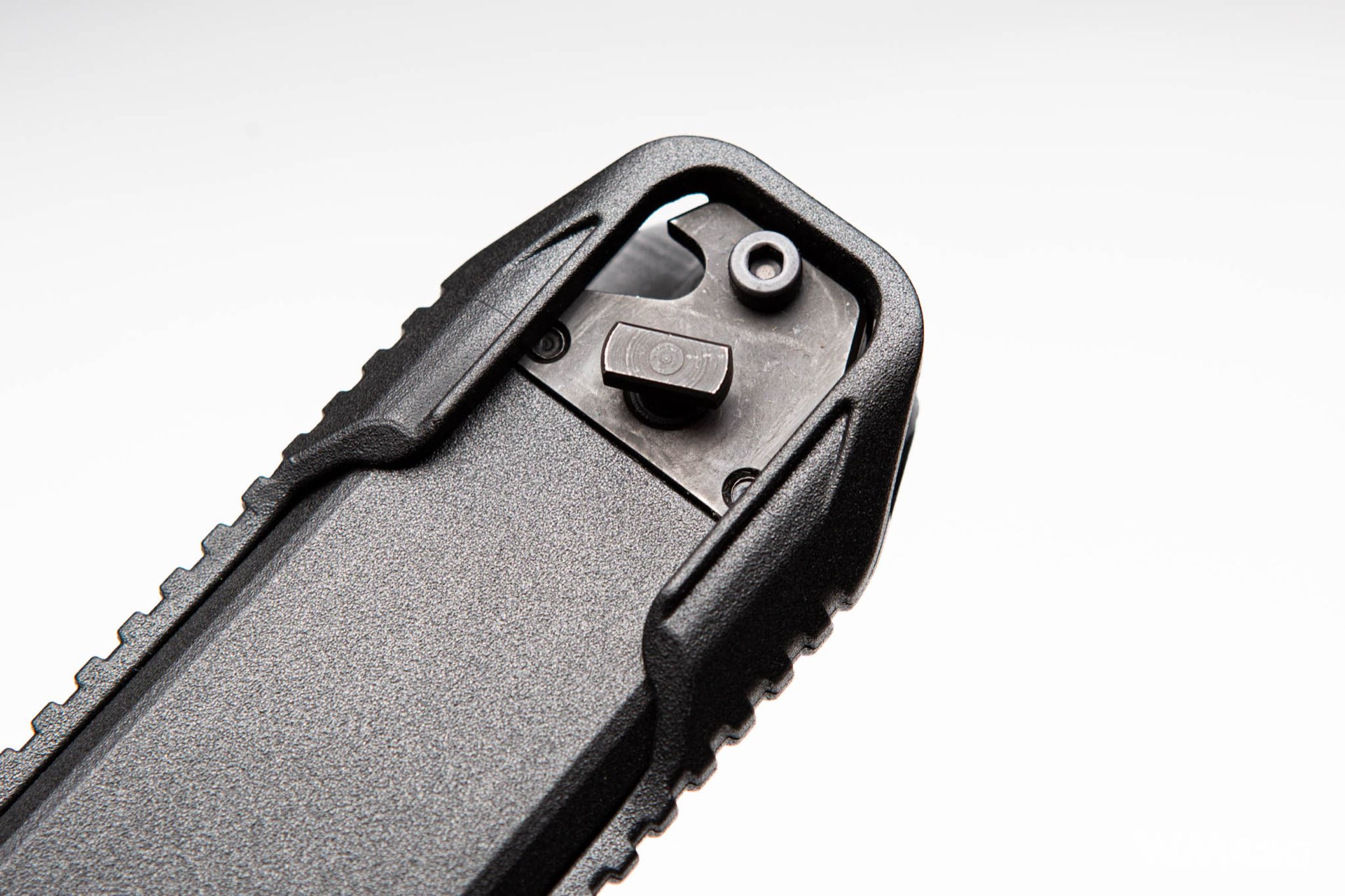

The total length of the knife is 278 mm with a butt, which acts as a mount, a glass breaker and a flat screwdriver. The aggressive drop point blade is characterized by high, double-sided edge made up to 1/3 lenght of the blade, improving the cutting and penetrating properties. The shape resembles the American bayonets manufactured by the Ontario Knife Kompany (OKC). The blade is 155 mm long and made of low-alloy NCV1 tool steel with a width of 3.5 mm. This steel is characterized by high hardness (about 60HRC) and impact resistance. In theory, because something strange happened during the tests, but more on that below. The blade is in a combo type, therefore there are 40 mm long saw teeth at the back of the blade. The so-called false cutting edge, an asymmetrical blade functions here as wire cutter. The hole for connecting it to the sheath is right next to it. There is also a thumb indentation on the spine to improve the grip of the knife.
There is practically no handguard, and what is left of it is a hook for attaching the bayonet to the weapon. The handle is made of glass-fiber reinforced polyamide (Itamid 253). The sheath (and the MSBS/Grot receiver) was made of the same material. It has a rough texture. The recess in the handguard is used to latch the knife into the sheath.
Like its predecessor, the new bayonet is designed to cut electrified wire. Apparently, each unit undergoes an electrical insulation test. The above-mentioned stub on the head has no connection with the blade.

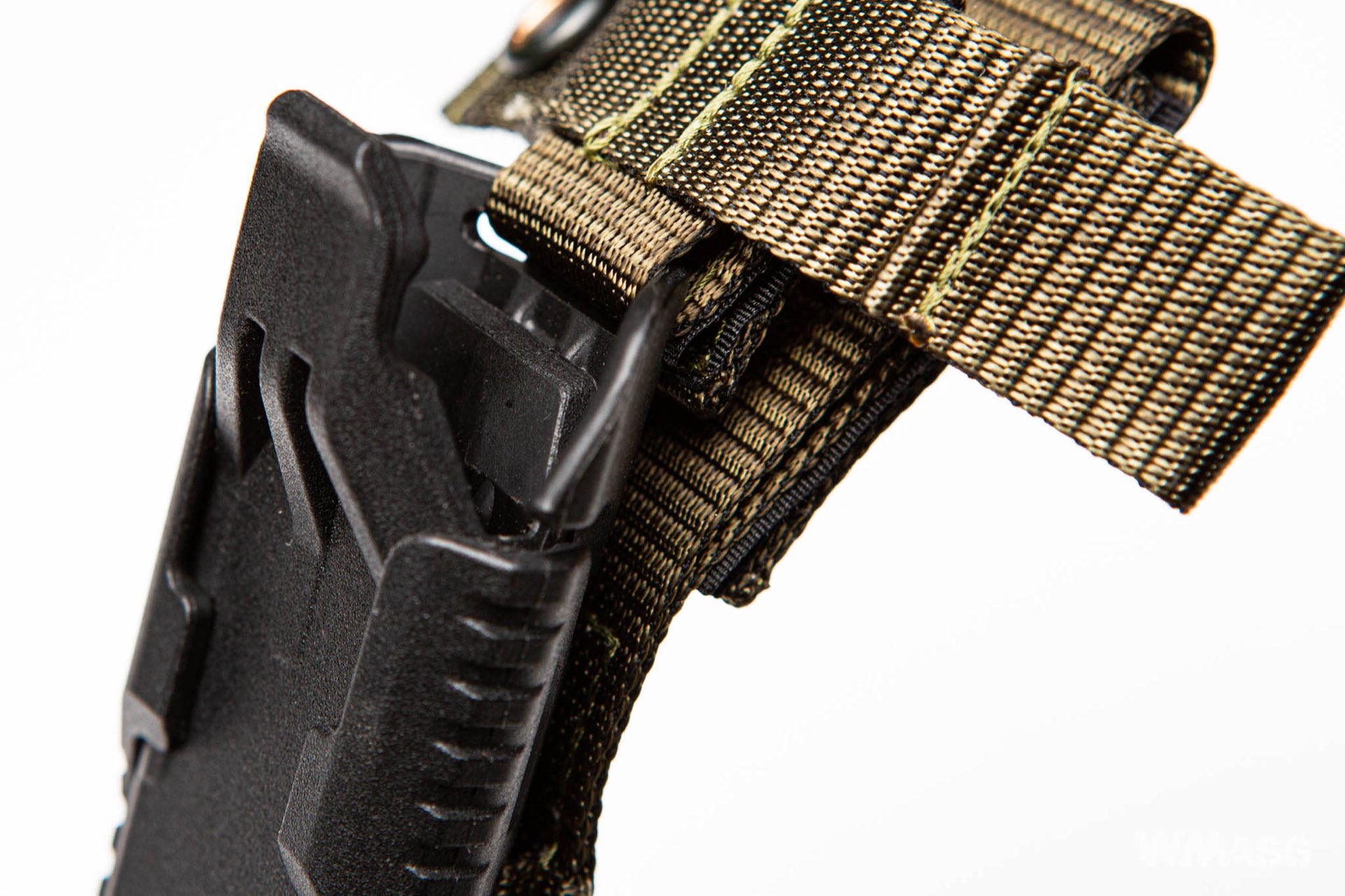

The sheath is two-part. The actual sheath and at the same time the part forming the wire cutter is inserted and locked with a latch in the frame part. The "frame" is attached with a polyester tape to the PALS/MOLLE (or belt) straps. This part also has an additional protection against losing the bayonet, in the form of a polyester tape with a latch. It is unnecessary, however, because the design of the sheath resulted in a resilient pressure, which, combined with the latch, rigidly holds the bayonet during transport. At the end of the sheath, there is a removable metal component with a hooked blade and wire cutter pin/hinge.

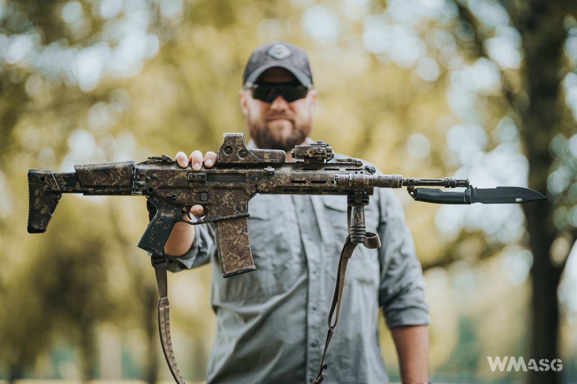

The bayonet is mounted on the carbine with a hook at the height of the handguard and a protrusion in the knife's blade and a latch on the bottom of the gun barrel. From the front, the hook attaches to the muzzle break of the weapon.

The two-piece sheath is an extremely practical and, at the same time effective, solution. In other designs, it is usually necessary to detach the entire sheath from one's webbing or remove it from a belt. Here, its enough to take out the bayonet together with the sheath from the "frame". In this way, we get an actual knife-bayonet and a wire cutter, and not just a wire-cutter in case of an emmergency.
The knife sits so tightly in the sheath, with an additional safety feature made of a latch (and in this case an unnecessary strap) that when carrying it at the waist, e.g. on the right side (in case of a right-handed people), there is thumb ramp missing on the side of the knife's back, to increase the leverage and facilitate drawing the knife. The current solution resembles that used in Glock knives and is not a comfortable one.
