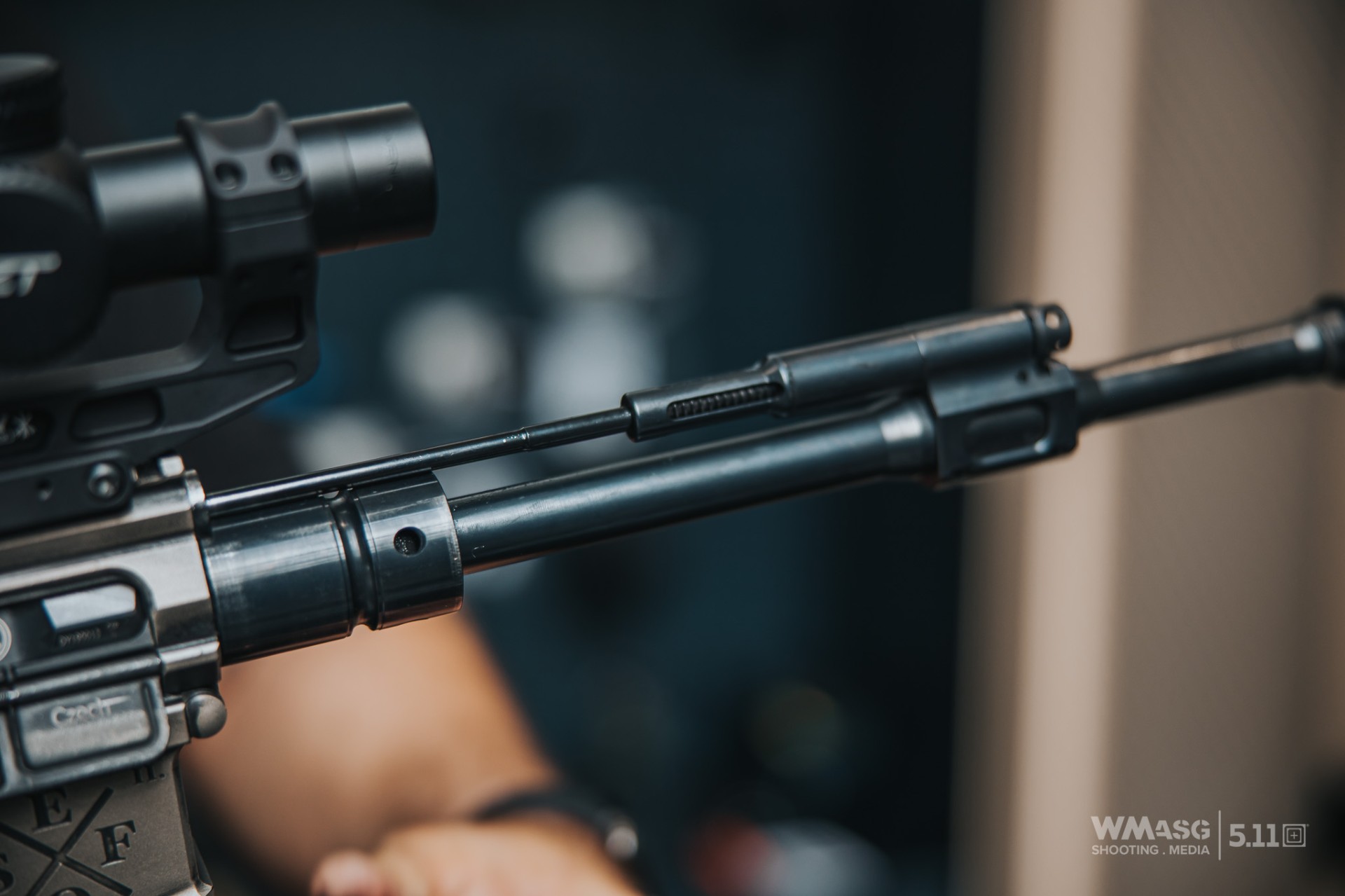

Antreg ARS M4s rifle's piston

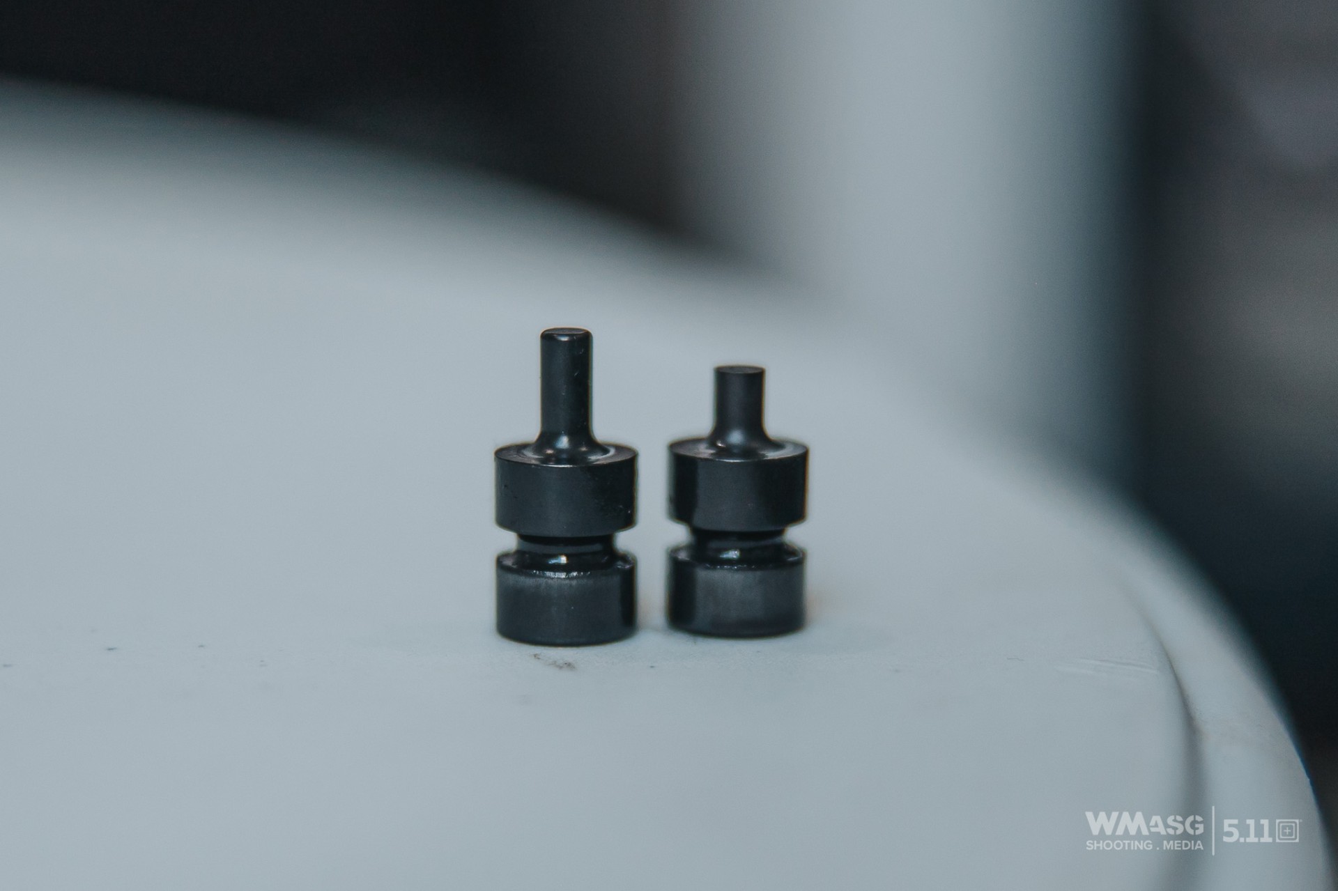

Two versions of the Antreg ARS M4s rifle's piston

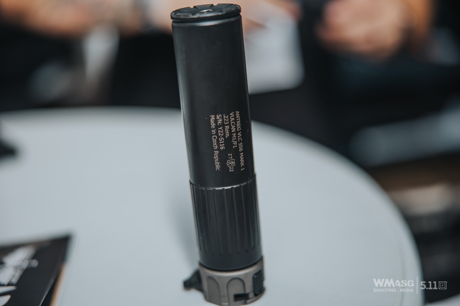

Sound suppressor manufactured by Antreg

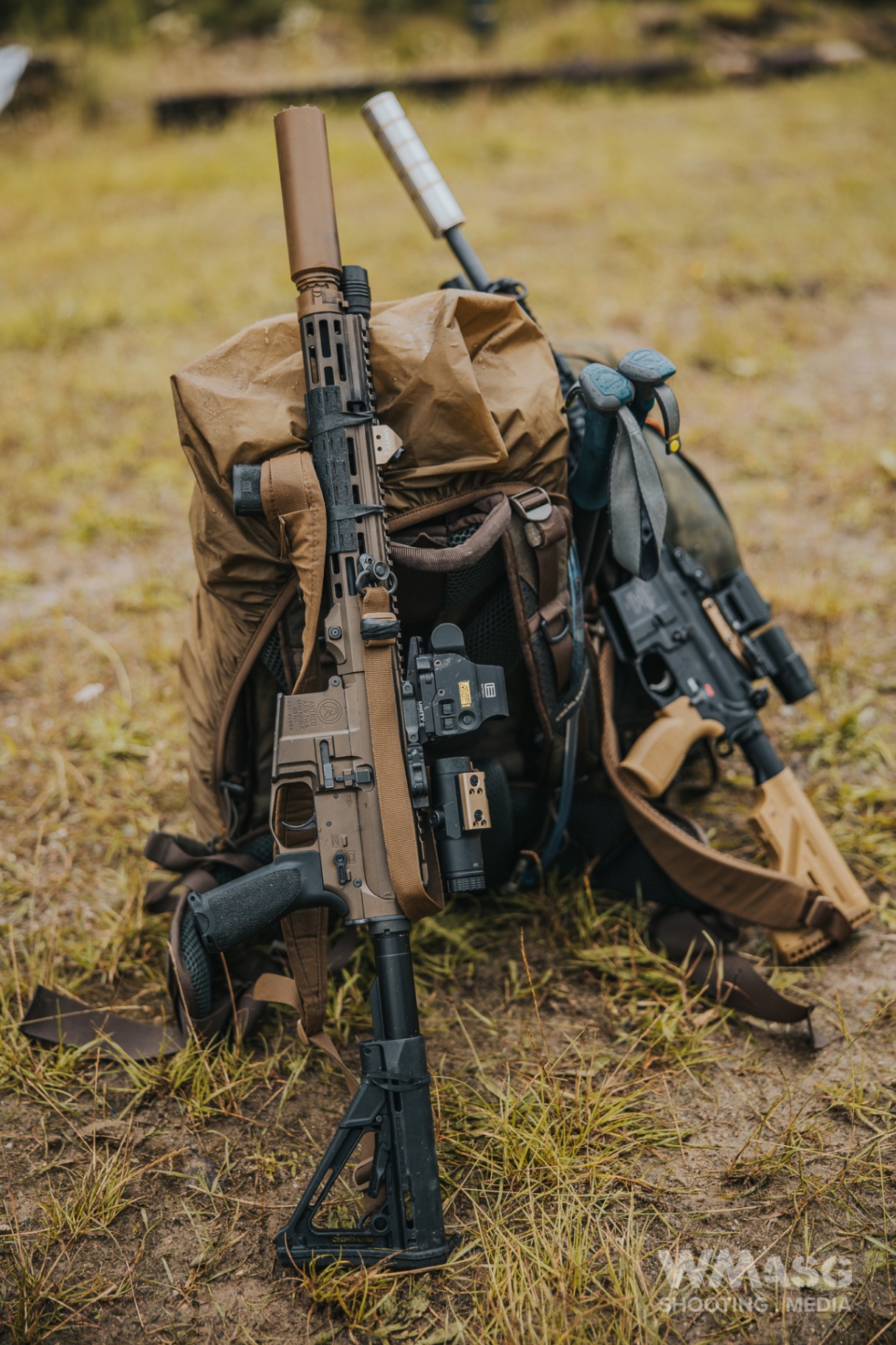

Such a rifle has appeared at the Light Infantry competition organized by the Klub Strzelących Inaczej in Pomerania, which we covered, where the rifle failed. Antreg sent a new rubber buffer element to the owner for free, although according to the service, the failure was caused by the user who neglected cleaning the rifle for too long and had a very dirty silencer.
Antreg ARS M4s rifle at the Light Infantry competition
