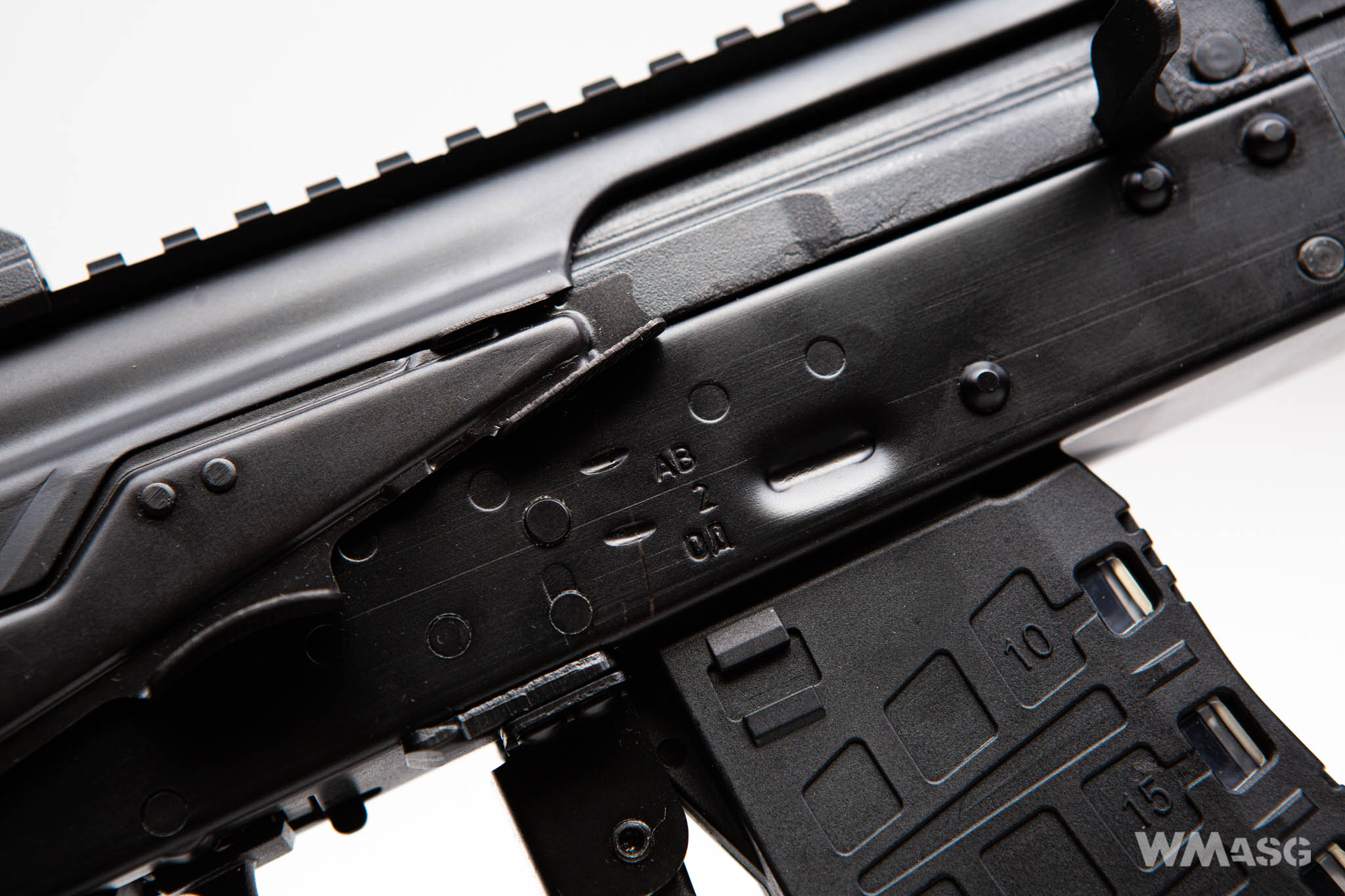

On the right, there are new markings of firing modes - in the original AK-12, apart from full-auto and single fire, there is also a 2-round burst setting. This setting was correctly replicated and placed between the full-auto and single fire modes, but the replica does not have this function.
When the safety/selector lever is in this position, the replica still fires in full-auto. The description of the single fire setting is placed like in other AK replicas, but there is no characteristic cavity where the safety/selector lever arm could stop. If you want to shoot in single fire, the lever must be pushed all the way down, beyond the outline of the receiver.
This is not an error or an inaccuracy - it is exactly the same in the real firearm. And here I should congratulate Arcturus as it was easier to "take a shortcut" and make the selector the same as in other AK replicas, but it was done just like in the original.
The safety/selector lever has an additional tab that makes it easy to use with the index finger. It can be done without any problem, but switching into full-auto setting takes some getting used to. Moving the lever all the way down to the single fire setting is not difficult. From the technical side, it is worth mentioning two things here. The first is how the lever is attached. The protruding "mushroom" is a nylon cap covering an Allen key hole in a screw, which the lever is screwed with. Therefore, it is not worth damaging the screw flange by trying to unscrew it. It is better to use a sharp tool to remove the cap and unscrew the screw when needed. The larger of the keys attached to the replica is used for this.
The second thing is an additional spring element, that does not appear in other replicas, riveted on the inside of the lever. Its role is to keep the lever in the position set by the shooter. This is another proof of Arcturus' great care for details.

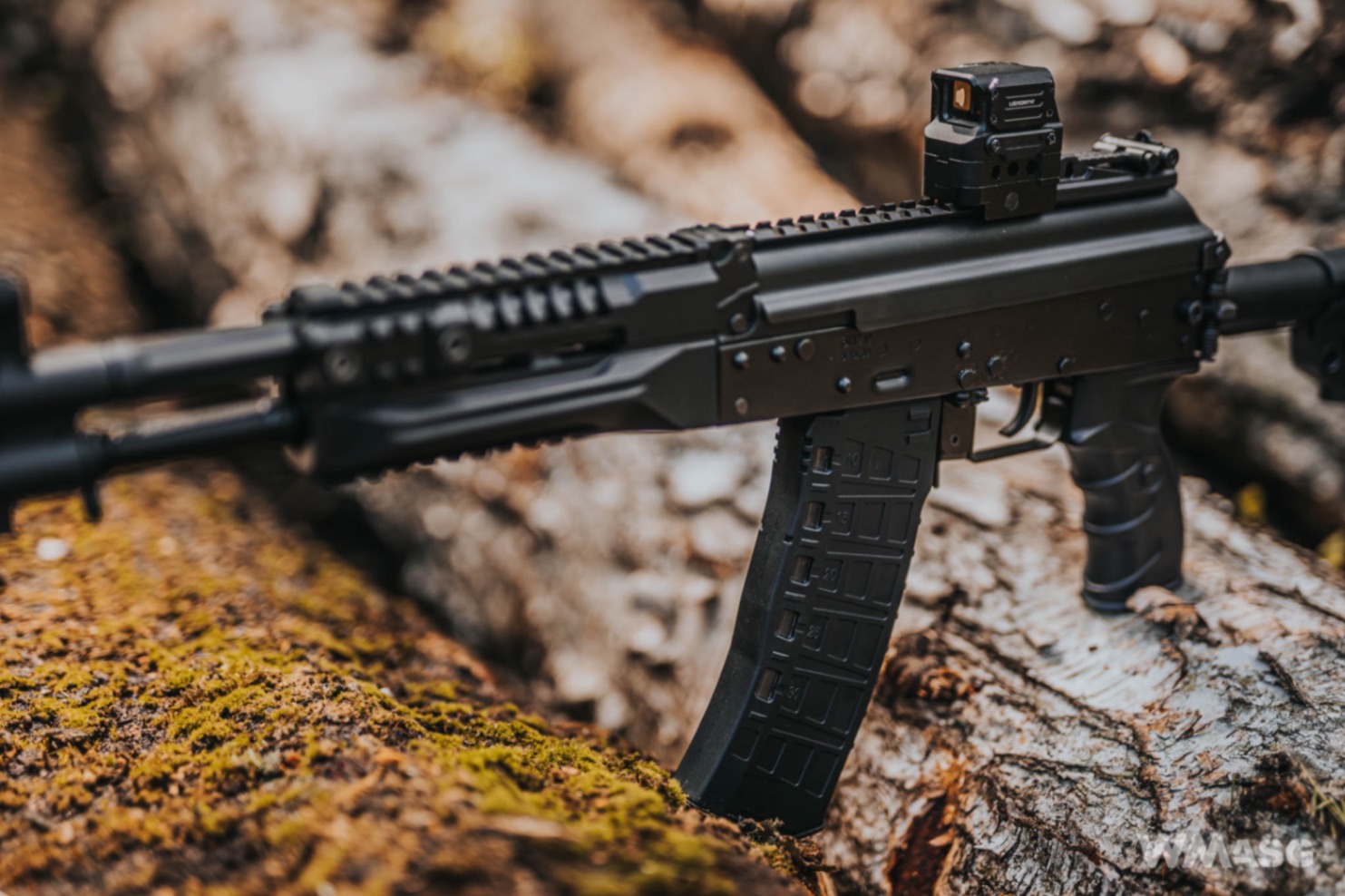

The receiver cover is also made of steel, but it gives the impression of being painted, not oxidized. The upper mounting rail, typical for the AK-12, is permanently attached to it with rivets. The rail perfectly matches the upper mounting rail of the gas tube cover.
The replica comes with a detachable rear sight that can be mounted anywhere on the rail, extending the aiming line. It is a classic sight known from many AK models, in which a round aperture was used instead of the traditional U-notch sight. The sight is scaled up to 800 meters. In addition, on the right side there is a screw that allows to adjust the sight horizontally. The screw can be rotated when lightly pulled along the axis. The sight should be slid over the rail and secured with a single setting screw. It is done with the smaller of the Allen keys that come with the replica. The screw is accessible after lifting the sight arm and there is no flat spring that to obstruct this.
The most important feature of the cover is the way it is attached differently than other AKs. There is no typical latch here as it is connected to the receiver with two hooks in the rear part of the replica, that are invisible from the outside, and after being moved as far forward as possible, it is secured with a bolt rotated by 90 degrees.

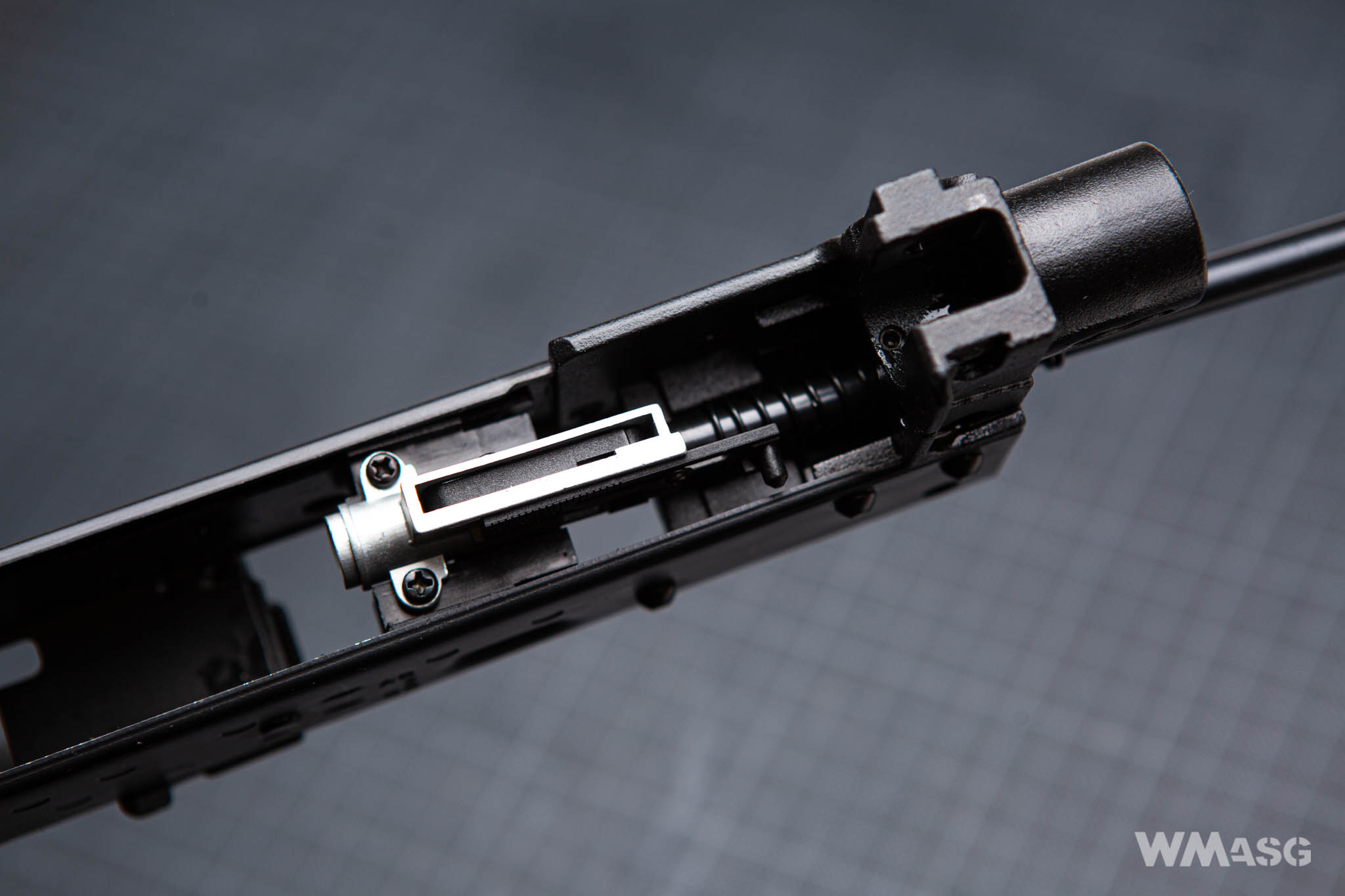

The cast bolt carrier is made of iron-containing material. It is rather not steel, although magnets are attracted by it. Due to the size of the return spring, it can only be retracted 5/8 of the length of the ejection port. The mechanism supporting the dummy bolt carrier is the same as in other replicas. Due to the change in the method of fixing the cover, the "button" is only used for mounting of the rod leading the dummy bolt carrier to the gearbox. It is invisible from the outside.

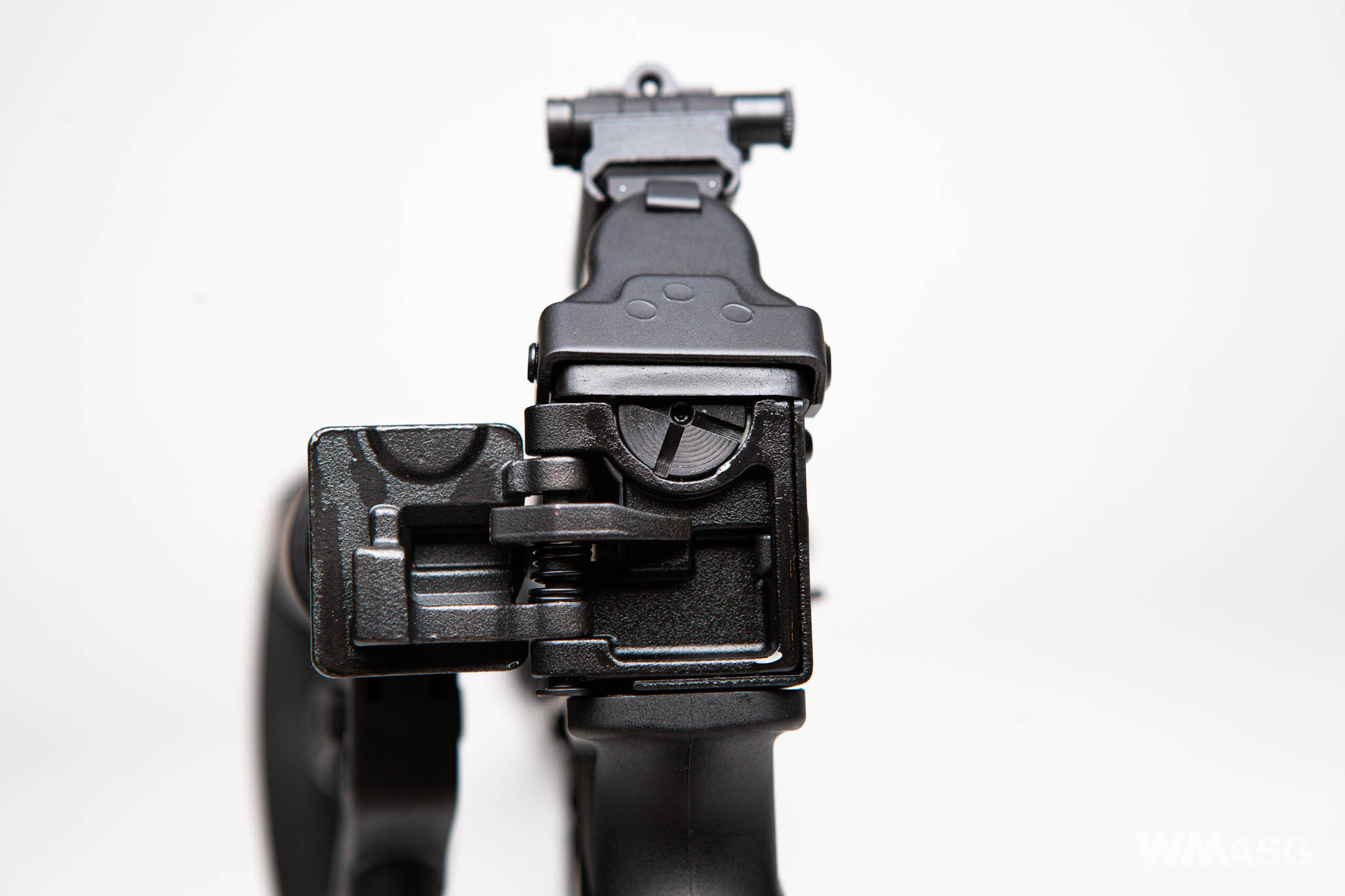

The stock, similar in appearance to an AR15 telescopic stock, is folded to the left side, similar to the previous AK versions. The construction of the hinge itself has been slightly changed, with a built-in lock that keeps the stock folded to the side.
In the AKS-74/AKS-74U/AK-74M replicas, the stock folded to the side was kept in this position by a latch in the front part of the receiver. In the AK-12, the latch is gone and an additional cam with a spring is built into the hinge. Now, to unfold the stock from the transport position, its enough to pull it. It is seemingly simpler, but the latch held the folded stock more securely.

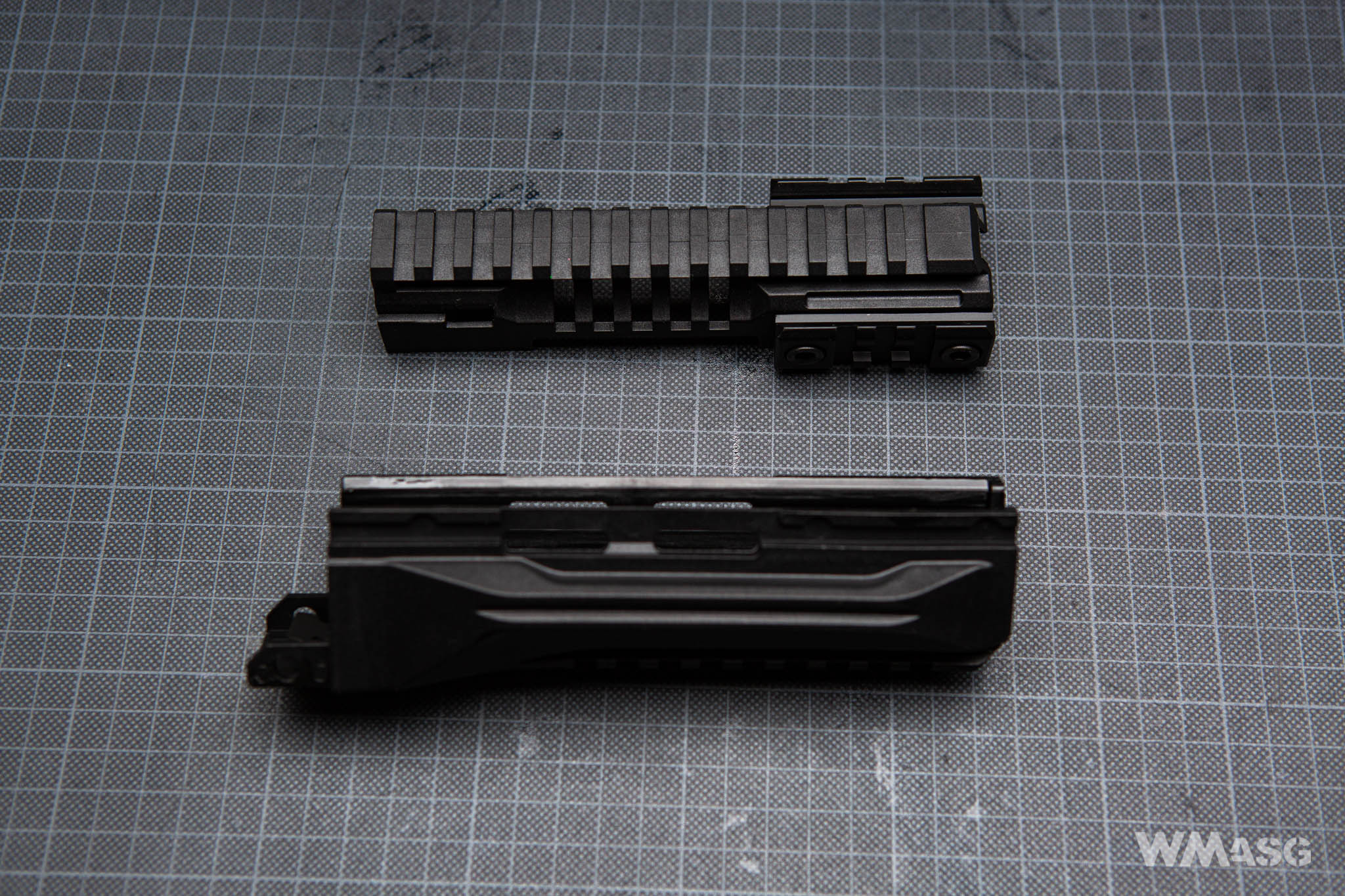

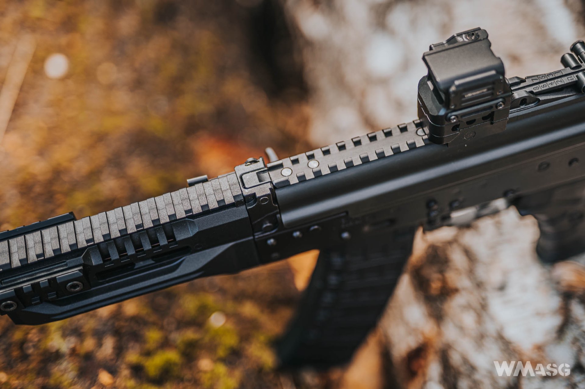

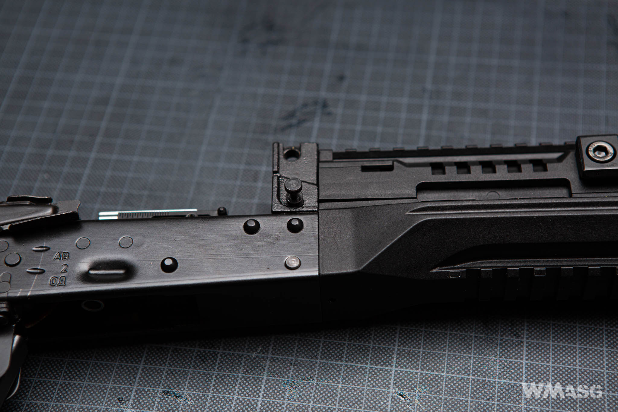

The handguard and the gas tube cover are made of the same hard material that is also used to make the stock. In the AK-12, the handguard and the cover are completely different than in previous AKs. First of all, they are connected to each other. The cover is attached to the handguard by putting over the handguard in the middle of its length and sliding it over.

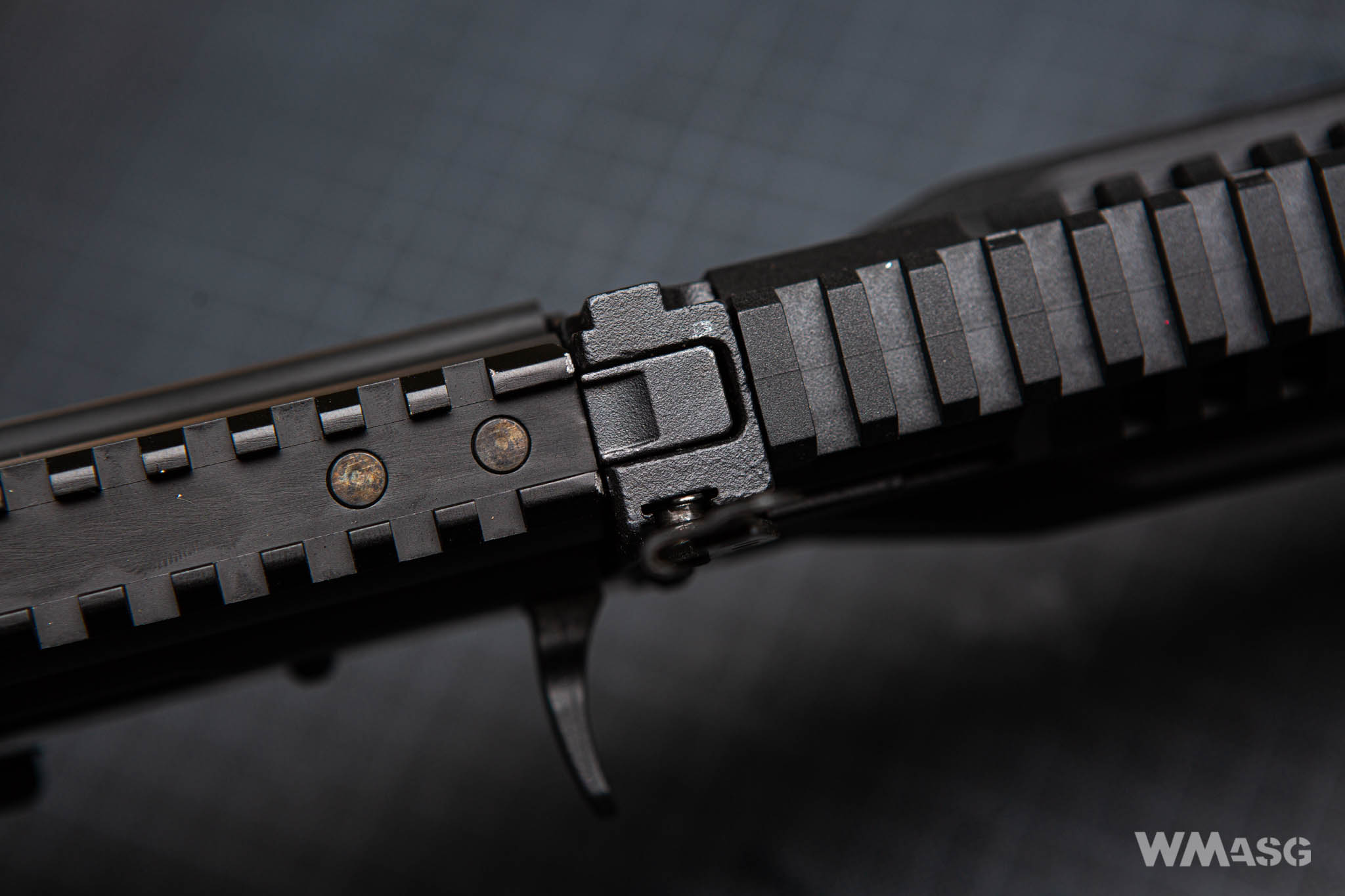

Secondly, the handguard and the cover are not connected to the barrel at any point. The only mounting point is the receiver, into which the complete assembly is inserted and locked with a pin. And this is a point that I would give some attention if I were the owner of an Arcturus AK-12. For many players, the factory fitting of these parts will be fine, but I would try to stabilize them a bit more.
The lower part of the handguard is shaped like a 9-slot rail for mounting additional grips or other accessories. The entire top part of the cover forms another rail. In addition, there are two 3-slot side rails with screws. And here's a note: it is much easier to screw them to a disassembled cover than when its attached to the replica.

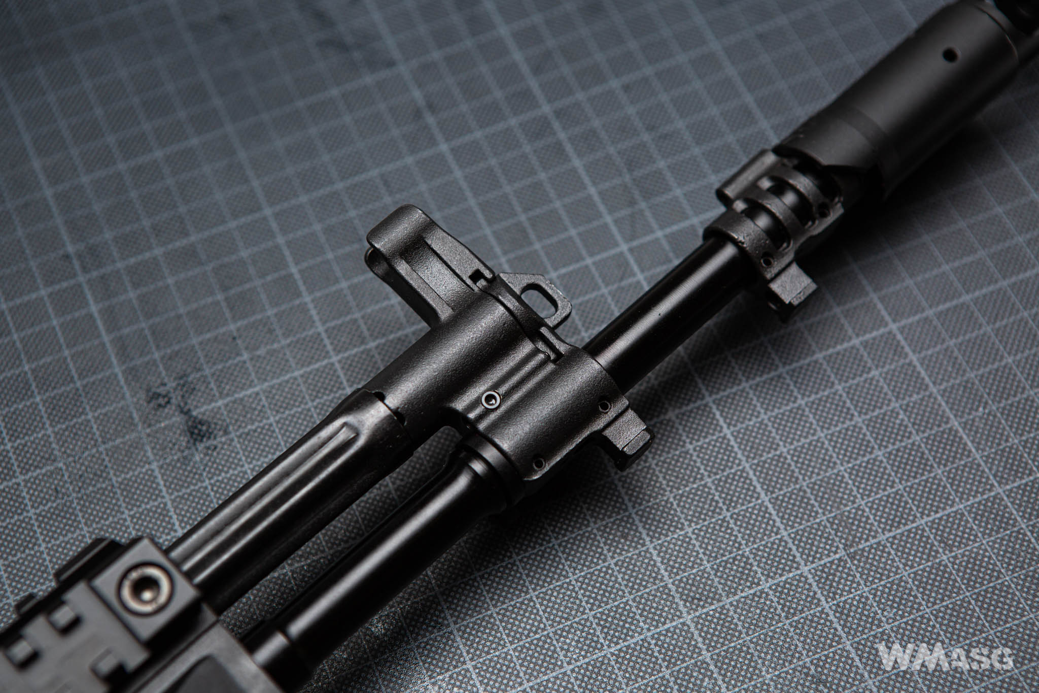

Some of the parts mounted on the barrel are made of the same alloy from which the dummy bolt carrier was cast. I am talking about a gas block and a bayonet mount. Both parts are mounted with spring pins, without any kind of setting screws.

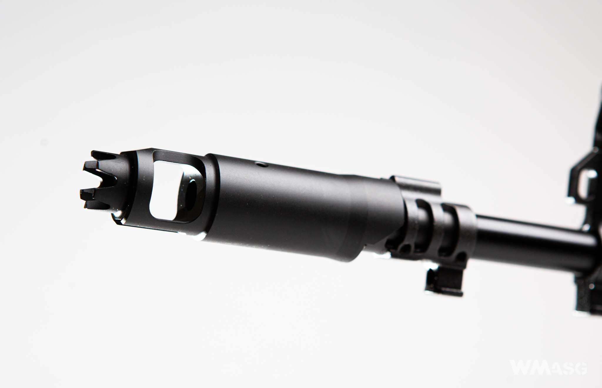

A muzzle device resembles the one known from the AK-74 and is made of an aluminum alloy. The mounting was solved in an interesting way... After pressing the securing pin, it must be turned in any direction by 180 degrees and than removed from the barrel. There is no thread here, so there is no way to mount any kind of silencer, unless the Arcturus decides to release a silencer dedicated for the AK-12.

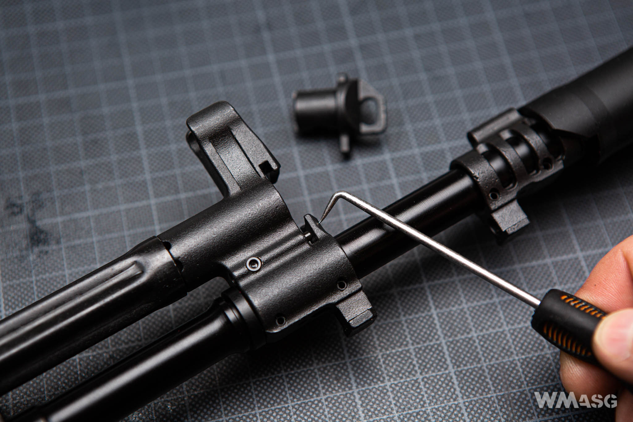

A replica of the gas system is worth discussing. First of all, because the AK-12 has a fixed (not removable in field conditions) gas tube, and its end, resembling a gas regulator, is in fact a plug used for cleaning and maintenance of the weapon. And this is another thing that Arcturus replicated very carefully.
To remove the plug, one has to press and hold the locking pin and turn the plug towards the pin. The assembly is similar - press and hold the pin and turn the cap. Especially during assembly, it is worth using a flat tool to press in the pin, e.g. a tip of a knife.
The second reason the gas system is so interesting is the additional function of the plug. After taking it out, it serves as a key for disassembling the main spring guide in the gearbox and thus to replace the spring itself. We will talk about how to do this in the next section.
The last part placed on the barrel is a rotating carrying sling loop. Like the outer barrel itself, it is made of an iron-free material. Do not be confused by tests performed with strong magnets as they are attracted by to the barrel only because the inner barrel is made of steel. If you repeat the test after removing the inner barrel, everything will become clear.

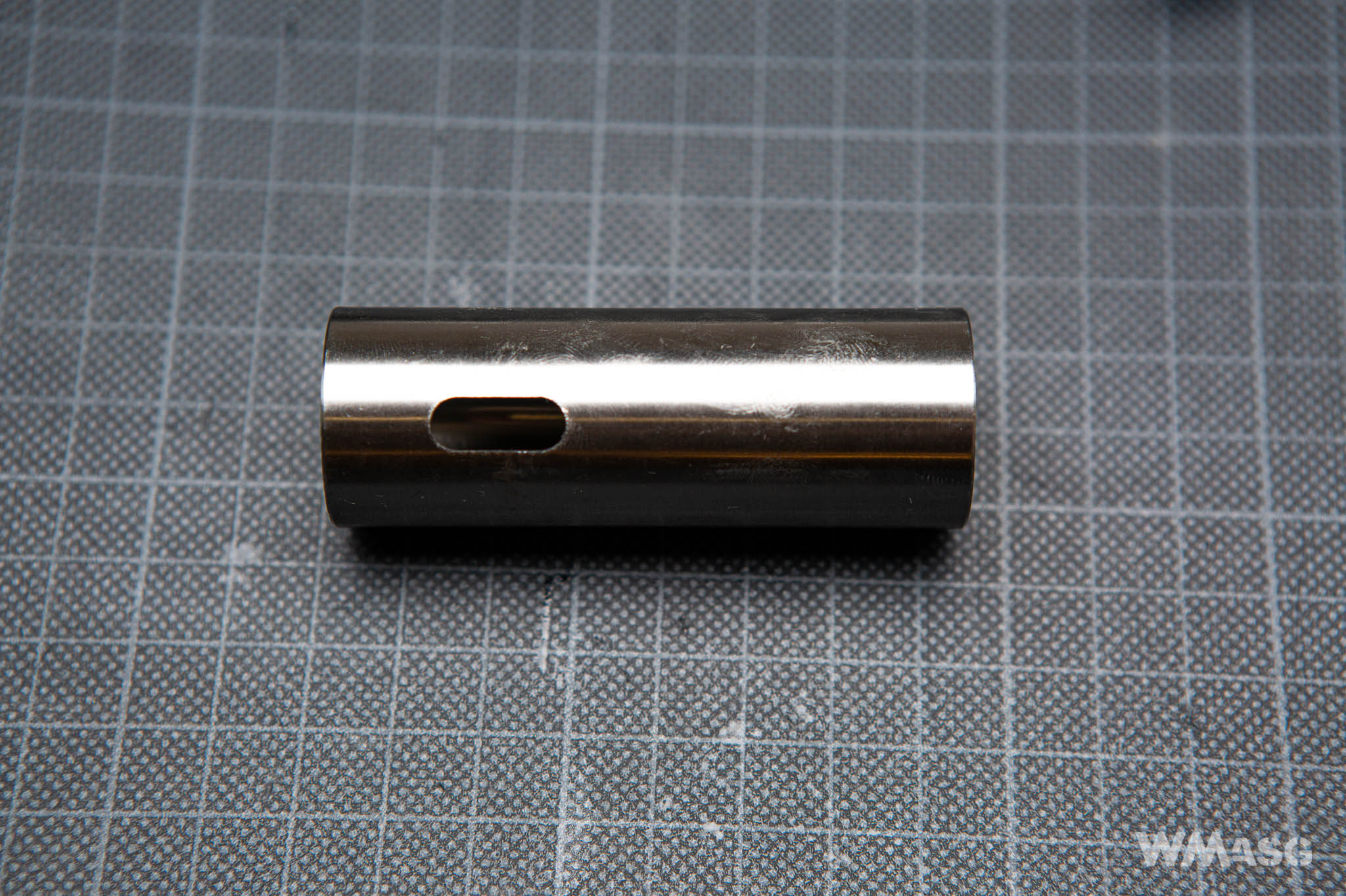

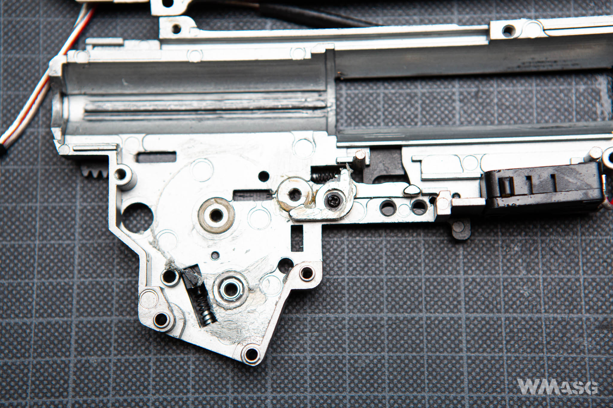

From the mechanical point of view, the AK-12 is not surprising. We have a very decent configuration typical for Arcturus. The frame is a V3 with quick spring change system and a cutout for an EBB system, which was not installed. Steel (sintered) gears are mounted on 8-mm bearings, but only on the bevel gear has ball bearings. The other two are mounted on slide bearings. A delayer is mounted on the sector gear. The piston has all teeth made of steel. The flat polymer piston head has a bearing, as does the spring guide. The 19.8 mm long polymer nozzle has an O-ring. The electrical installation is made of low-resistance wires in colorless and hard insulation and is controlled by the micro switch mentioned at the beginning.
The additional frame of the movable contactor cooperating with the trigger is secured from the outside of the gearbox with an additional guiding plate made of plastic. This prevents bending of the part of the contactor containing the micro switch, which would lead to problems with the current flow and operation of the replica.
Apart from the parts mentioned above, all other parts of the mechanism are standard. Even an anti-reversal latch that works with an external spring-release lever. The whole mechanism is assembled and adjusted very well.
The Hop-up chamber is a standard AK chamber with a slider adjustment. The bucking is typical. The inner barrel is made of steel and, according to the manufacturer's declaration, has an internal diameter of 6.01 mm. Target shooting tests have shown that the replica does indeed fire is a satisfactorily way.

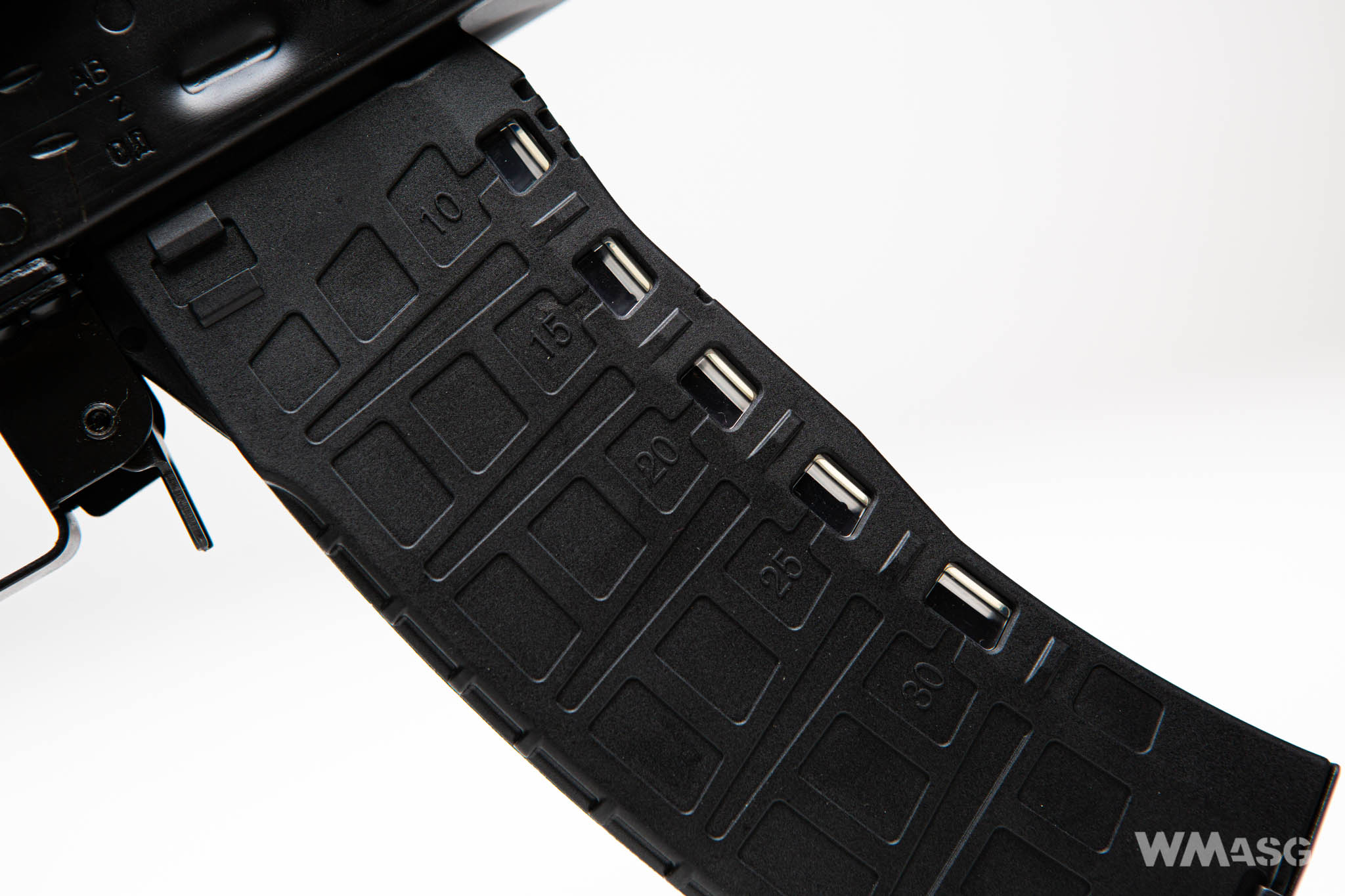

The real AK-12 magazines have transparent inspection ports for controlling the amount of remaining ammunition. Both types of Arcturus magazines these ports, but you can't see BBs through them. There are no ports in LCT magazines.
We also conducted a magazine compatibility test of both currently available AK-12 replicas. The magazines of both manufacturers (Arcturus and LCT) are fully compatible and work interchangeably in both replicas. During the tests we did not find any problems with feeding of BBs.
One more feature of the AK-12 magazines is worth mentioning. As you can see in the photos, the bottom of the magazine is not flat. The rear part of the floor plate is angled at such an angle that it is parallel to the barrel's axis. Thanks to this, by resting the replica on the magazine, it can serve as a relatively stable support during shooting.
