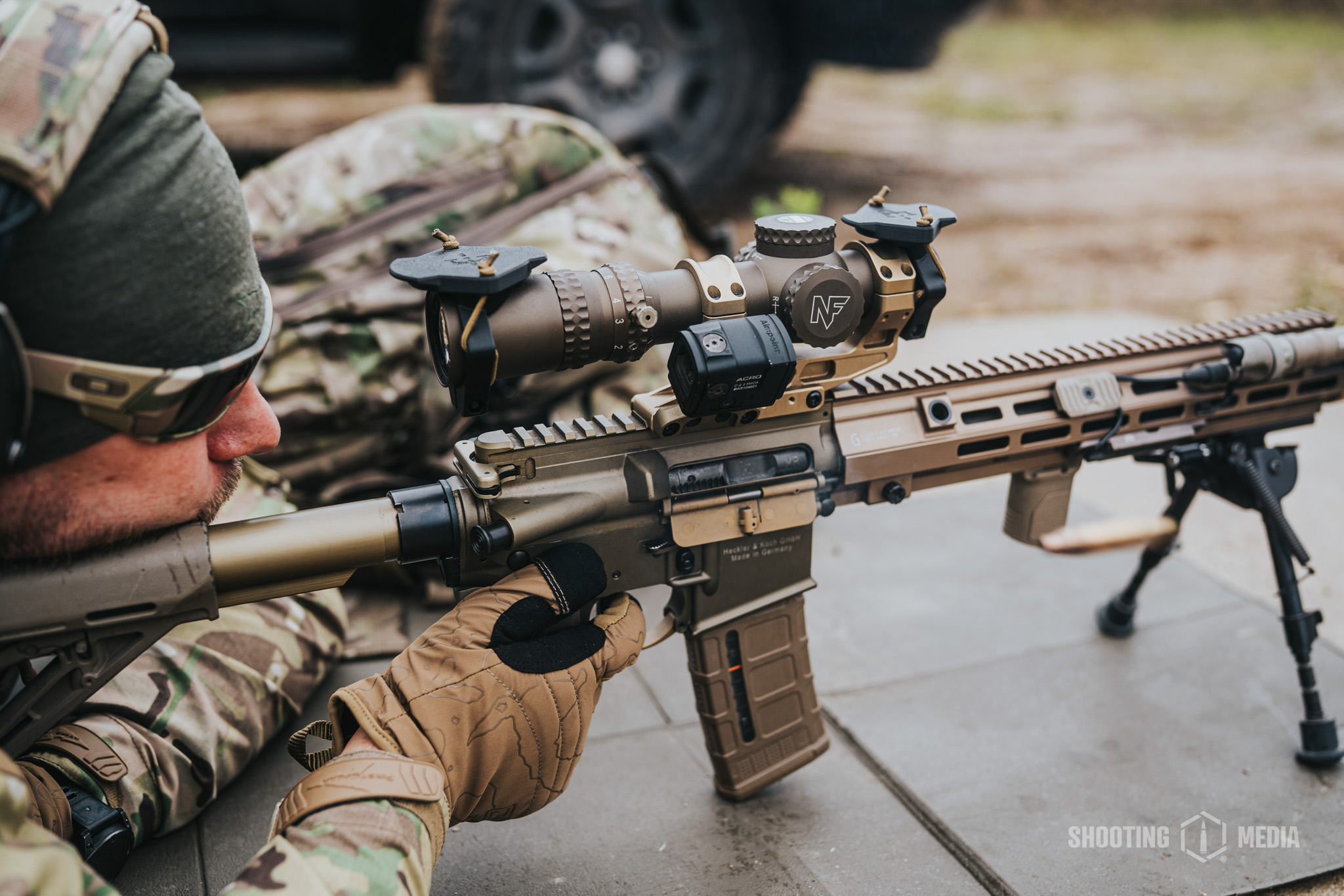

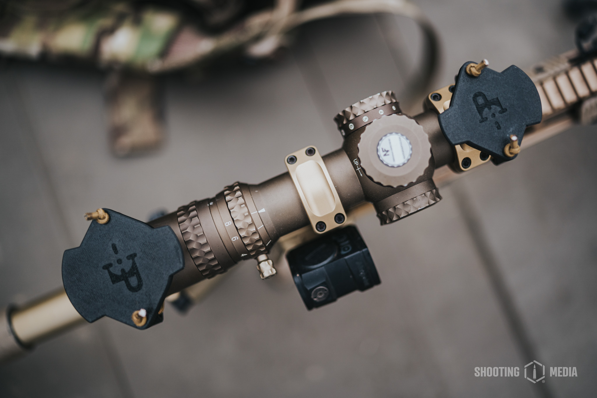

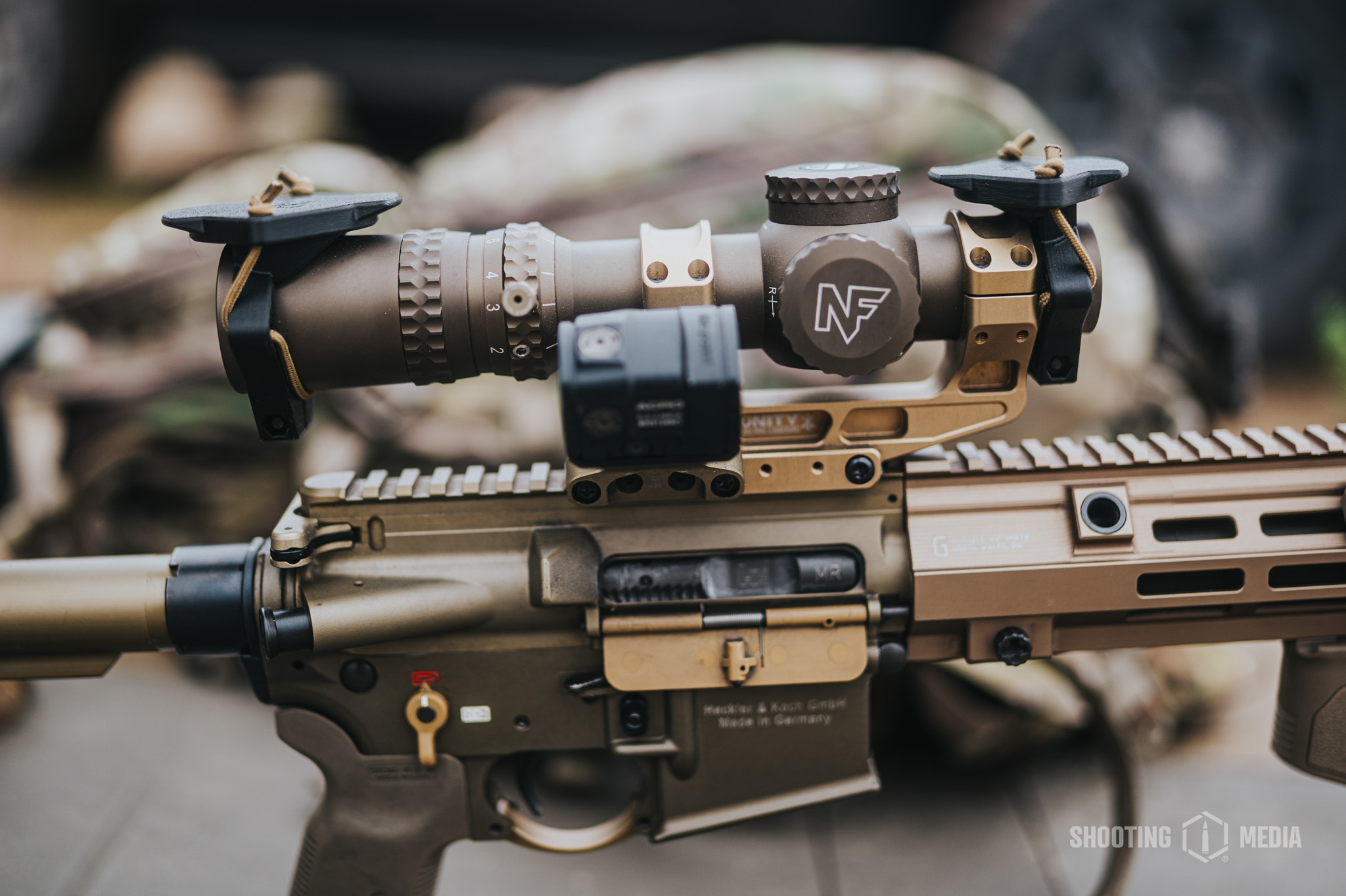

The covers described here consist of a 3D-printed ring and the actual scope cover attached to it with elastic shock-cords. The mounting ring has a rubber insert inside which further stabilizes the whole assembly on the tube something the manufacturer strongly emphasizes as a distinguishing feature of their product. Interestingly, even though no glue was used to mount the insert, it sits firmly in place. The installation itself is not rocket science as the ring is simply tightened with a 2.5 mm hex screw, and thanks to the rubber insert the recommended torque is only 0.5 Nm.

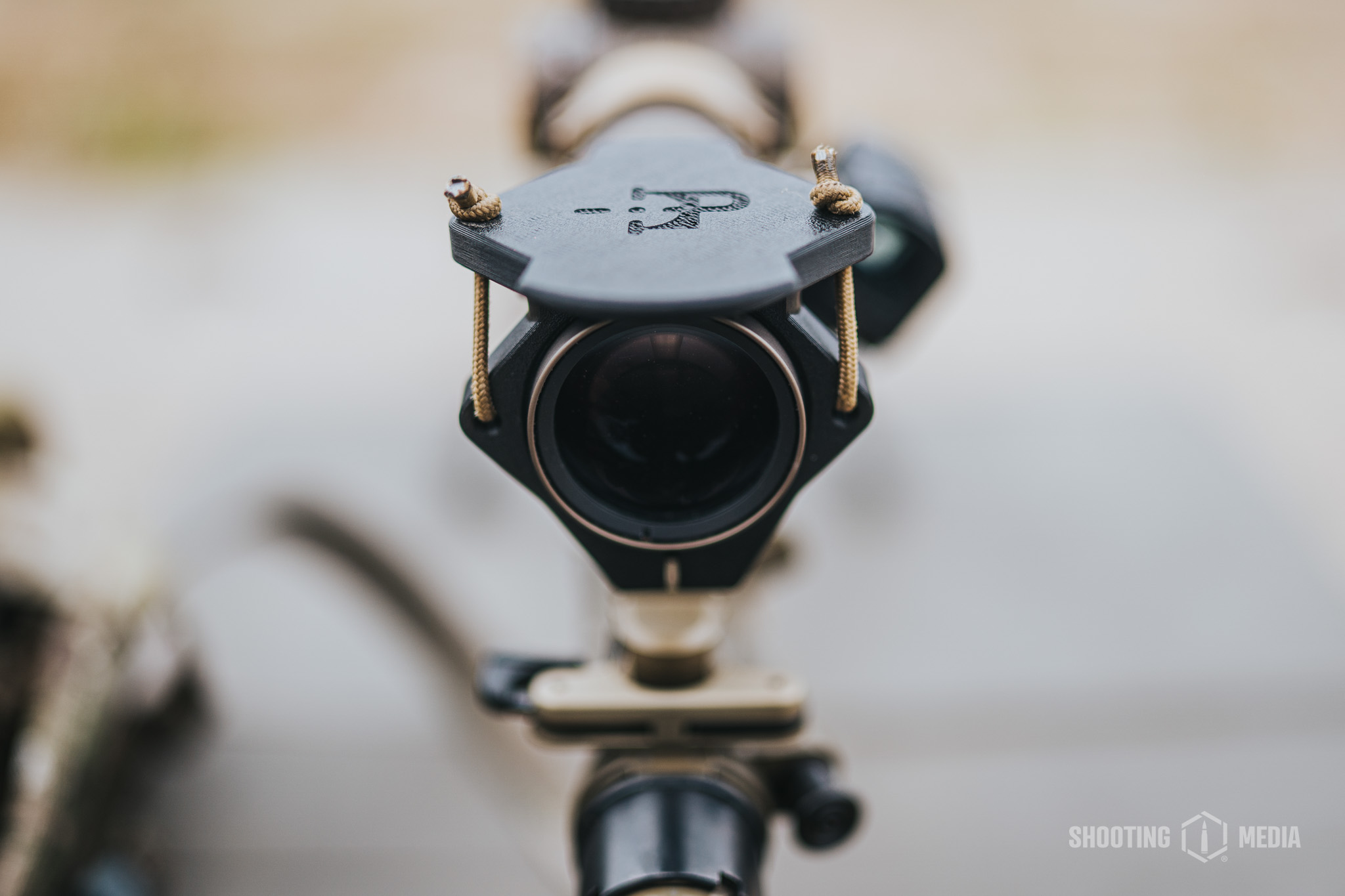

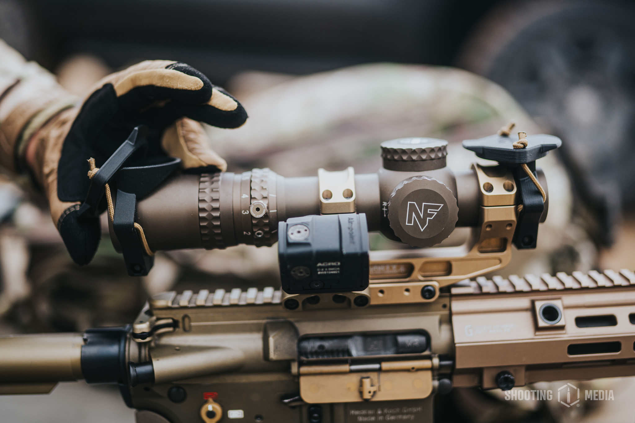

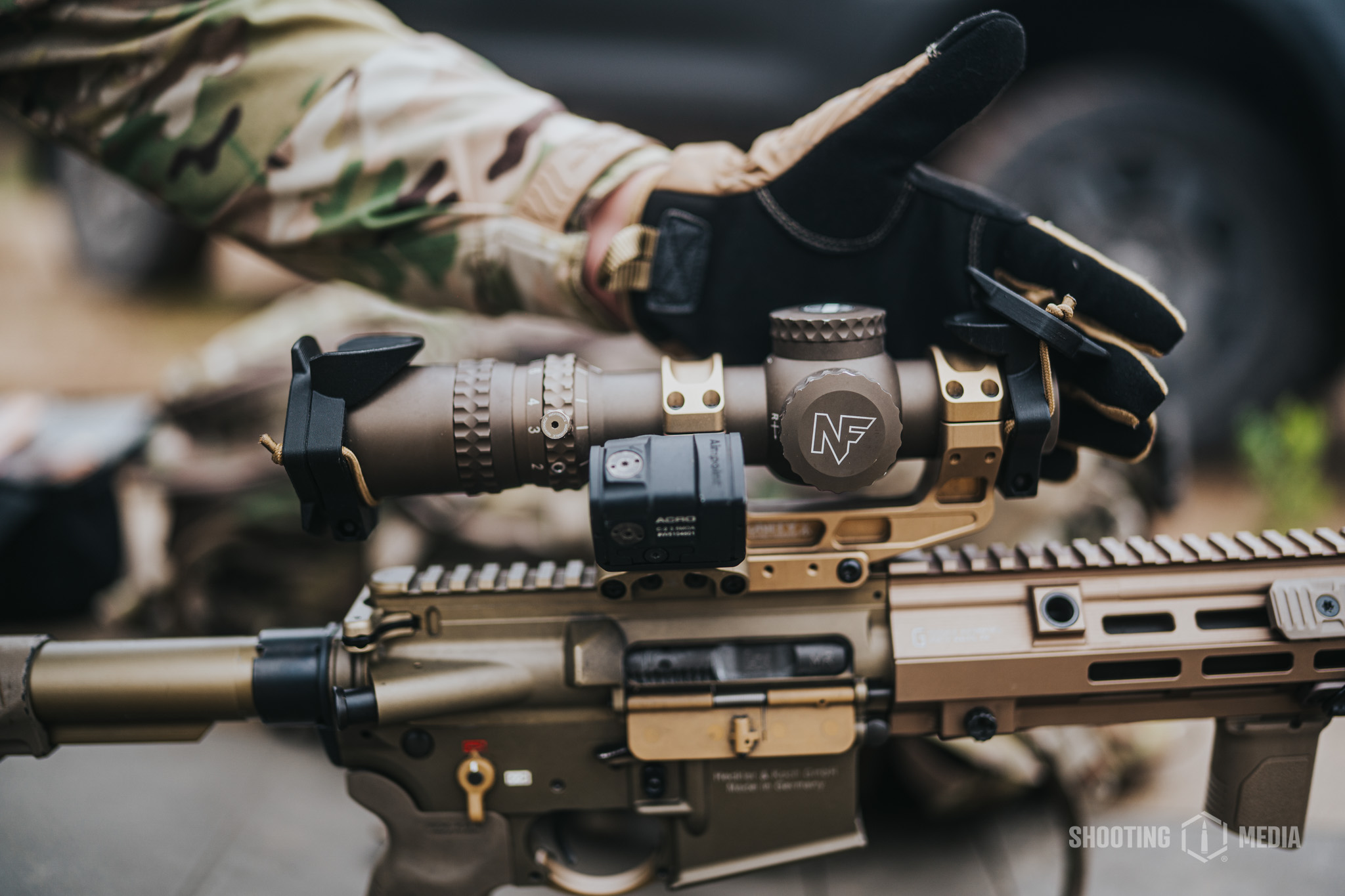

The cover itself is also not complicated, but its shape includes two protrusions that make opening and closing easier, especially when wearing gloves and during dynamic weapon manipulation. The solution works — the protrusions actually do their job. Properly selected tension of the shock-cords (which is up to the user) ensures that the covers reliably and consistently snap into the correct position. I have not yet experienced it working otherwise.
The most important feature that distinguishes OPTactical.eu covers from competitors is the characteristic “shelf” for the cover in the upper part of the mounting ring, called a “saddle” by the manufacturer. Supposedly refining this very element took the most time. The challenge was to design such a shape of the “saddle” that the cover would repeatedly and reliably “snap” onto it, stay stable, and return to its place every time, protecting the scope’s lens. The front and rear covers are constructed in the same way.

At the current stage the manufacturer remains with 3D printing due to its policy of an individual approach to each customer. If a given model of scope is not on the selection list, which in our market reality is not difficult, or if the chosen mount does not allow one of the covers to be installed, it is not a problem: simply send the dimensions of your configuration and OPTactical.eu will adapt their covers to your setup. That was the case for me. The Unity Tactical FAST LPVO mount sat too close to the Nightforce lens and the “shelf” had to be raised by 2 mm. Thanks to 3D printing technology the company is able to adapt the product to every customer.
